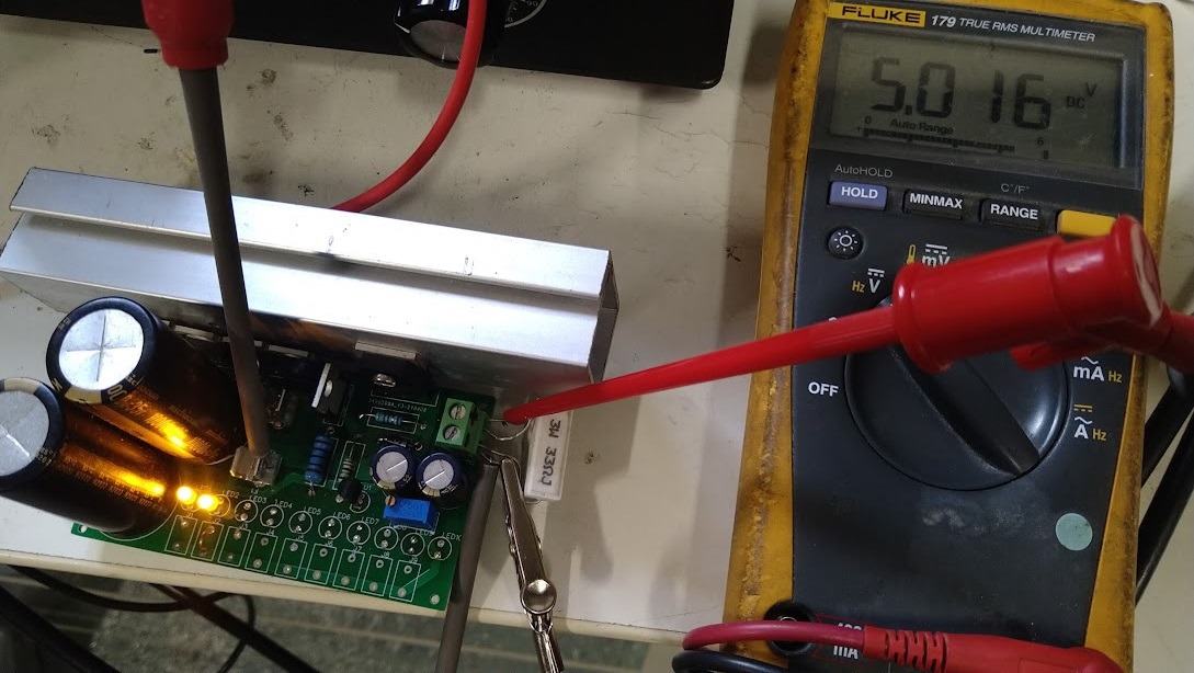

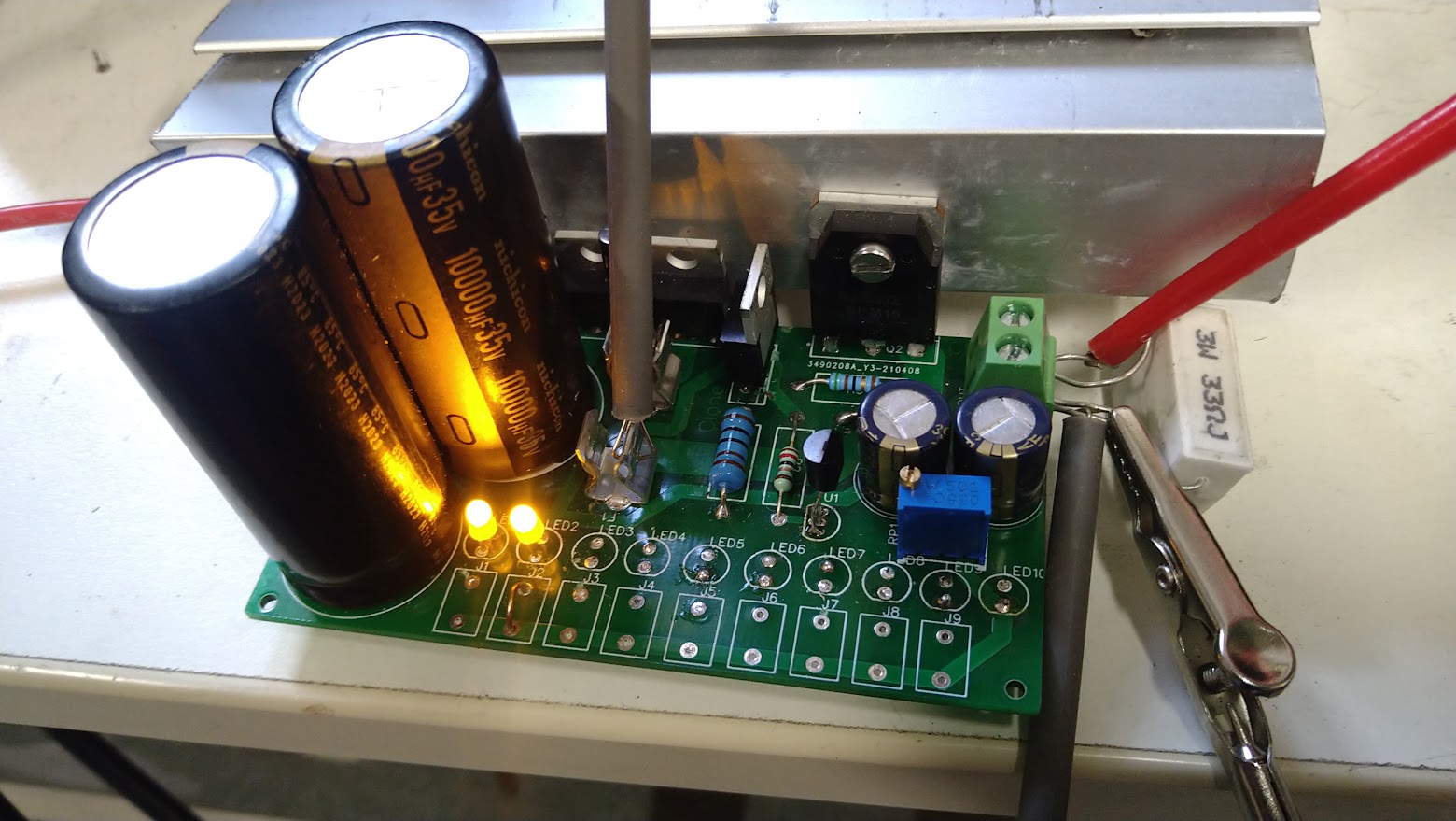

Thanks for the quick responce. Now I got it all right and my clone is working. I did a small fail at the PCB and did put the LM334 the wrong way. I used yellow leds and they seems to drift more than what others seem to have, so i will try others. Will try the ones I used in shunt reg project.
It could be partly due to the different layout too. Try red Leds. You may also try increase the 12 Ohm value up to double if it helps to reduce their drift in your example.
Yes I was testing with an external dc-source to minimize problem sources. I have now tested with rectifying circuit and red leds and all is better. Actually really good. Improving my Allo Digione Signature hat some steps.

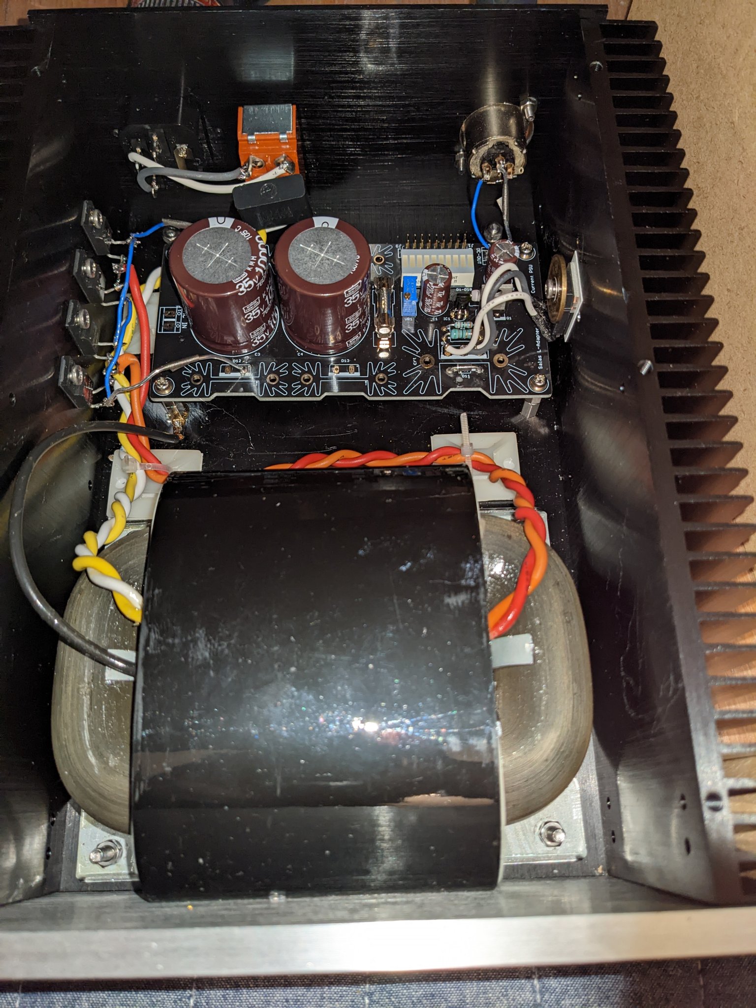

Congratulations. Substantial sinking and big R-Core I see. A heavy duty DIY PSU build for computer.
Horse race track shape transformer and a coin to mount power transistor states DIY made in Japan.

I have tested with ACA mini and it was amazing.I can not forget.
Now I want to build another one.
