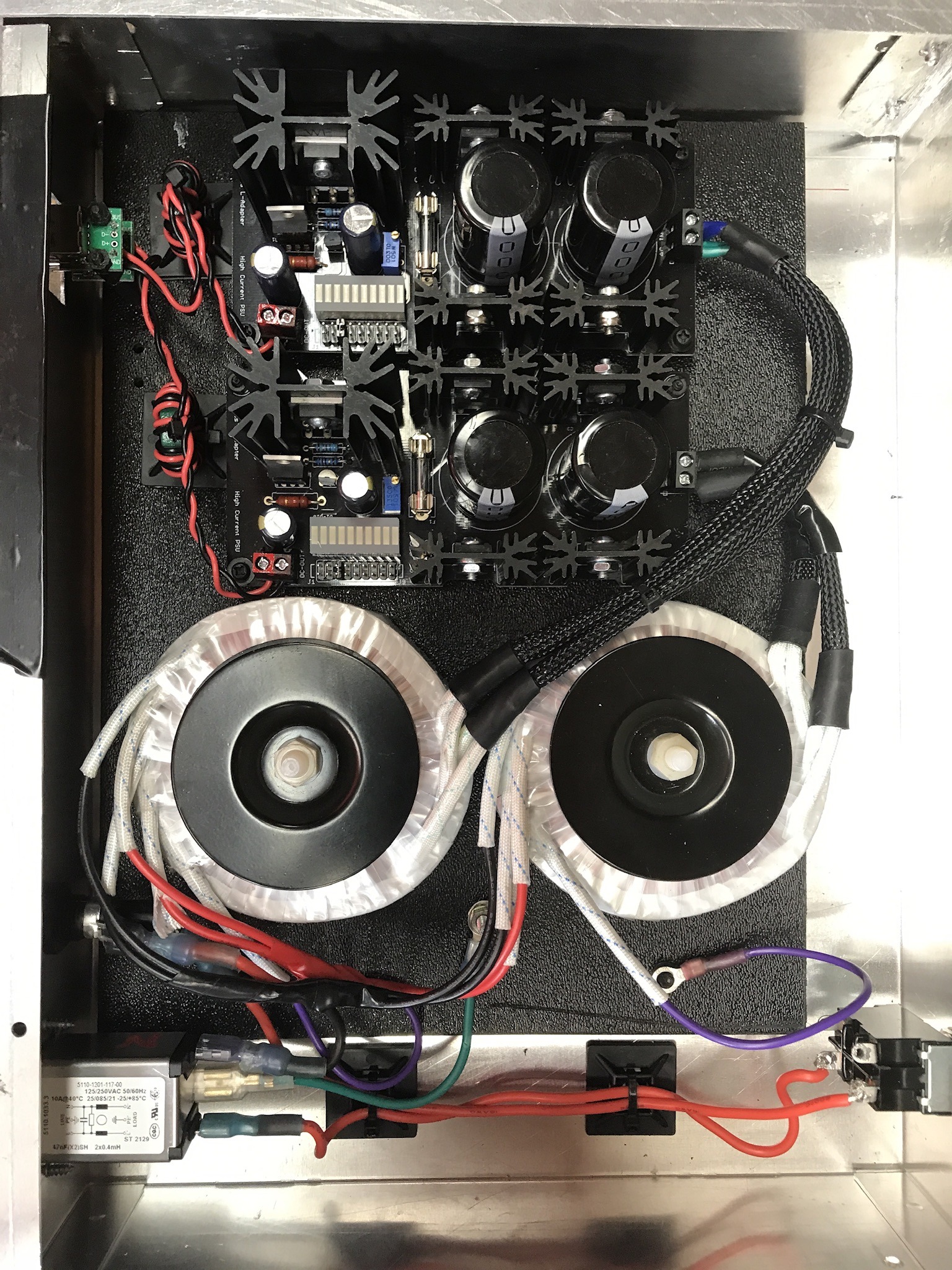

Hello again. The L-adapter build was straightforward, no issues! I’ve built the double PS/L-adapter using two 50VA toroidal transformers from Antek each with two 9V secondaries wired in parallel to the two L-adapters. The transformers are fed 120V through a Schurter filtered inlet, with its ground attached to the chassis. (The purple shield wires from the transformers are not connected to anything.) I am getting 5.0V output from the L-adapters, however I am also getting 45-50VAC between the chassis ground and the 9V secondaries, which I feel is not safe. Can you give me an ideas on how I should correct this?Of course It's possible to power multiple same voltage spec devices from a single power source.

@jdkinase,Hello again. The L-adapter build was straightforward, no issues! I’ve built the double PS/L-adapter using two 50VA toroidal transformers from Antek each with two 9V secondaries wired in parallel to the two L-adapters. The transformers are fed 120V through a Schurter filtered inlet, with its ground attached to the chassis. (The purple shield wires from the transformers are not connected to anything.) I am getting 5.0V output from the L-adapters, however I am also getting 45-50VAC between the chassis ground and the 9V secondaries, which I feel is not safe. Can you give me an ideas on how I should correct this?

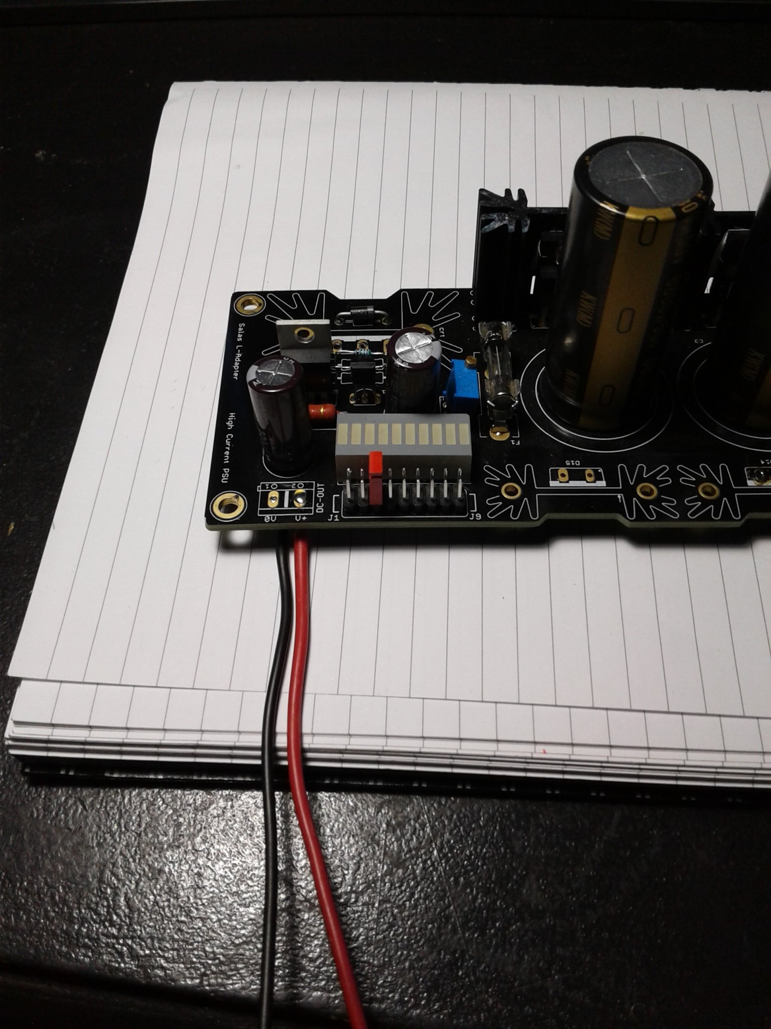

Looking at the picture I noticed that you have taken precautions by marking the polarity of the dc-out of the L Adapter using red paint for positive. I am attaching a picture of one of my boards and I show the polarity markings on the board outputs. The black wire is for ground(0V) and the red wire is for positive or 5V. Did you make changes to your board so that the polarity is reversed on the outputs? My note does not address your issue with the chassis ground and the 9V secondaries. Sorry.
@ktham. Good eyes! Thanks! Yes, I did change that after taking the photo.@jdkinase,
https://www.diyaudio.com/community/threads/what-with-toroids-earth.364148/@ktham. Good eyes! Thanks! Yes, I did change that after taking the photo.
Look at Posts 4 to 9 at the above link to answer the question on the purple shield wire. Connect mechanically and electrically both the transformer purple wires to the green wire from the IEC socket. Make sure that you have a solid mechanical bond between the fastener and the other side of the chassis and it should not be painted. A serrated washer on the painted side of the chassis will provide a solid and mechanical and electrical connection. You need metal to metal connection between the chassis, the fastener and wiring. Do the measurements again with a load on the L Adaptor DC outputs. Good luck.
But he addressed that.
Regarding the static shield wires they drain noise to chassis best when they are also kept short. Less length inductance allows more HF drainage. The secondaries are isolated from the chassis. Because connected to full bridge unipolar schemes. PSU ground is the output zero not the chassis/mains protective earth. Thus they legitimately float to some ghost potential vs the chassis. Until we reference the chassis to PSU zero directly with a wire or through a loop breaking circuit they won't be correlated. Like Yin Yang or bridge diodes safety ground lift. R//C bypassed. In case we get ground loop hum or something.

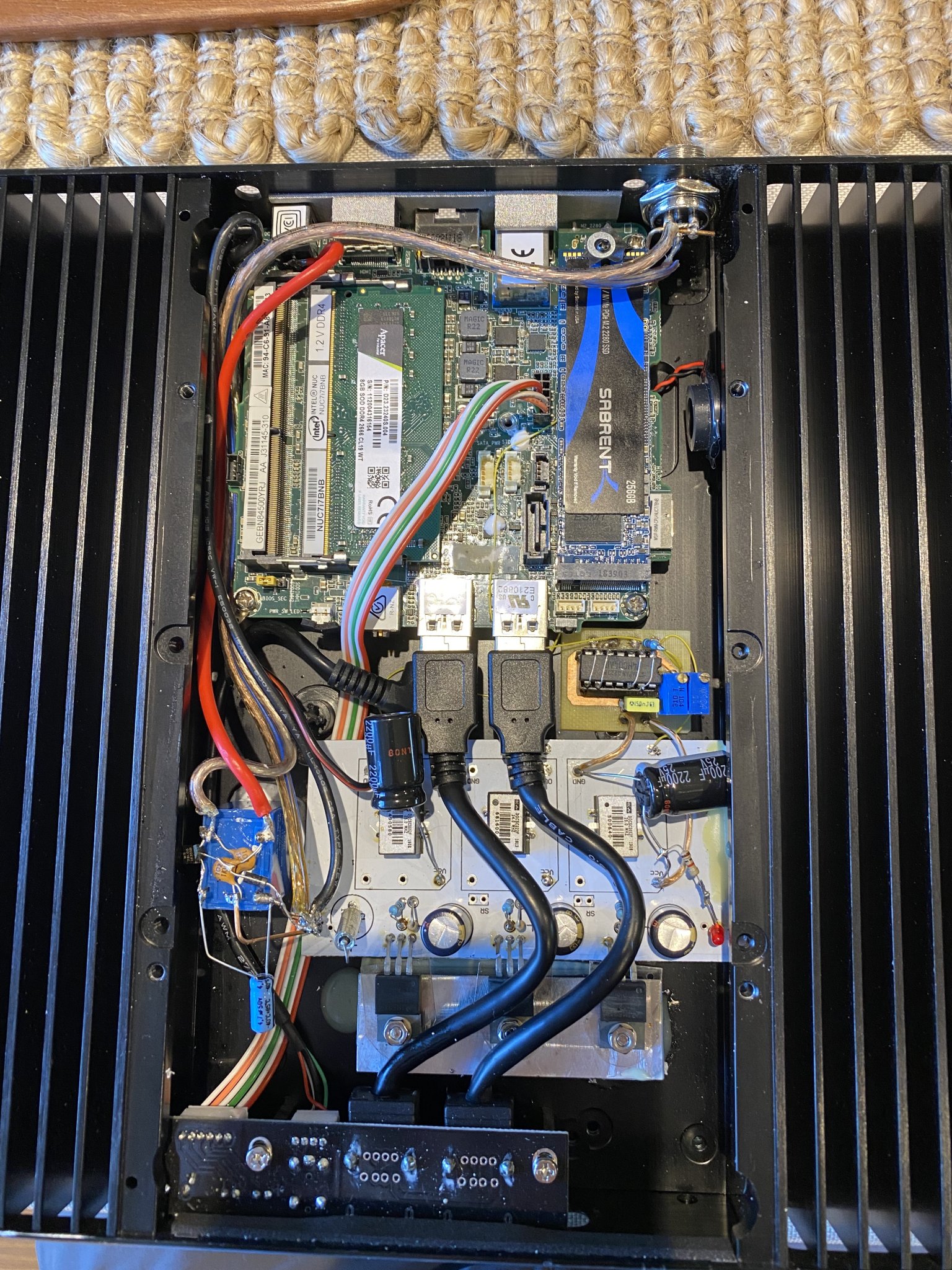

How good is the voltage regulation on L-Adapter?
I'm looking to power a NUC with it, that has max input of 19vdc and 3.6A - if I set up L-adapter for 15-18vdc output can I be sure that 19vdc input will not be breached if mains voltage happens to be higher?
Also, my NUC contains aftermarket Connor Winfield OCXO DOCSC master clocks. I have the option to power these separately, but would it be ok to power them all off a single L-adapter?
It's a bit of an odd arrangement in this used NUC I've picked up... for some reason there's a relay (Kam Ling KG1P-F) which both the DC jack (for the NUC) and 3-pin jaeger connector (for the Master clocks) connects into - thus the NUC needs two separate power supplies, or at least two feeds from a single power supply...

Hi, the L-Adapter follows an internal DC voltage reference. Mains voltage fluctuation does not govern it. Its LEDS play that reference role. In other words it can fall little below than where you originally set its DC output due to heavy transient loading (mainly because of output cables resistance) but it will not overshoot. Set the DC out when unloaded. Make sure you read the pdf guide from post #1. Has recommendations about voltage range, power, and what transformers to choose among other things like sinking.
You surely can branch out its DC output and L-Adapter will be OK with that.

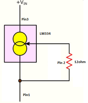

Thanks to Salas for a great product. I use the Ultrabib already with really good result. I have trouble understanding how to use the Lm334 regulator in this L-adapter. Is it as described in picture attached?
