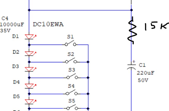

using L-Adapter to drive tube heaters… is there a way to obtain a slow turn on? Something around 3 - 4 sec.?

any suggestion about R value (roughly) to have slow turn on around 5 sec.?
15k to reach 6,3 at output in 5 sec?
this way the resistor ?

You can find RC time formula and calculator online. Digi-Key has a nice collection of online conversion calculators for instance.
But put that resistor horizontally between the LEDs and the capacitor to work right. Transistor's base stays at the RC node.
