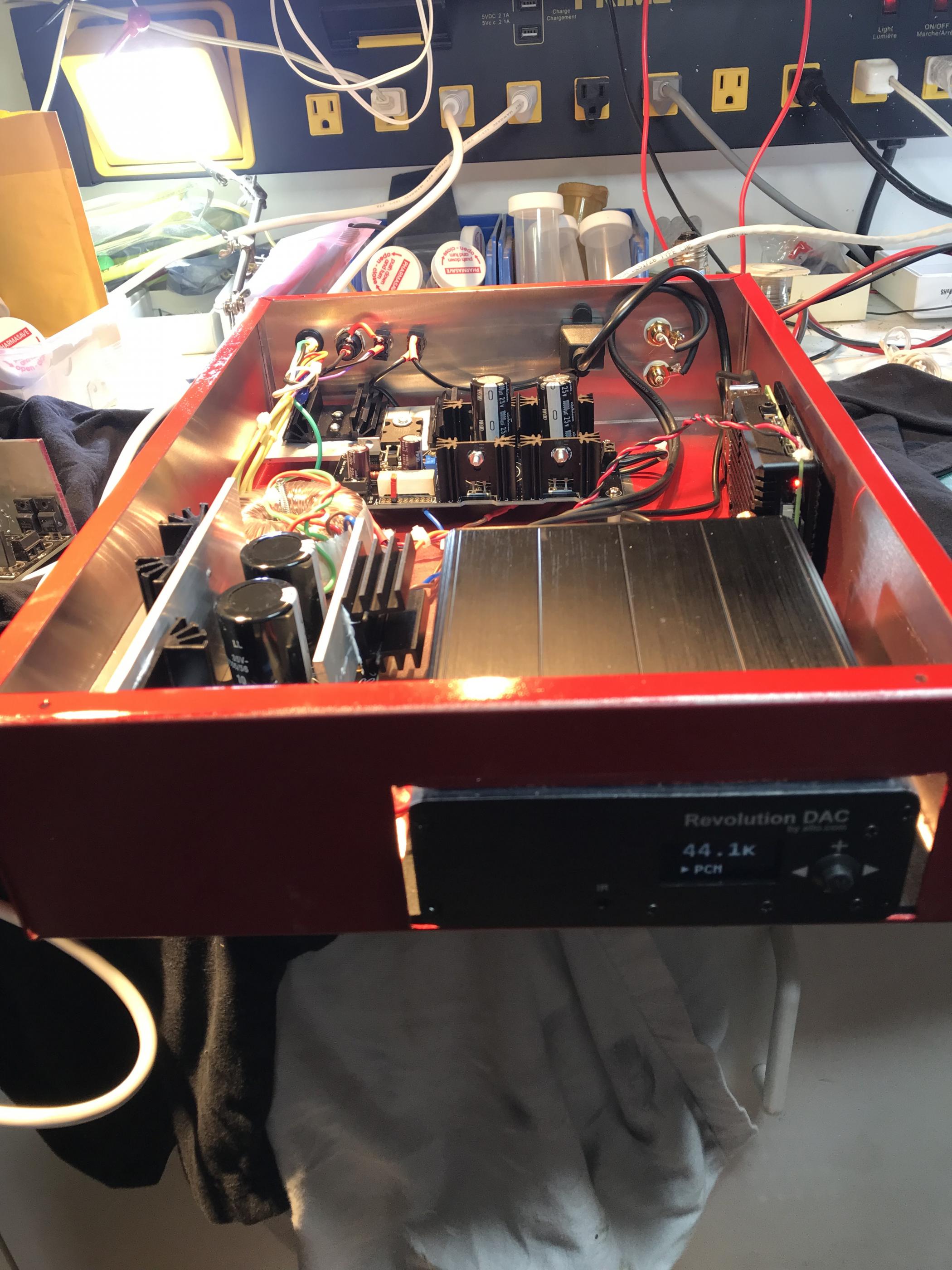

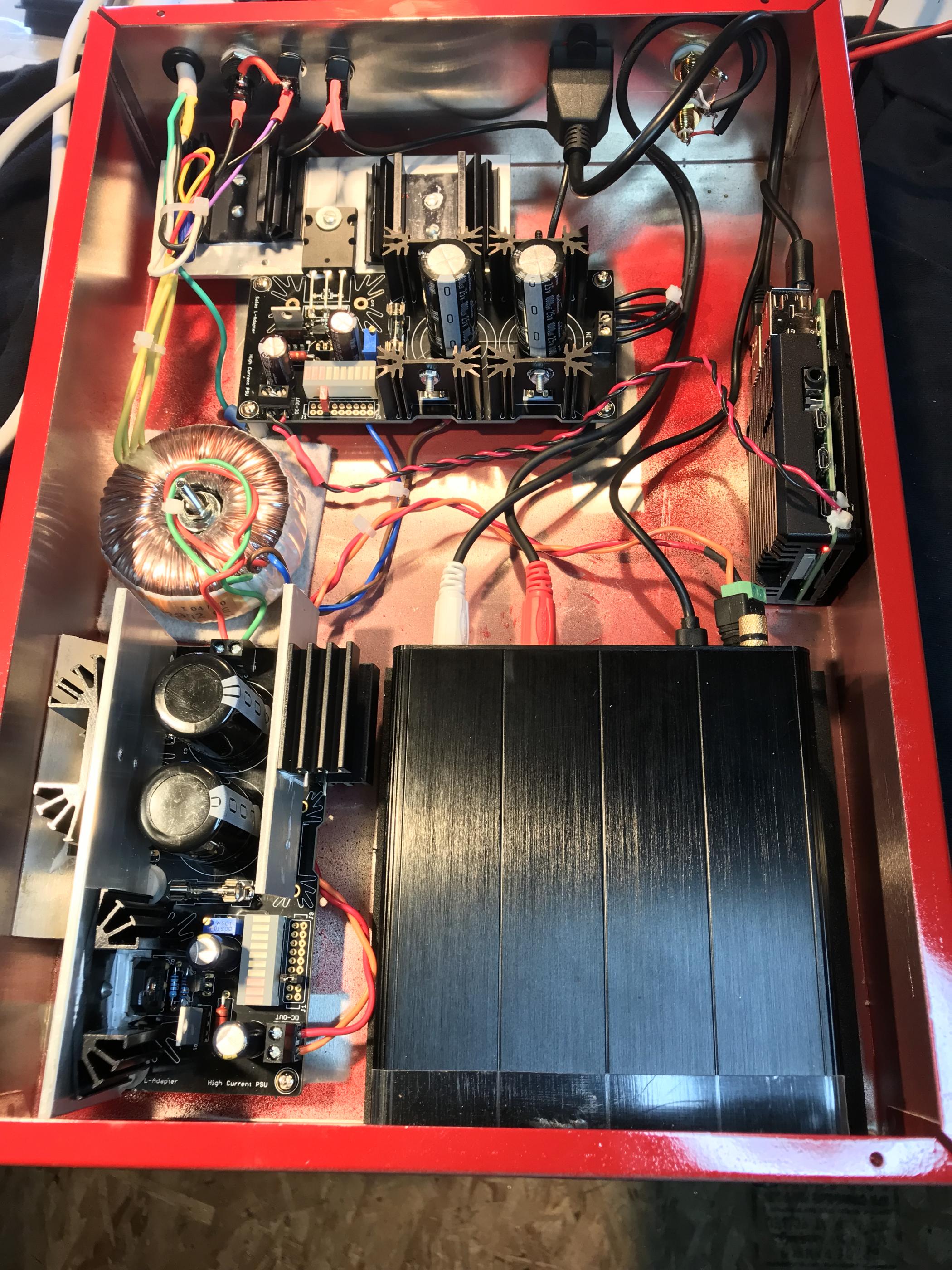

I have just completed assembly of my latest Rpi4 and USB DAC project using your L Adapter design and product supplied by Teabag. The L Adapter and UltraBiB are my key building blocks for DC power requirements and have proven to be very reliable. Thank you for sharing your skill and expertise.
Attached is a picture of my latest build with the Allo Revolution Dac and Rpi4. The heat sinks are my solution due to real estate issues within the enclosure. Regards.

You are welcome. Happy when designs give practical & reliable solutions to fellow members. You applied some interesting sinking combinations indeed. You even use a TO-264 package Q2 in the back L-Ad I see. Is it 2SA1943 or MJL1302A? I also see incoming black wires there but I don't see a second transformer. Spliced to the blue and brown secondary wires? How many VA is the photo's transformer and is it staying at an acceptable temperature?
For this particular implementation I use a dual secondary transformer (35VA) which feeds two instances of the L Adapter. One adapter uses NJW0302G for Q2 and the other uses 2SA1943. I use aluminium oxide thermal pads to characterize the heat dissipation for this particular enclosure since this unit will be left on 24/7. Initial power up sequence is Dac is on first when plugged in and then the Rpi4 switched. For system survivability I have similar power supplies so I can switch power easily for testing within the unit itself and also the other units in my listening eco system. Heatsink temperature is about 42 deg C and transformer is 35 deg C. Attached is a picture of my system. Regards.

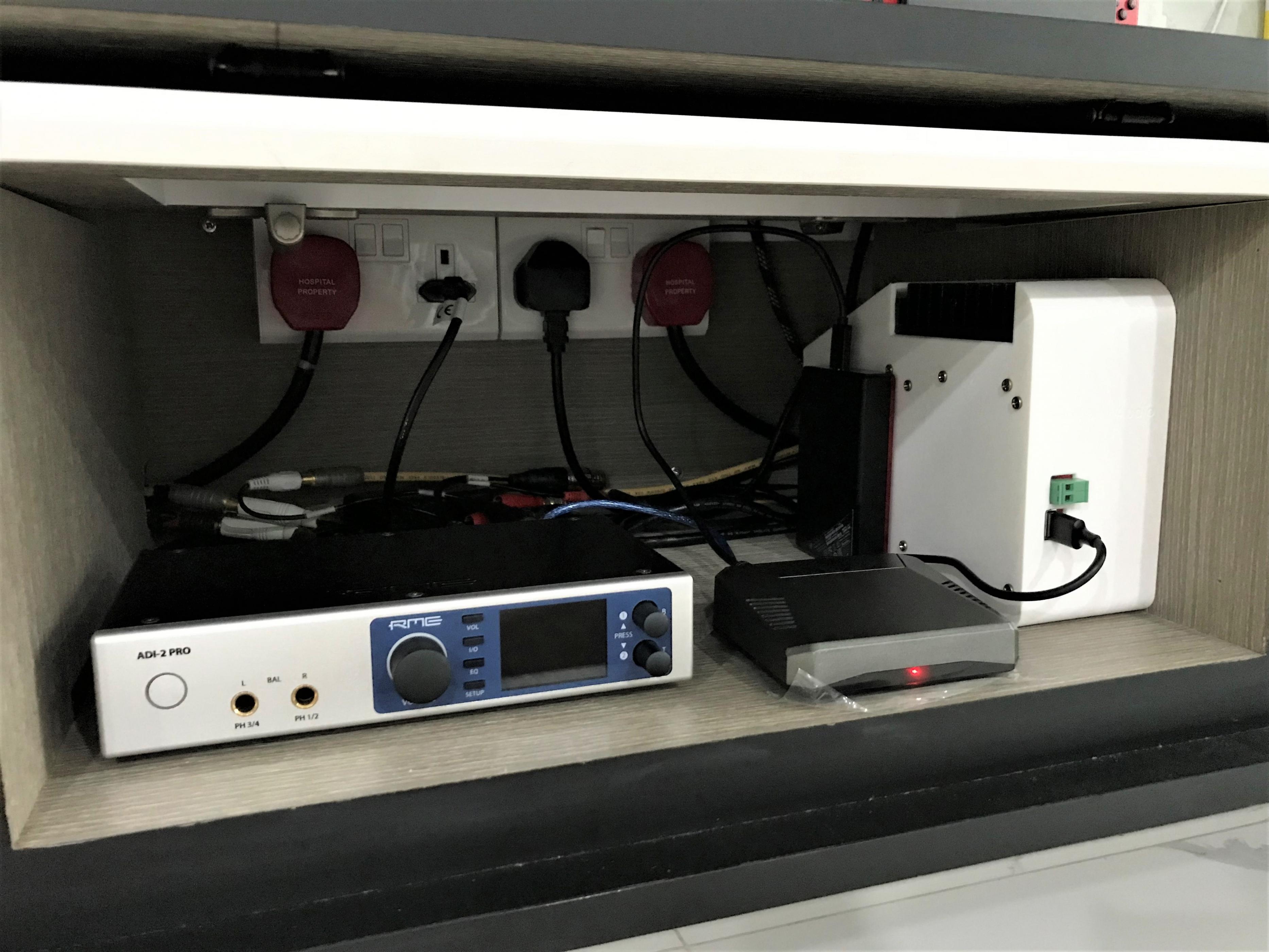

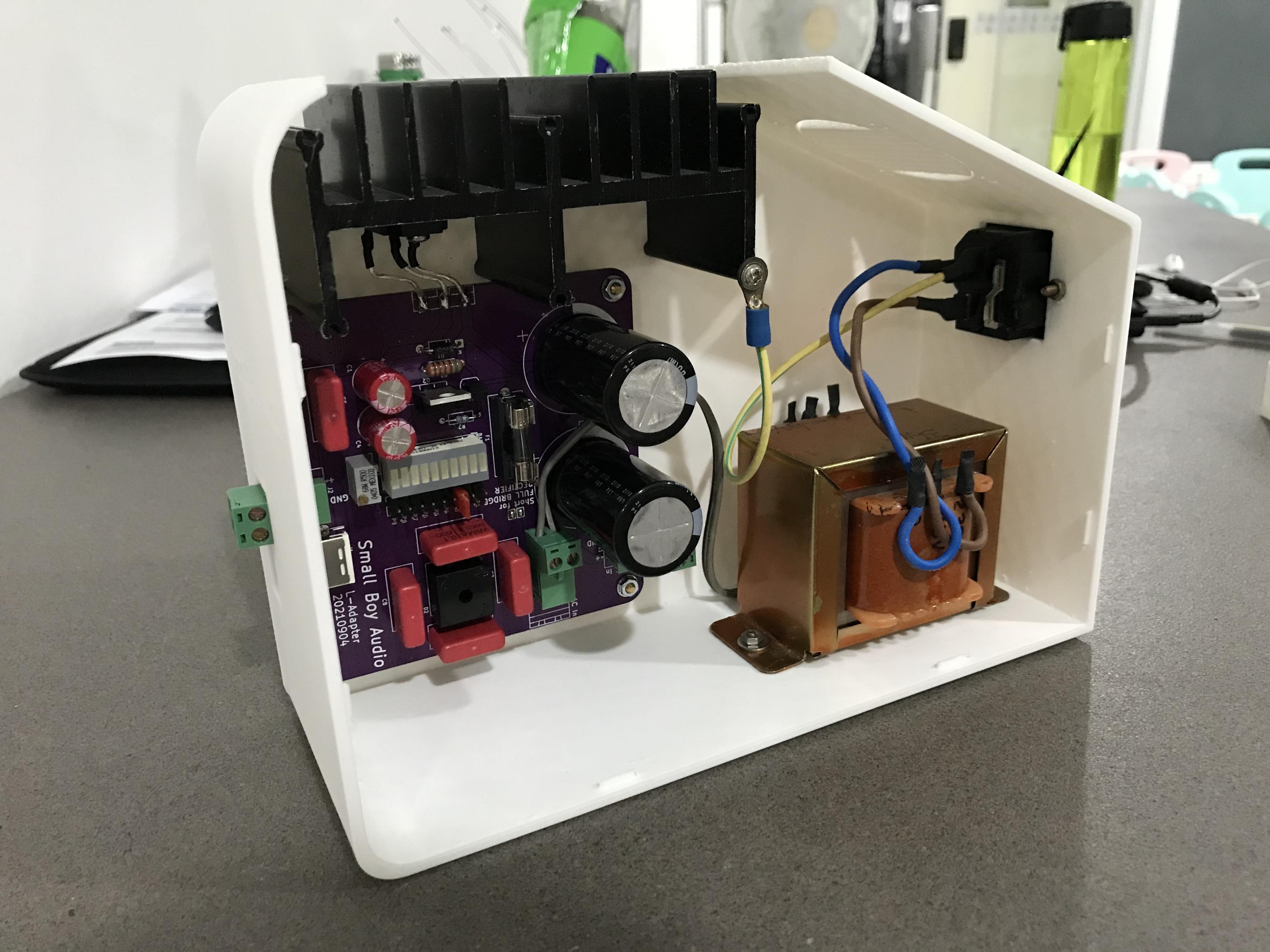

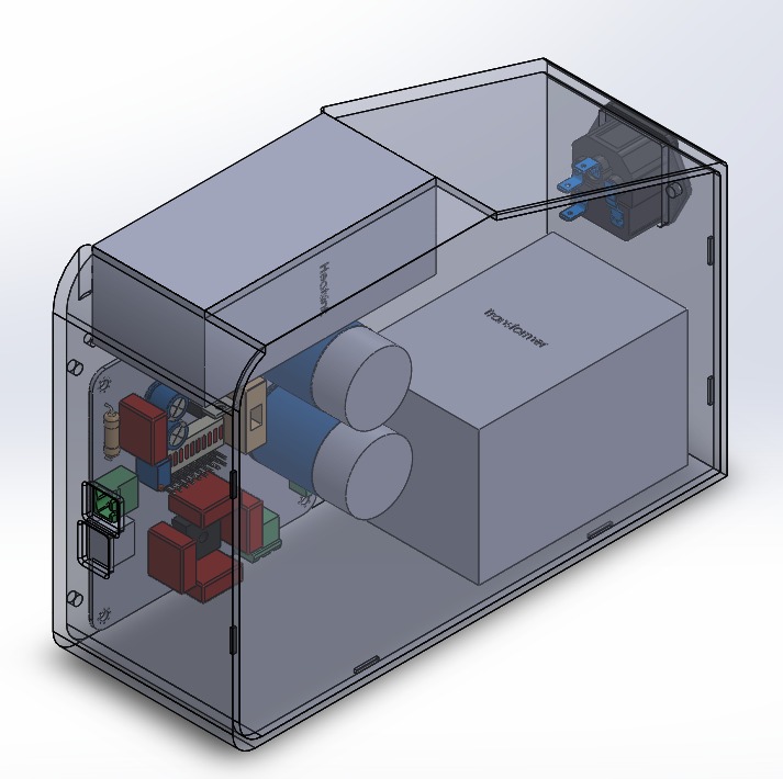

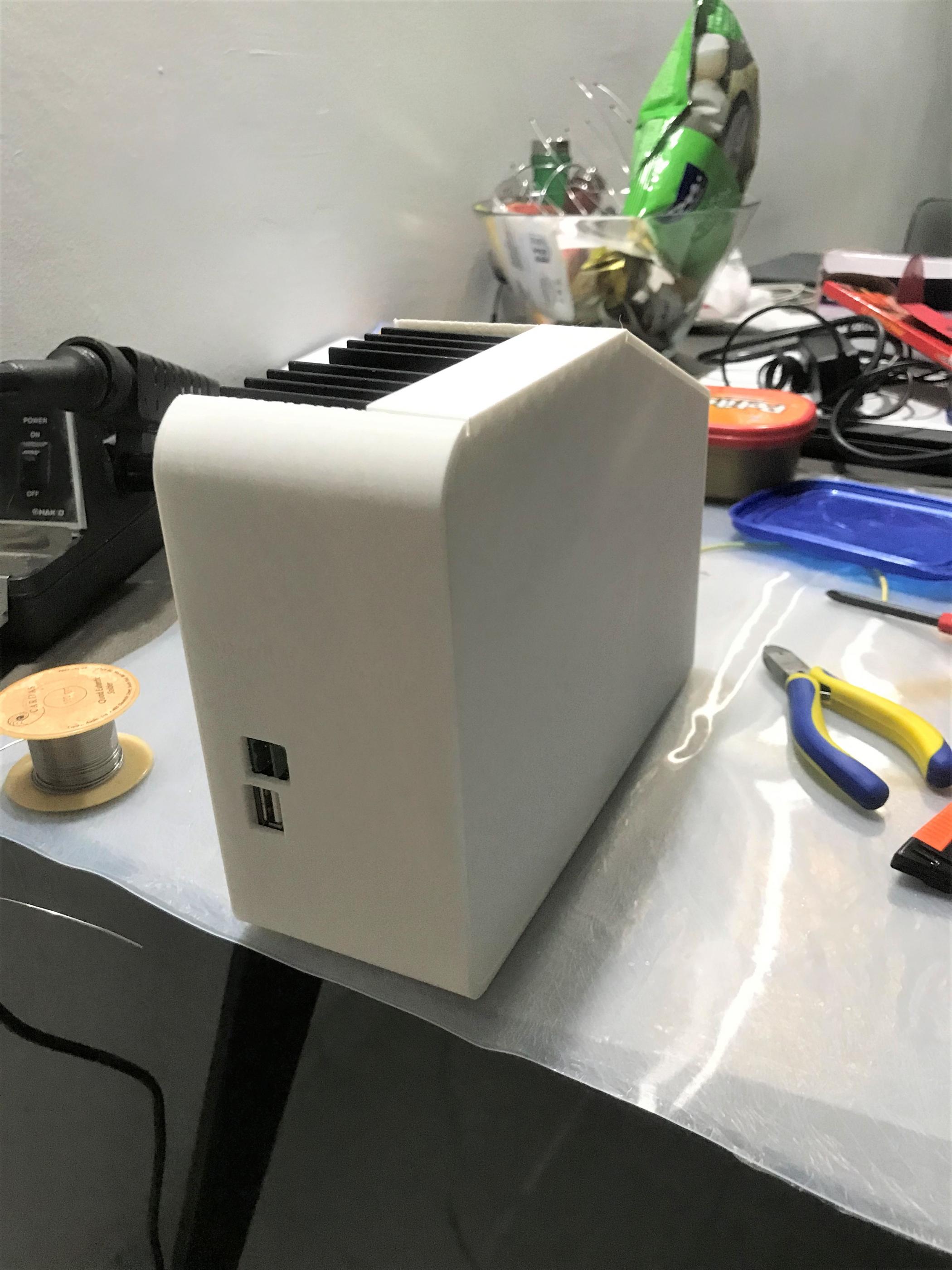

Hello Mr Salas,
Thank you for the excellent circuit that you have shared with us. I have built it and housed it inside a 3D printed case and the circuit has proven to be very reliable, supplying a RPI4 running Moode with a hard disk connected to it. Not problems at all even when playing DSD tracks.
Really appreciate your kindness in sharing your expertise!
Very nice 3D printed housing. Congratulations. That full bridge can not be on a sink as implemented and will have a lower dissipation limit than the TO-220 diodes on sinks. The original board sees to can also cover the odd very heavy loading stuff.
But to known moderate loads this integrated bridge allows for a "squarer" PCB. So all well in your application.

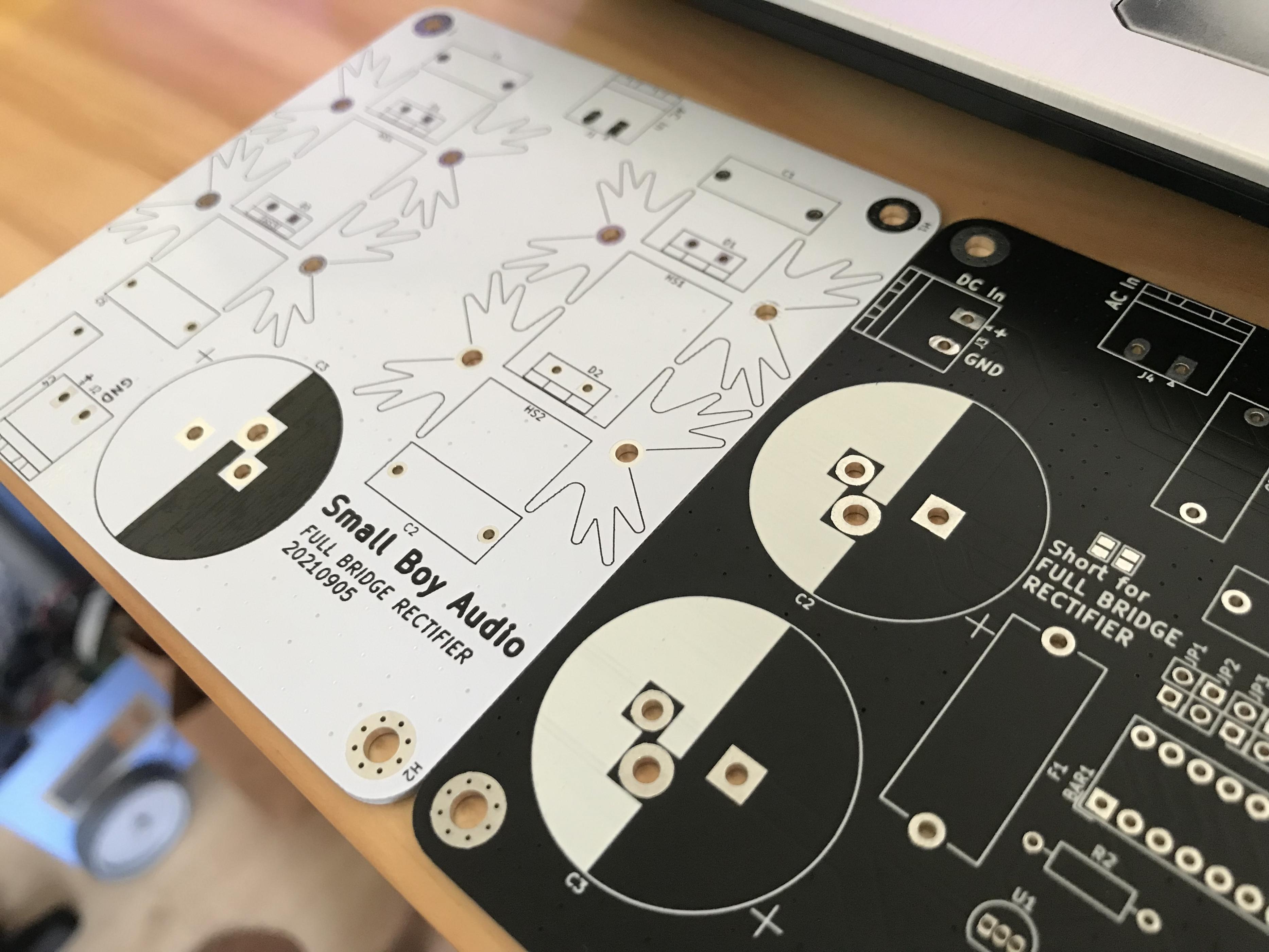

I made full bridge rectifier boards to go with your L-Adapter and on the L-Adapter, there is provision for the square rectifier to be bypassed. The boards are the same size hence they can be stacked nicely if needed to.
