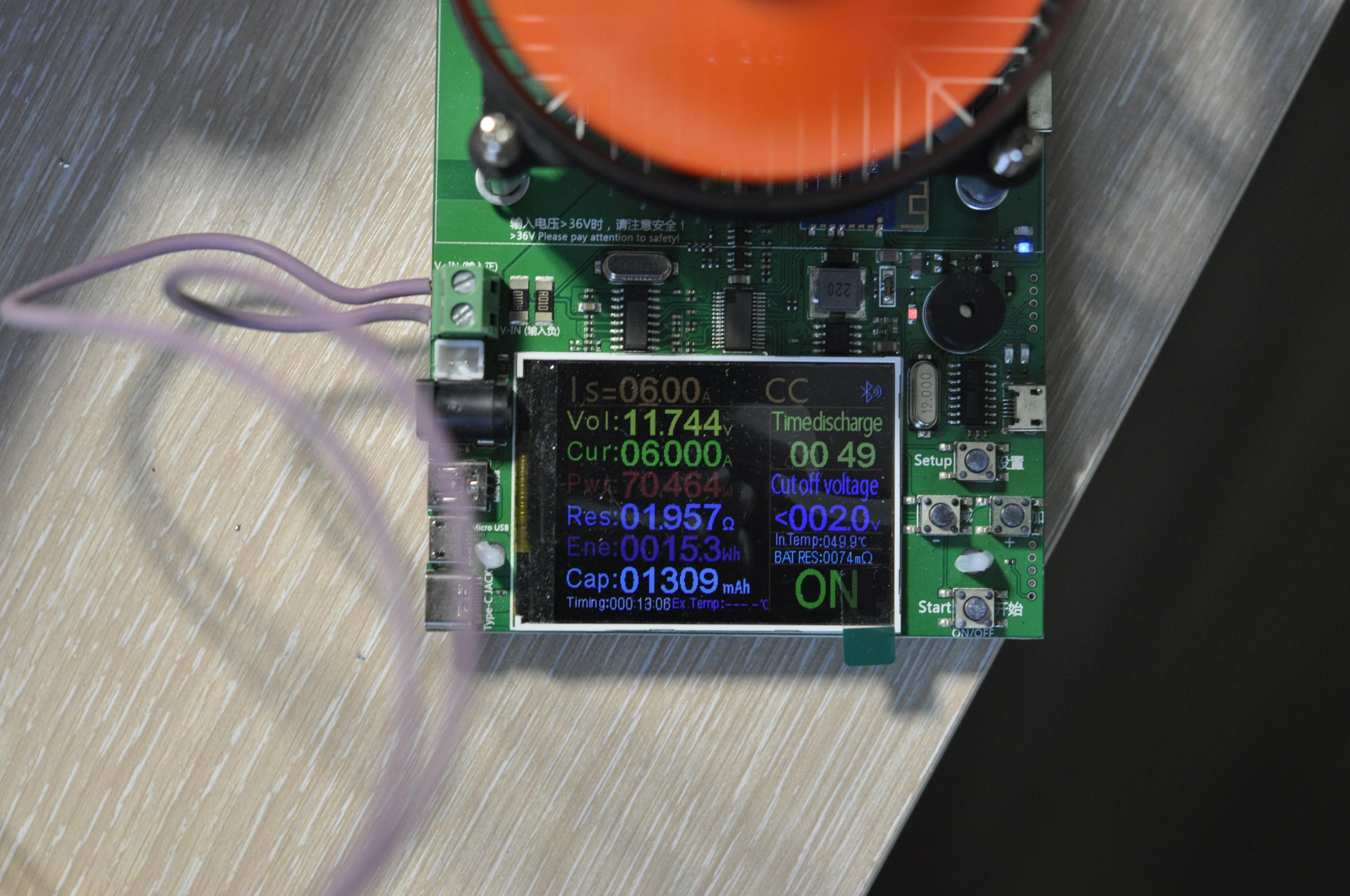

Q1 is a good size driver that burns about 200mW even when 5A passes Q2 so its not normally in danger. If you feel its in a hot place by other parts radiation and no good ventilation just measure its tab temperature with a contact probe. If often above 75C in your build put a mini clip-on TO-220 sink on it for better long term reliability.
That's a good deg thermal exchange state for 13minutes on 6A punishing CC electronic load. Will be even better when the fins stand right. Lets hope Kapton tape will last long as insulator in the build. Voltage drop is measured at the load I see, no Kelvin sense wires back to the output connector, so its real life including the output cables drop.
Correct practice experimenting with the meant to install cables length and thickness knowing the voltage tolerance to expect at their end between lowest to highest projected target load current.

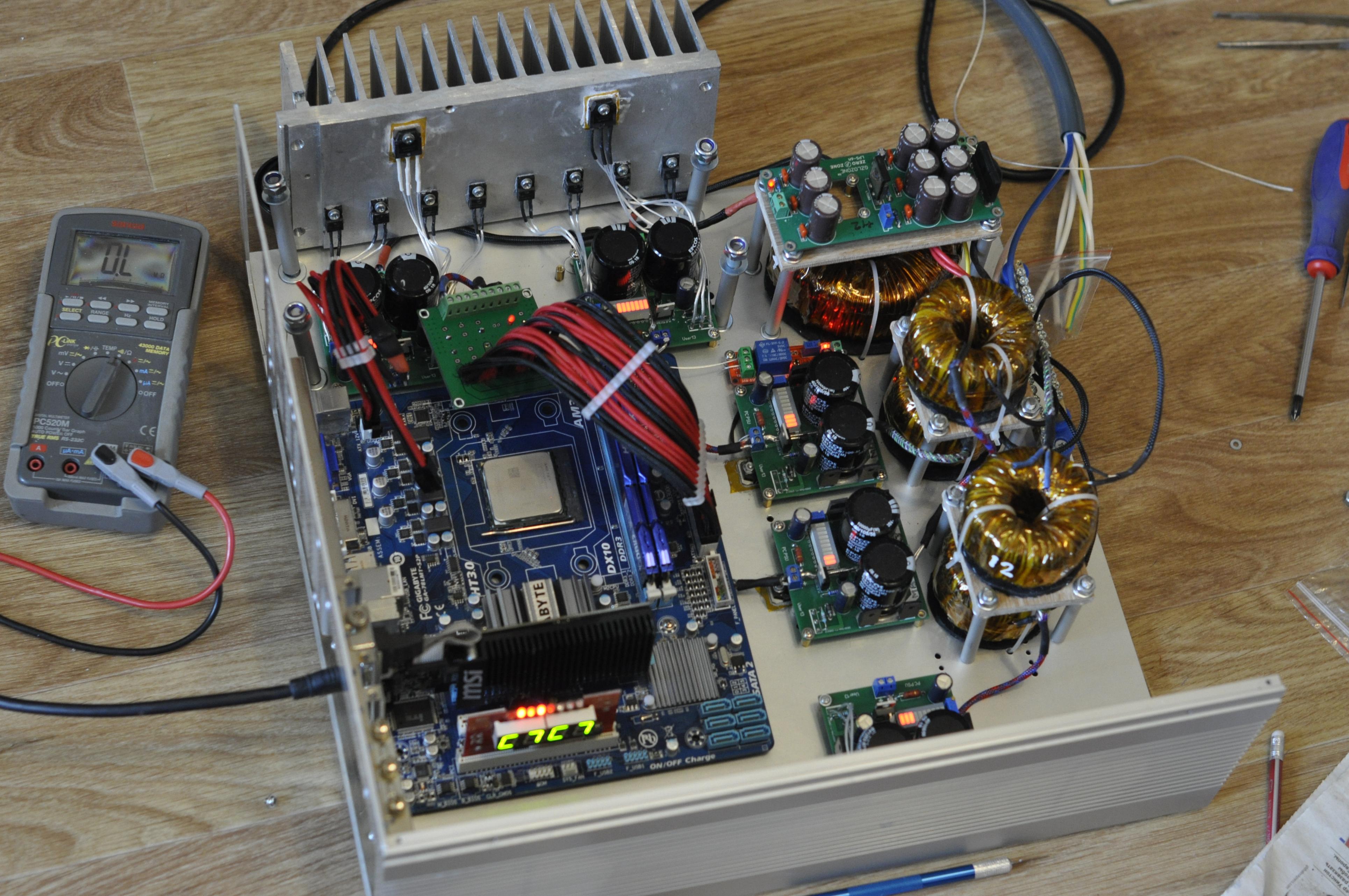

Quite a build. Congratulations. Nice its still stable with all those long extension cables. Proves itself a tolerant PSU. You wound the toroids yourself?
Yes, I took them ready and twick them for needed voltages.You wound the toroids yourself
5x L-Adpater in case...
What are the output values and what do you plan to do with this setup? 😉
+3.3, 2x +5, 2x +12. General HTPC + Jcat PCI-E USB card. All lines galvanic isolated, othough they has common ground.
Thanks for your reply bbest. I suppose that many will simply get a general purpose computer psu. HTPC requires silence.
