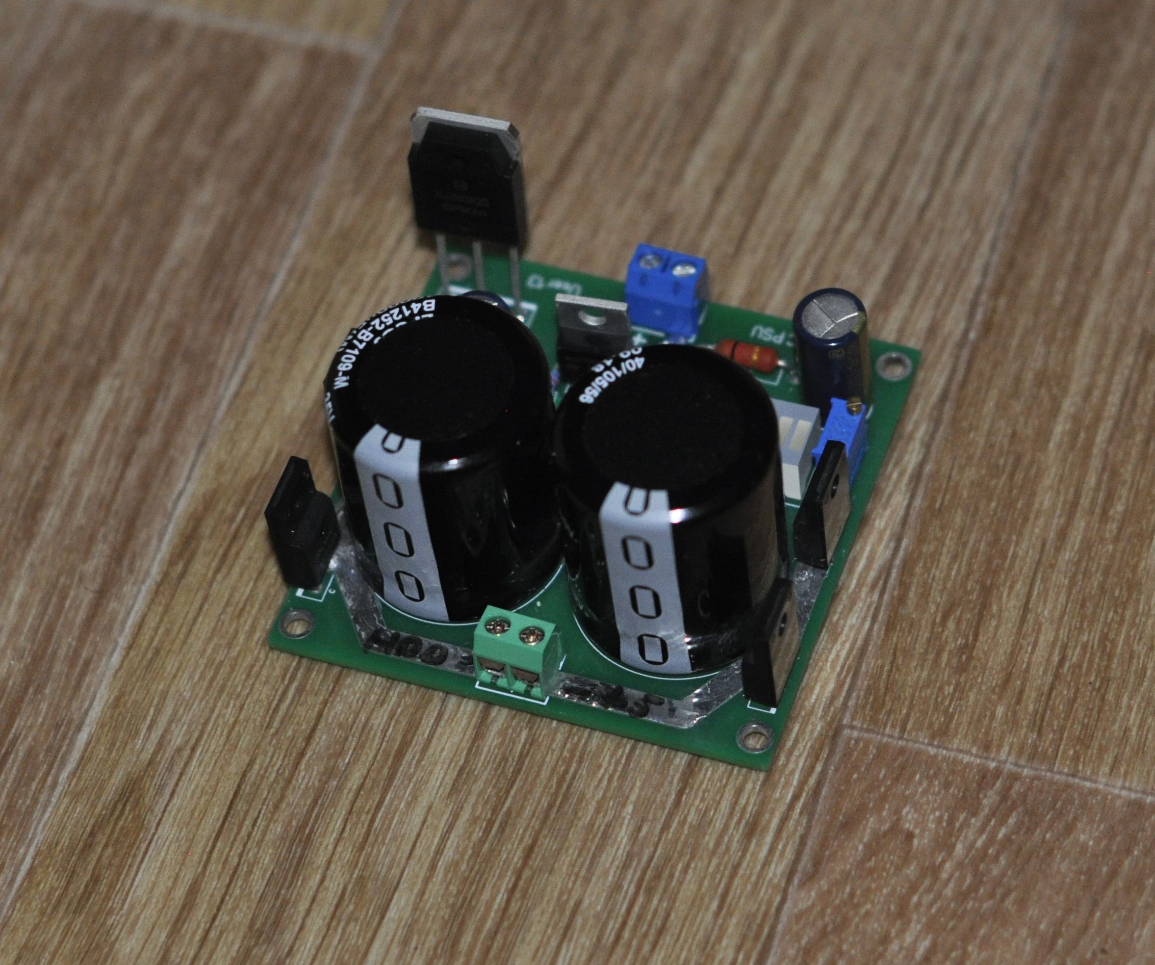

But I wanted to power simple micro ATX board with low power Xeon CPU + 21W Video card GT710. I has several L-Adapter boards.
Now testing +12V power for CPU. Tested: 1) 14V transformer, 2) 16V transformer, 3) 1A and +12V load, 4) 2A and +12V load. Always 50% efficient. I could use very large radiator, but if it could be 70-75% efficient (as you said), all will goes much much better.

Transformer now has 16VAC, capacitors 2x10000uF. I tried no load: 12.5V (it is ok for ATX specification). Then 1A load => 12V, also good. But for 3A it is 10.5V. How I could get more stable Vout? Raise transformer secondaries up to 18V or set larger capacitors = 22000uF or more? What you suggest for 4-5A?

Losing 1.5V output over a 2A difference step suggests 0.75 Ohm output impedance. Not the case in a properly executed and properly configured L-A. You should check two things each time.
First how much DCin to Q2 is eaten by Tx AC drop, Vf drop on bridge diodes, and AC ripple on filter caps i.e. pure DC Vin-Vout margin should not drop below 2.5V across D11. Second thing is that the loss over the output cables to the computer does not eat more than allowed. Read post#149 carefully as well as the "How to plan it" section in the L-A's pdf manual. Explaining how to predict, measure, and tackle those issues. Assuming that your L-A works as it should. Is it an original board or your development?

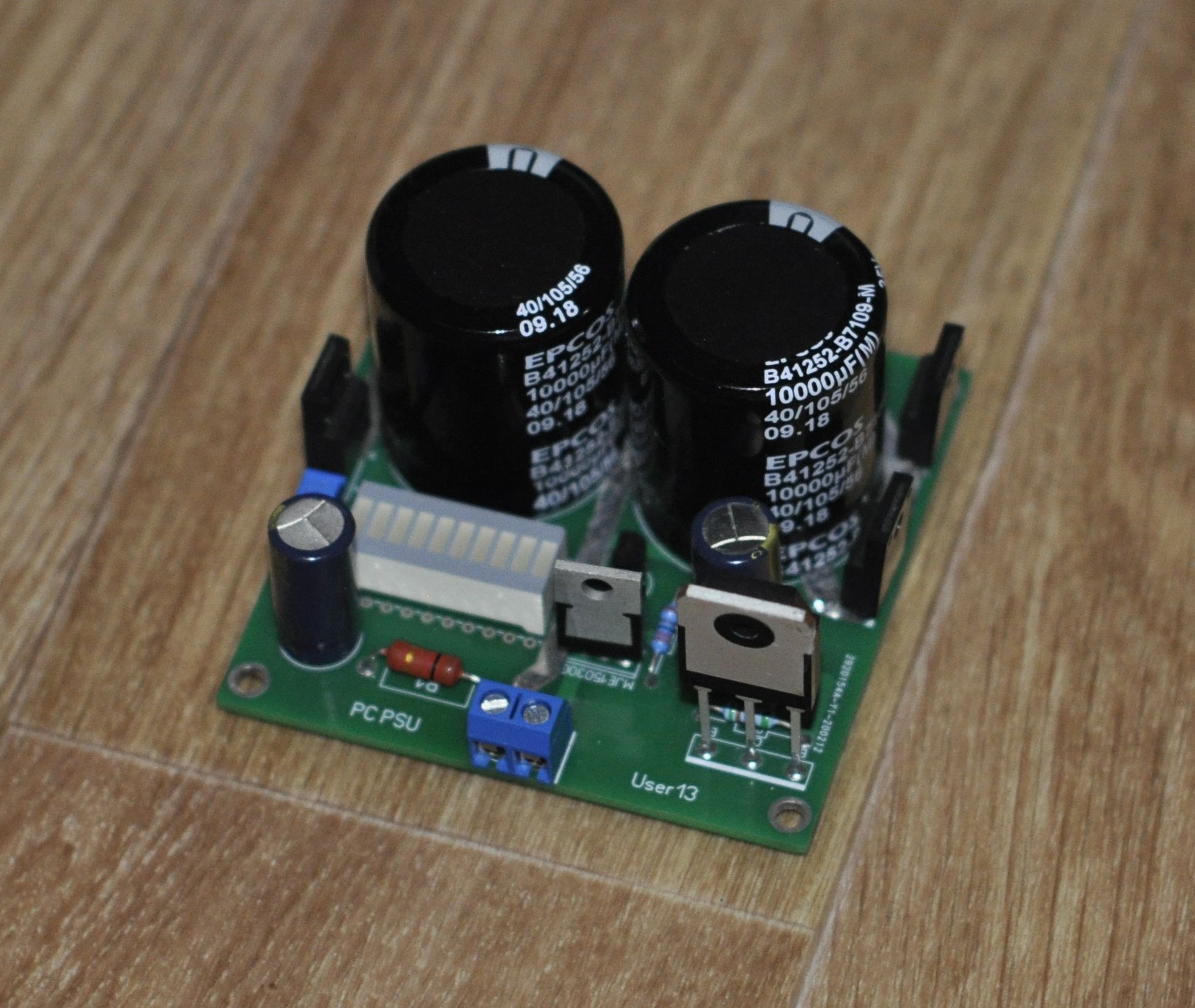

By the way make sure you executed IC1 R2 connection right as in LM334 datasheet.
As general you are right. I am relooking just now IC1, R2 (12 Ohm).
Is it right:
IC1: 1 V+ 2 R 3 V-
IC1 V+ to C4 +
IC1 R to R2 (pin 1)
IC1 V- to MJE15030G Base
IC1 V- to R2 (pin 2)
IC1 V- to DC10EWA -
diyAudio Chief Moderator
Joined 2002
You did the IC1 R2 tricky connections right but you mixed up the easy bit on Q2. Happy end, you found the error.
How you sink it now? Its in a difficult place. You put it on a large external sink with cable extensions on Q2 pins?
You skipped the fuse, is there a D11 reverse voltage protection diode at least? Is there a jumper row? Can't see.
Yes. Two of your boards: UltraBib and L-Adapter. In both made 1 error per board. Not bad for newbie. But for me it is a bit pitty, because I rechecked those boards several times.
Yes, extensions wires, there are no other variants. It will be very huge radiator inside PC case + 140mm coller on top for all PC components (mother board, CPU, L-Adpater's and so on). The most hotest elements on 5A current are diods rectifiers FFPF30UP20STU. For L-Adapter's motherboard (where will be low GPU) and CPU, all hot elements will be on radiator: NJW0302G, MJE15030G, FFPF30UP20STU. Other L-Adapters will be will general radiators on board.

Right now I rearange L-Adapters in computer lage case. Two Q2 will be on large radiator and other on case walls.
But what about Q1 MJE15030G. How you think - does it make sence to take care of it? Place it on computer case wall, even it will be 2A 5V?
