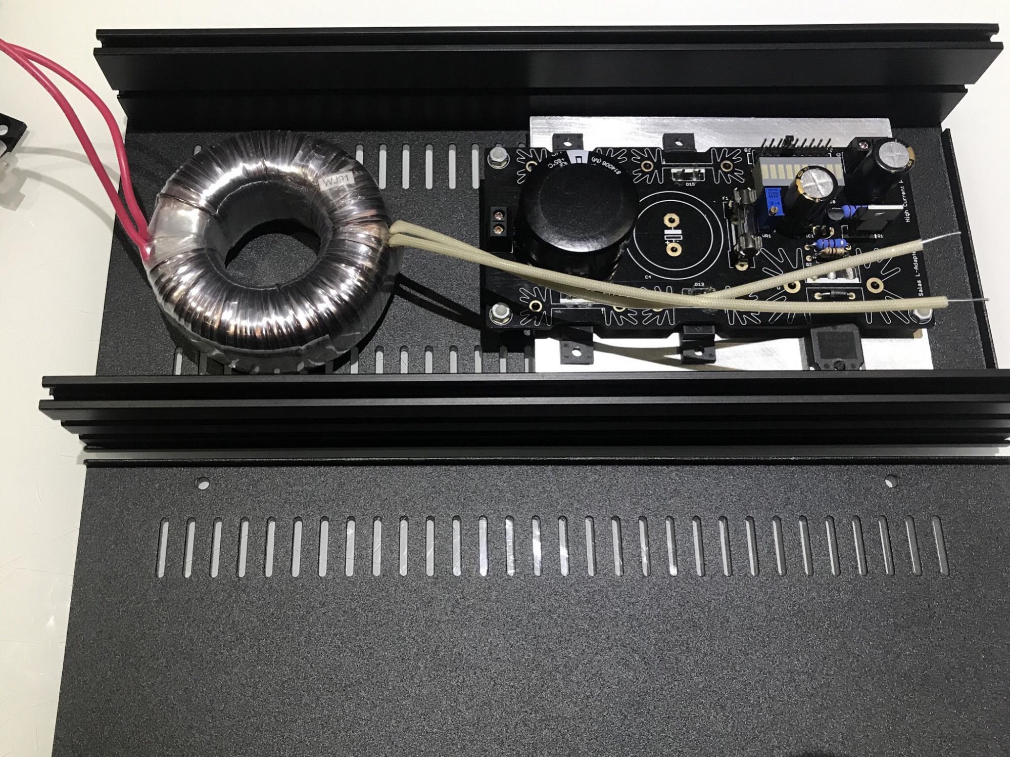

I have not seen anyone (or I must have missed out) using the chassis as the sink for the D12,13,14,15, I plan to use the FFPF30UP20STU, Rectifiers FAST RECOVERY DIODE/600V 30A for a RPI 2B. Not likely to go beyond 1A as I have underclocked it.
Thoughts?
Thoughts?
You may cool on chassis if for more uses but for the specific application (1A computer) they will survive free to air cooling easily.
Just curious, what current will start to require bridge / chassis sinking?
Depends on the load's pattern of consumption too. How much stress it puts to the PSU's reservoir recharging process how often. A more helpful answer is when you have higher than 65C on the diodes, sink them.

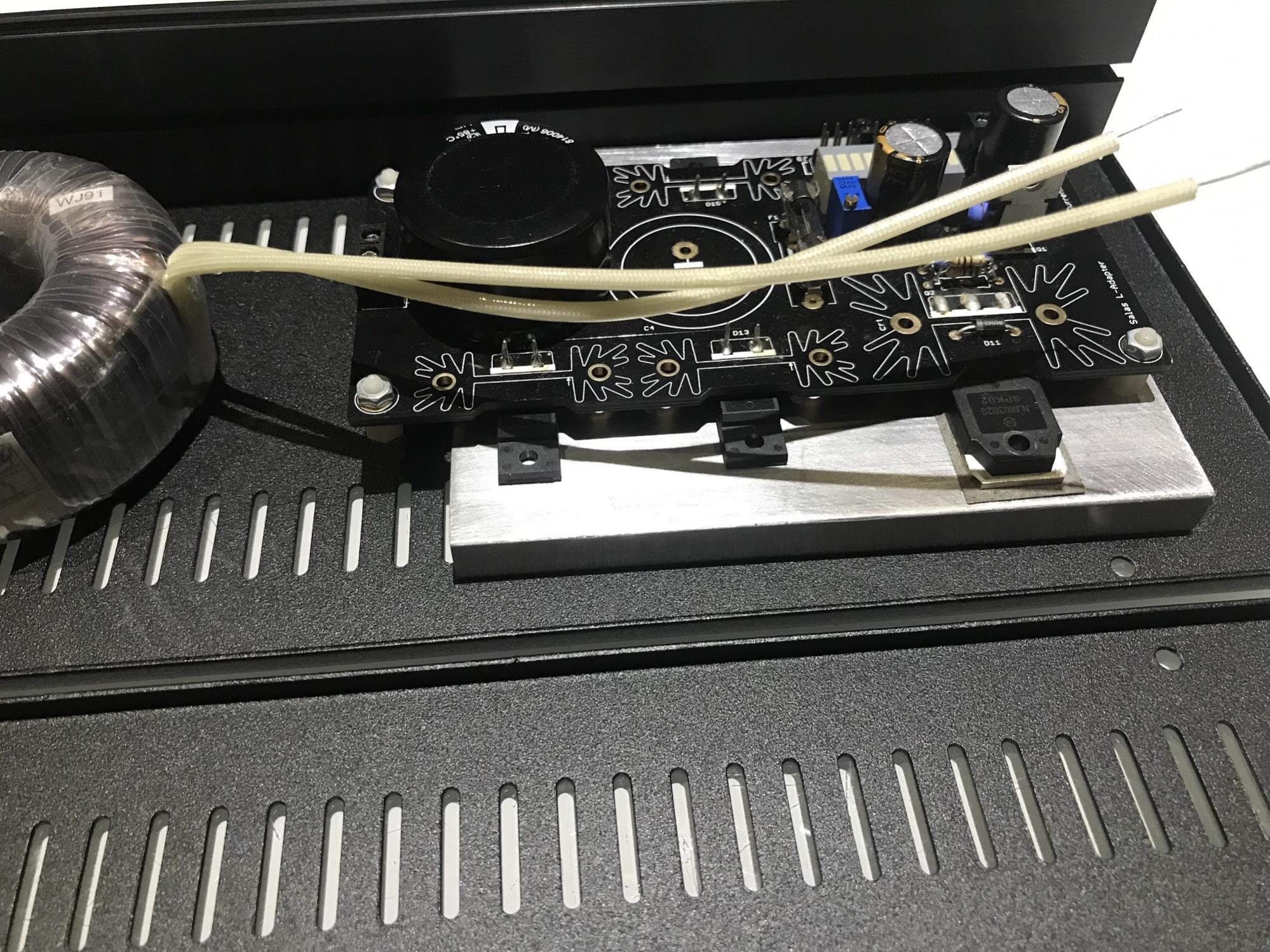

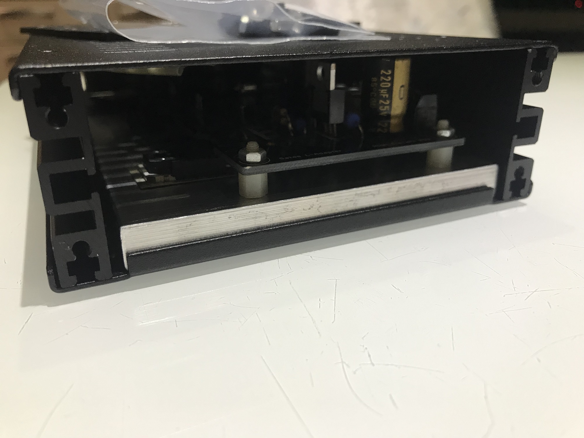

When you will double or triple the plate's surface area, plus it will be bolted to the chassis, the temperature should moderate a lot. Be generous with the plate's size. Because there are no fins.
There is a threshold in the sinking solutions after it they become saturated. When below that saturation threshold the temperature loses 10-15C kind of abruptly. Watch to have some top and bottom ventilation slots or holes in the final assembly.
what might be the optimal usage of case as a heatsink here?
1. Attach diodes and Q2 to inner sides? Forget about aluminum plate.
2. Attach them to 1cm aluminum plate and then screw it to the bottom lid?
3. Some better option?
case is 28 x 13 x 4 cm; aluminum plate is 12 x 10 x 1 cm
