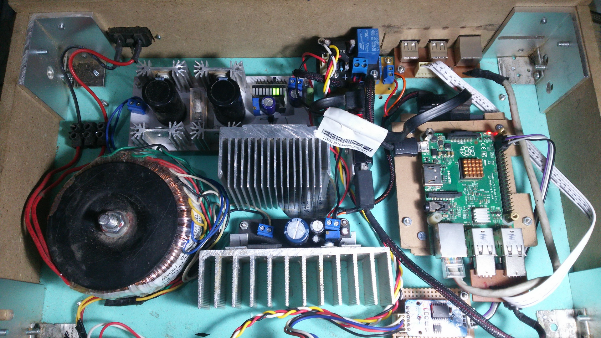

Thank you ...though all credit goes to you (and T-Bag!) for your superbly detailed instructions, support, and design !!
I am a rank amateur and understand very little of the theory... but know enough practical to muddle along and your answers to my questions have helped me to complete this project.
I am thrilled with the performance of both L-Adapters.

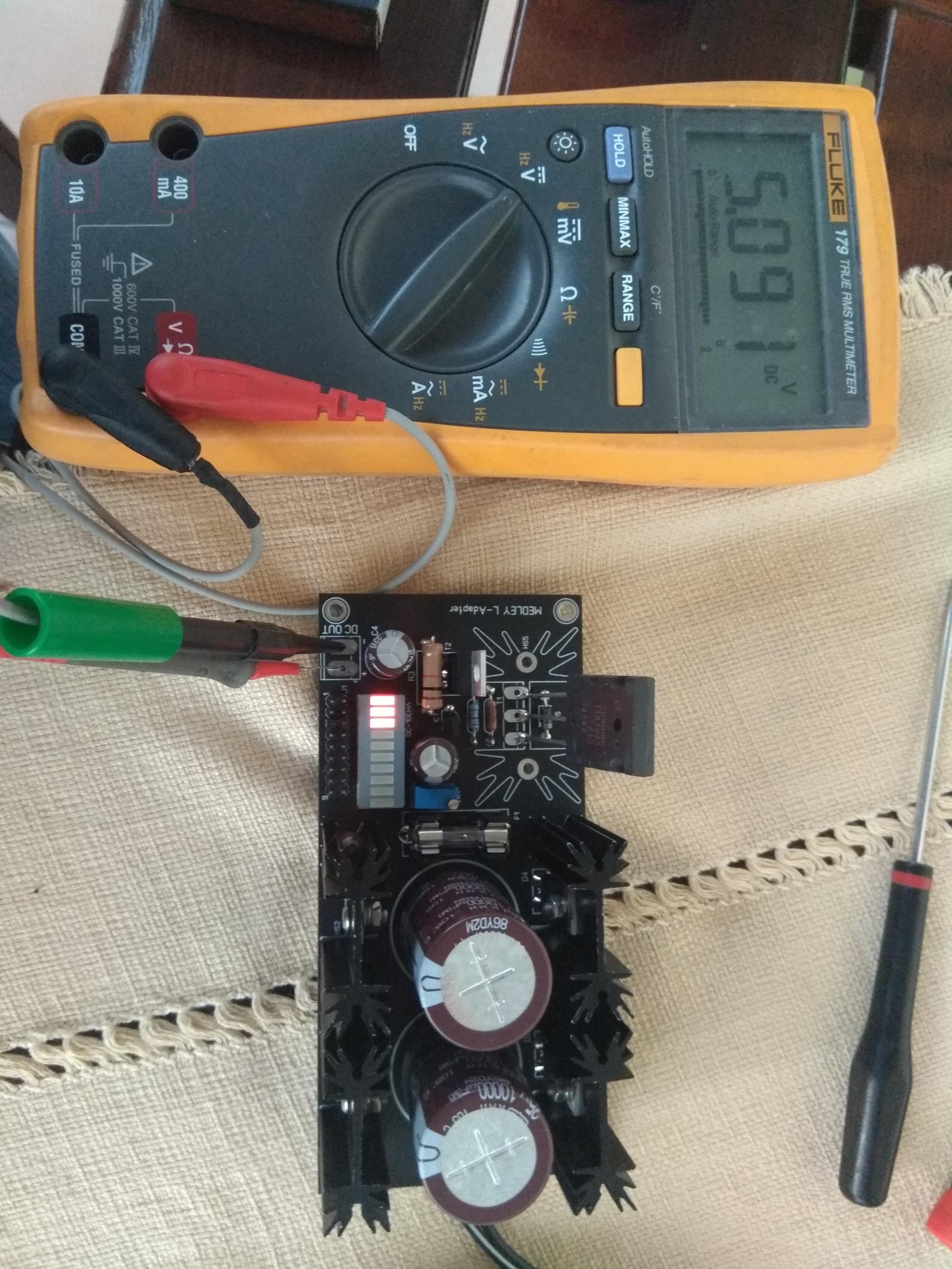

I have used 9v dc in as first test.
3 leds light(jumper set to 3) and trim for 5.090 Vout no load.
Then a 12R connected direct to L Adapter OUT.
I see 5.034 V out.
5.090/12=0.4A
0.4A*0.03R=0.012A
Is it something wrong?
PS now i see 0.03R is the out impedance at 1.5A😕

0.057V drop divided by 0.4A gives 0.1425Ω
I kept no lower loading data than for 1A and it was giving 0.035Ω there. Those big parts need a substantial current pull to wake up well. My output transistor was ON Semi NJW0302G mounted on a board level sink during the loading drop test. Sink the TOSHIBA 2SA1943 too not to burn it by some mistake.

Thanks Salas,2SA1943 is without any heatshink and not well soldered yet because this will be mount on the bottom of the box when ready.0.057V drop divided by 0.4A gives 0.1425Ω
I will try to test at 1A or so latter.
Mount on some plate or something for now. So you can test in higher current range with more realistic temperature both for good data and safety. I had tried with 2SA1943 too. Maybe it was little different for Zout than the ON Semi but not much. I don't remember the spot check numbers, but I remember comparable.

Liking the result? Does it really need such a big sink for RPi2?
Just tested without DAC. My Dac nit finished.
Not really, from test, it should be enough for 1A constan load.
It hard to cut the heatsink with handsaw 😀
