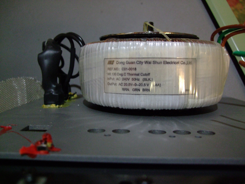

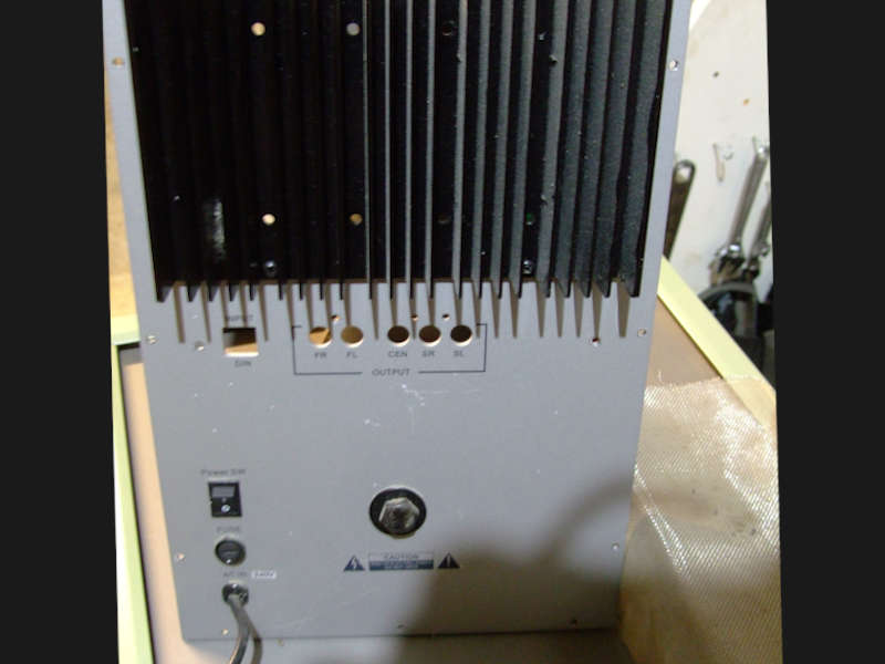

Yes 20.5v @ 6.4A ........ power supply and heatsink off a subwoofer rescued from the local 'tip-shop'....... 'untested electrical' @ $3 (US equivalent)
