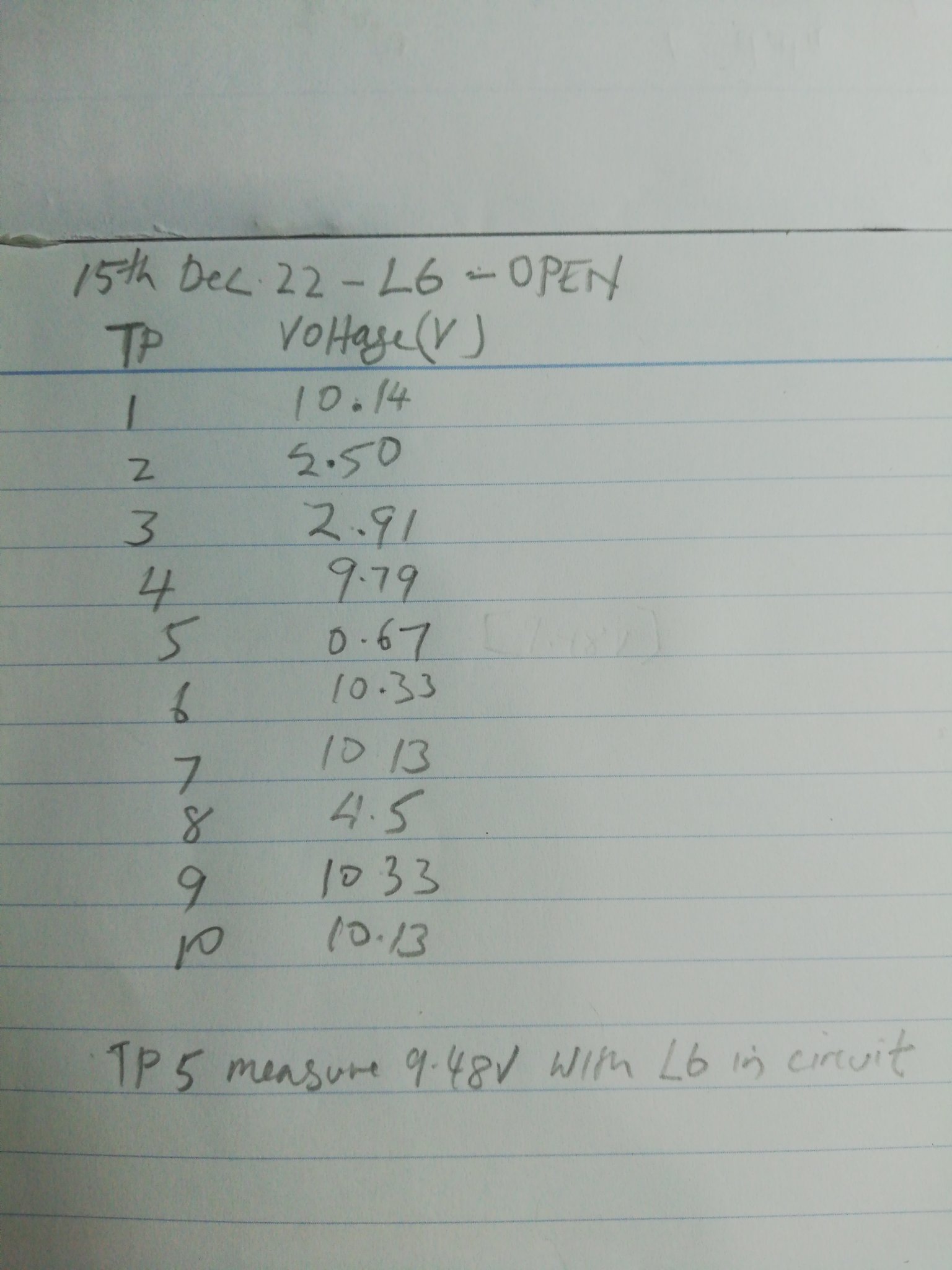

Sound record of static type noiseUnfortunately, after playing for few minutes, notice this noise that sounds like static coming from same channel. Will try to upload audio recording later
The static noise could be one of the DACs gone bad, investigate that by shorting pin7 to pin4 on each DAC chip in turn (I use a pair of tweezers for this) to see if the static noise goes away. If no success with that then you can eliminate stages one by one by taking the output signal from TP7 rather than TP10. To do this you'd need to connect R46 to Q9 instead of Q16 - this bypasses the NOS droop filter. If the static goes away from doing that then you know its the droop filter making the noise. If its still there, then it must be DACs or I/V stage.

I took output signal from TP7. Short pin4 and 7 of dac. The static noise persisted. BY implication the culprit is in iv section.The static noise could be one of the DACs gone bad, investigate that by shorting pin7 to pin4 on each DAC chip in turn (I use a pair of tweezers for this) to see if the static noise goes away. If no success with that then you can eliminate stages one by one by taking the output signal from TP7 rather than TP10. To do this you'd need to connect R46 to Q9 instead of Q16 - this bypasses the NOS droop filter. If the static goes away from doing that then you know its the droop filter making the noise. If its still there, then it must be DACs or I/V stage.

All of the DACs, one by one?I took output signal from TP7. Short pin4 and 7 of dac.
Not necessarily as that was a quick check which catches many DAC problems but not all.The static noise persisted. BY implication the culprit is in iv section.
I suggest next step is disconnect one pin of L6 and listen again. If the DACs are the source of static, it will disappear with L6 out of circuit.
l connect output from TP10 to an amp and then ground pin 7 of the TDA1387 , one by one for testing. The Kubeik is powered during testing.All of the DACs, one by one?
Do l have to take output from TP7 and then repeat the test of shorting Pin7 of TDA 1387 , one by one ?
BTW is pin7 is the Iref pin and is floating in this circuit ?
L6 is the big inductor with 4 pins soldered. Can l substitute by removing R40, 2k resistor ?
l connect output to an amp and then ground pin 7 of the TDA1387 , one by one for testing. The Kubeik is powered during testing.
Yes, correct. By setting it to 0V a DAC is effectively disconnected from the circuit. But some damage to DAC chips disables this function.
Only one pin needs desoldering - one with a wire connected to the coil. Removing R40 is almost as good as disconnecting the inductor, but you may damage R40 in the process.L6 is the big inductor with 4 pins soldered. Can l substitute by removing R40, 2k resistor ?

That indicates that one or more of the DAC chips have gone bad. The way to find out which is to lift pin6 (L output) on them, one by one.
If you have an oscilloscope, it would be worth checking that the digital inputs to the DAC chips look correct (pins 1,2 and 3). There is always the slim possibility that the input buffer is damaged but seems rather unlikely as you're only getting static on one channel. Normally a problem with the inputs affects both channels.
Another possibility is that one of the current source transistors has gone bad (Q17, Q19, Q27, Q28) - that would normally show up on the TPs as a shift in offset, but not always. Are all the TPs for L channel correct now with silence playing?
Can l lift pin 4 or pin 5 instead of pin6 because it is easier to do?That indicates that one or more of the DAC chips have gone bad. The way to find out which is to lift pin6 (L output) on them, one by one.
I haven't tried that so I don't know what the result would be.
For lifting pins I've used sharp-pointed tweezers which have curved ends (not the straight type). Get the sharp point behind the pin, right next to the package. Apply the iron to the pad and move the pointed end away from the package. This flicks up the pin from the pad, leaving a gap between it and the pad.
I think perhaps the next step (because its easier than lifting DAC pins) needs to be checking the current sources as they could be the source of the static noise. Please measure voltages across the following resistors : R2,R66,R57,R58. L6 needs to be in circuit for these measurements.
Do l need the i2s pins to be active for these measurements ?I think perhaps the next step (because its easier than lifting DAC pins) needs to be checking the current sources as they could be the source of the static noise. Please measure voltages across the following resistors : R2,R66,R57,R58. L6 needs to be in circuit for these measurements.
