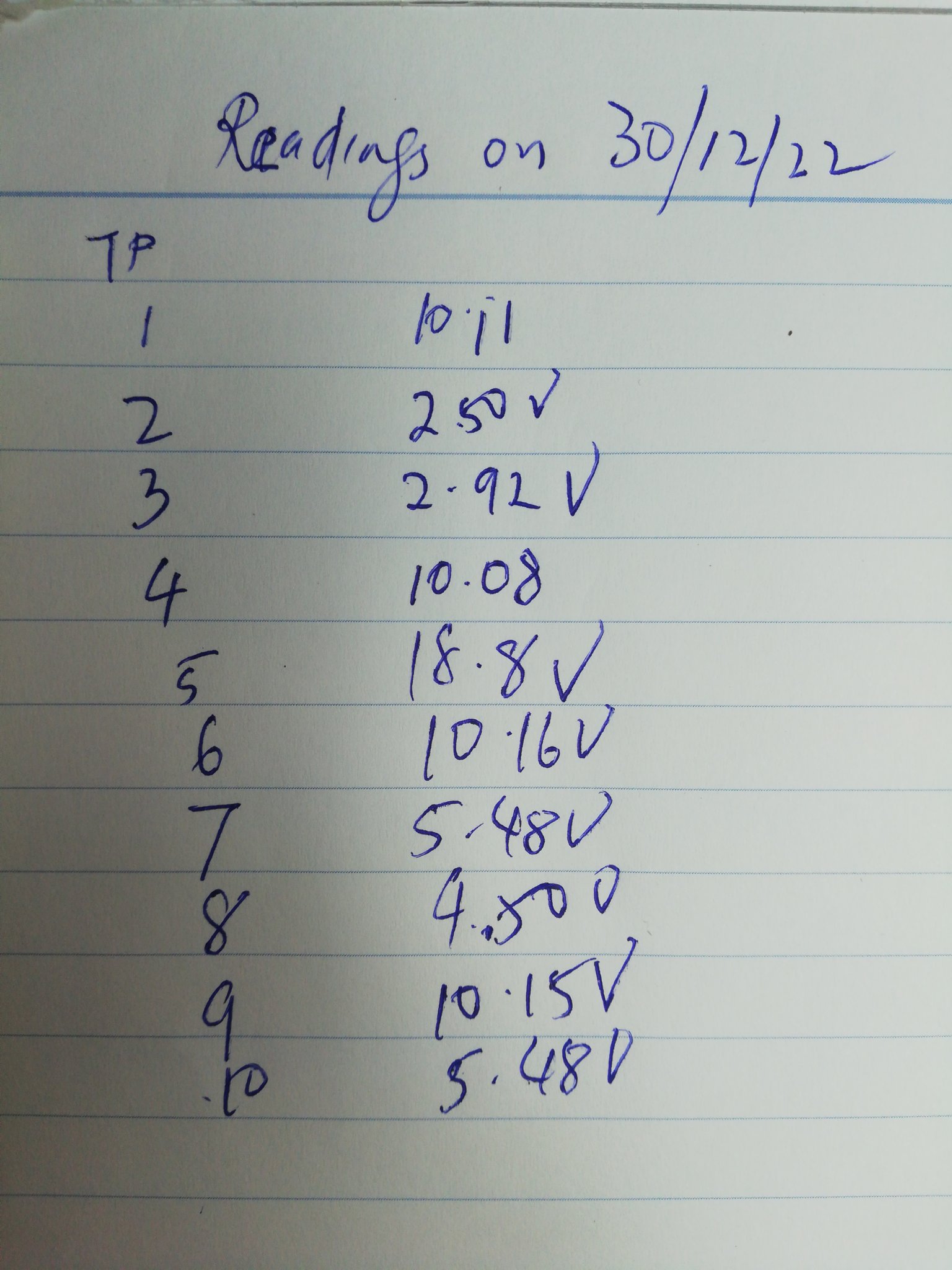

Hooked it up to a power supply today, all the voltages checked out...
So I completed assembly of my Kubelik - just have to wait for the Bluetooth receiver to arrive now.

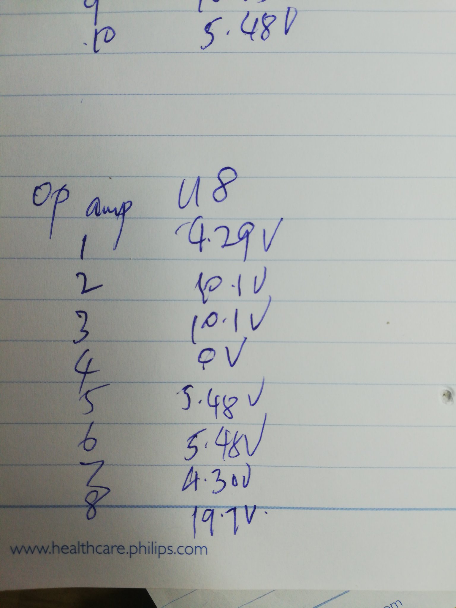

Are those readings with I2S playing into the DAC? The U8 opamp seems to be working fine (its + and - inputs are at the same voltage) but there is an offset at the output which seems larger than normal DAC operation would expect (between +7V and +13V at TP7). The offset could be from the current source transistors (Q17,Q19) not functioning correctly.
TP5 is showing a serious fault condition at 18.8V - its worth checking that R37 doesn't have any voltage drop across it. If it does, that would indicate a failure of the MOSFET Q14. U8 running hot is a significant concern - check its output current by measuring volts across R32 and R63.
When powered up, no voltage across R32, R63 and 37.TP5 is showing a serious fault condition at 18.8V - its worth checking that R37 doesn't have any voltage drop across it. If it does, that would indicate a failure of the MOSFET Q14. U8 running hot is a significant concern - check its output current by measuring volts across R32 and R63.

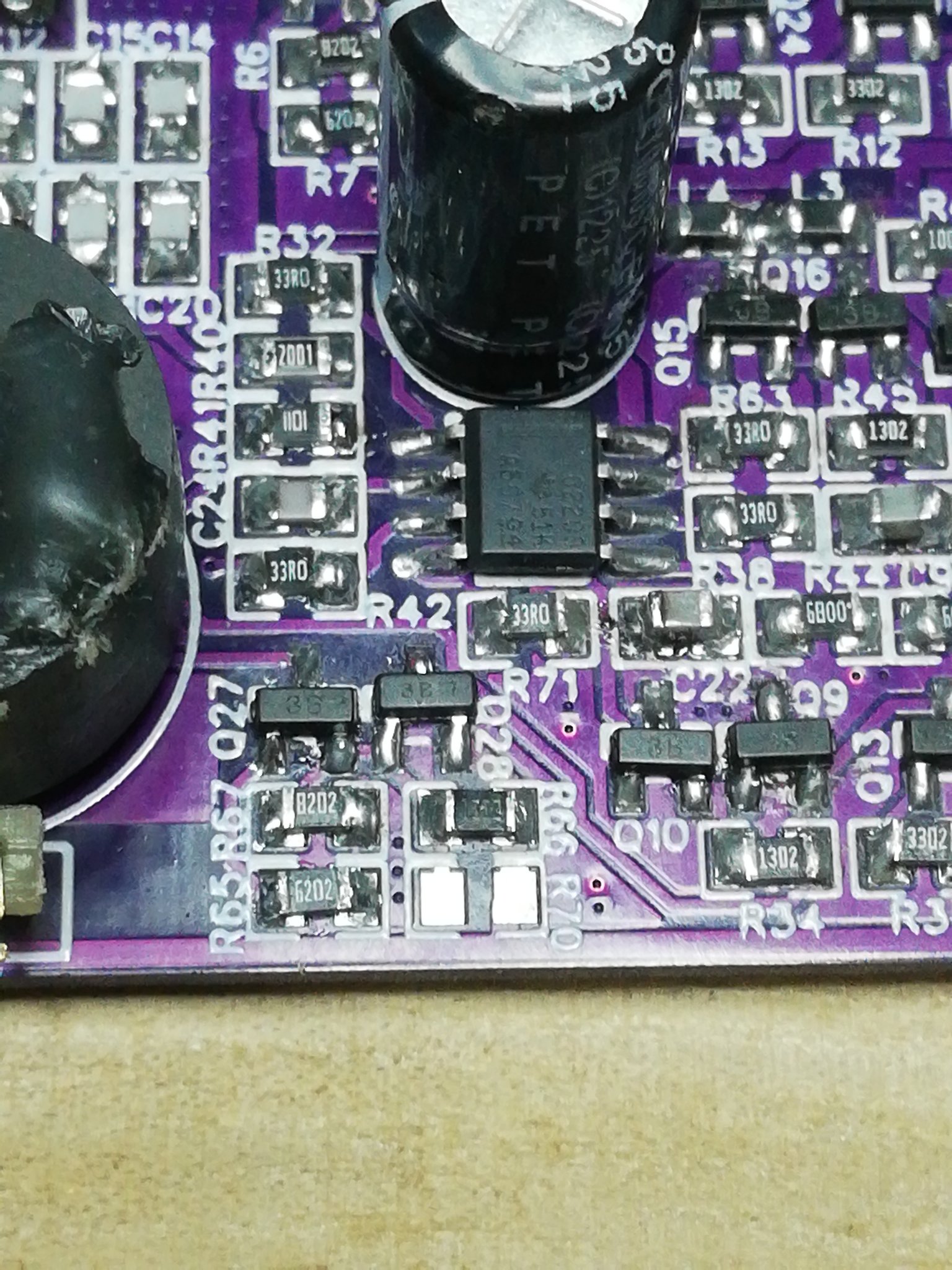

I noticed that the markings on R66 appears faded
R70 is for tweaking the DC offset, which is optional. You could measure voltage across R66 (or R70 which is in parallel) to check that the current source is behaving as expected. Also worth checking that R66 is still 120ohm.

I replace R66 and this solves the overheating of U8.
I replace Q28 and the voltage at TP5 is within specs.
