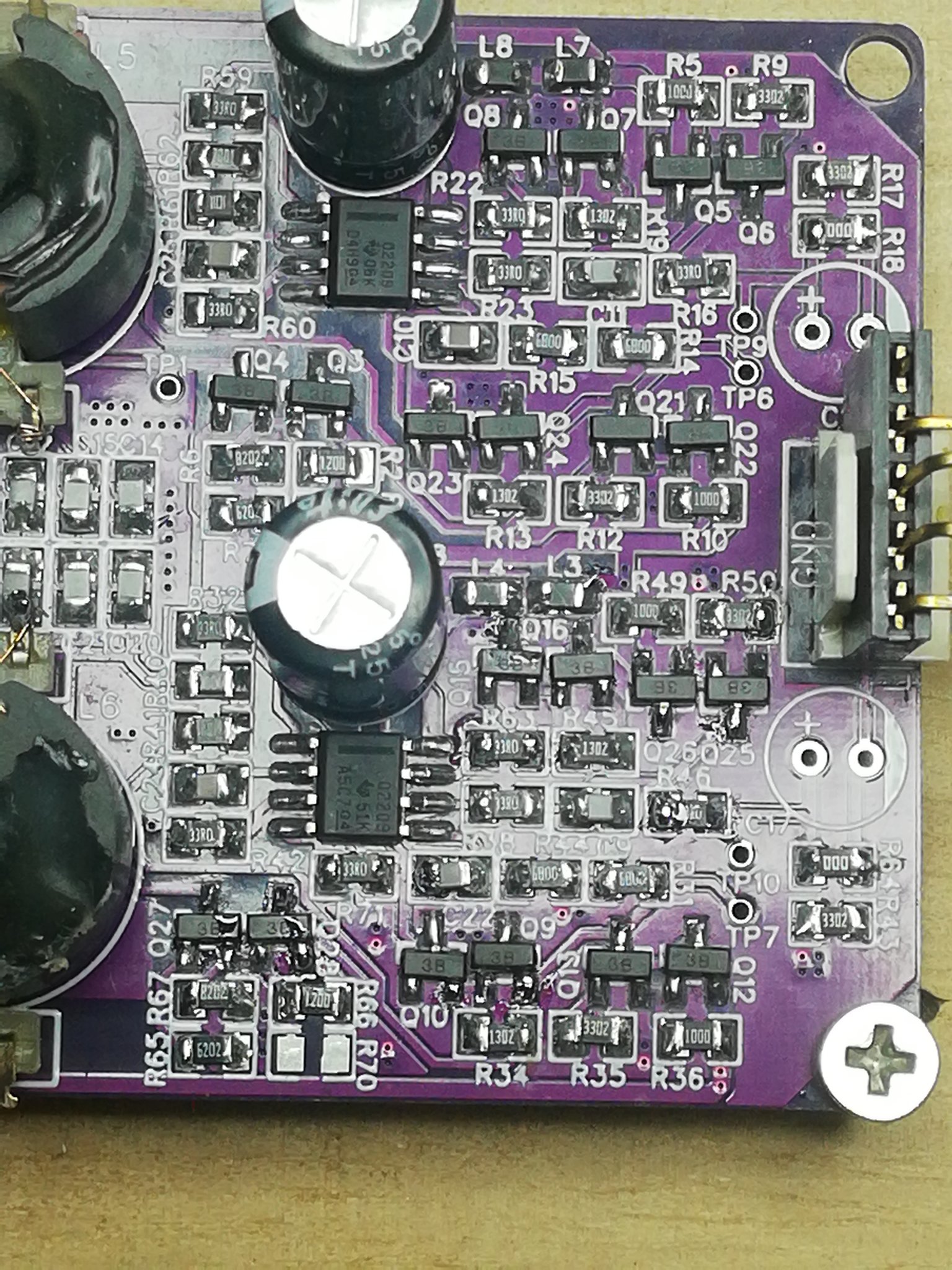

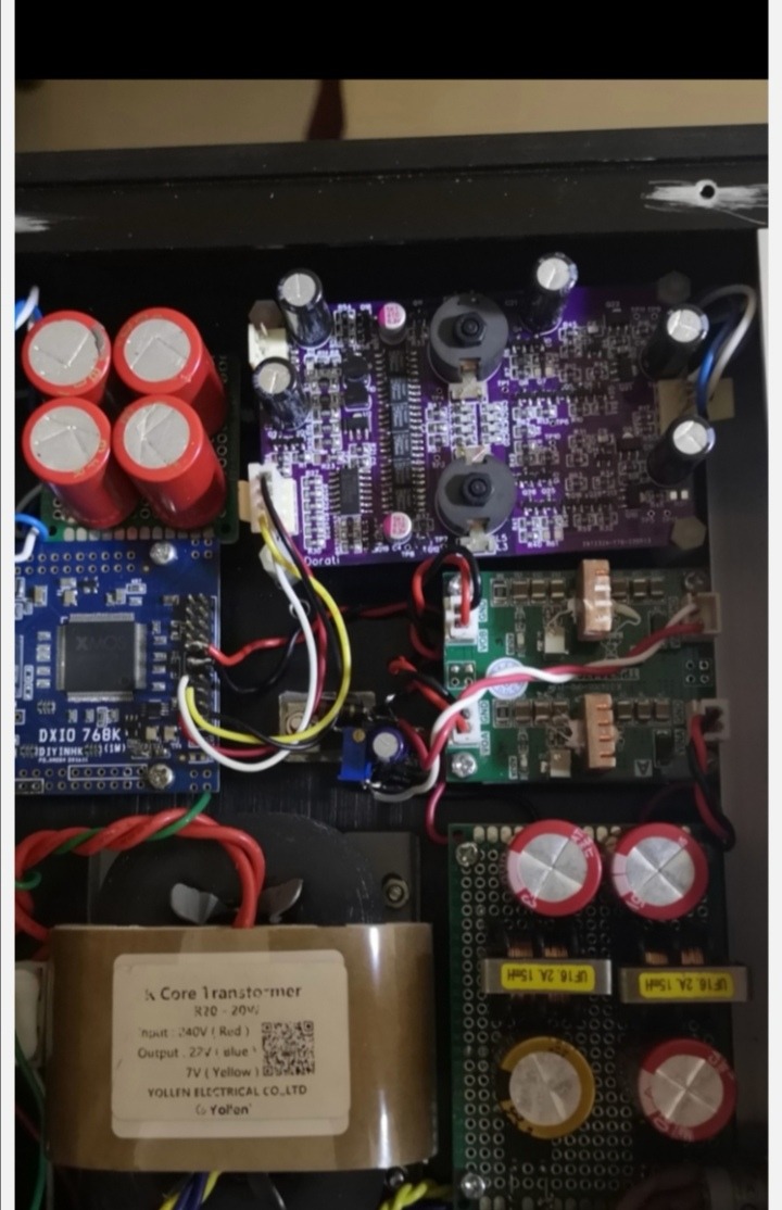

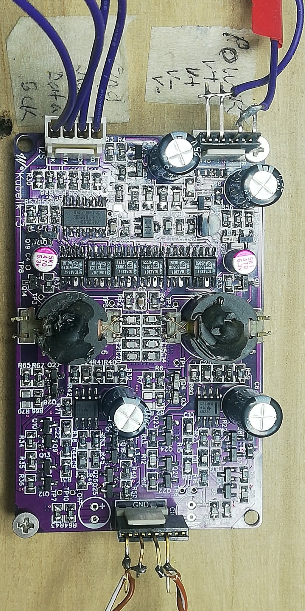

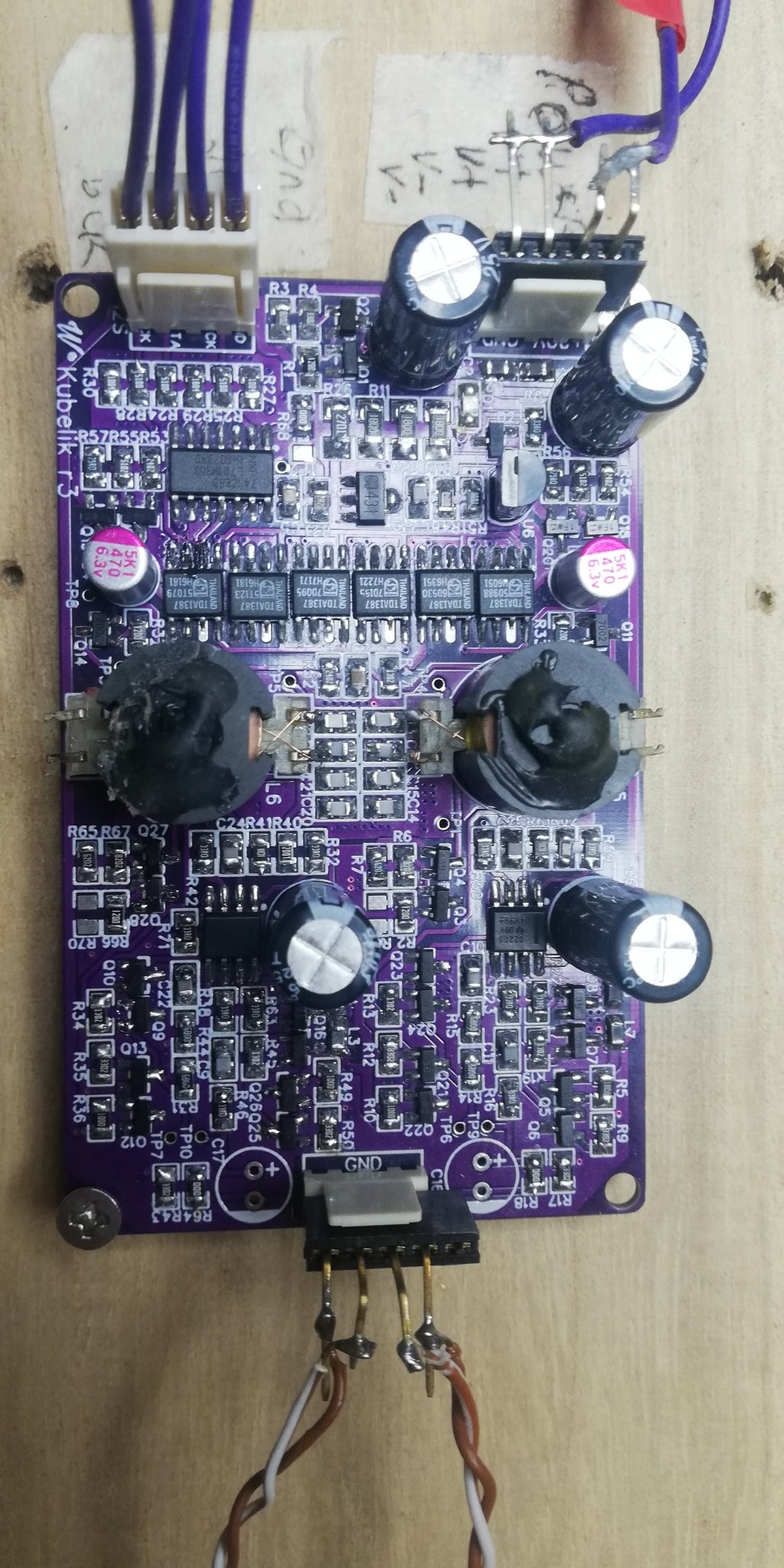

Kubelik r3. Developed a fault after playing well for a few months.
The output from left channel is much much lower compared to right channel. When not playing music, there is an intermittent scratching sound.
Attachments are my build and TP measurement.
Hope to rectify problem with some help

From looking at your list of TP voltages, the first problem seems to be between TP4 and TP6. These are on the R channel so I'm at a loss to understand how its the L channel which has the low signal condition.
First I would check the resistance across R61, could be its too low impedance due to a failure or short across C25.
What would be useful would be to have TP4 - TP7 taken again but with an active I2S input (music or silence playing out).

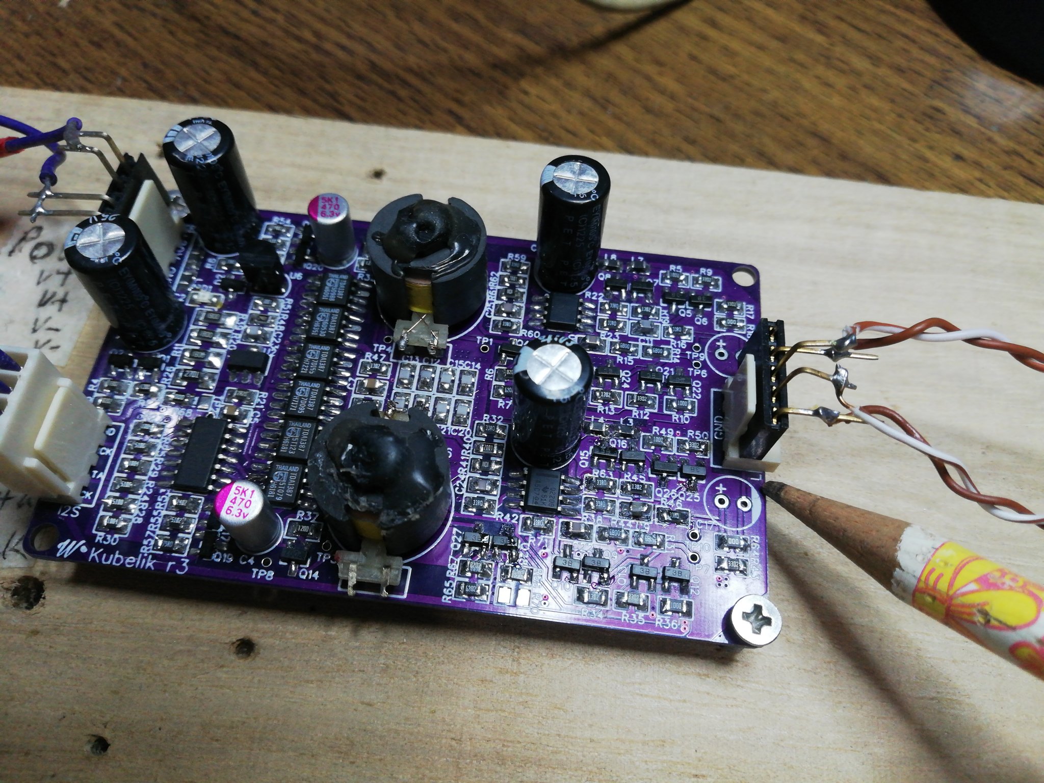

These are new measurements.
Left channel referred to is this side of pcb. The side nearer to i2s input
In circuit R61 and R 41 resistors measures 1093 ohms for both
