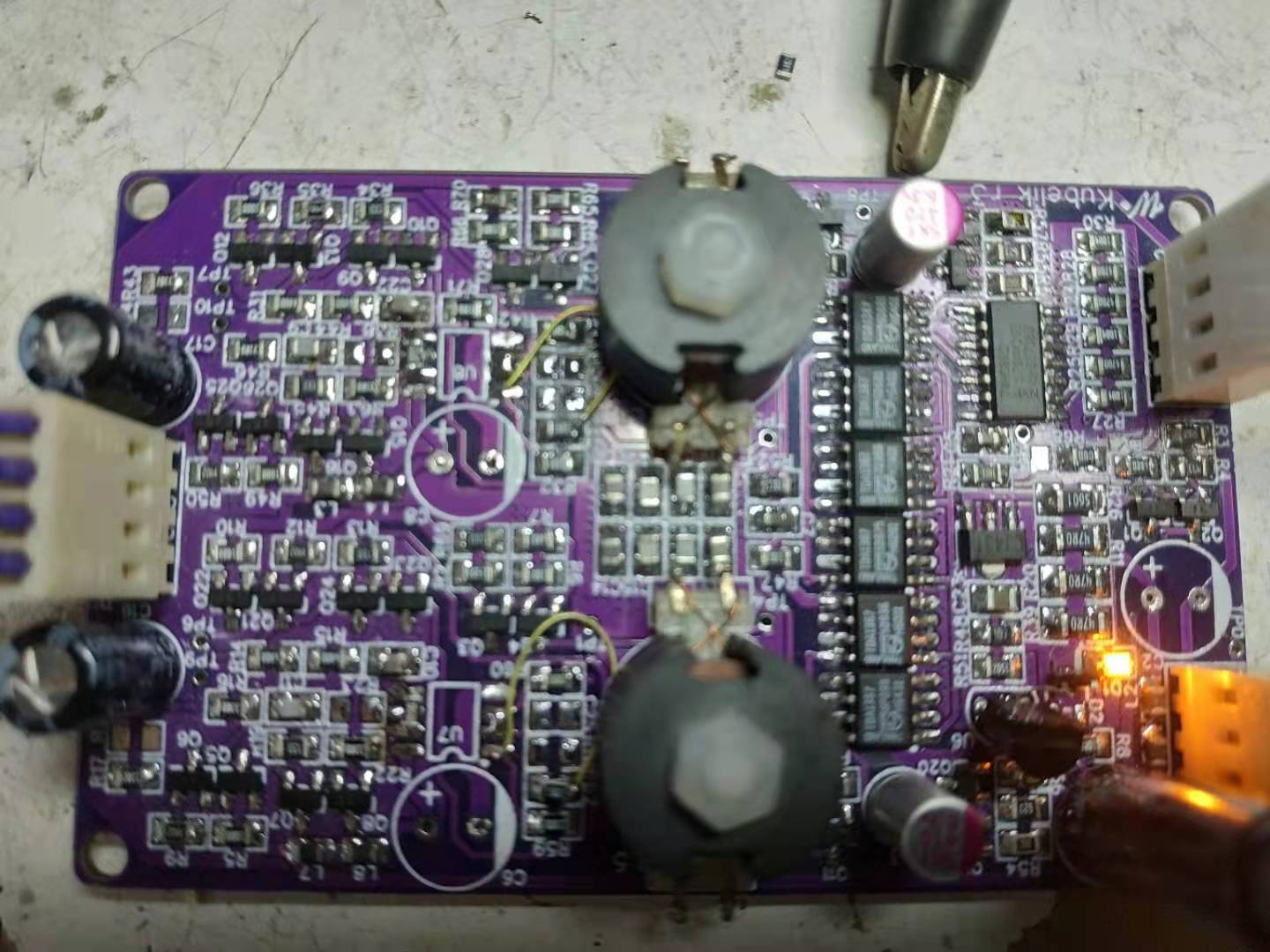

Good question and thanks for bringing attention to this - the signal level there is 4VRMS. So twice what you'd get with the original design. I'm not suggesting reducing the I/V resistor because that would necessitate changing the inductors.

Since the opamps died what you've done is remove both opamp stages - the first one (the I/V stage) was replaced with a resistor (passive I/V) and the second one was completely bypassed. As a result of bypassing the second stage you no longer have NOS droop correction so there's now a HF roll-off.
Since the opamps are assisted by discrete output stages (unity gain buffers) you're now using one of those discrete buffers after the passive I/V stage. The second buffer isn't being used at present but I could look into re-purposing that to restore the HF response.

I'm playing with a first prototype of an evolution of Kubelik where the all the opamps are removed completely and the analog stage just consists of discrete transistors. Need to run the sound by wifey to see if there are any snags with this.... Seeing as the OPA2209s have shot up in price of late this could be a way to keep the BOM cost in check.
The tricky bit here is managing the DC level - as the transistors all lose 0.6V we have 2.4V between the input of I/V stage and output of droop correction stage. Which reduces headroom rather but I'll have a play to see what might be achieved. With passive I/V there's no need for the 20V power supply of Kubelik, it might be possible to get down as low as 12V.
Oh forgot to mention, the inductors need to be 11mH (previously 22mH). I looked in Mouser and they don't have that value but they do have 12mH so perhaps I can tweak something...

If you'd like to try this variation based on Kubelik you'll need to source yourself some 12mH inductors - that's a value that goes with an I/V resistor around 1kohm. Standard Kubelik uses 2kohm and 22mH inductors. I'm fairly sure it does sound better than original Kubelik - there seems to be more tunefulness in the bass and a deeper soundstage - but so far I've not done the side by side comparison.

Here's an interim schematic, I'm giving this evolved design a new name, Dorati (though I often can't remember his name correctly and call it 'dorito'). Not all the component values are adjusted for the lower supply voltage yet, but it'll give some idea.
