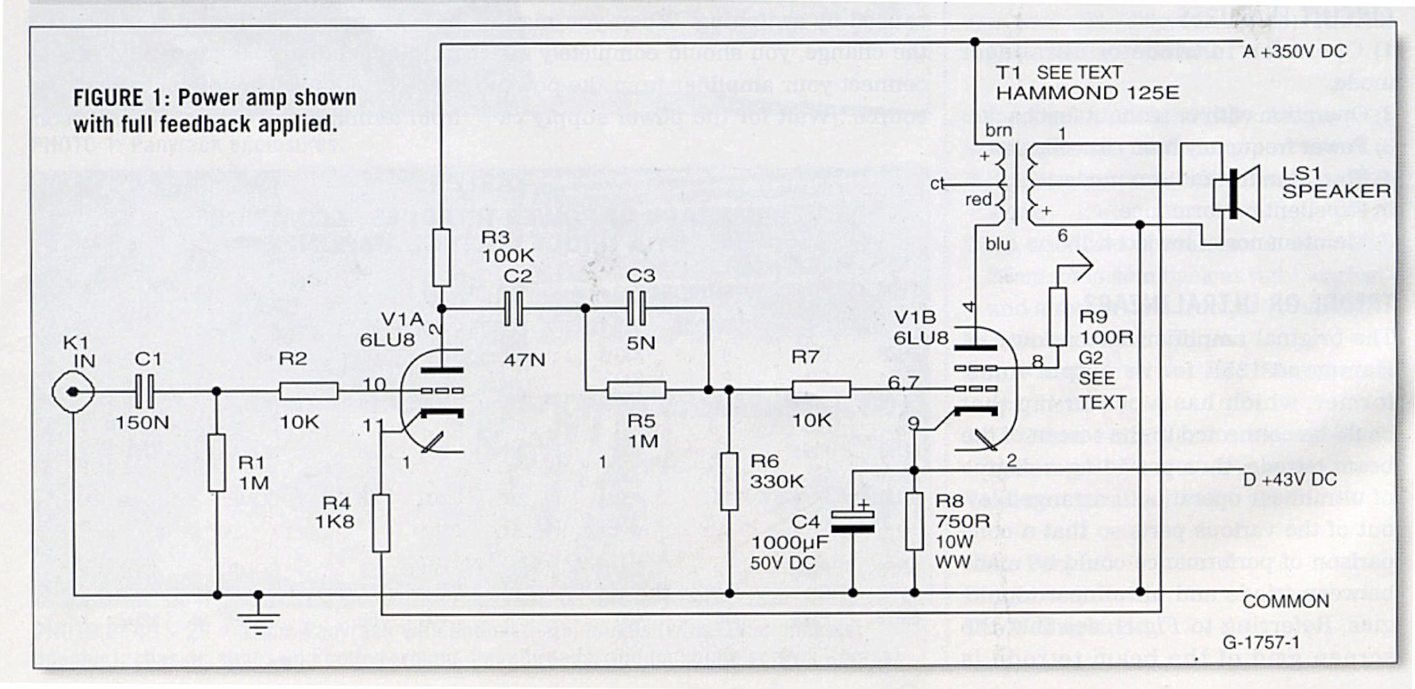

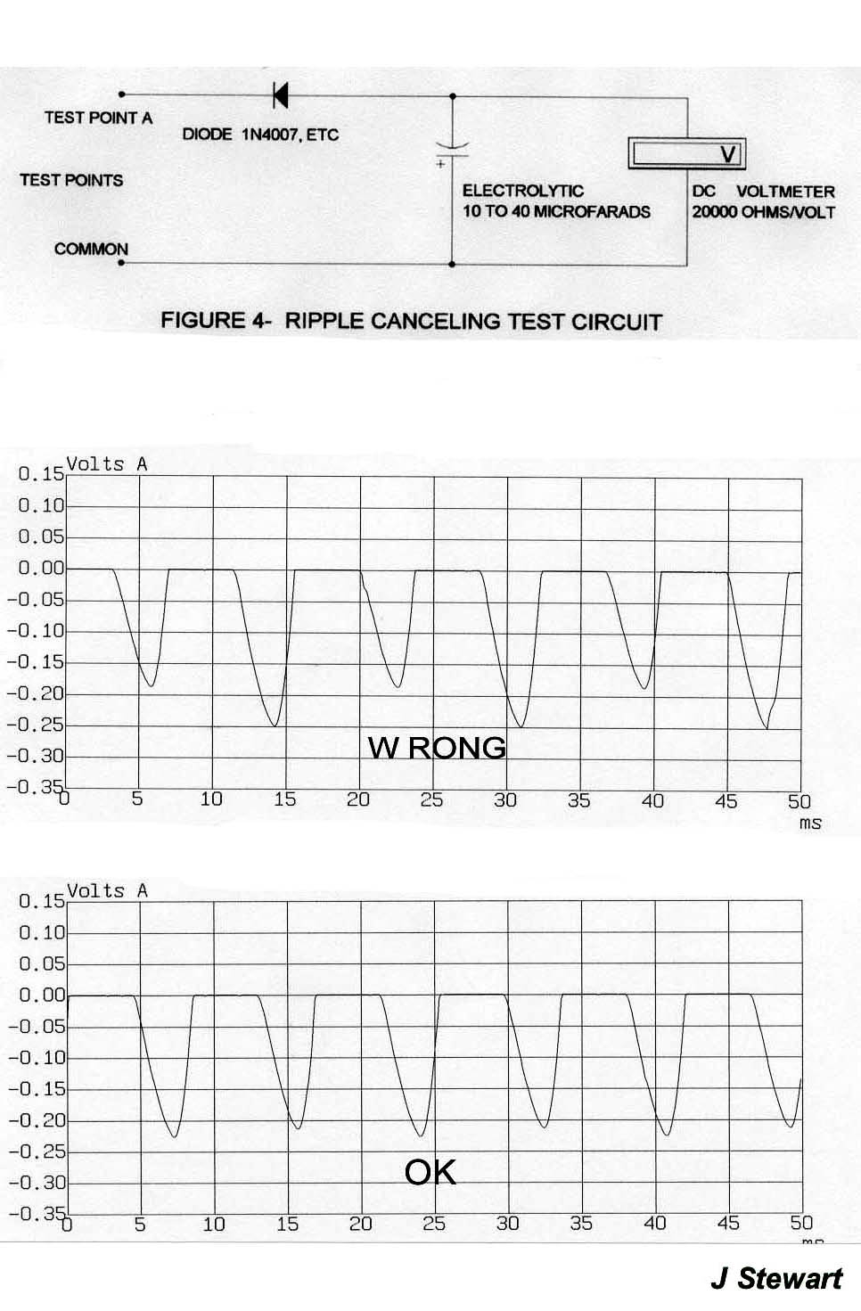

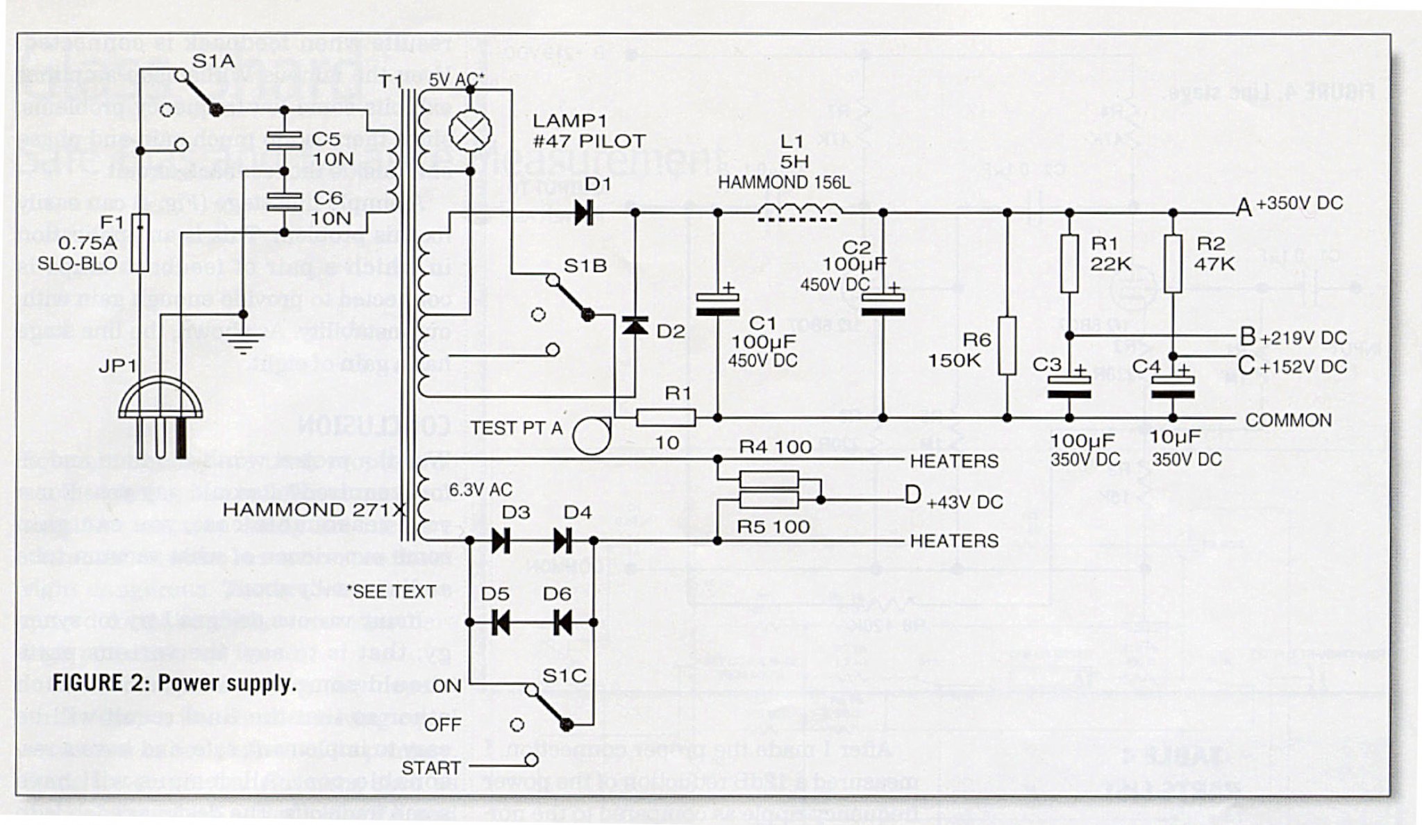

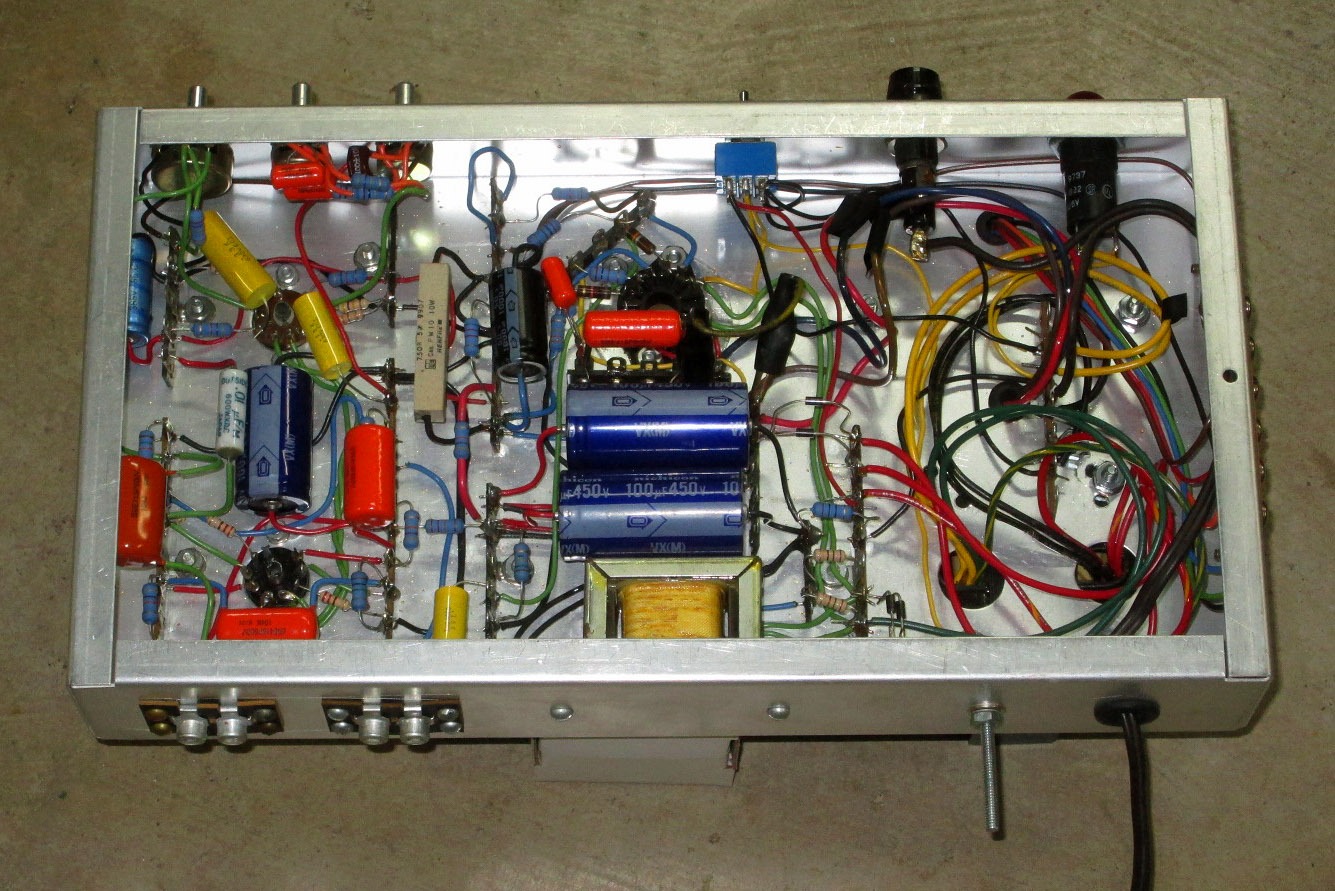

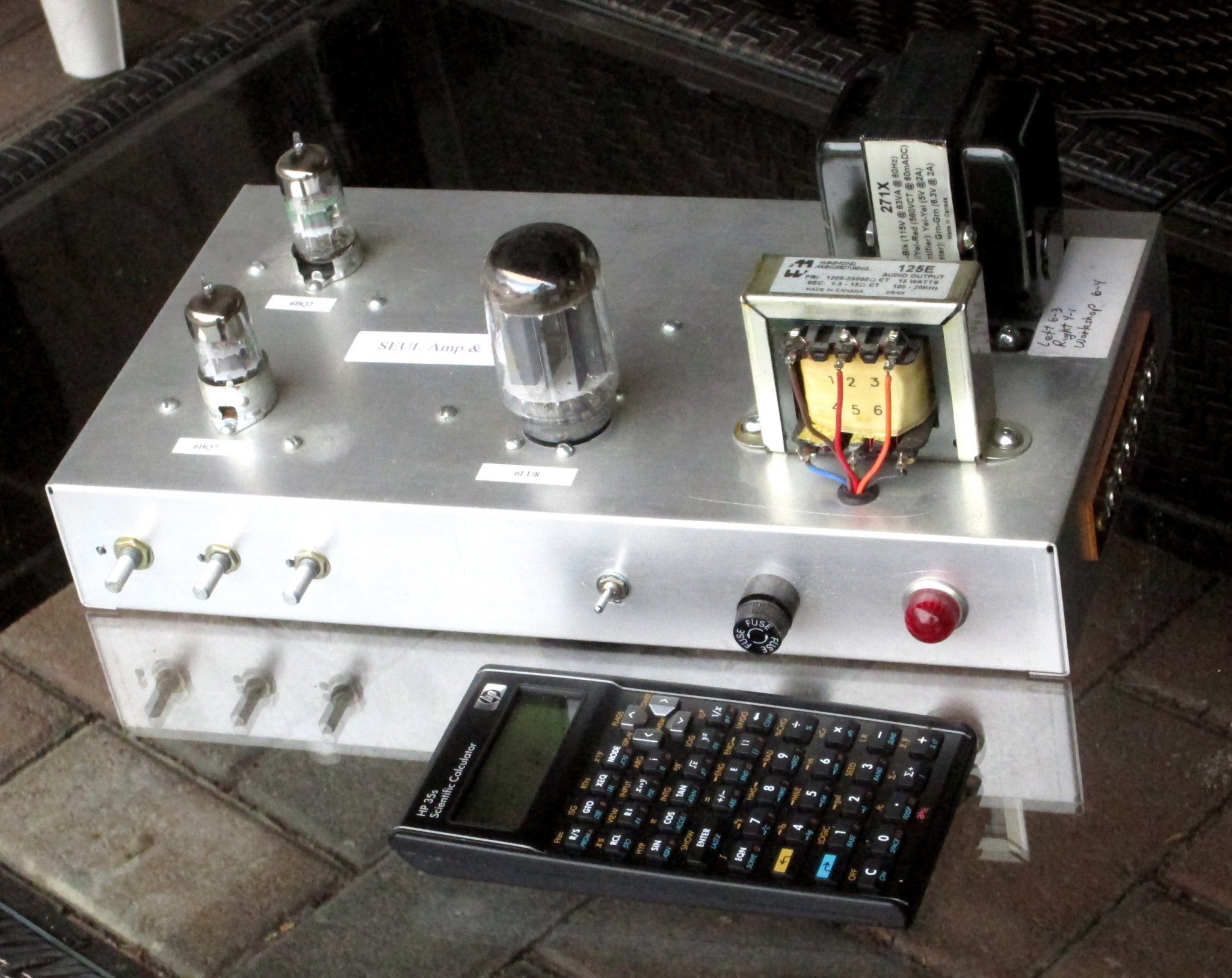

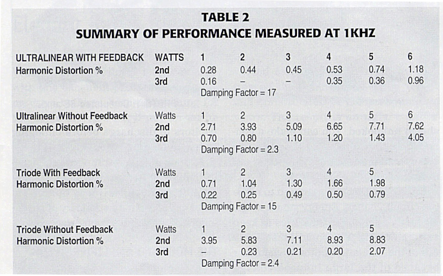

hello John:
Thanks for the circuit. I am just starting to study and comprehend it. Good for you that you chose to publish your circuits. I agree with that philosophy ideas should be shared so they can be enjoyed by many and perhaps improved upon to make an even better outcome. I also appreciate data to support the Diy person in the construction process.

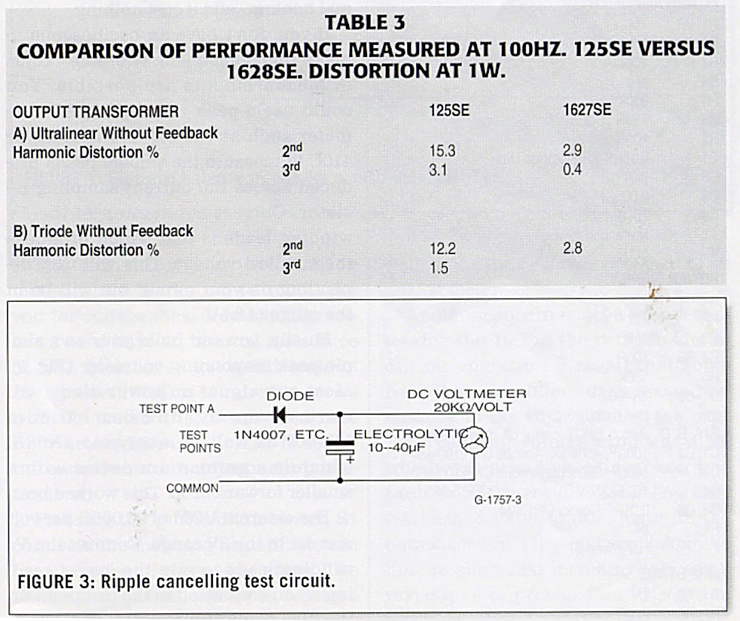

I notice a discrepancy on table 3, did you compare to a 1627se or 1628se. Also could you explain the effect of damping factor?
Your first photograph shows a pair of 6bq7 to the left of the chassis? Is that a pre amp section or a tone stack? I do not have the entire article to reference.
A very nice design with impressive performance figures good for you.
Thanks again
Thanks again

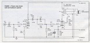

That is a good point, the OPT for that test was a Hammond 1627SE.I notice a discrepancy on table 3, did you compare to a 1627se or 1628se. Also could you explain the effect of damping factor?
When I started the original project for a 6EM7 SET, I was intending to go a least cost route.
This is an experimental amp as all my amps have been during the past 25 yrs.
There were some SE OPTs on the market but for a start I simply used a Hammond Universal, their 125E.
There were a couple in my stash. All of the tests would be done at 1000 Hz.
For the 6LU8 SET/SEUL version I simply changed the output tube socket & rewired for the 6LU8.
At the end of the tests on the 6LU8 UL version I did a comparison at a much lower frequency
using the H1627SE to get a look on performance improvement. Both versions sounded OK,
I did listen to the 6LU8 vers for a while as background tuned to local FM
If you like send me a private msg with your email., I've put both projects into PDFs.
And attached here is the original article covering power frequency ripple & reasons why it is worth doing.
I claim no Copyright or Copyleft on any of this. Just something I enjoy doing. 😀 👍

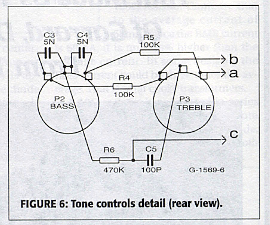

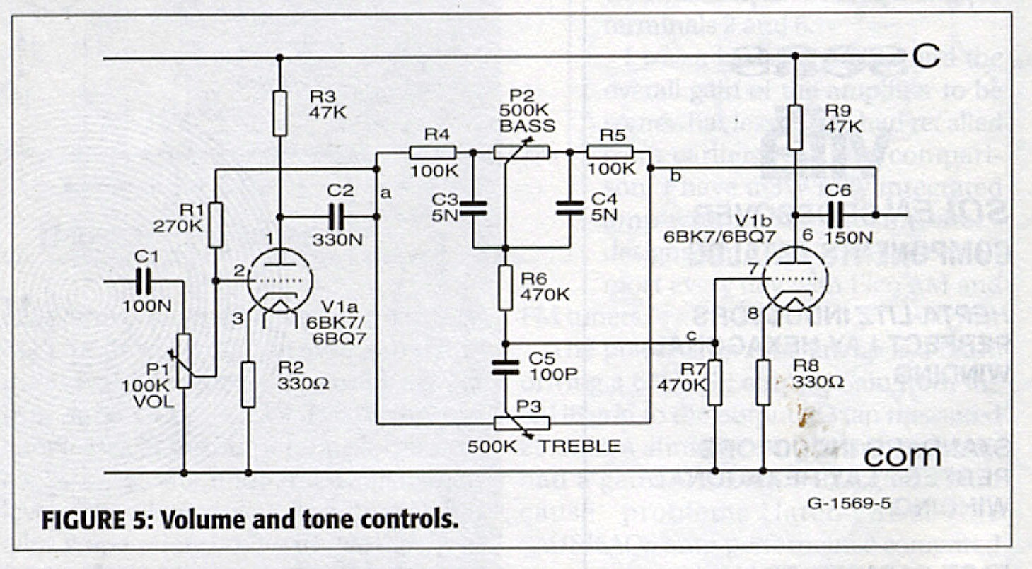

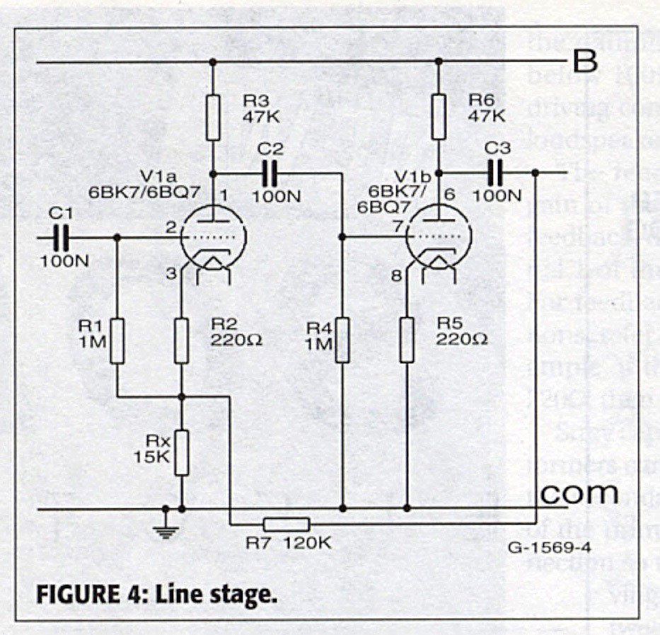

As I tested the earlier 6EM7 SE version of the amp I found that when the max NFB was applied the front end sensitivity was too low.Your first photograph shows a pair of 6bq7 to the left of the chassis? Is that a pre amp section or a tone stack? I do not have the entire article to reference.
There was plenty of space on the chassis, so two more sockets were installed. One 6BQ7 acts as a form of Line amp.
The other 6BQ7 is a complete Baxandall tone circuit, BASS & TREBLE controls.
The end result is something that can be driven by vacuum tube AM & FM Tuners from the 50s & 60s.
The line stage has a gain of 8 & looks like a source 1300R to the following load. 🙂 👍

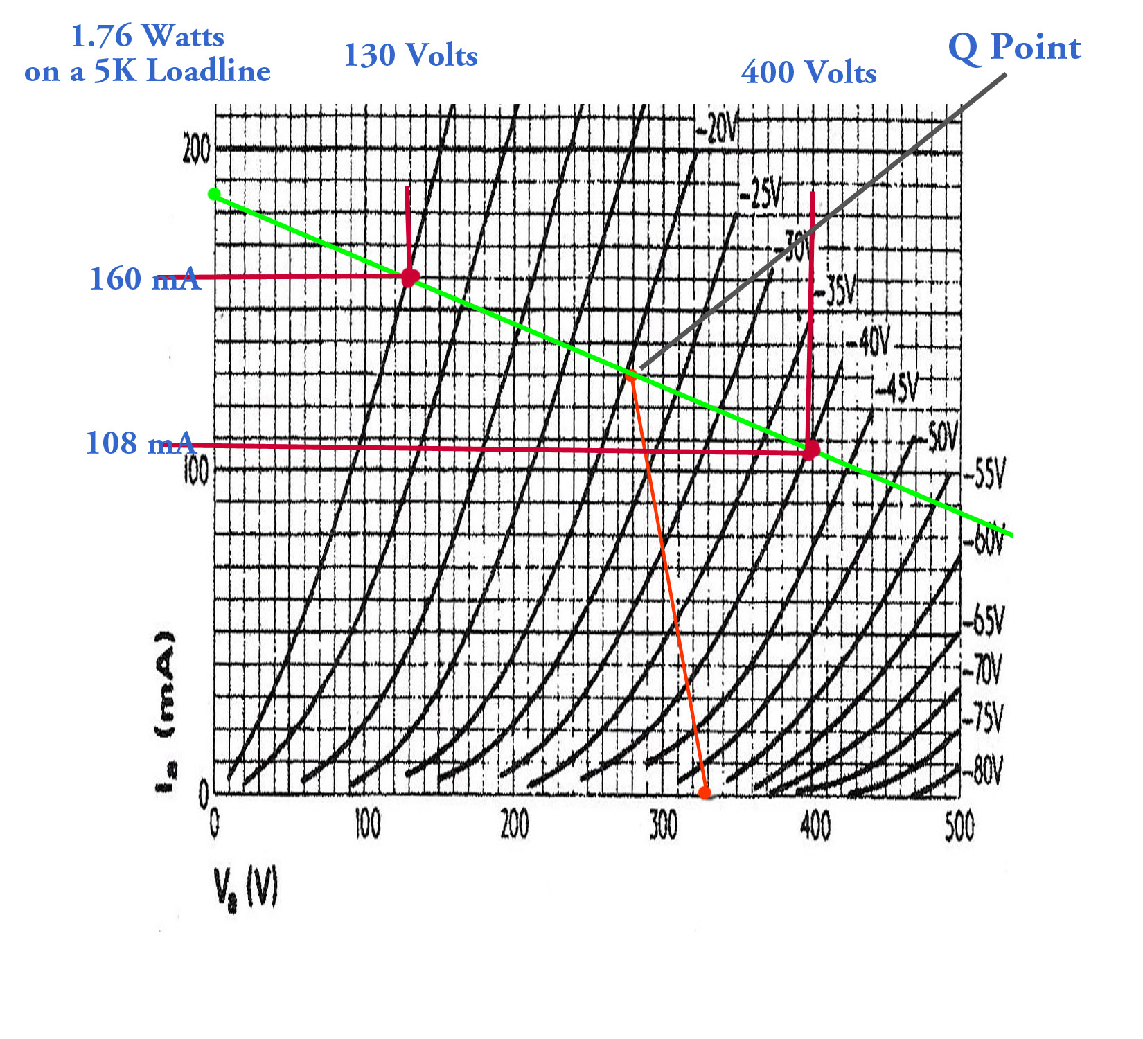

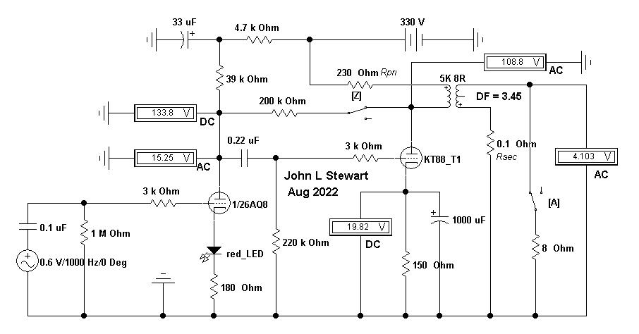

So here is the KT88 in Class A, ~130mA Plate current. On a 330V PS. Plate dissipation is ~ 36 Watts.
Drop across the Cathode resistor is ~ 20 V & across the OPT Primary another 30V. The KT88 has 280V to work with.
Using different methods the 5K loadline is not suitable at all. Not surprising, the KT88 plate resistance is ~670R under these conditions.
For any common triode, theoretical max power occurs when Rl = 2 rp. But in practical amplifiers it is more like 2.5 rp.
But that brings with it quite a bit of distortion. So a professional designer might spec the OPT to be something like 3-4K.
That would result in more audio power than with the 5K OPT.
On the graphical method, power output is simply pk to pk voltage times pk to pk current divided by 8.
