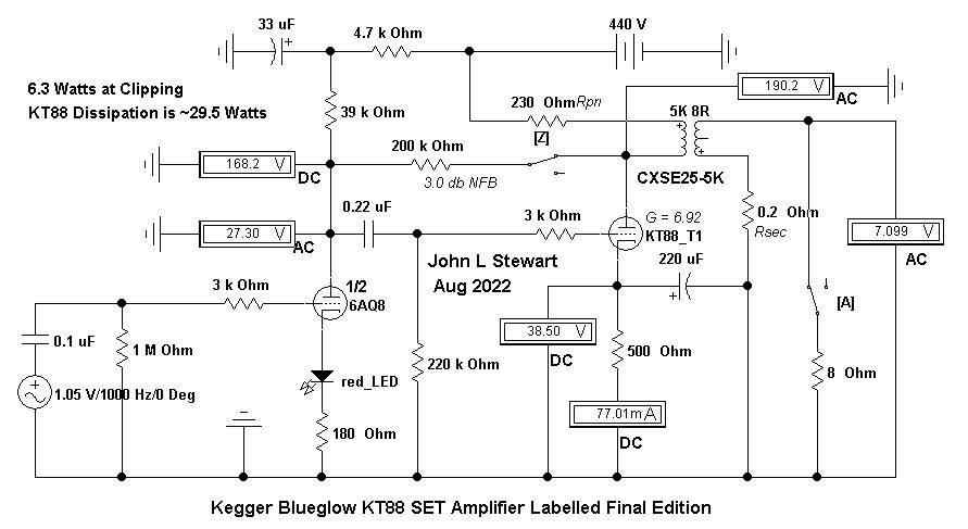

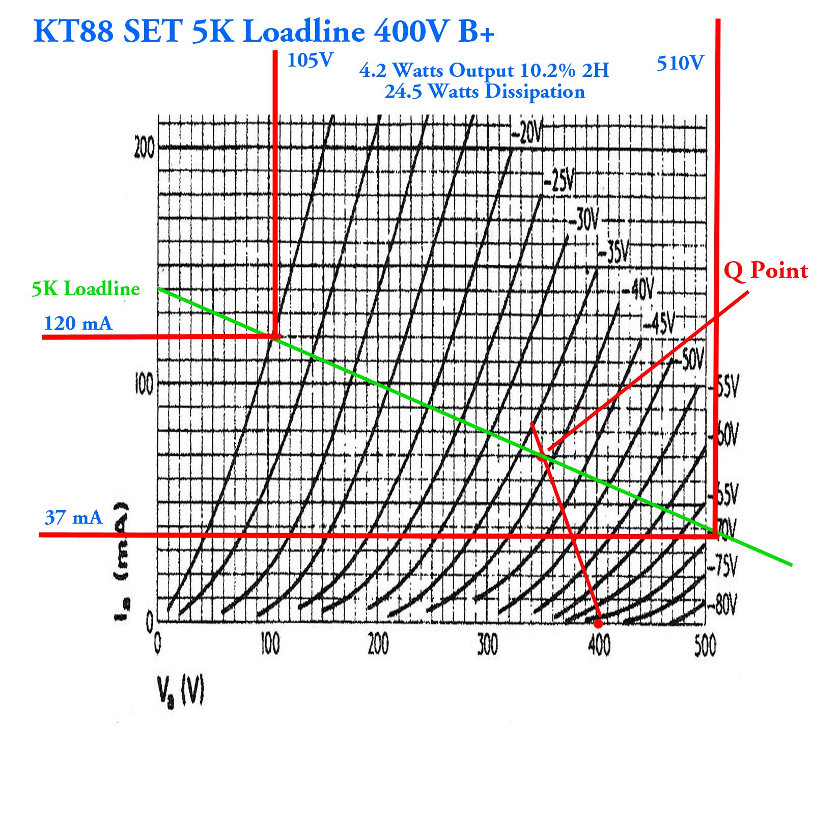

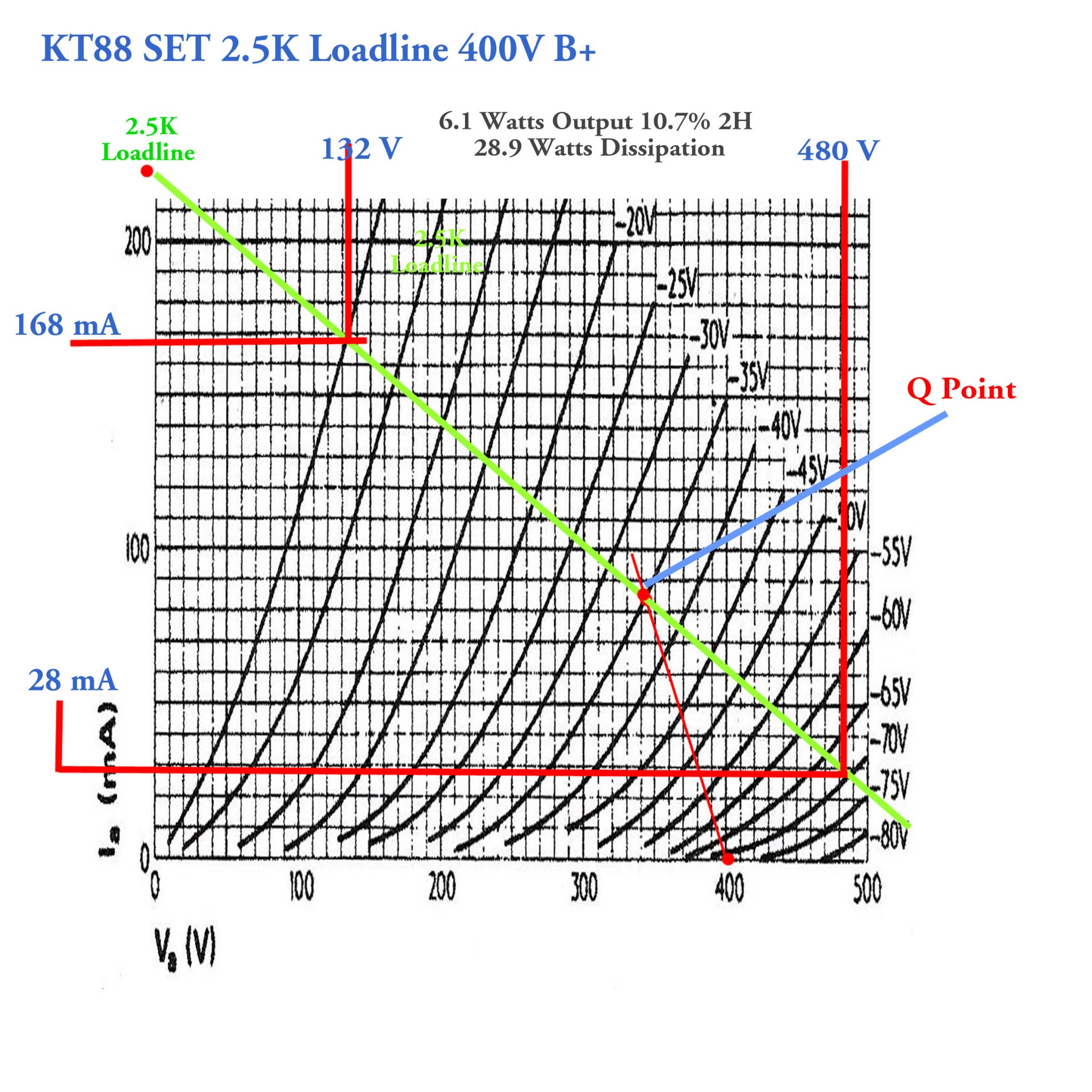

KT88 SET 400V B+ 2.5K Loadline
These simulation conditions manage ~7.3 Watts while plate dissipation is ~28.9 Watts. That is close to the theoretical for Class A, the power output is 25% of the plate input.
The graphical solution is close, easily within the same order of magnitude as it should be. Second harmonic is 10.7% & calculated by a simple formula often found in texts & data books. And attached here. 2H is proportional to output, so that at One Watt it would be ~1.5%. And could be further reduced by a NFB circuit. 😀 👍

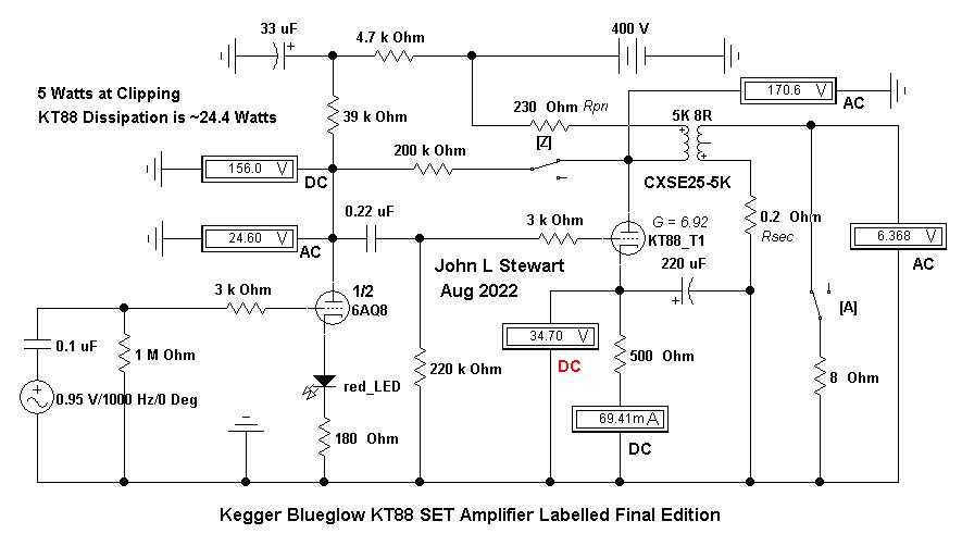

As requested, here are the results of the final version dated V6 2018 as posted on the Kegger Website.And FYI the actual distortion numbers of a sample of this amp, running the right tubes at the correct voltages, measured at 1% distortion is making 8W, at 5W is at 0.5% and at 10W it's still under 2%. For a SE amp those are really good numbers, the frequency response is flat and it has a lovely looking square wave. He explains all this in these two videos.
In SET mode the audio power available is ~5 Watts while the KT88 dissipates ~25 Watts. It will do a little better in SEUL.

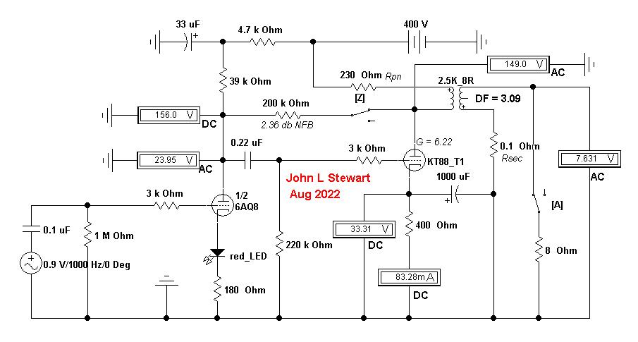

Here is the graphical solution for the Kegger Blueglow KT88 Amp Final Vers in triode mode.
The amp has about 2 db NFB, that will help the distortion figure a bit.
But neither solution comes close to the claimed numbers.
The B+ could be safely increased to about 440V with the 500R cathode resistor.
Alternatively, the 2H might be reduced by setting the cathode resistor to 400R.

They aren't "claimed numbers", they are the actual bench tested numbers. You can watch the amplifier being tested with several different pieces of equipment. I bench tested mine after it was finished and got the same results.Here is the graphical solution for the Kegger Blueglow KT88 Amp Final Vers in triode mode.

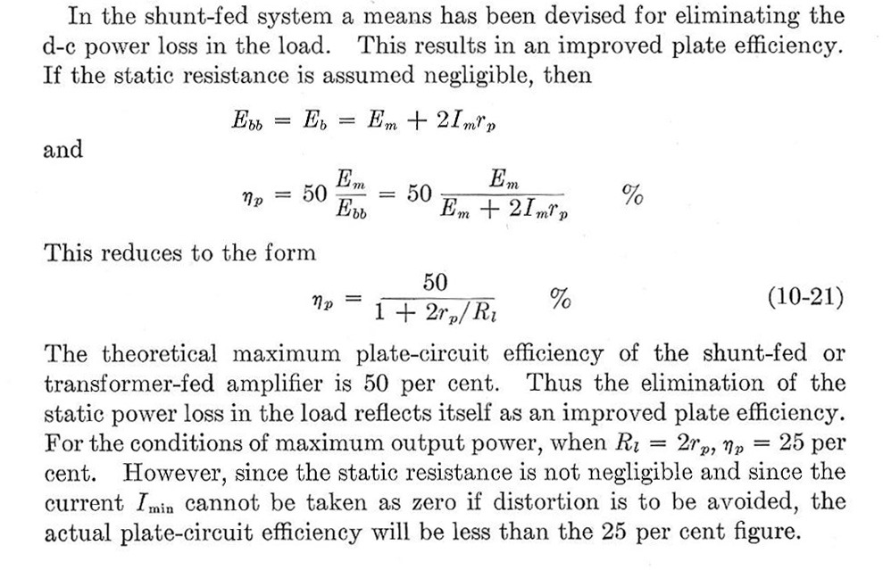

No, ideal A is 50%, for choke/transformer loading.close to the theoretical for Class A, the power output is 25% of the plate input.
"25%" is an approximation for usual triodes in A1 which are FAR from ideal.

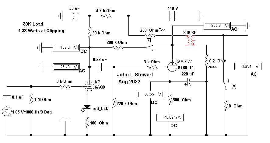

KT88 SET 440V B+ 30K Loadline
While that may be considered by some to be 'ideal', there is a fundamental problem. There is no usable output.
But common triodes are very tolerant to load resistance & most anything greater 3rp works well.
The upper limit is set by the designer, how much usable power to forego achieving lower distortion. 🙂
On this sim the PS could be increased & the plate current decreased while the Q point is pushed farther to the RHS.
But soon becomes SE Class AB.👎

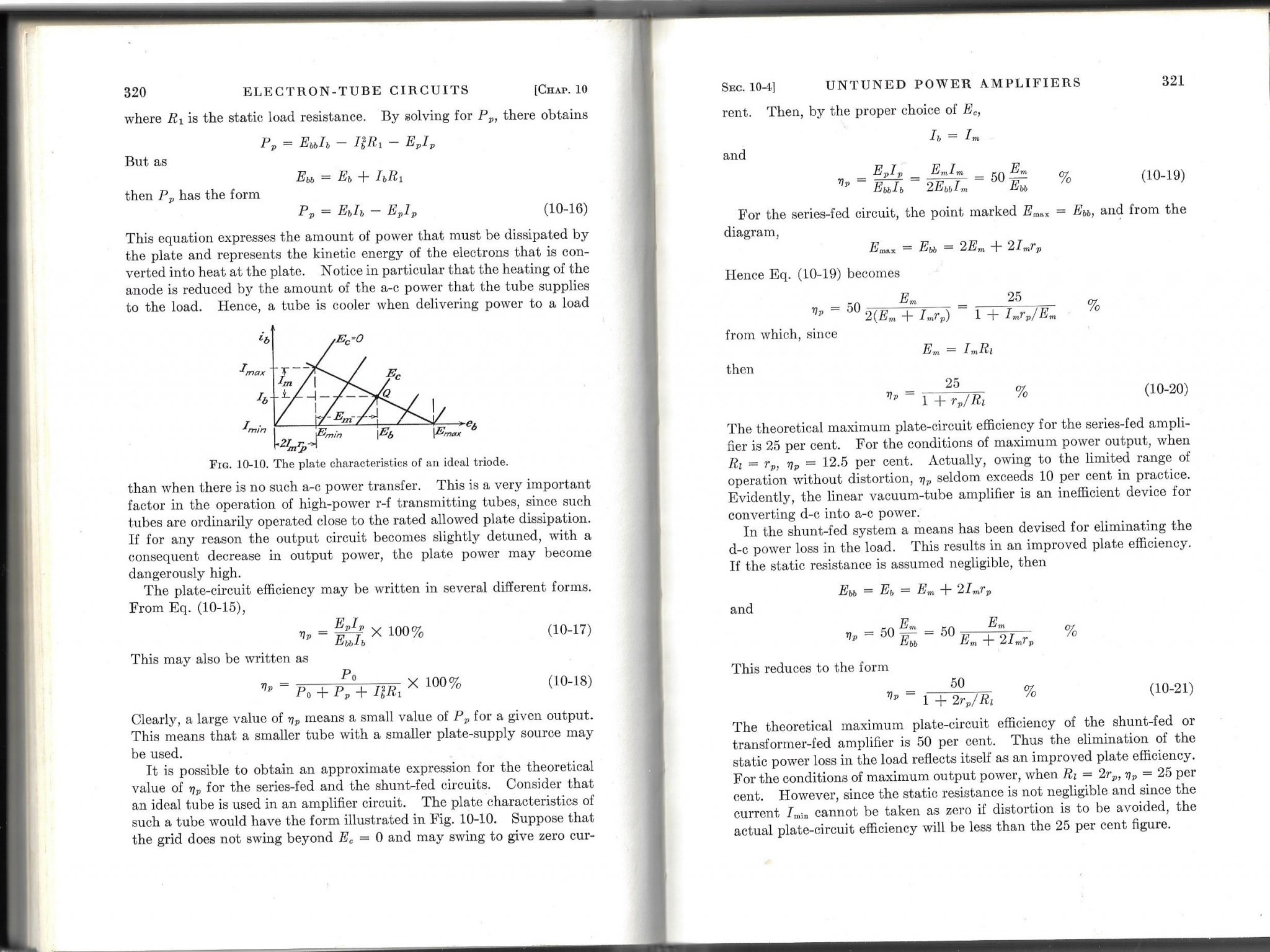

Here is a good reference from the distant past scanned from Samuel Seely's text book 'Electronic Tube Circuits'.
Its one of the McGraw-Hill Electronic & Electrical Engineering Series of text books from the 50s.
As I grinded my way thru the system this was one of the text I used & another of the same series by John D Ryder.

That passage from Seely is for the non-ideal case where rp is significant. And also somewhat constant.
Compare to a 6L6 (or KT88) pentode. rp takes two values, very high and very low. Any 19W 6L6 can make 8+ Watts in pent/tetrode. Load in 2500+r and swing down to the ~~250r saturation resistance.
