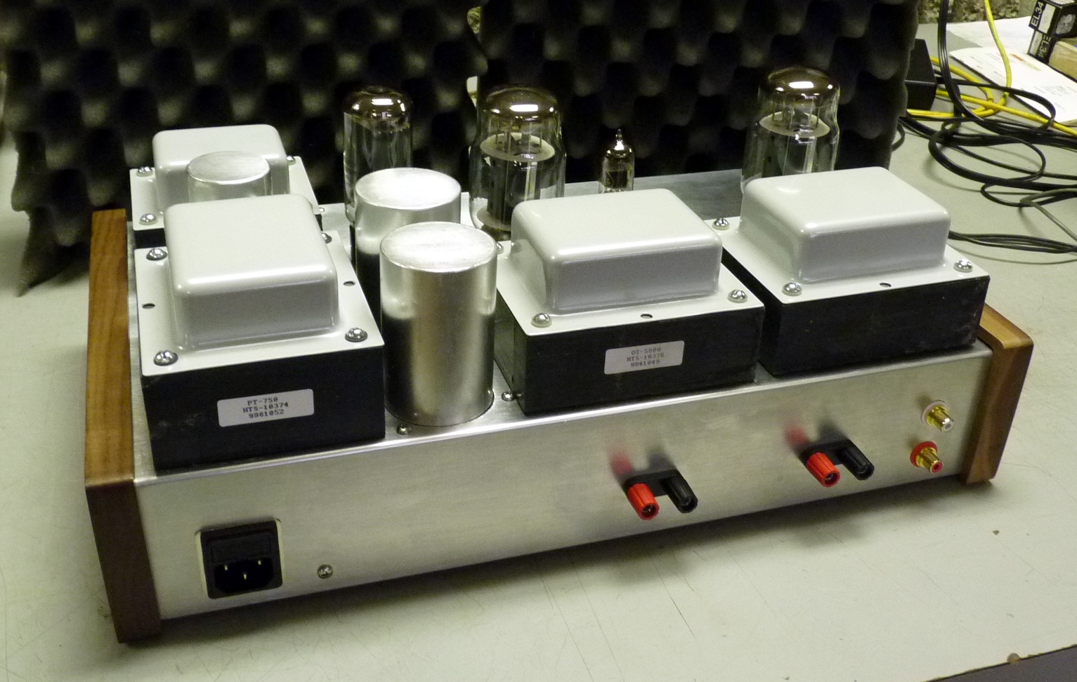

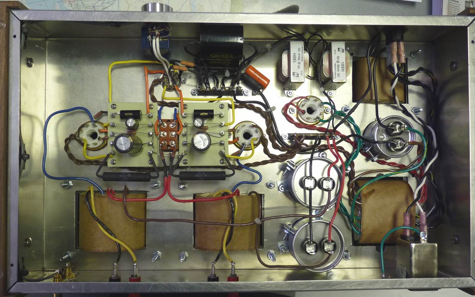

Completed KT88 SE Amplifier
I received the power transformer for evaluation and installed it. Perfect. The amp sounds excellent as expected. The AC hum/noise level, with no input signal, at the speaker terminals measures 1.3mV. I am using 98dB speakers with this amp and it is dead silent with no input signal. The power supply B+ voltage measures 420VDC. I'll be doing frequency response measurements this weekend. The attached photos show what the amplifier looks like with the custom transformers. I know that the power chokes have shipped and I should have those next week. It looks like within 2 -3 weeks I will have the output transformers, power transformers, and chassis. We're almost there folks.
Scott
