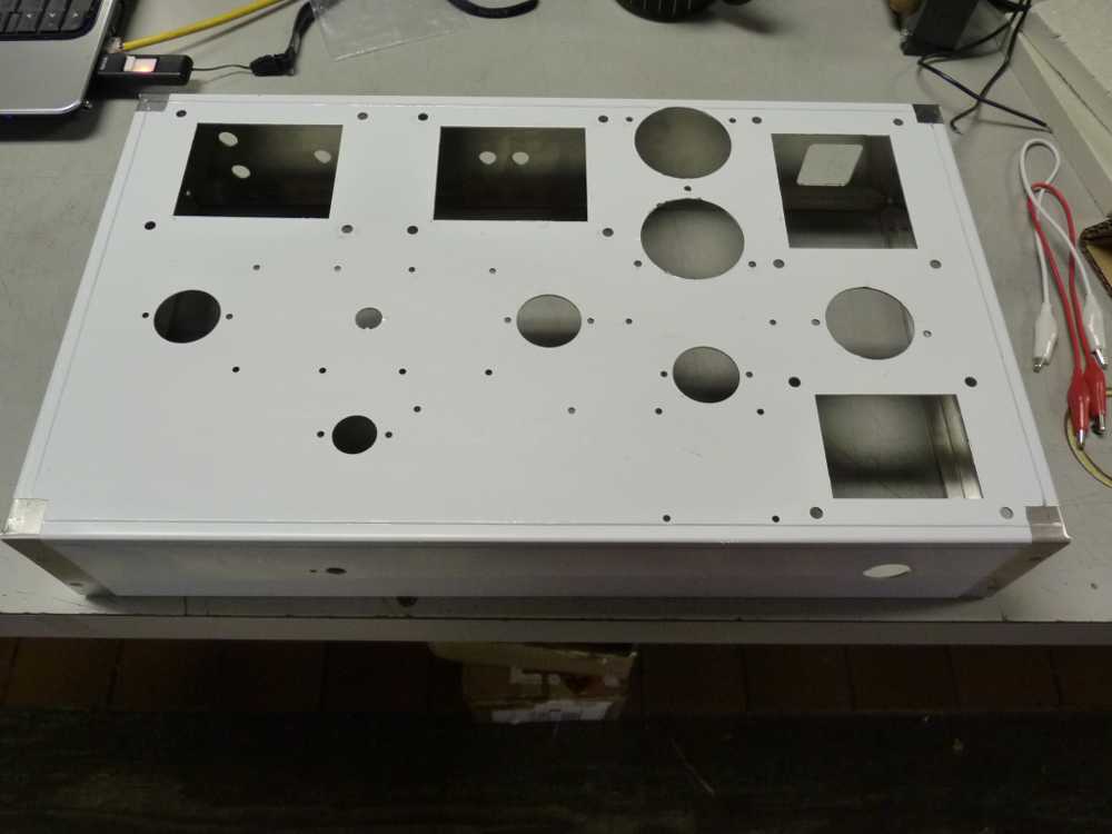

I have attached a photo of the pre-punched chassis that is included with the Master Kit.

There is a seller on EBAY who has prepunched and painted chassis for stereo SE amp. They run about $160 or so shipping and all. The chassis has all of the features that are listed above. I went thru a phase where I was running SE KT-88s; I was not too impressed with the sound tho. I then built a 300B amp, and finally reached by SE Nirvana when I built a Cathode Follower 6S33S amp. But that is on another thread...

Can you give me a link to the seller on Ebay? I don't know how that is possible considering that I personally designed the chassis shown above and it is configured for custom transformers that were also designed by me.
This amplifier does not use or require feedback. I have tried implementing feedback in this design and all it does is muffle the supreme clarity that this circuit offers. This circuit does not provide optimum sound when run in the pentode mode.
