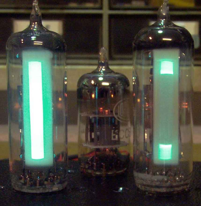

Oh btw, I have bought on ebay a pair of these magic eye tubes with their controller boards and a pair of transformers. I am still deciding if fitting them inside this amplifier for an aesthetics touch or mounting them in a separate enclosure (thus allowing me to use them as a vumeter with other different amplifiers).
They were pretty cheap at 10€ each delivered, and work pretty good! look very nice in the dark along the other tube's red glows.

Hey Regi, those magic eye tubes look cool! Will make a nice addition.
