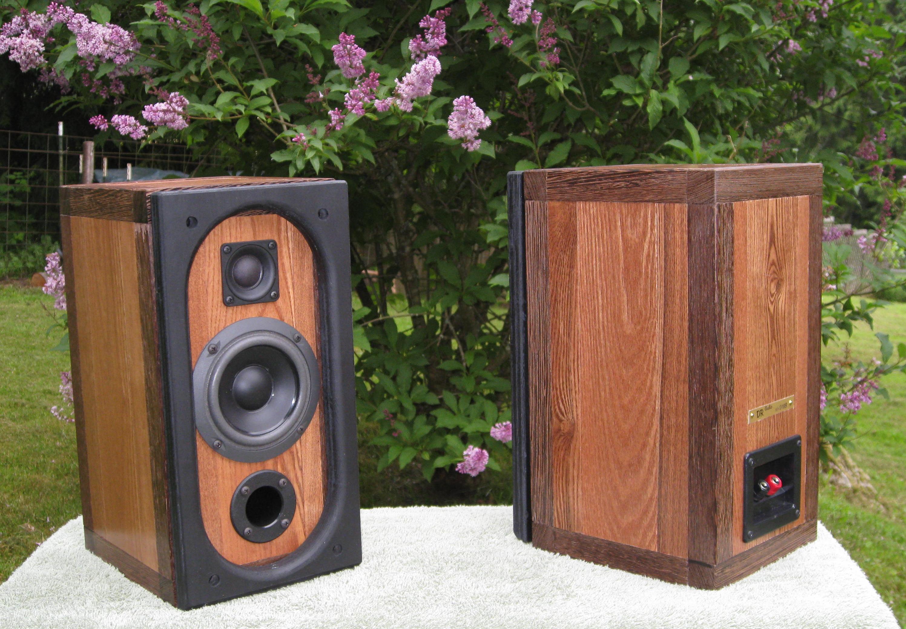

TerryO is referring to a couple of diy speakers that I put together, dubbed "DR1" and "DR2". The DR1 sounds somewhat better, and it makes a great combination with this KT88 SE tube amp.
They are bookshelf speakers, both using the same 4.5" Vifa/JBL midwoofer in a 5 liter vented box. The original DR1 uses a 3/4" Audax tweeter, while the DR2 uses a 1" Peerless tweeter. All of these drivers were obtained on a discontinued buyout, and are no longer available. 🙁 Both designs use a series crossover (different). Above the vent tuning frequencies, the impedance of both designs is relatively constant at around 4 or 5 ohms. They are both approx. 89 dB.
Attached is a shot of a pair of DR2's that I made for a friend. I can't find a shot of the DR1's now.

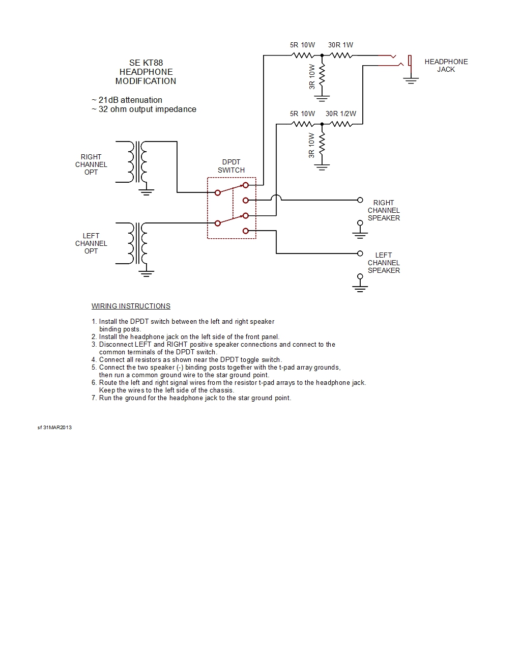

SE KT88 Kit Headphone Mod
Here is the information for installing a headphone jack on your amp.
These are the resistors that I used:
Mills 5 Ohm 12W Non-Inductive Resistor 005-5
Mills 3 Ohm 12W Non-Inductive Resistor 005-3
CPF130R100FHB14 Vishay/Dale | Mouser
Here is the same toggle switch that was in the kit:
S6A NKK Switches | Mouser

I'm going to build it and report, components are on it's way to home. Check out the sch, 30 Ohm resistor is shown as both 1W and 1/2W rated.
Thanks for that! Amusing to be able to use it as HP amp 🙂
Yeah, the 1/2W is incorrect. They are both the same 1W resistor. I think you'll be happy with the sound.

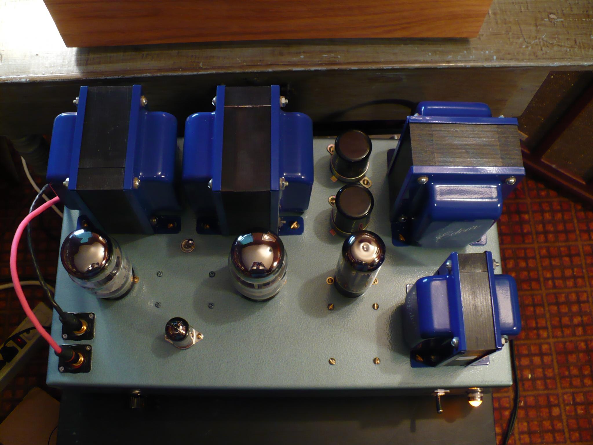

I just finished mine 4 days ago. This was my 4th build, preceded by an AudioSector LM3875, Bottlehead Seduction and a Pass B1. I almost built an F5, but got discouraged searching for parts for it.
Here is my parts list:
I used all Edcor xfmrs
PTX: XPWR 222-120 (for the 320ma rating)
OPT: CXSE25-8-5K
Choke: CXC125-10H-200mA
I didn't want to venture too far into uncharted territory, so I mixed Scott's and Porkchop's schematics. I did use a basic PEC volume pot and JJ multi capacitors (32+32 & 50+50). Works fine for me. None of the "hum" that we've been warned about.

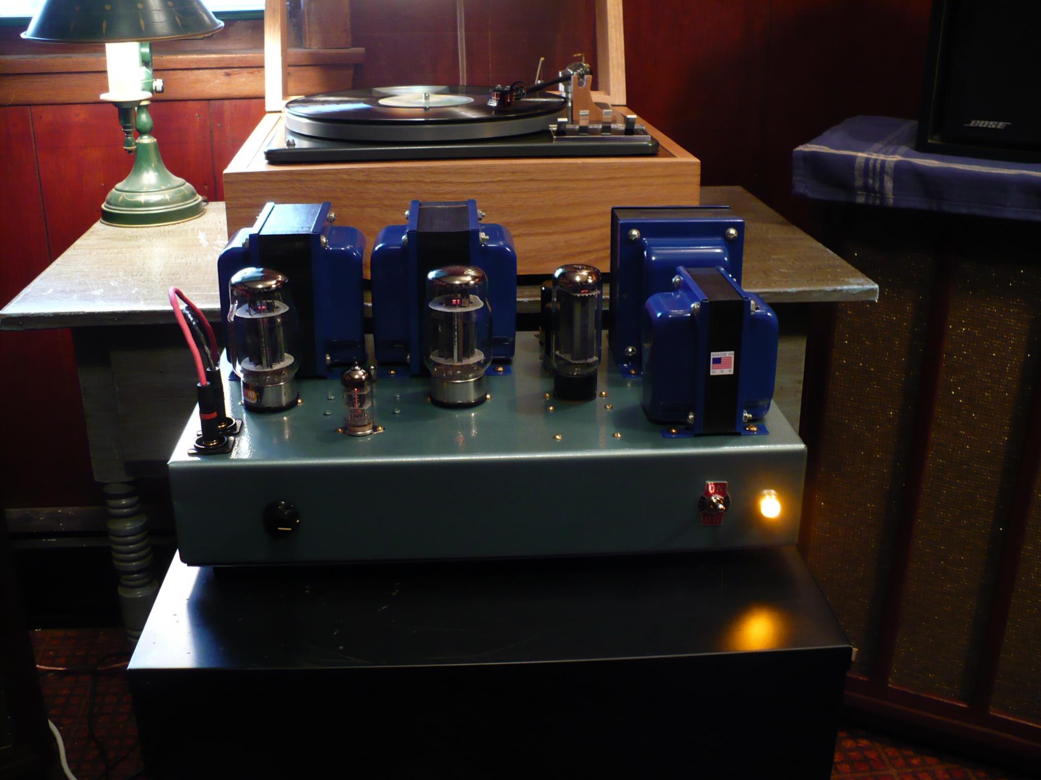

I am very pleased with and proud of this amp. I like Triode mode the best and 8 watts is PLENTY loud on my 89dB Fisher XP-10s. My room is 10x12 with paneled walls and thin carpet. I will definitely be building some full range mid-90's sensitivity speakers next.
Prior to this, I had never even heard a tube amp. So I don't have much of a frame of reference. I can only compare it with my dual mono LM3875 and a Marantz 2230. However, I have done a lot of research and decided on this one because of the reviews, the simple circuit and relatively reasonable cost. Not to mention Scott's outstanding documentation, R&D and continued support gave me a great comfort level. Thanks Scott. I really came to appreciate the amount of work you put in to this kit with a very modest profit.
Listening impressions. Great detail. Pretty "black". It is quiet, even considering that my wiring job probably isn't as tidy as it could be and I didn't use motor run caps. It is a little better in every way compared to the LM3875, but not as much as I expected. That isn't to say the KT88SE is average. It is definitely high quality, but I have a new appreciation for my LM3875 too (especially in bang for the buck). I'm curious what a speaker upgrade would do for both amps.
I can now say that after listening to the KT88SE, I realize what "sound stage" means! It has smooth and rich bass. More than my chip amp.
Nice smooth sound in all ranges. What amazes me is that without tone controls, it sounds perfectly balanced. If I run my Marantz with the controls flat, it sounds lifeless. It takes controls and a loudness button for the 2230 to sound nearly as good as the KT88SE.

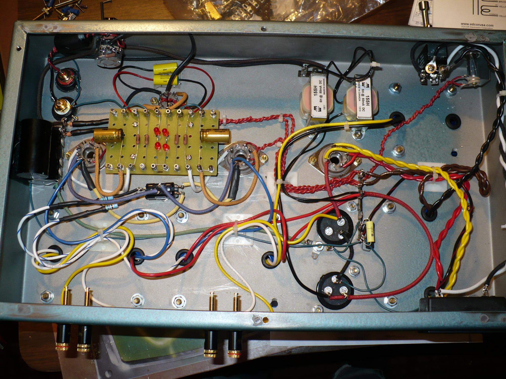

The wiring photo must be before it was finished. I can't see the KT88 cathode resistors.
Did you get 4V bias with the two red LEDs? I had to use 2 green LEDs to get 4V.

Thanks Scott17. The cathode resistors are on the bottom side of the turret board, like Porkchop did. I will add the switch for EL34 operation later. My turret board was too large. That is one of the things I would have done differently. I like the way your kit divides the channels onto 2 separate boards. Live and learn.
In regards to the LEDs....I actually replaced them (after the photo) with the 1K & 100uF in your circuit. I'm not sure I understand, but I read where others are buying batches and "matching" them. That sounded kind of important, so I decided to leave LED's for later.
Another thing I would have done differently would be to orient the tube sockets 90 degrees from how I have mine (key of the tube oriented to 6/12 o'clock vs. 3/9 o'clock). Better view of the filaments that way. Otoh, the mounting screws look better set off to the sides.
