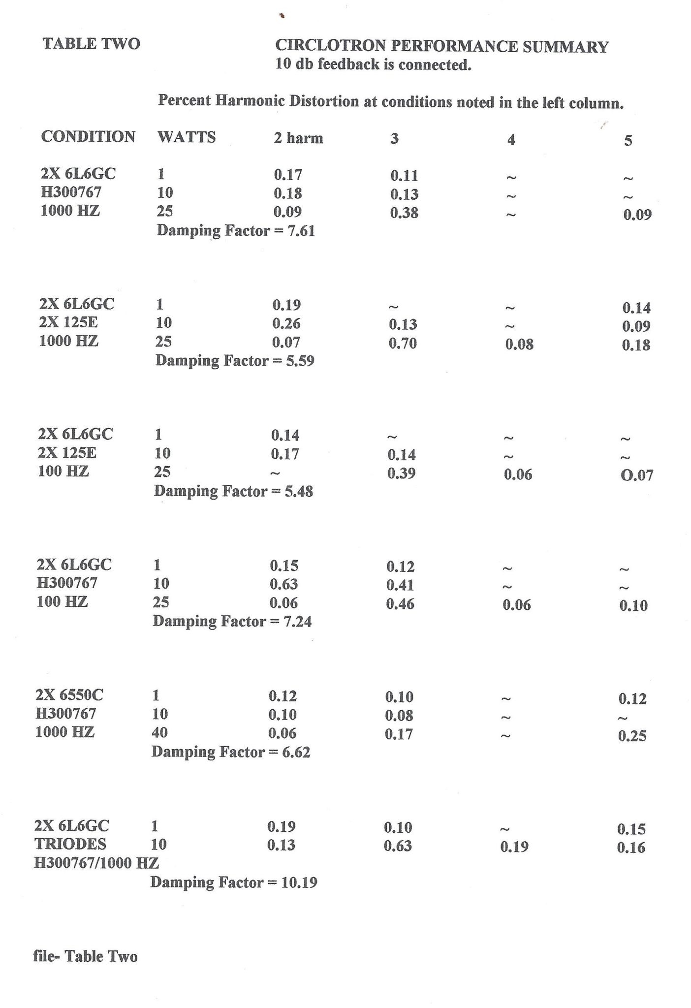

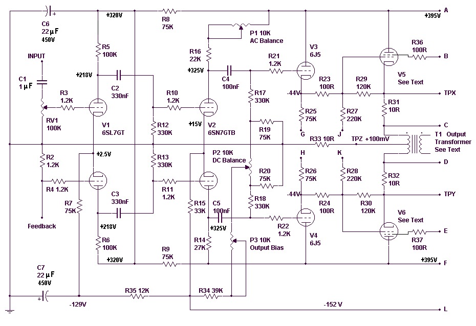

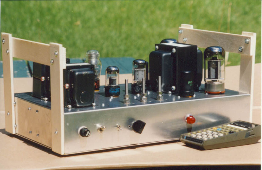

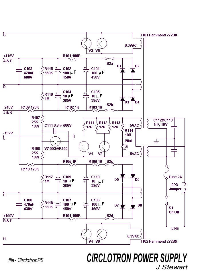

Curse all of the myriad of simulations, I built this one in 2001 as an experimental Circlotron.
And tried three different OPT systems.👍
This project was originally published in the Volume 33, Issue 5 of AudioXpress magazine in May of 2002. It describes a high fidelity vacuum tube amplifier based the Circlotron from the 1950s. The circuit appears to be somewhat involved, but a closer look will reveal all. The primary object is to show what is possible with off the shelf parts & at reasonable cost.
The D% results, with & without NFB speak for themselves. And without the multiple delays as simulations get in the way.
The AC balance Pot is a Mil Spec thing that is able to handle the 2nd Diff Amp plate current.🙂

OK for me the output power is a little low for the HT. Could be screen resistors 220R or could be the driver output hitting the HT rail or the OPT ratio. May not matter. I have 2 pairs of 6550A operation (UL) on 430V HT and this gives 120W rms so 60W per pair @ 430V. So 1 pair of KT88 at 520V maybe 70-80W. It may not matter to you but just check nothing is amiss. You maybe hitting saturation on the driver plates with 33k + 100k and the plate voltage. You may need to increase the CCS a little to lower the plate voltage.
OK. I think your running the LTP cold. The result of this is I think is that the non linearity in the LTP stage and the non linearity approaching 0V on the grid of the KT88 start to cancel. This could of course be total rubbish. The danger is you may not drive the KT88 grid quite fully. The advantage is you won't get blocking.
OK but I would aim to drive the KT88's fully. If the LPT is running out of current then you will get different results depending on the KT88 fitted, your bias and the HT voltage. In my books the design needs to be toleranced even it that means sacrificing some THD. Measuring the grid voltage on the scope of the KT88 will indicate if you have headroom or not.
