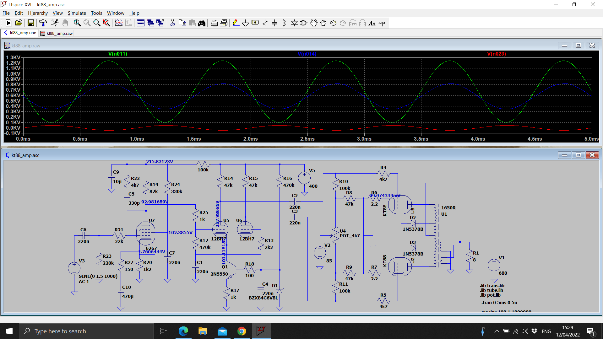

Rather delayed reply, I know . Anyway, what happens when the plate voltage is pulled down below 100 volts in the relative half cycle? I'd be afraid of severe distortions.The 6GB5 works rather well in a UL simulation. I put a 100v zener to the screen from the UL taps to drop the voltage.
Best regards!

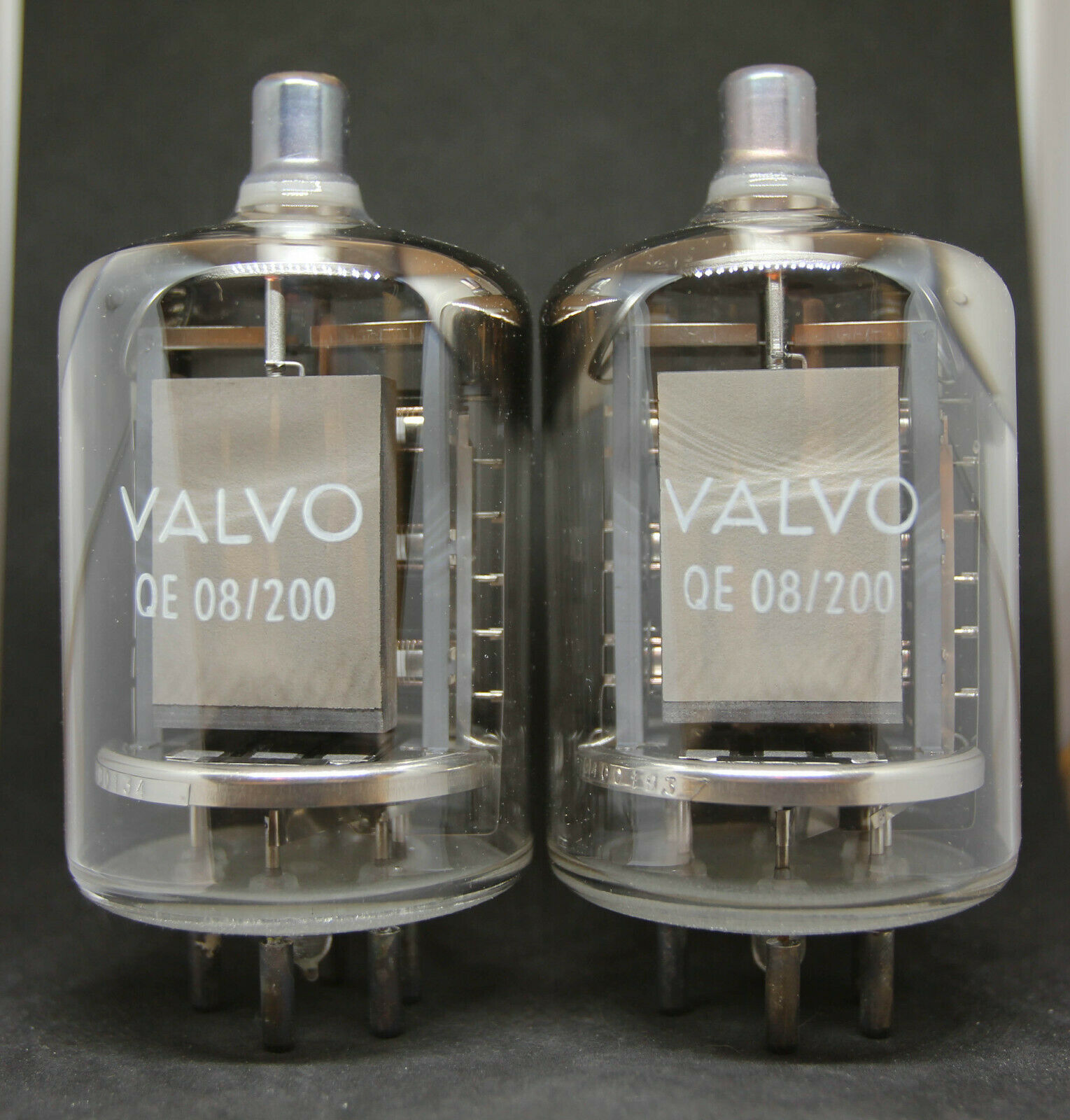

https://frank.pocnet.net/sheets/030/q/QE08-200.pdf
100 Watt, 600V Beam tetrode
may not be that many around though

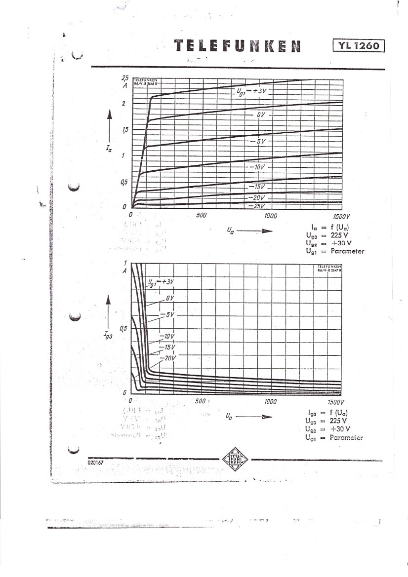

Very, very nice!! Why can't we get production of tubes like this?

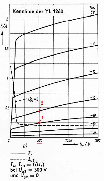

YL1260 plate curves (courtesy of Wolfgang Holtmann at: YL 1260, Tube YL1260; Rohre YL 1260 ID20456, HEXODE )
Looks like the knees might be down around 100V where it could still be used with like 600V B+. Quite linear curve spacing for the top curves. I'll bet it has great triode curves too.
That QE08/200 had high V plate knees, not as nice.
another curve set, courtesy of Davorin:
