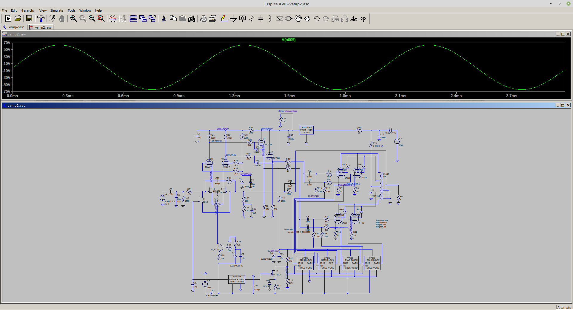

I have to agree will stick with 6550/KT88 cheap. Here's an example of upgraded amp.
