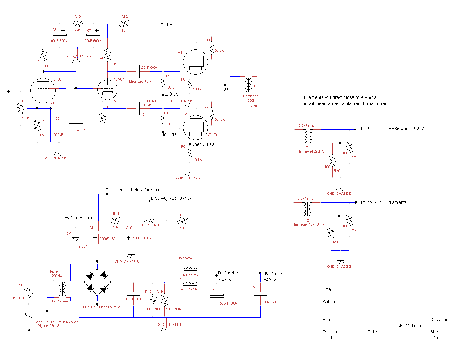

I'm doing a triode connected push-pull project (attached) Already had it running with KT88's many years back but never had the tools to measure anything.
Sooo...4 or 8 ohm tap? Ya I'll measure it when I get it built....
I'll post my progress on this project. So this post will be it for the project for all those interested.
I'm using a new power transformer for my KT120 version over what I used with the KT88 version (Hammond 290HX). PSU Designer II gives a B+ of ~460v. It has a 420mV rating so it was my choice for the project. My previous transformer only had a 250mA rating and sagged a wee bit as I recall.

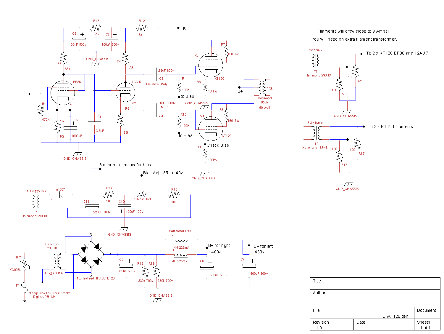

Have you built and tested the bias circuit feeding off the tap of the power transformer? Just today I was modeling a similar circuit and it does NOT work. I think it is because there is no direct ground reference for the bias circuit. The ground reference is created by the full wave bridge rectifier. If the transformer had a ground tapped into one of its windings it would work.
It's not obvious, but as long as the grid is not pulling current (and it shouldn't) the ground reference is through the FWB and the bleeder resistors. No current, no voltage drop across the two 330k resistors in parallel.
It should work.
Oops - I neglected the 30k voltage divider to set the bias... That could be a problem...
OK, this got me curious... The 290HX has a separate 100V winding that is likely being used for the bias. If so, all is good 😎
As long as he is using the separate 100v winding all is fine. If he is coming off the center tap of the secondary as the diagram suggests it won't work in my opinion.
And indeed, looking at the 290HX data sheet shows a 100v 50 ma winding which I suspect is being represented by "98v 50ma" tap in the schematic.
...I would never have noticed it except for having thought of trying to do that just today...
I would consider (for less ripple but probably not really necessary) a full wave bridge for the bias supply.
Ya I will use a full wave bridge in the bias supply...this ain't no stinkin' guitar amp! Thanks!

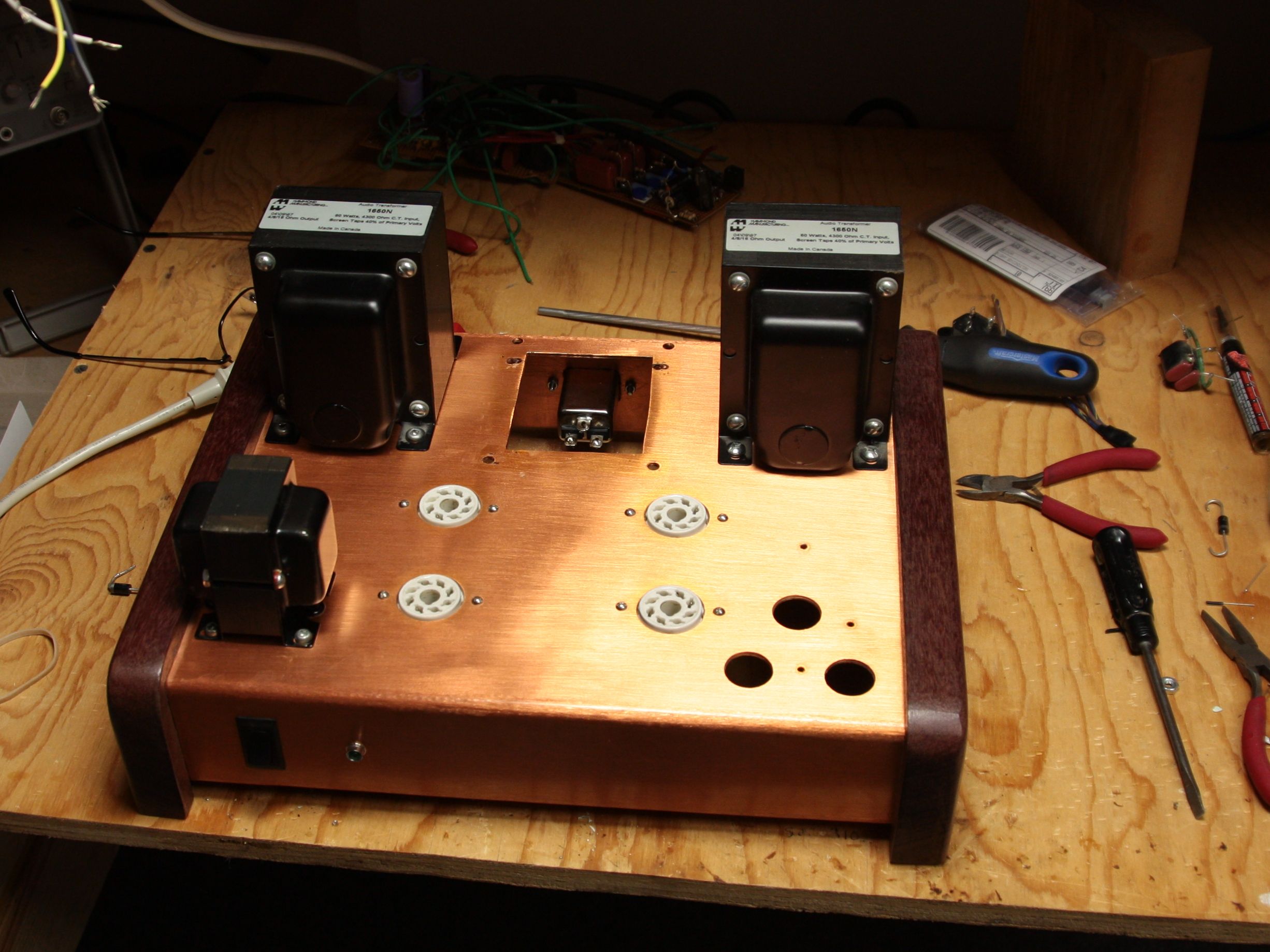

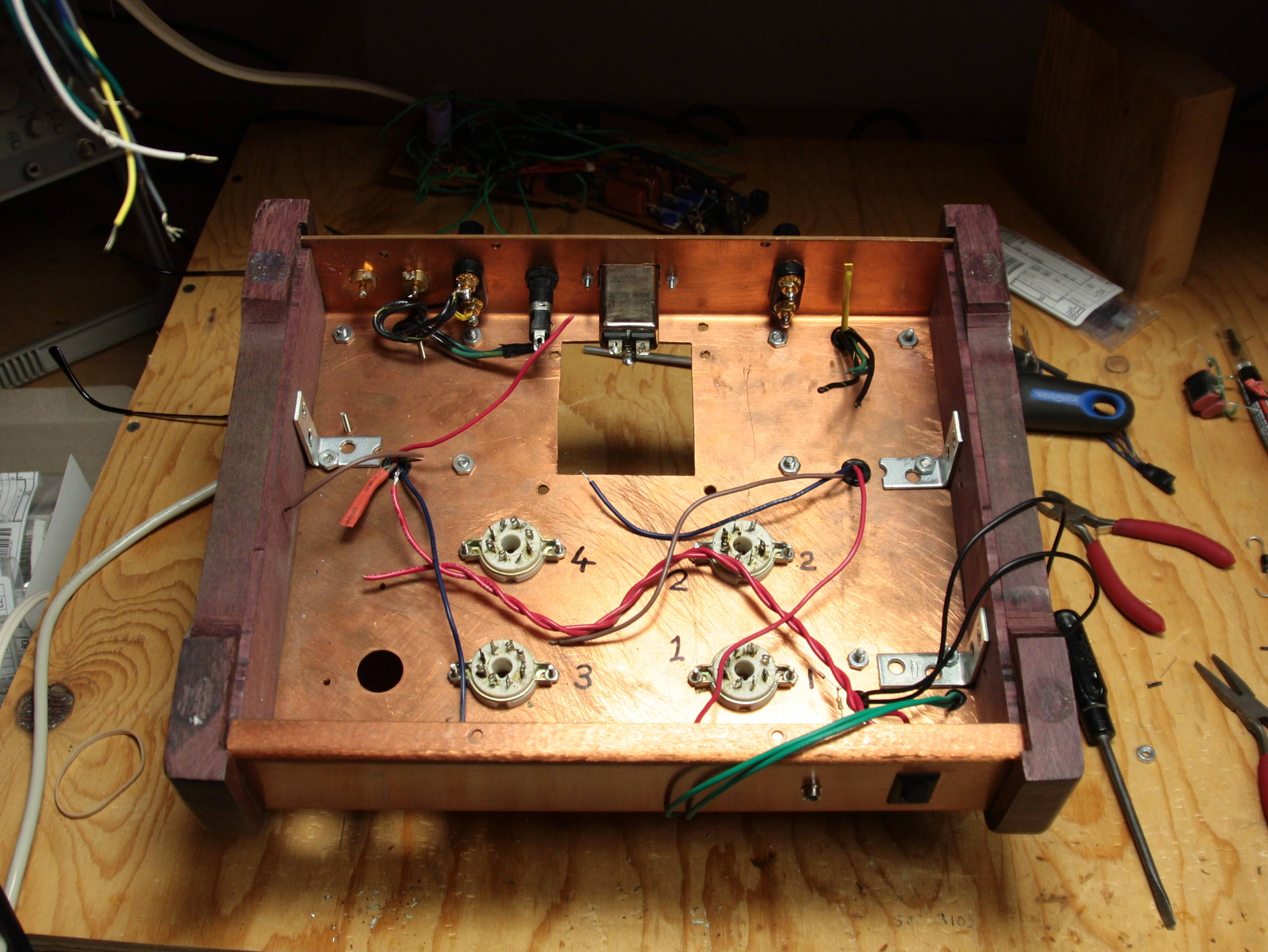

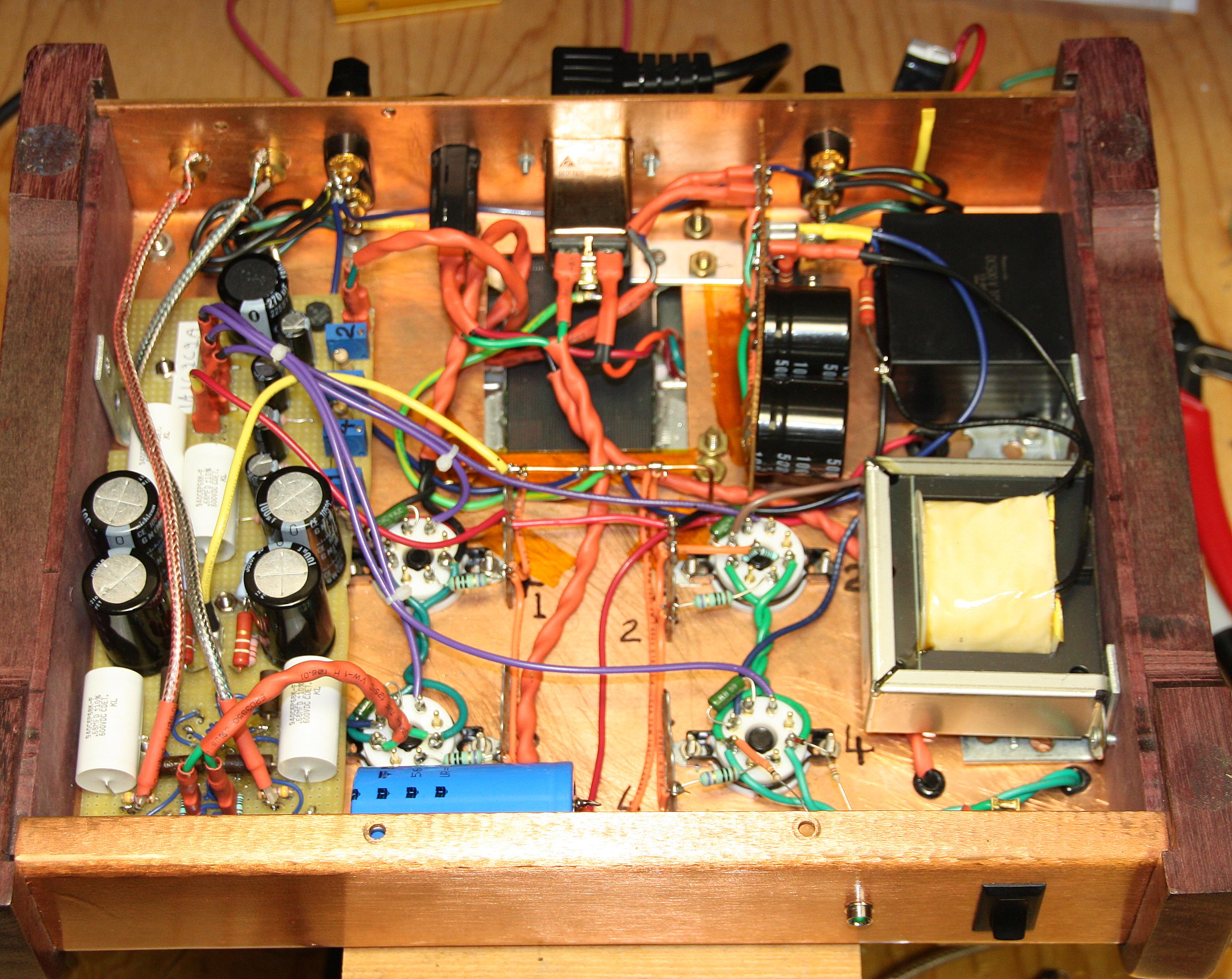

Attached are the now stripped down previous KT88 project chassis.

First ... you have not designed a "triode-mode" amplifier. Sorry. You're using pentodes, as pentodes. [And I've got no problem with that. Good work!]
Second ... I'm glad you put in the separate B- supply - the first drawing wouldn't have worked as you expected, I think. [Then again, with an additional capacitor it would have worked ... as a voltage multiplier does! but that's a different story]
Third ... its not clear why you're using that poor little 12AX7 as the phase splitter ... when at full power operation the output tubes may well want current draw on their grids. I recommend at least considering socket-and-pin compatible higher current relatives, such as the 12BZ7, 12AU7, etc. The BZ is a particularly sweet tube, overall. You would need (and want) to drive it with more current though, choosing 11K cathode/anode resistors.
Fourth... since you're using a pentode ("cascode on the cheap") in the front end - always kind of ballsy in an audio forum site like this - why not keep on with the pentodes? They work great where the 12AX7 is in the circuit. Ultimately, the phase splitter is acting as a cathode follower - where the anode resistor is "along for the ride" (and thus accomplishes the phase splitting/inversion). So... why not use a tube whose IV characteristics are so much squarer and less dependent on cathode-to-plate voltage? Dunno... I would sub.
Your work looks good. Keep it up.
GoatGuy
The phase splitter is a 12AU7. Other schematics (By noted "designers") I have seen are using 47k resistors....I went with the 33k's which I will use as my starting point and see how it measures ...thanks for the tip.....it would appear I can go to 16k there easily with my 12au7. The 12BZ7 sounds like a tube I must try! Thanks!

deriving B- bias from centertap dual-use winding
Even with a cap in series with the diode I could not get it to work. The problem is not where it is tapped off, the problem is the ground return.
I accept that. Voltage-multipliers are the height of "non-obvious how they work" devices. I could dig something up that DID work for me ... but unfortunately The Man now requires that I ... Get Back To Work.

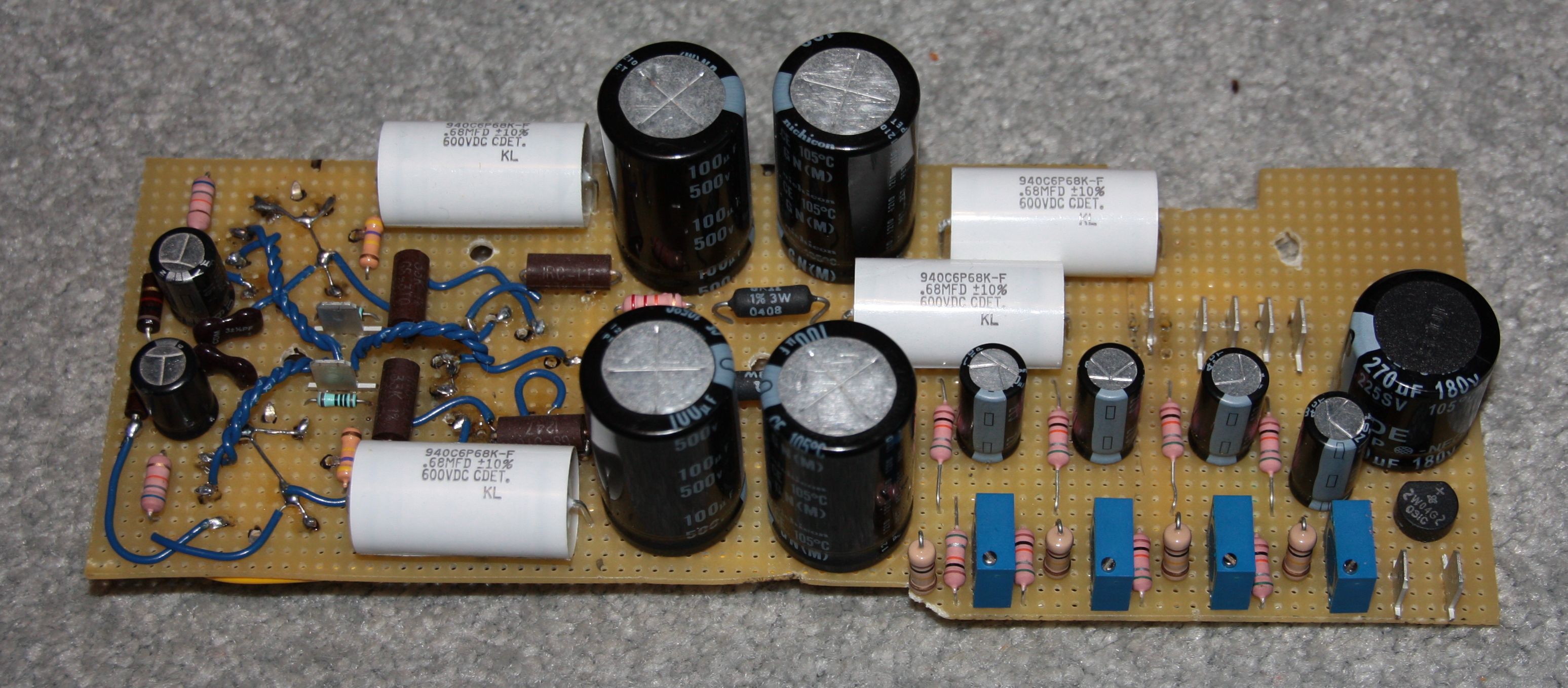

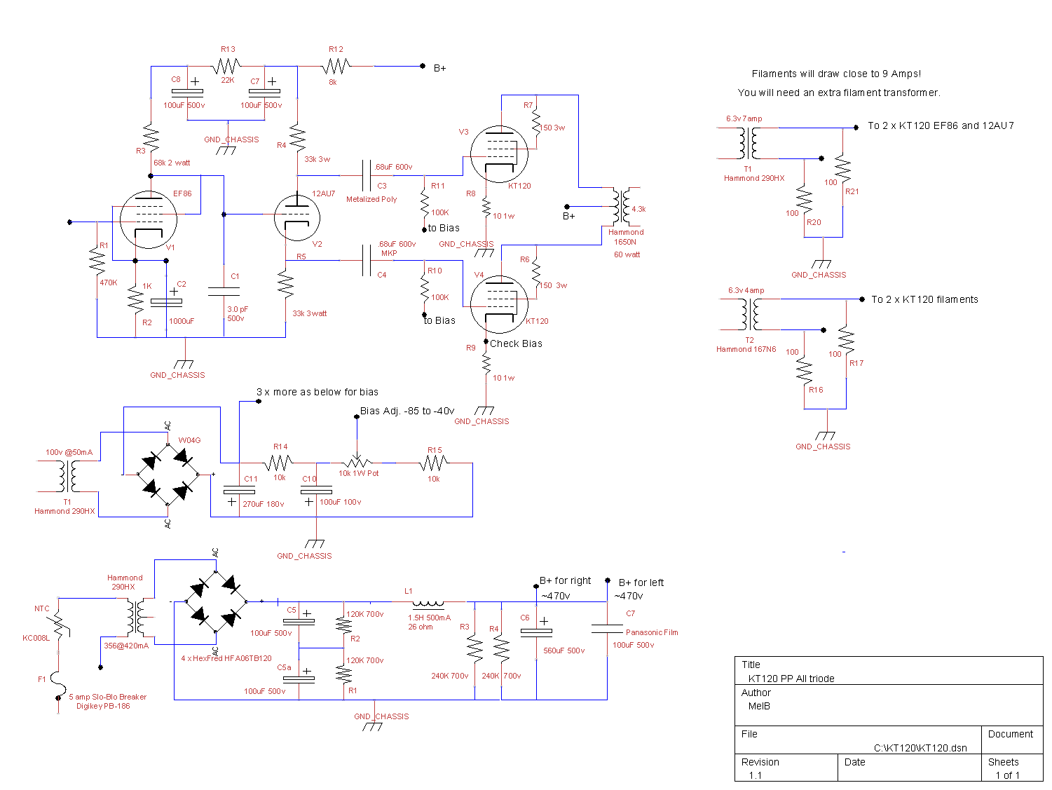

Finally got to it. Nice winter project. Got it all hooked up. Going to bias at 60 mA per tube and do some testing now.

That looks sweet, I was wondering how you would solve the space issue😀 the PCB looks nice to.
Edit; on a cautionary note, glue everything on that board down whit hot glue, I've had heavy capacitors ripping the soldering joint on some of my projects.
GoatGuy said: Sorry. You're using pentodes, as pentodes. [And I've got no problem with that. Good work!]
No problem for me either. But as in the schematic, with the screen grids connected (via stoppers) to the plates, that is triode connection 🙂
I googled around for EF86-triode specs. Found the Klausmobile test for 6J32P wired as triode (Russian equivalent to EF86). Tube Tester Files - 6J33P (EF86)
It says the amplification factor is about 25 to 32. Let's say it's 25.
If you have a 1.5V rms input signal at the input, that's about a 2.1V peak input.
If the amp factor is 25, then the max output from the first (voltage amp) stage is about 50V peak.
That will be going through the cathodyne phase-splitter stage, which will have a gain of about 0.9, so that 50V gets chopped down to about 45V peak to the KT120-triode output stage.
Is that enough to drive KT120's to full power at the operating points you're running them? Or are you using a preamp with gain in front of this amp?

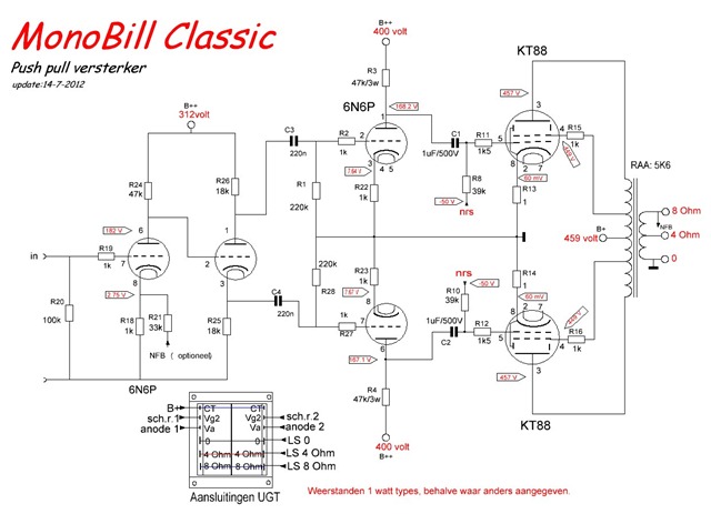

Never seen triode connected 6550's/KT120's driven by only a triode voltage amp and Phase splitter. You need a push pull driver as well.
Will have very slow dull sound.

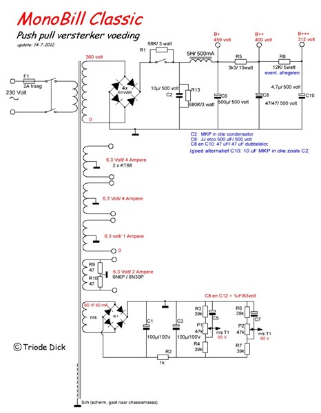

Take a look at this well designed KT88/6550 amp and it has an ultra linear output stage much easier to drive than triodes. Does your Out put transformer have ultra linear winding's? You may get better results using Ultra linear Or pentode. Dynaco used such a simple driver for Ultra linear KT88's as they are very easy to drive.
Phil
