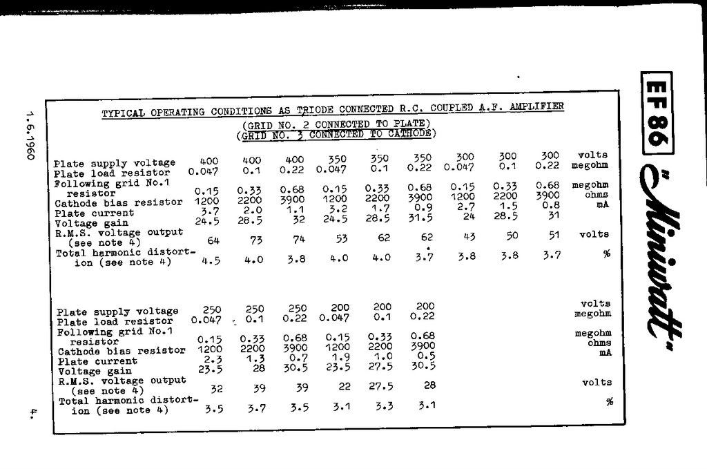

I googled around for EF86-triode specs. Found the Klausmobile test for 6J32P wired as triode (Russian equivalent to EF86). Tube Tester Files - 6J33P (EF86)
It says the amplification factor is about 25 to 32. Let's say it's 25.
If you have a 1.5V rms input signal at the input, that's about a 2.1V peak input.
If the amp factor is 25, then the max output from the first (voltage amp) stage is about 50V peak.
That will be going through the cathodyne phase-splitter stage, which will have a gain of about 0.9, so that 50V gets chopped down to about 45V peak to the KT120-triode output stage.
Is that enough to drive KT120's to full power at the operating points you're running them? Or are you using a preamp with gain in front of this amp?

Datasheet: http://www.r-type.org/pdfs/ef86-1.pdf
The EF-86's are biasing up with a B+ of 350v and then 142v on the plate and 3v on the cathode (3mA)

Cool. Figure 2V rms = 2.8V peak.
2.5V(25) = 62.5V
I guess that leaves the question of what the bias is on the KT120s. If the bias is less than or equal to about -55V (grid to ground) then you should be able to use the amp without a preamp with gain.
Whether or not a 12AU7 cathodyne is capable of driving the grid capacitance of the KT120-triode with low distortion and no slewing is a separate question. There's a formula for figuring that out somewhere...

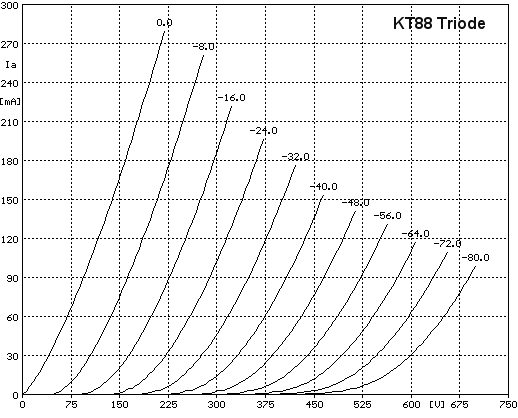

If you look at the KT88 data, in the Push Pull. Class AB1. Cathode Bias. Triode Connection section, it says that with plate voltage = 400V, quiescent plate current = 76mA (each), into a load of 4k ohms plate-plate, the grid bias should be about -40V.
I've attached KT88 triode curves from Sofia. They suggest that KT88-triode could be used at about Va = 450V, Vg1 = -48V for Ia = 75mA.
That doesn't use all that the KT88-triode is capable of, but would be a reasonable op point, and would just barely work with the driver stage proposed. I'm not saying I think the proposed driver stage is a great solution, I'm just saying it should work. Of course, I may have missed something or be mistaken about something. I welcome corrections, since that's how ya learn, right?

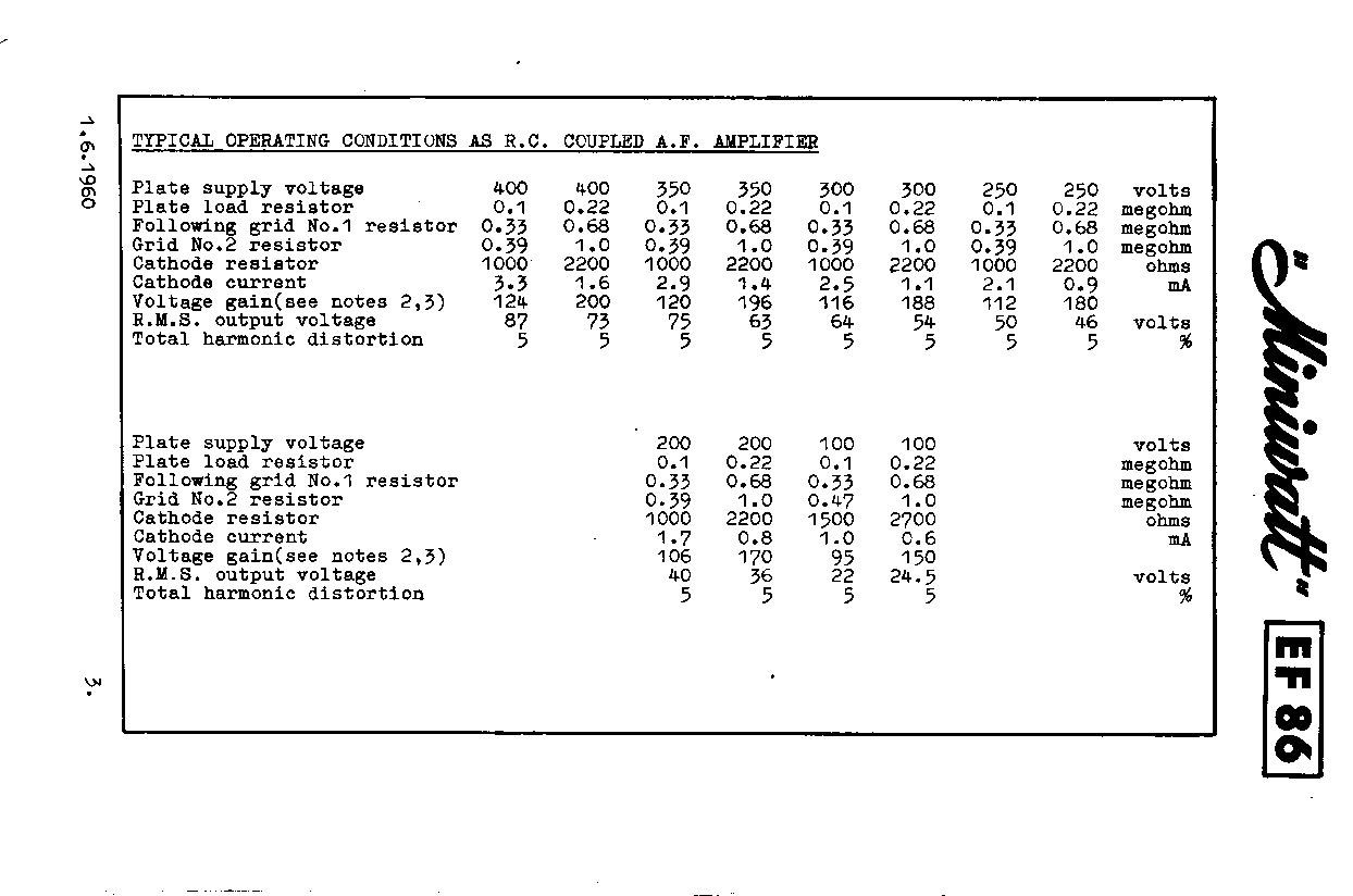

ef86 data for Pentode and triode.
Data for EF86.

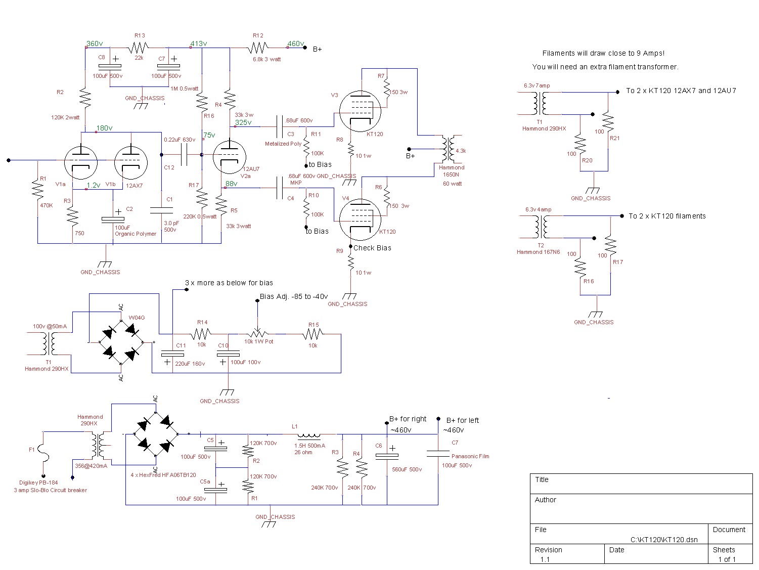

After trying a bunch of different configurations I have come up with the attached schematic.
It makes 30 watts at 3.2% distortion and 10 watts at 1% distortion with no feedback. This is using the 8 ohm connection on the Hammond 1650N into a 6.8 ohm resistor. Next thing I will do is put in my KT88's to see how they compare
I found out you are not going to be able to directly connect a 12ax7 to a cathodyne no matter how hard you try and still have enough drive. I got the grid bias idea for the cathodyne from the Valve Wizard. (See his page on Cathodynes)

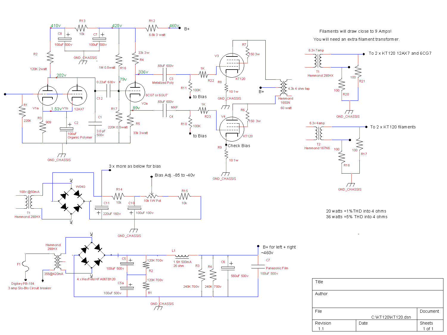

Nice. Finally got some 6CG7's. Swapped one in for the 12AU7 in the circuit and I am getting 30 watts out with only 2.2% distortion now.
Melb.
You should try 6GU7/12BH7 Much lower plate resistance than the 12AU7 and 6CG7.
The 6GU7 even has the same pin out. The Russian 6N6 has even lower plate resistance so even better and again the same pin out as the 6CG7. 12Ax7's make very poor drivers due to the high plate resistance.

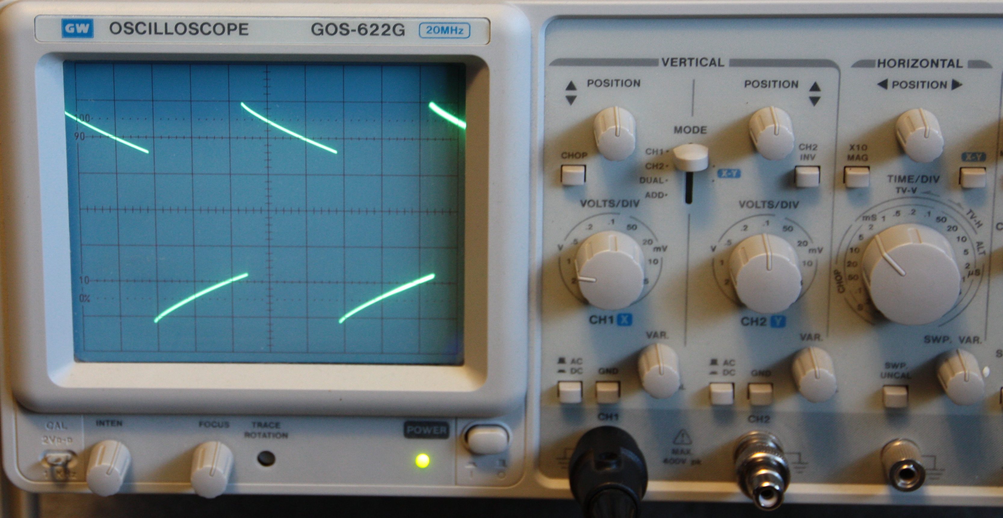

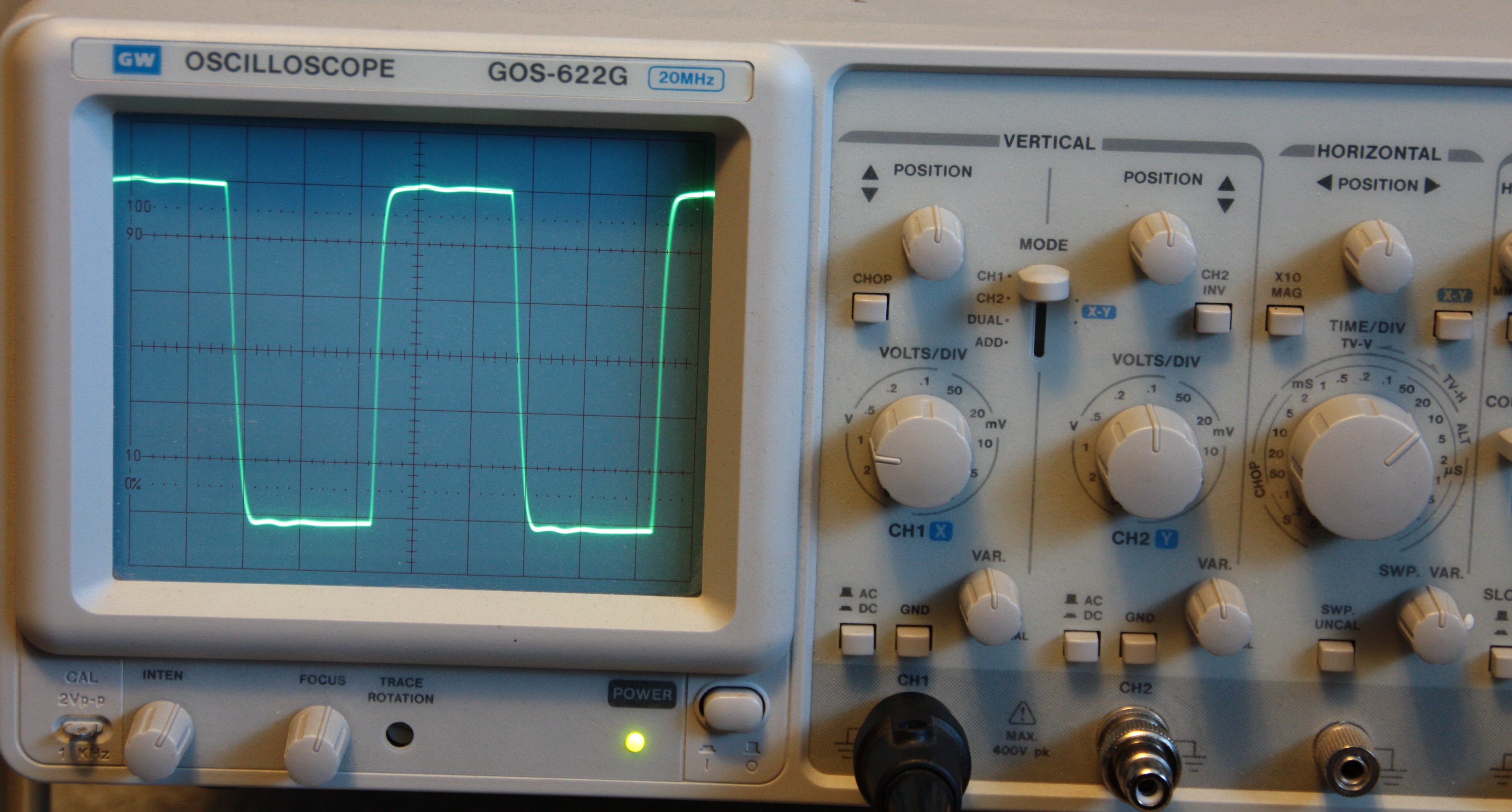

I tweaked the resistor values on the driver (12ax7) and this was the best I could get. I'm hoping at this point I'm driving the KT120's to their max.
Here are some scope shots at 100, 1000 and 10K square waves...I think it looks pretty good! And the final for now schematic.
This thing sounds pretty darn good.
