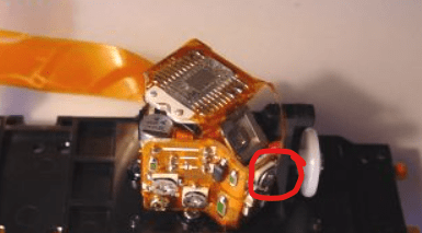

I think so. It will be the preset closet to the laser diode itself. The last three digits of the pickup serial number should be the factory set laser current, for example ending in 593 would be 59.3 milliamps calculated from the volt drop across the emitter resistor of the laser diode regulator transistor.
Thanks for the info Mooly. I'll soon try to turn the potentiometer and read the laser voltage with an oscilloscope. 1.2V/(22)Ohm = 54.5mA laser current,
so it should be something.... HF = 1.2V is probably new. Laser voltage at 800mV, less current will flow through the laser diode,
I will increase it to 1.2V and see if CDs can be read well.
1.2 volts pk/pk is the normal RF level and it should not be lower than that. Make sure if you are using a divider probe that the probe is correctly compensated as any error in the probe trimmer setting will greatly effect the pk/pk value on the scope screen.

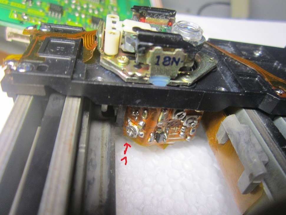

I just turned the pot left and right, it's very difficult to get to it because it's installed at an angle. And no, nothing has changed. HF remains at 800mV.
The marked red 1 potentiometer must have a different function. I have little experience with expanding the KSS272A. Those who have experience with Sony cdp x339 should write. Maybe you can't adjust the laser current on this model?
That is strange.
I would very carefully look at the print from that preset and see if it follows what your earlier diagram of the pickup shows. The preset should go to pin 2 of the chip.
Not everything about the KSS272A is recorded in the Sony Servicecircuit diagram CDP-X339. I found other KSS272A PDF. It seems to be an automatic laser current control. APC 2.2k there is a control. Can be seen below in the circuit diagram. Yesterday I turned the TB tracking bias potentiometer. I thought it was the laser current potentiometer, but it wasn't. At the moment it's running again since I turned on the TB tracking potentiometer I turned. I noticed the position. I'll leave it like that for now Greetings Chris
The APC circuit is similar in any pickup with the optical power of the laser being held constant at a level determined by the preset adjustment. The current is varied to achieve this constant optical output and that is why the actual current is such a good guide to the laser condition and why it marked on each pickup via the serial number. If the current is higher by 10% or more then the laser diode is considered deteriorated.
Are there any (HF)RF amplifiers that are tuned to 1.2V? And laser current amplifiers that are connected directly behind the laser. It's very complex You would probably have to calculate the laser current through the series resistance. U/R = I I still have a lot of unanswered questions, it's not that easy to understand everything. I won't twist the Polti APC automatic power control at first. I'm afraid that the laser will receive too much power and will soon become defective. You also have to remove the laser unit, I don't know how yet. I won't be turning the pot on the device anymore. There's probably no voltage test point for Focus Gain , Tracking Balance either?

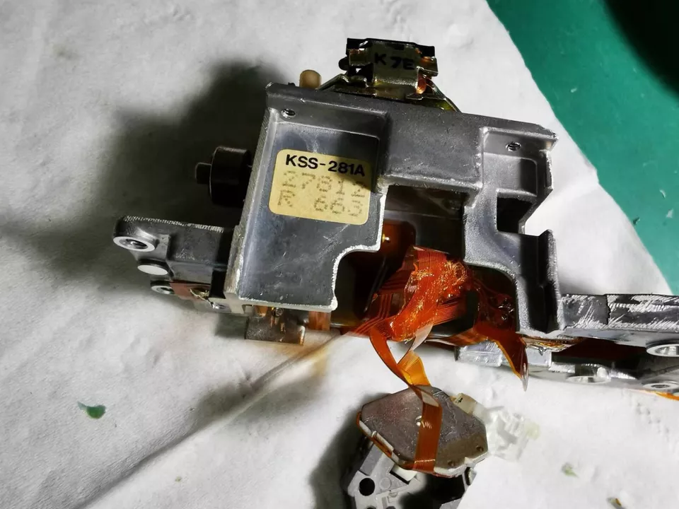

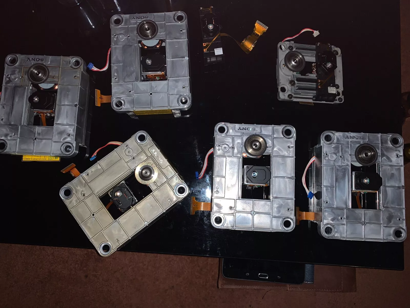

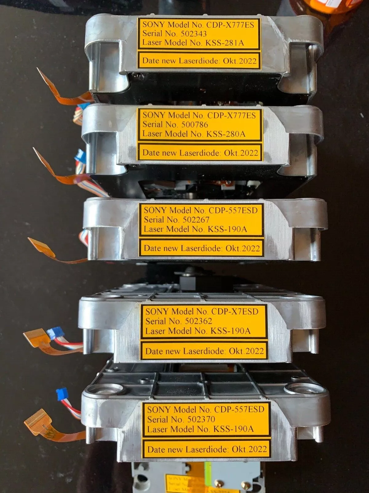

I agree - go to images in post #10+15 underMany laser units have been replaced in the past while they were not defective at all. This concerns the KSS-190A as well as the KSS-281A and the KSS-272A. Often there are other defects and misalignments, and the laser is thought to be the culprit when it is not.
For now, 35 years later, prism and lens needs to be cleaned, at least, because they all got polluted which affects the final SQ.
https://www.diyaudio.com/community/...v-dead-transport-section.410367/#post-7637179
This Sony servo board is mostly in use with laser unit KSS-272A - the BSL motor board "1-641-763" probably in some other additional models.
Leaked caps are here to observe very often (with all consequences).
Nevertheless I remain convinced that hardly any other laser unit has a shorter lifespan than the KSS series due the laser diode, the foil (flat) cable and the plastic suspension of the lens - go for some images to
https://vintage-audio-laser.com/A-l-atelier-page-69
The fact that reliable laser units like JVC Optima series or Sanyo's SF-91 are still available - even as NOS versions for reasonable costs (in opposite to the KSS-units for SONY ES and Accuphase) is proof of this for me.
