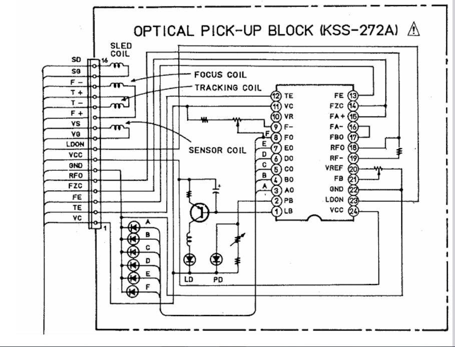

Hallo Leute
I also have reading problems with Sonx cdp339Es.Laser unit is KSS 272A.
The KSS272A has 3 three potentiometers.Is there a potentiometer for laser current increase?
I have already measured RF(RF0) =800mV very little with Osziloscop. Sony states 1.2Vss?
I think my laser is blocked malfunction
But I would increase the laser current.
I found a Picture KSS272A, but where it says RF there is only a solid resistor.
Gruss Chris

The preset next to the diode marked PD on your diagram is laser power... but adjust at your own risk...
I have replaced the laser diode assemblies in about half a dozen units over the years which always fixed my tracking problems. Sourced from Liberty on Ebay. But wondering why I never hear of people using Blu-ray players and running into separate Dac stand-alone units. Tried this recently and had excellent sound from this combo. As good as any of my complete CD players through the years (NAD, Cambridge, Phillips, Sony, Onkyo)
- Digital Source
- KSS-272A Don't blame the laser diode, It's the lens
