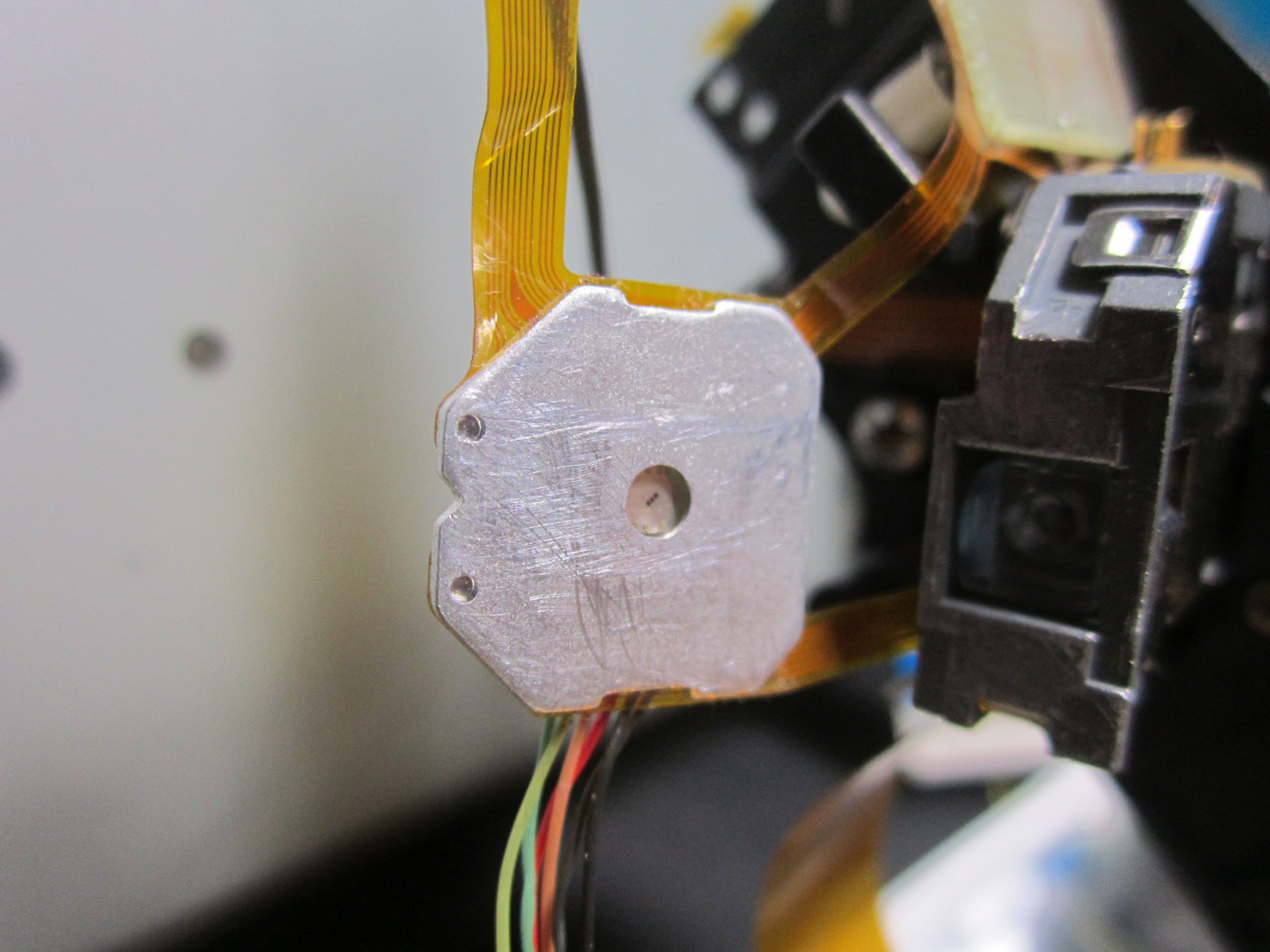

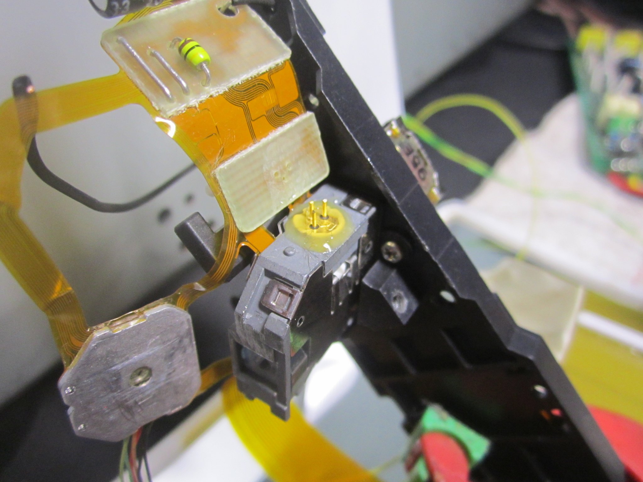

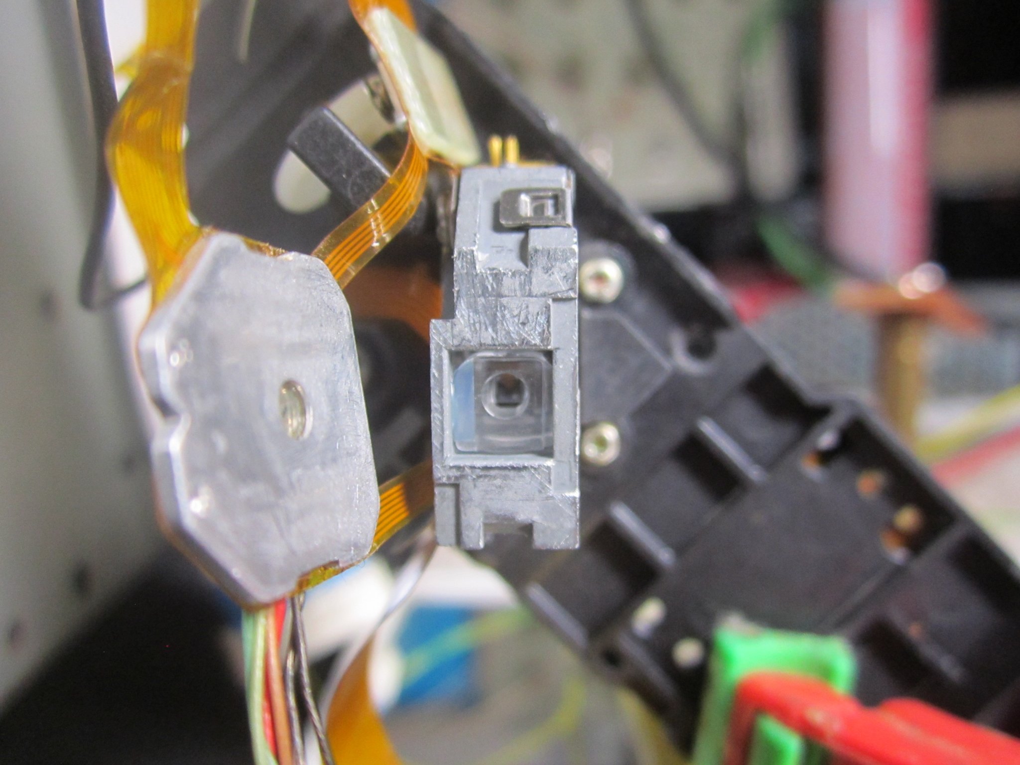

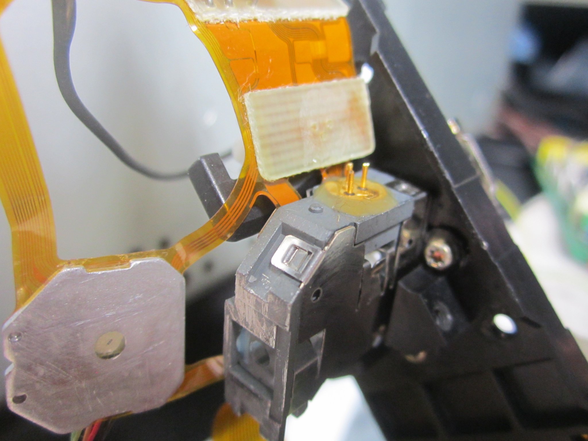

A member of this forum sent me a KSS-272a for to try to repair, maybe to replace the laser diode. Well, first of all, I see laser power. It was right, about 120uW. It looks that laser diode was right. So, I replaced the potentiometers, because original potentiometers are very hard to manipulate, and another thing, this potentiometeres are of 2K2, however it measures 1k9, they was out of tolerance. I replaced the electrolitic capacitor, original measures was right, but I don't confide in 90's Nichicon capacitors. Then, I tried to adjust the laser pickup. One, two afternoons trying to adjust, and nothing, it can barely read. What was happening? It looks like it find the right signal shape, but then it get lost. What can I do? I replaced the lens, and now it is ok. Why the original lens is bad? I don't know, it has a good aspect, but it does not work right. It a bit mess to adjust the lens position, but with a 8cm size CD it can be adjusted. Another problem, is that if unscrew the potentiometers board to adjust the potentiometers, the board get board stumble with the motor, and the CD can't read the TOC, a mess...
And yes, it is necesary to adjust the azimuth screws located beneath, yes, a mess...
Well, now it working. The only doubt is how to adjust TB(tracking balance), because following the service manual method don't works.
Needless to say that original laser diode was not replaced.
I still question why the lens is bad, and why it happened.
Moral: Don't blame the laser diode at first sight.

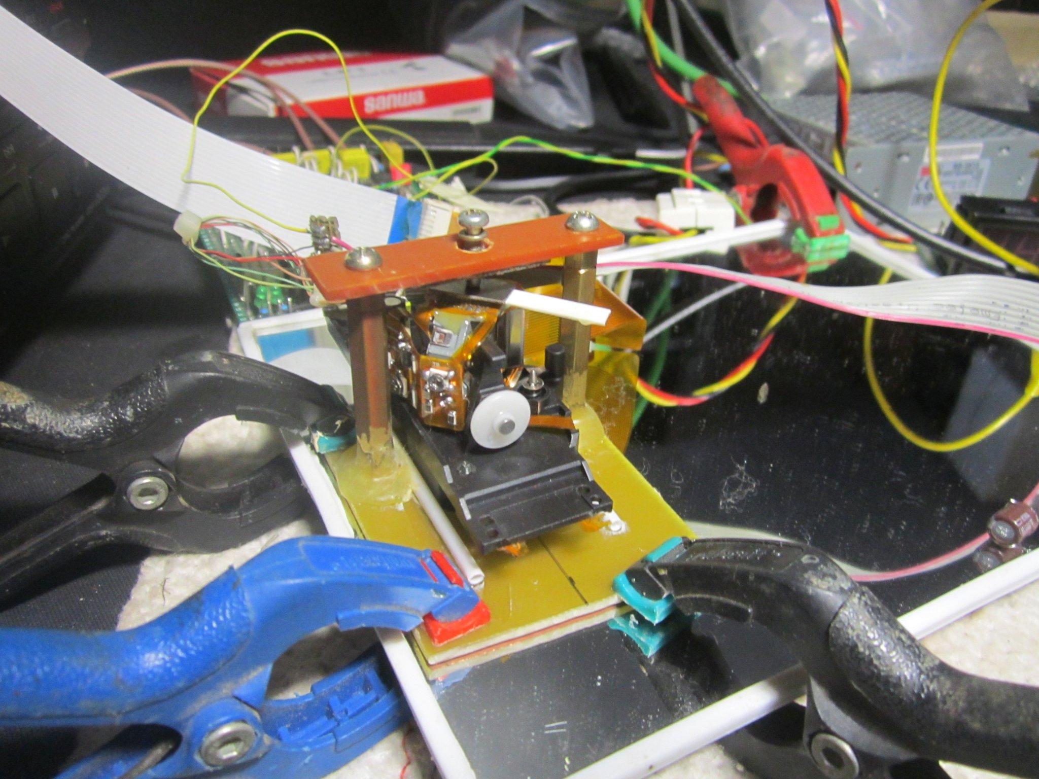

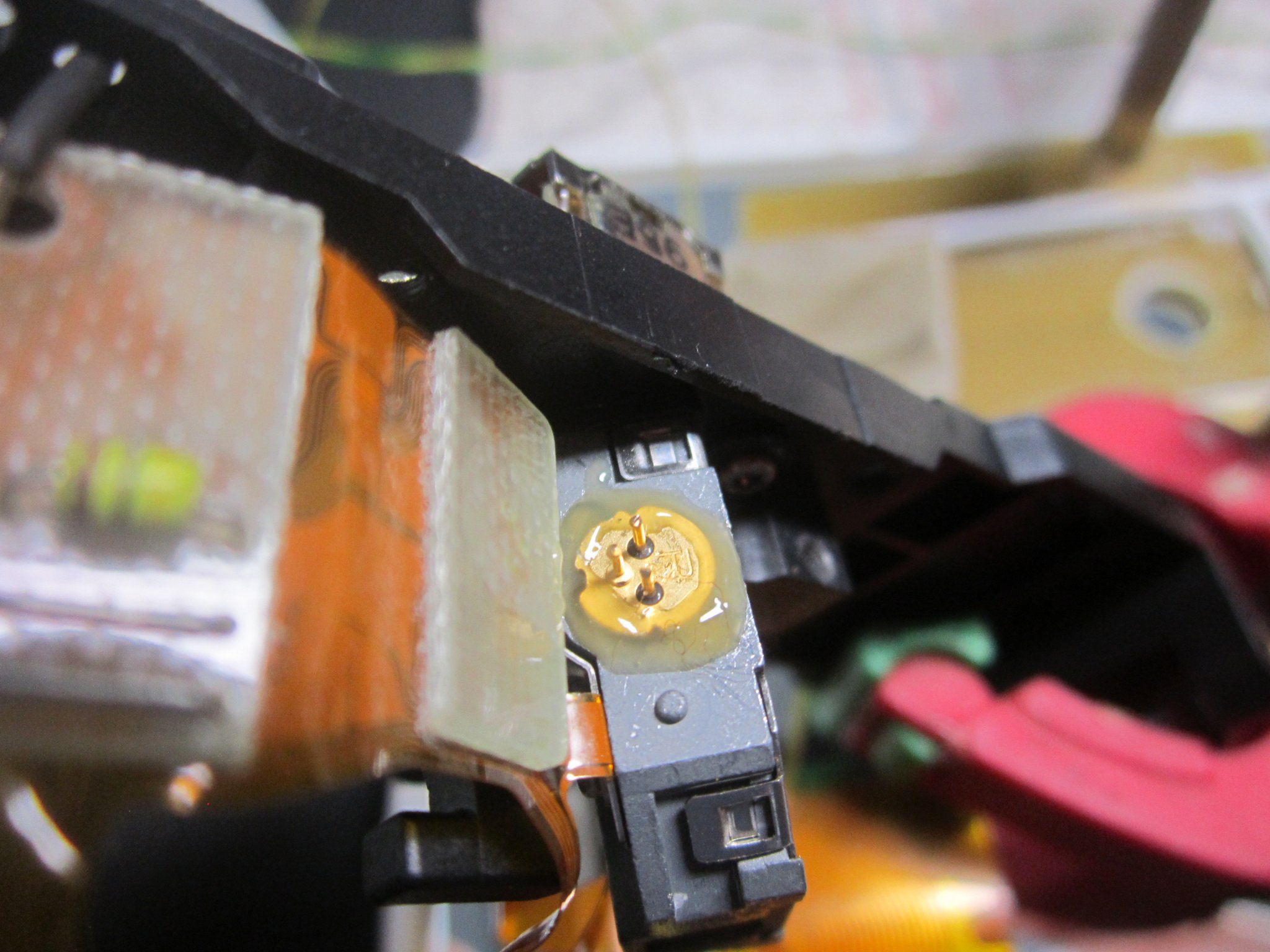

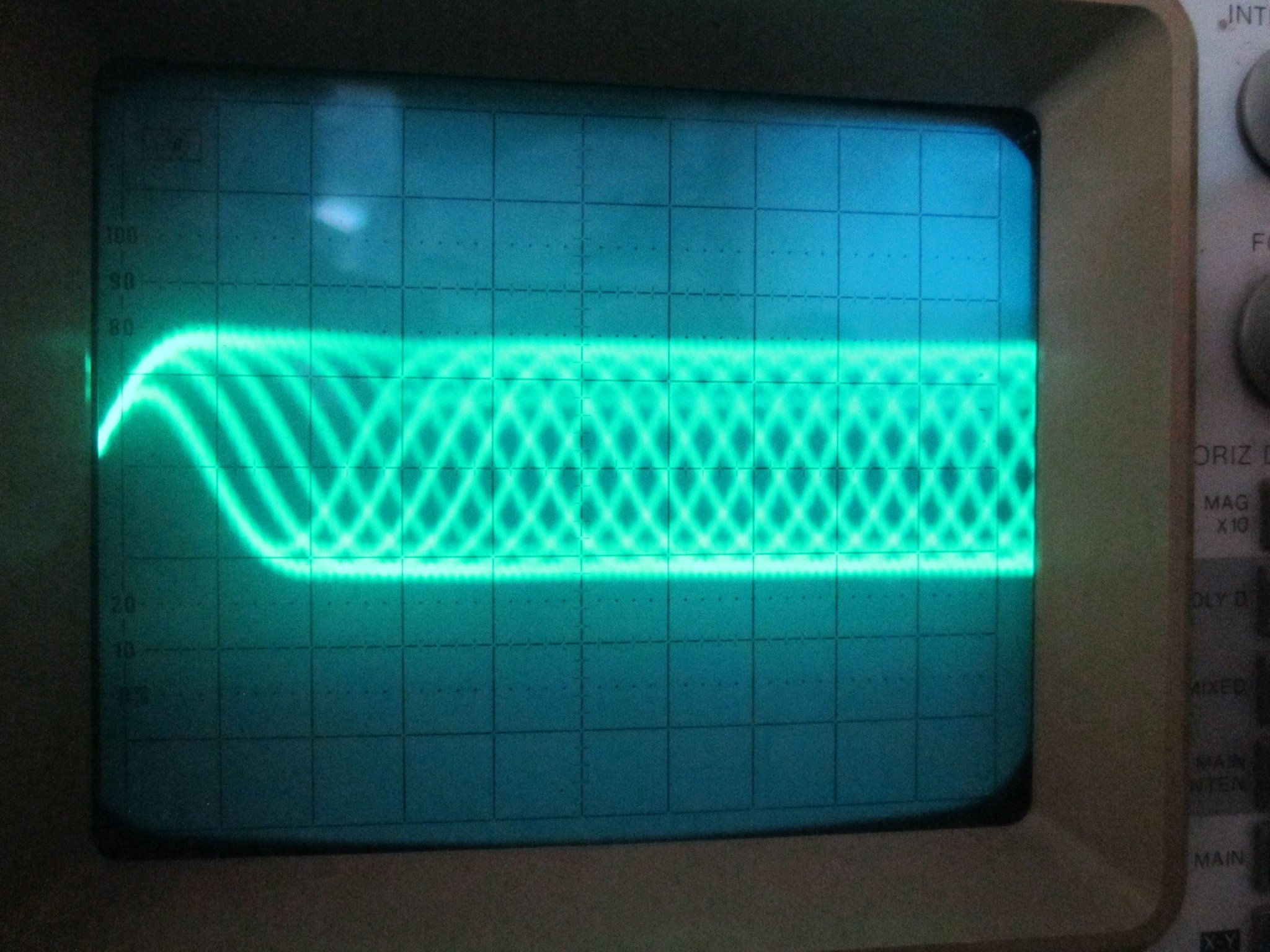

Another update. After adjusting and more and more adjusting, and RF signal perfect, and can read original CDs in bad state, but, however, it happens the following: It can't read CD-Rs.
Don't mind if the CD-R is well recorded: It can read CD-R.
However, it can read original CDs in bad state.
Something happens.

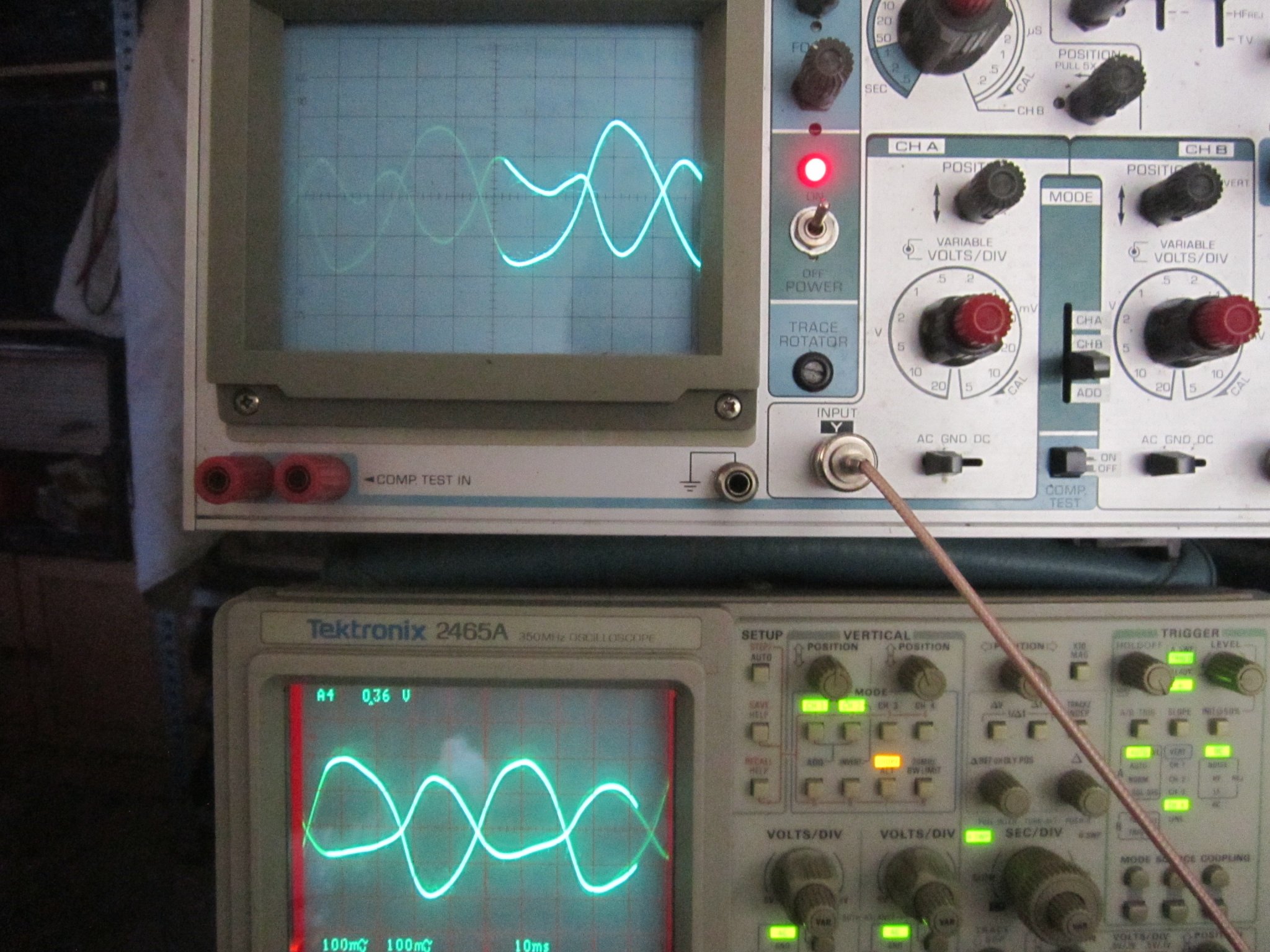

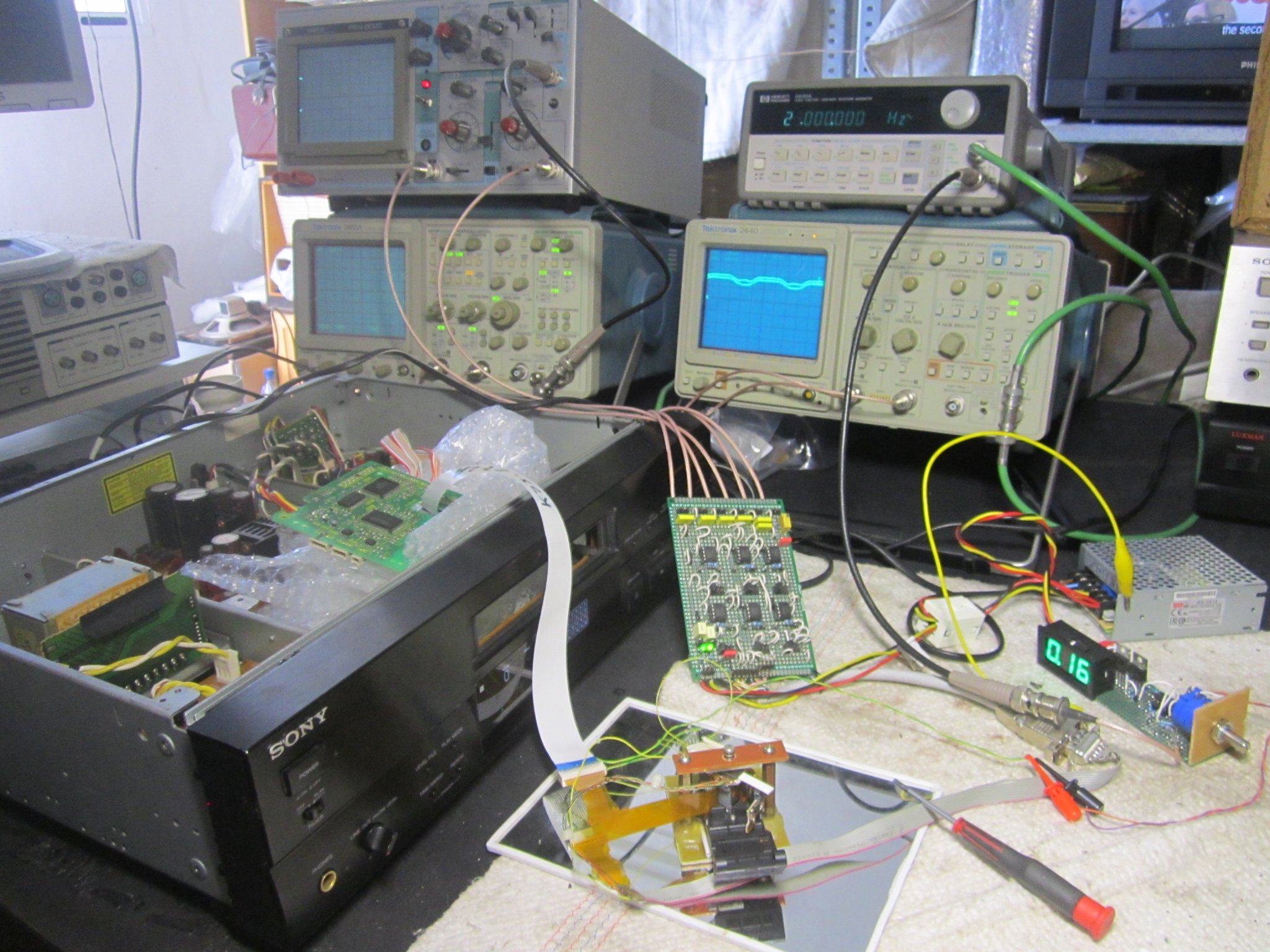

I connect all the stuff for to see the A-B-C-D-E-F diode signals, the same stuff I use for to replace and adjust a burn out laser diode.
And I see this: The signals, the sinus, are not symetrical. When I modify DC Focus Voltage its evident.

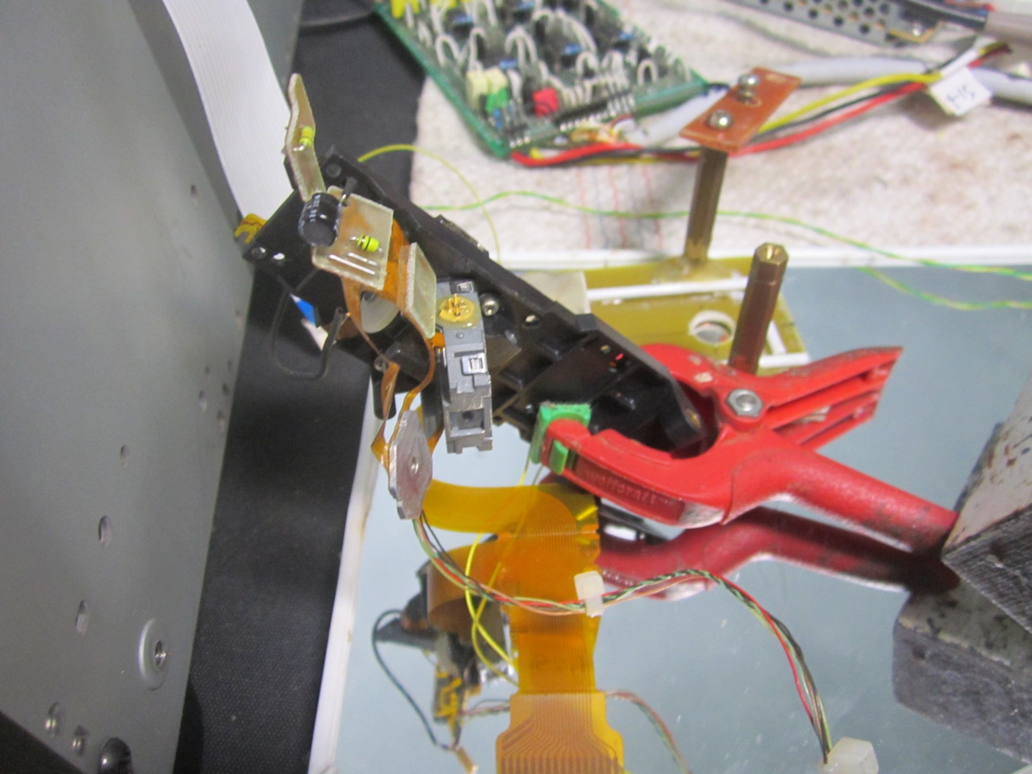

Now I'm tired. What do I'll do? I'm thinking to trasplant the Fotodiode Opic for anogher KSS-272A that I broke this same Opic. Maybe is just a little factory adjust fail, but I don't want to do more experiments.

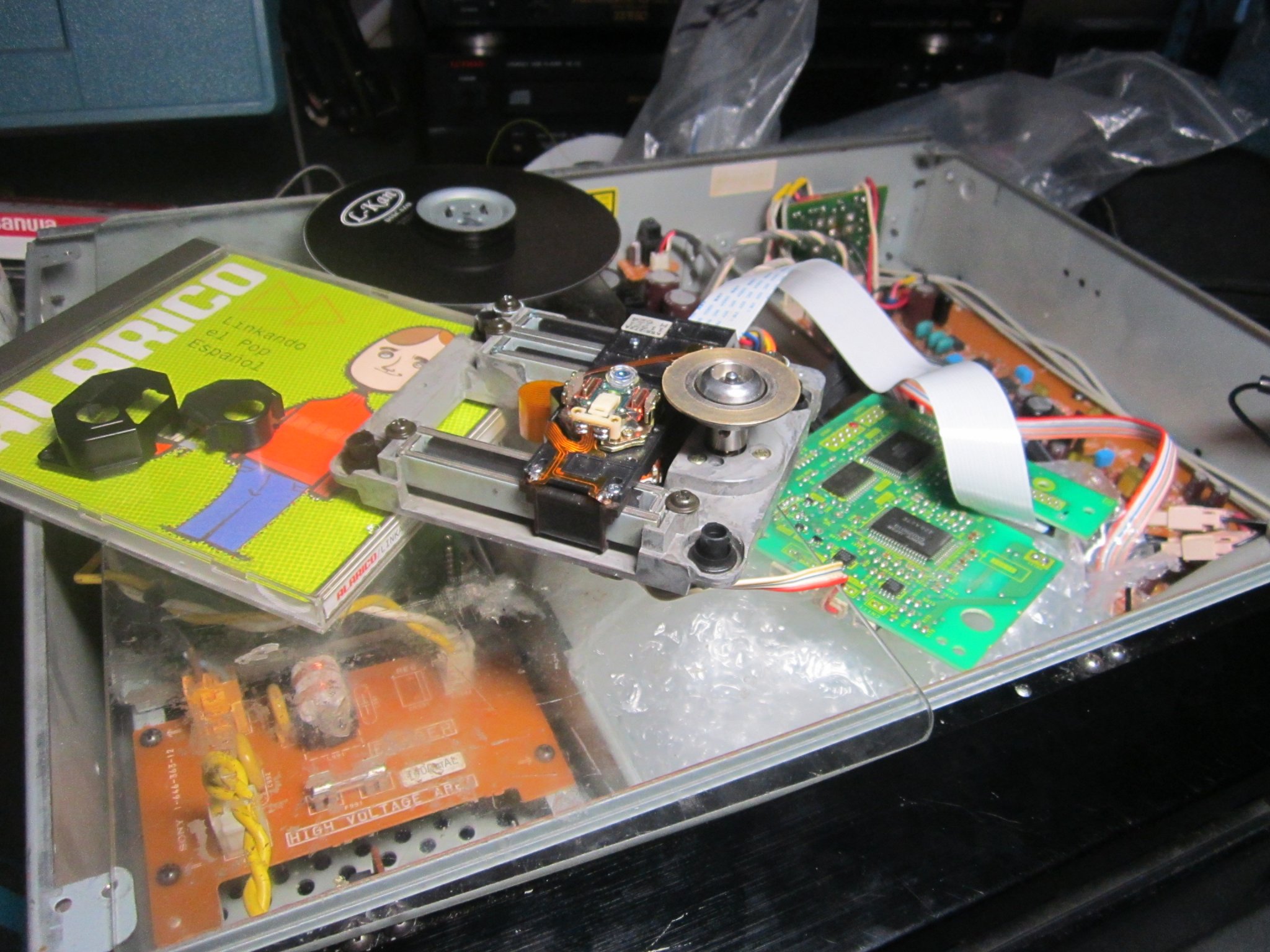

And the pleasure of listen an old cd player that you have repaired? And there are another thing that some people does not understand, repair, try to find any explanation for a difficult fault, target the solution, and repair, is a very strong drug. Try to know how to repair some things, like cd laser pickups, is something that make me feel alive. When you know that this cd player is working thanks your knowledge, music sounds better.
In 2 afternoons one could have digitized many CD's (one often hears that that is too time consuming....) I don't enjoy CD's anymore since at least 15 years and never regretted anything. In fact I scrap every CD player as optical days are over because of wear-out, age, lack of spare parts and the large footprint of device and media. Of course I do know the joy of being able to repair or build stuff that is why I suggested to build an audio player. That is, of course, if the main goal is to playback music. It is just a suggestion!
So, should I replace the laser diode if the original is OK? I think is the best option. It don't worth to keep a used laser diode, if you have the option for replacing.
So, I started over again.

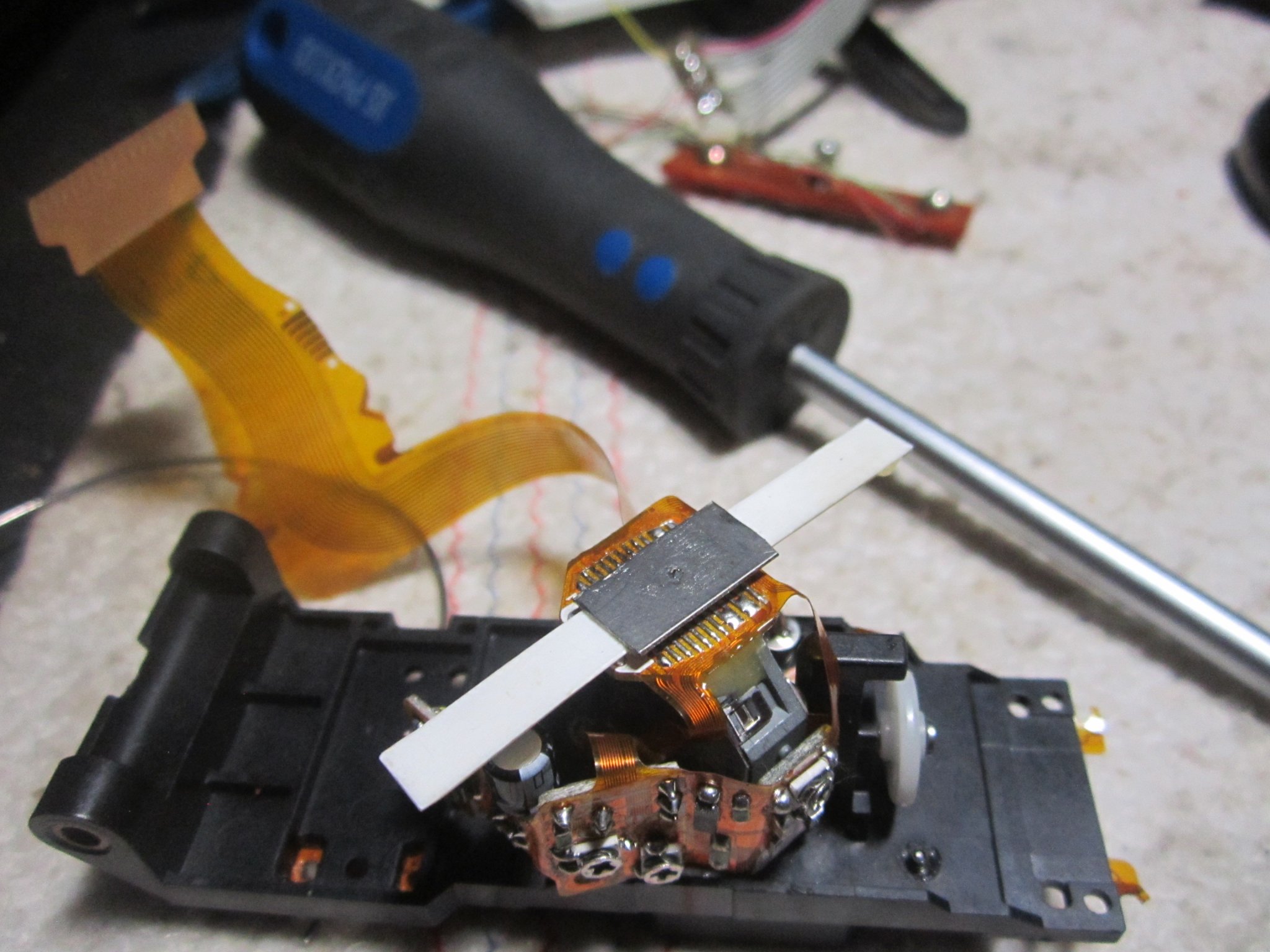

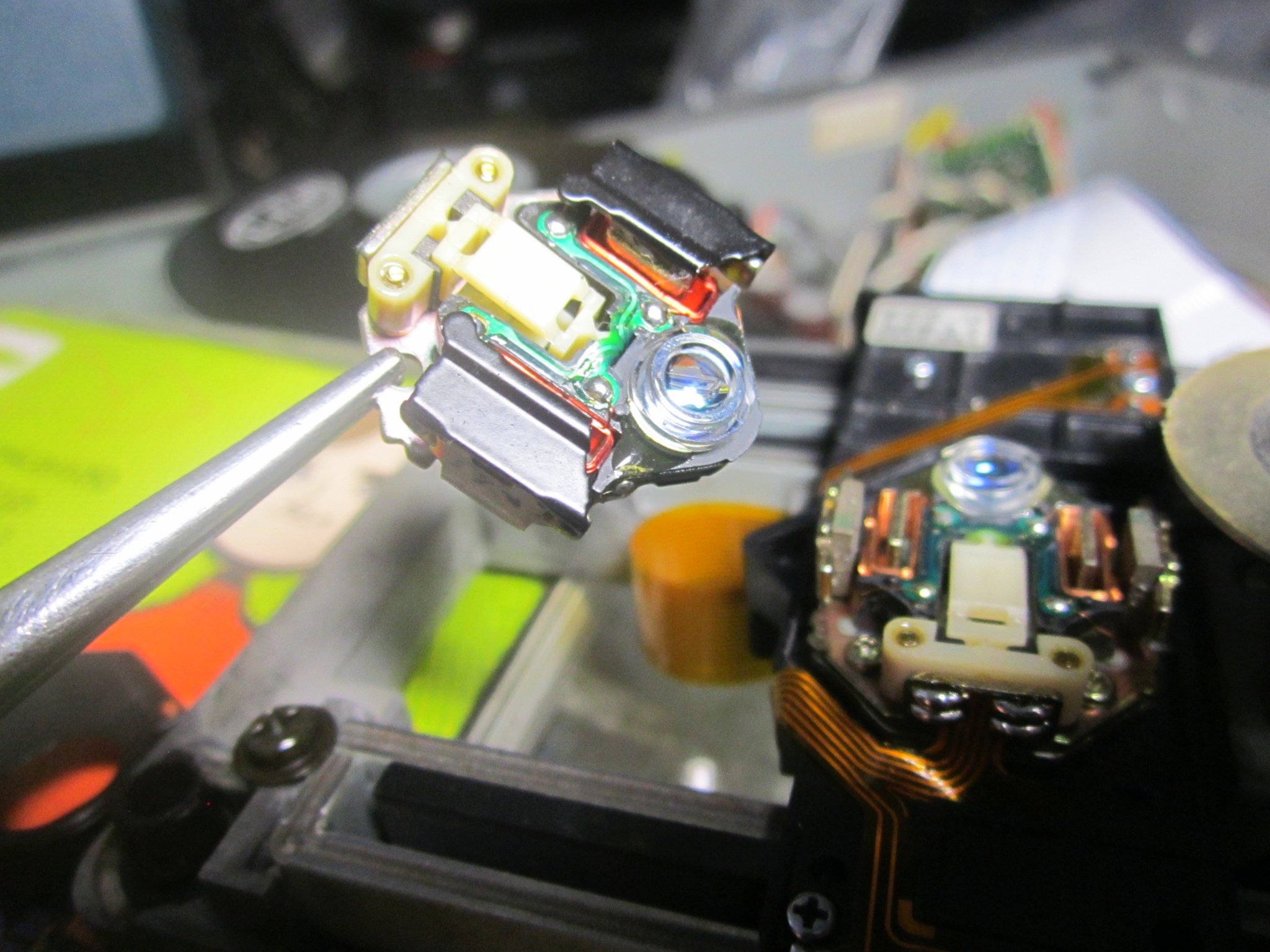

Finally, I replaced the lens, the laser diode, I've adjusted the OPIC-Photodiode Array, and now is working flawless.
The question: Is the lens bad? Why the laser pickup was bad ajusted? It was bad adjusted at factory, or it was material fatigue?
I don't know. Now it can read all discs, CD-R, scratched discs, etc...
KSS-272A performs a bit better than KSS-151A, KSS-190A and KSS-152A.
As anecdote, when the laser pickup is in the workbench with the oscilloscopes, is very very sensitive to vibrations. Are lasers used for to detect vibrations, earthquake, etc..?
