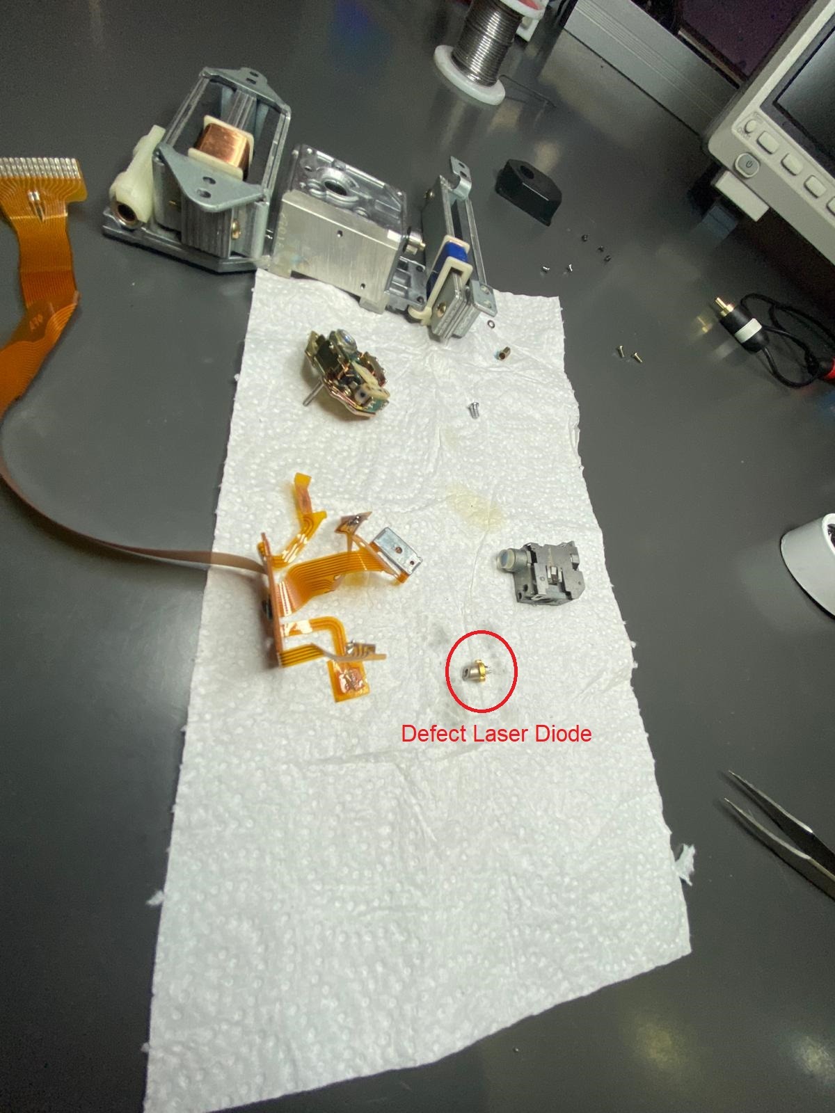

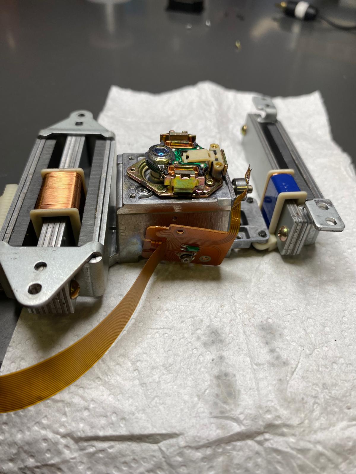

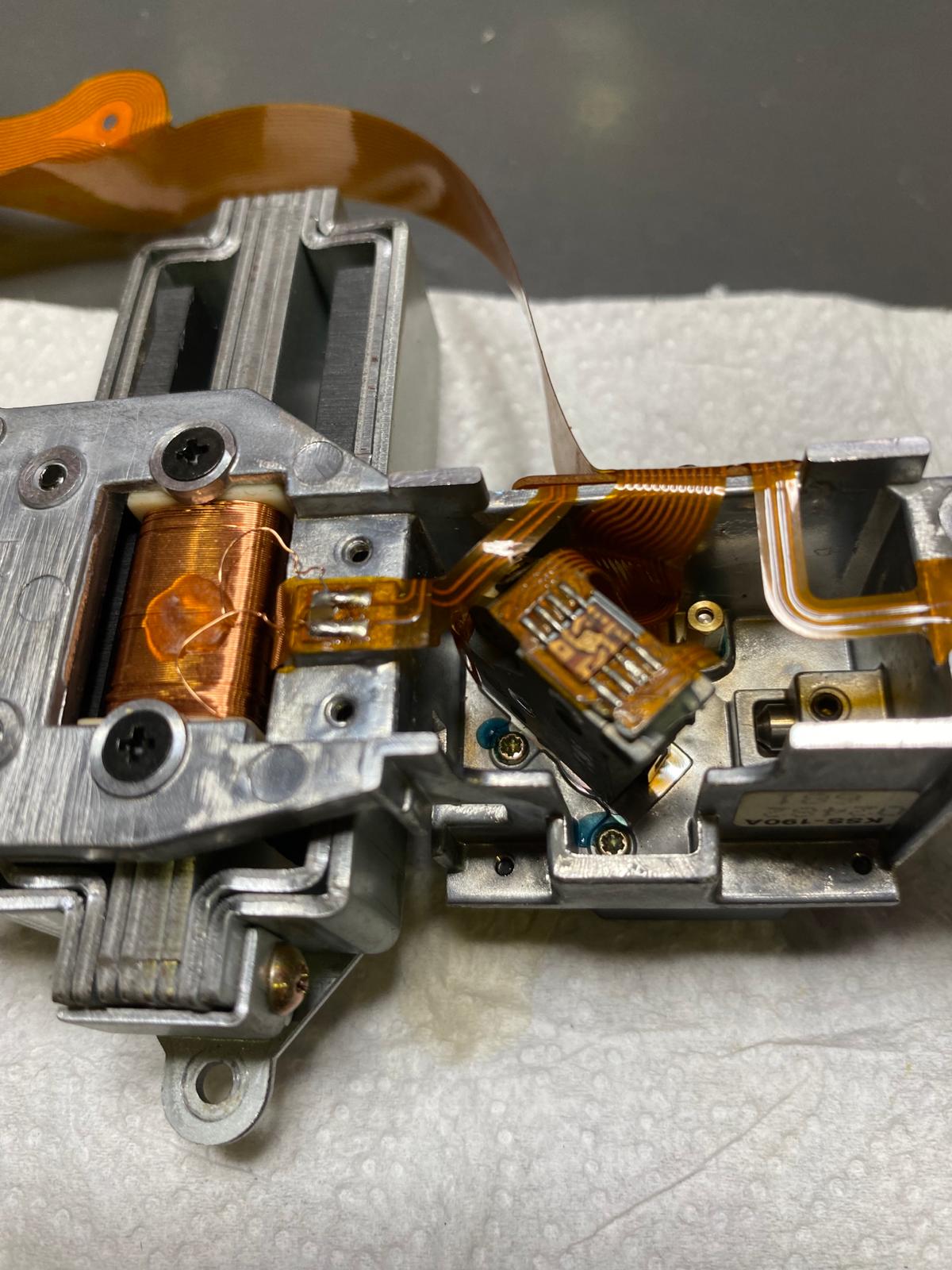

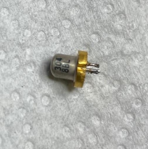

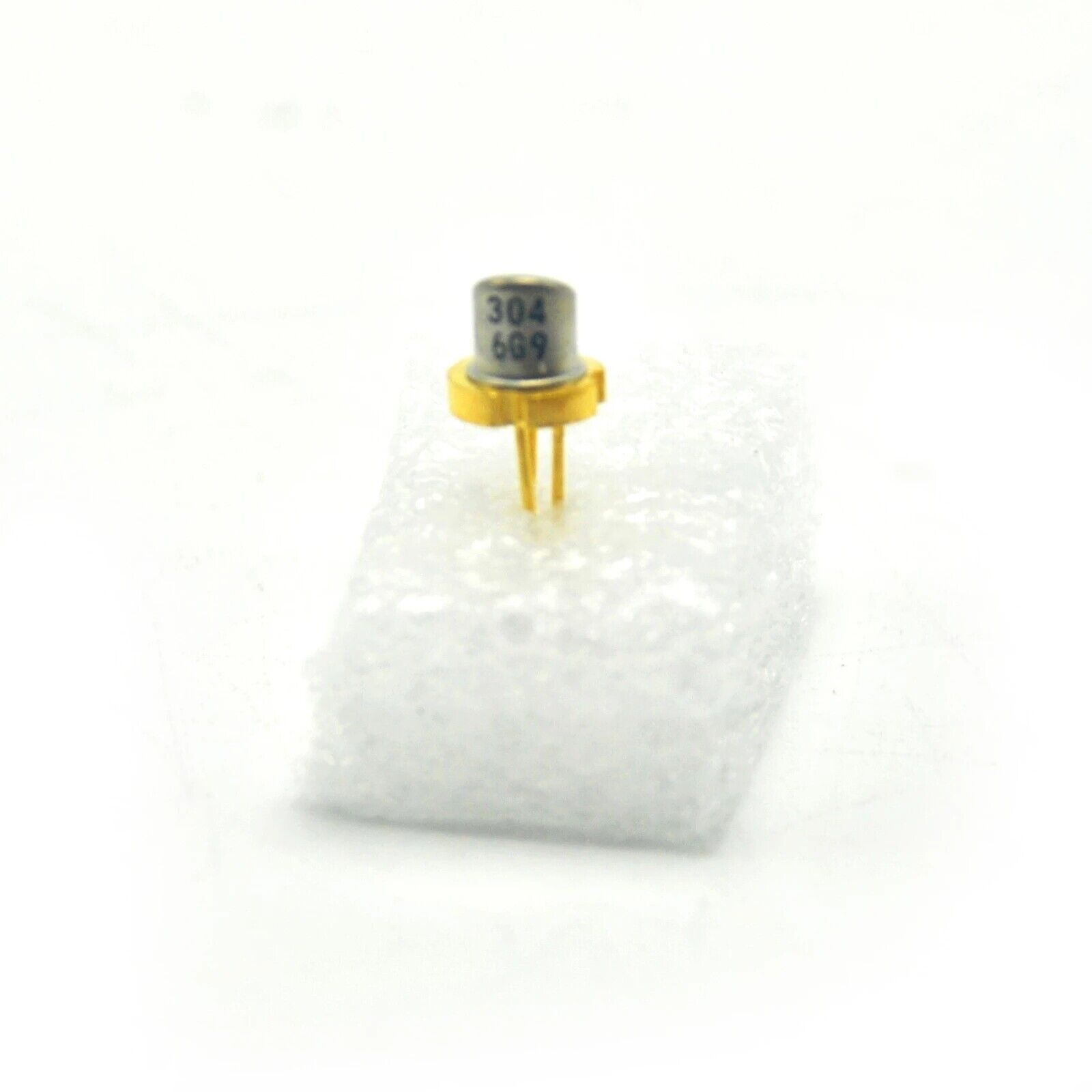

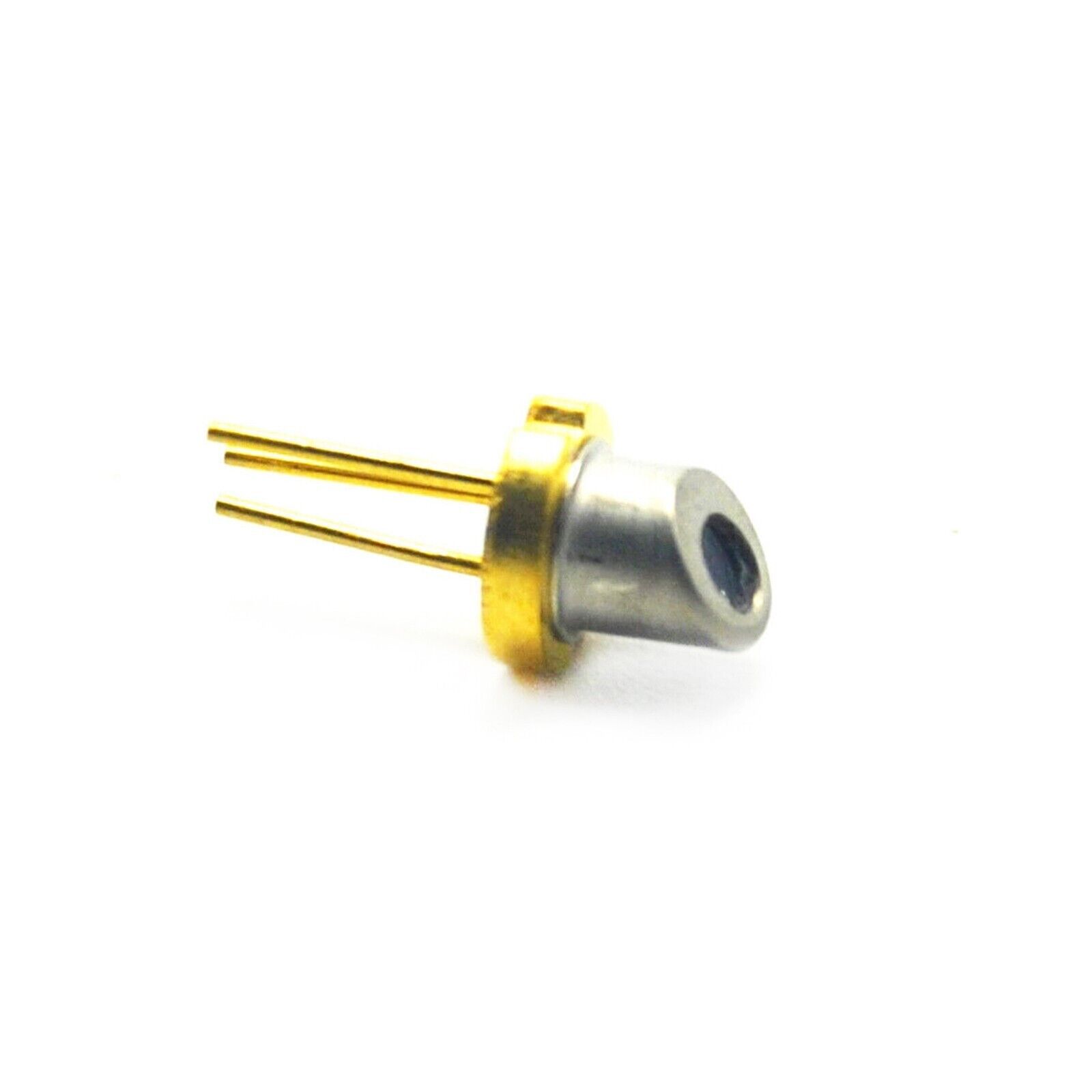

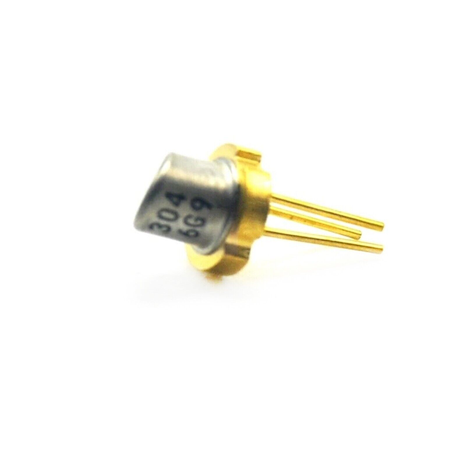

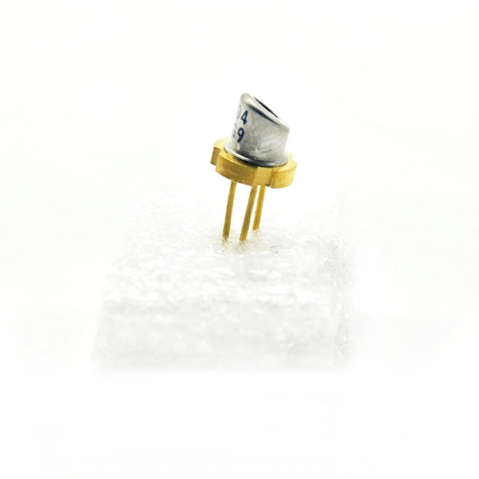

Hello everyone, I own a Sony CDP-337ESD CD player defective of KSS-190A lens. I disassembled the lens and determined that the laser diode is defective. Has anyone changed laser diode of KSS-190A before? If anyone has replace this diode before please tell me how can I find it. It's mark is 304 8BL. I couldn't find the producer of diode with this marking.

Hello. For KSS-190A, the laser diode necessary is a M Type, 780 nM and 5mW, 5,6mm. I've used always Rohm laser diodes different types and all worked satisfactory. I've had bad experiences with bad or counterfeit laser diodes.
I've opened some threads about replace laser diodes, but now I occupied in other activities.
In Ebay or other places I've seen some tecnician that do this kind of work.
Read the threads about this issue.
And, don't break your KSS-190a. Treat it with care.

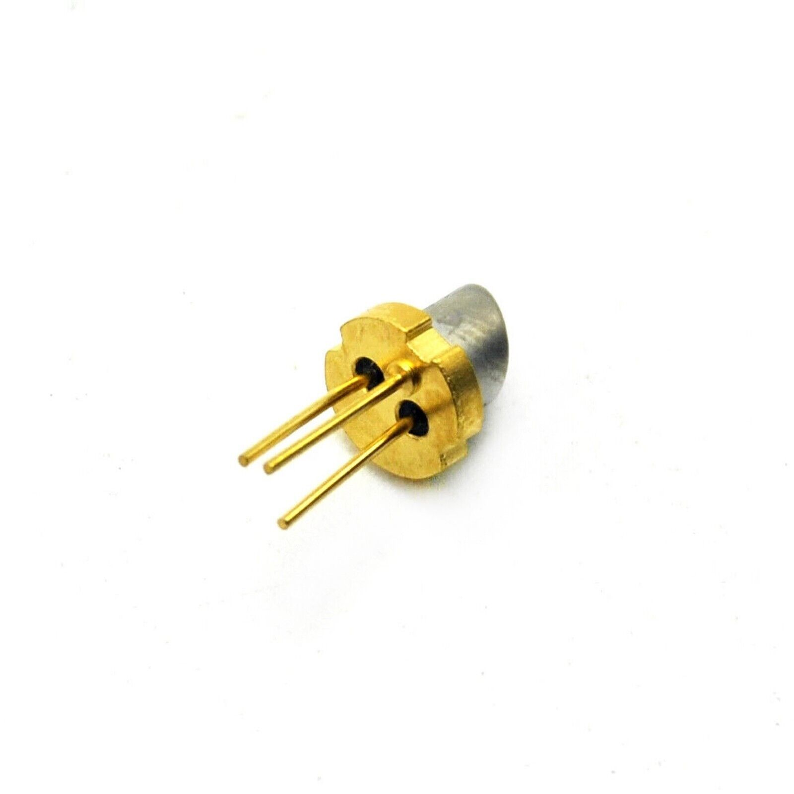

Hello. In Iccfl you can find some suitable laser diodes.
https://www.iccfl.com/product_info.php?cPath=252&products_id=31351&osCsid=fcggek87e3ij3uu0lrf9dtah63
There is another handicap with KSS-190a, 151a and similars, the handicap it that some adjusts like focus and tracking gain is very critical, service manual procedure adjustment is not the best way, and finally I've done the adjustment by the error-essay procedure. In JVC and Pioneer the adjust is perfect with its procedure, with Sony no. So, you can have a perfect KSS-190a but, however, you can have problems with some discs because the adjustment is not perfect. Best regards

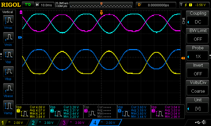

HI! I found some time to dedicate myself to these experiments.
As explained above, I only swapped the diode taken from another identical Pioneer optic frome same model PDR. I was trying to move only the diode, without touching the photodiodes.
Failing to position the source as expected, I positioned it as best I could, then fixed it and started moving the photodiodes. My tests have shown that it is much easier to move the photodiode array than the laser diode itself.
In fact, making an extreme comparison, a small movement of a light source will produce a large movement at the destination point. Since the laser travels a certain distance before reaching the photodiodes (including the mirror where it reflects and go back), moving the photodiodes is easier.
So I focused on A-B-C-D, leaving out E1 E2, F1 and F2.
After a few hours I reached the following result:
  • light blue = B
  • pink = C
  • yellow = A
  • blue = D
It can therefore be seen that A and C (yellow, pink) are in phase and B and D (light blue, blue) are also in phase.
Note that the pairs are only shifted in position to aid visualization, but they all have the same zero volts.
So I fixed everything, removed all connections and reassembled the optic on the CD.
....Unfortunately the result was not what we expected:
The unit is able to focus, but it does not read the TOC and is unable to track. I rerun all the electrical and mechanical alignment steps in the service manual (including grating adjustment), but the result is as indicated.
Two questions arise at this point:
  • Is it possible that ABCD are correctly aligned, while E1 / E2 and F1 / F2 are not? It does not seem possible to me as the sub photodiodes should be a consequence of the alignment of the four main ones.
  • Furthermore, how much inaccuracy can we tolerate on the amplitude of ABCD? Considering that the algorithm (from service manual) for the tracking error is the following: {(B + C) - (A + D)} - {(E1-E2) - (F2-F1)}
    it is clear that even a small difference in amplitude between the four pairs will lead to a tracking error!
