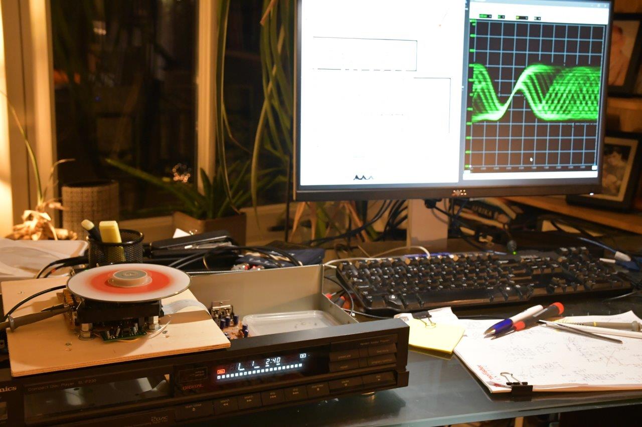

Hello everybody,
it's quite a while that I had a look at this thread, quite some development - and all based on ManoloMos' work! Nice to see!
ManoloMos, also from my end a big thanks for all the help you provided by sharing your work!

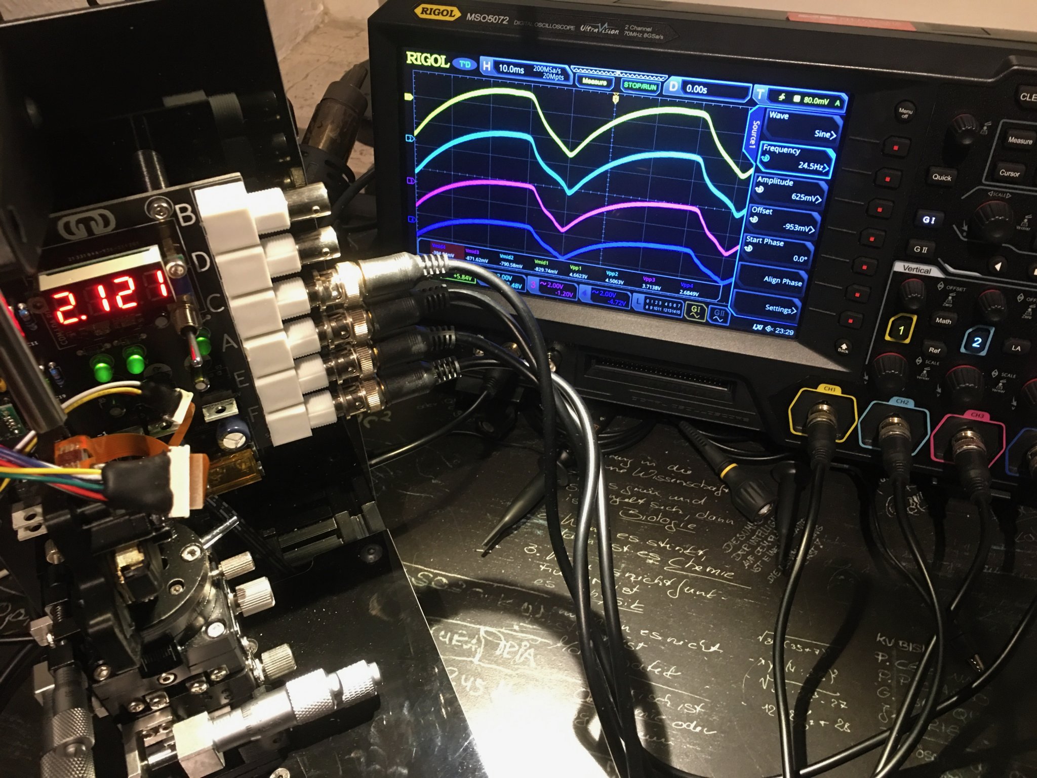

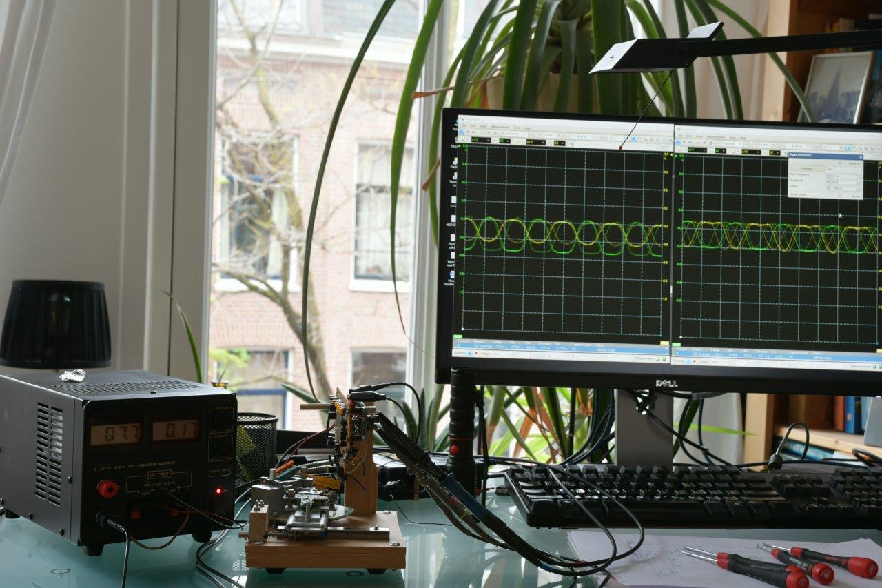

You may remember, I have commented on a different thread that I am busy as well with replacing the LD (in a SOAD70A) - and I actually managed
to get the pickup running a few days back.

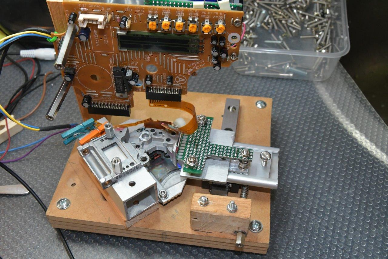

I have used what I had, no complex amplifiers or alignment tools. My 'rig' has been changed a few times, and I got by chance a linear bearing with rail which is used for one axis and the other axis are 'homemade'. The SOAD70A does not have a grating which makes it a bit easier. The original servo PCB is used to drive the lens and to supply the LD. Unfortunately, I did not find one with the correct polarity for the photo diode, therefore the signals needed to be inverted.
Signal for A-D are connected to very simple I/V amplifier (TL074).
I do not use a mirror, I am using a piece of a CD which is aligned using a working pickup. With a mirror the signals were not symetrically, I therefore
took the CD (that is where the laser should look at anyway 🙂 .
When the pickup was replaced after alignment, it acutally read the TOC and played right away. Only some minor adjustments were required.
Please find a few impressions of my work. To be continued.
Greetings from NL!

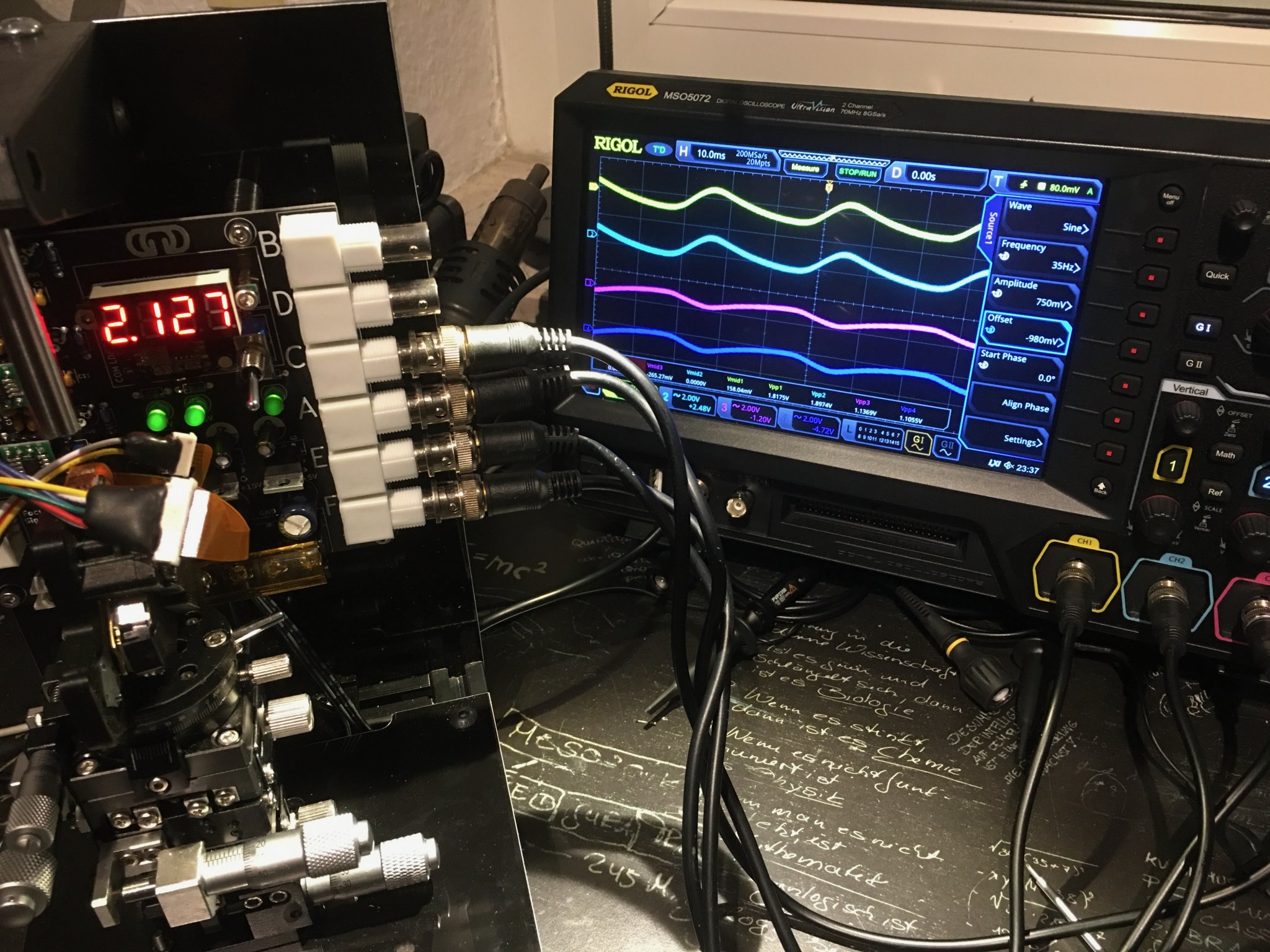

I tried lasers which were installed in KSS-210B pickups. This Lasers worked on my bench but not in my CD Player.
There must be a difference in the laser pickups which causes the pickup not to function when installed in the Player.. I guess.
Also I noticed that signals of the E and F Diodes switched polarities when KSS-210B Laser diode was used -> picture attached.
before and with old Laser diode:
after and with new KSS-210B Laser diode:

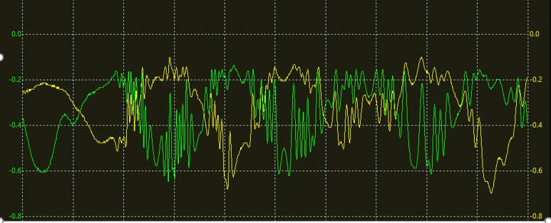

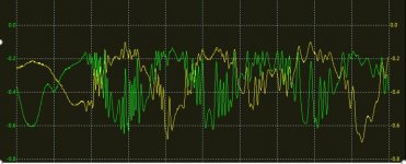

About member Ruzki issues. Well, KSS-168a. I've never have seen it in my hands, but it looks in the pictures, that is a bit more difficult to place in the "gig" for to manipulate and adjust. Another problem are the screws in the lens base, tht in your case, it seems impossible to manipulate or adjust with a CD running. This is a problem. In KSS-151, 272, etc... this screws can be adjusted, it is not easy, but it not impossible, but KSS-168a is another history... more difficult.
Another thing, in the pics, I've seen all the signals you have published, and all are bad signals, all looks like out of focus.
If I were you I'd practice with a kss-213a or similar for to see how a well adjusted laser pickup works, and how it plays the signals.
This is a KSS-151a not repaired A-B-C-D signals
About to use a CD like a mirror, is not problem, but a real mirror reflects more light, and you can adjust the laser at minimun and get a lot of signal. I've used some mirrors, and some of then does not work well, I don't know why.
Best regards

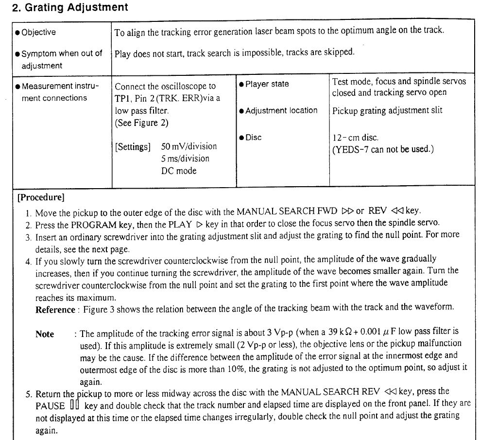

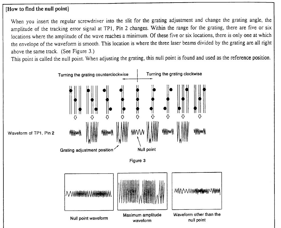

I found this in a Pioneer service manual (PD-4700/5700/6700).

I think, Yamaha had the same alignment as well.
Ok, so only the angular position seems to be crucial,
but not the horizontal position.
I was asking because in a Sony KSS-123A or BU-1(C)
the diffraction grating has a lot of horizontal play, about 1mm.
It is secured by threadlock (Schraubensicherungslack)
It is also pressed down by the diode with a spring.
Two washers spread the force of the spring evenly
over the plastic frame of the grating.
But but when only a tiny amount of threadlock is used,
chances are very high that the grating peels off
when the diode is removed.
This happened in one BU-1 while disassembling.
As far as I remember, there is no access to the grating
once the diode is installed and ready for machanical alignment.
Dear Salar,
sorry, again quite late with my response. Unfortunately, I can't answer your question since I didn't need to do any grating alignment so far.
I would believe that the adjustment is one of the last things done during alignment. Means, in a first step the 4 diodes would need to be centered, and once
this is done the grating, and maybe repeat step one. That would mean there should (must) be a way to access the grating.
Unless (just a guess) there was a special optical 'bench' that was used to perform this adjustment before .

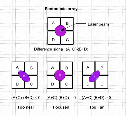

Hi! No, the question is very important. You need DC current for to focus, it depends of the distance of the mirror, the own optics, etc... With DC current you adjust the focus, and with low frecuency, you have to produce a focus-unfocus movement. In this pic, you can see that what I mean.
This draw is not from a CD player laser pickup, but is useful for to show the idea.

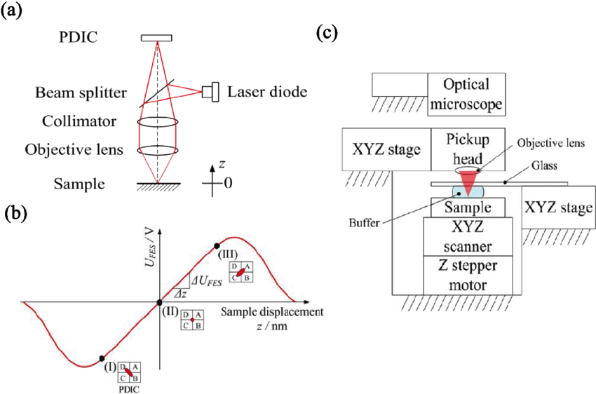

When you replace a diode laser, the problem is to adjust the position of the photodetector diode array, this is the main job we must search. For this, we use the astismatic propiery of the laser optic, with this propierty, you can see that if we moves the lens a bit forward(positive V in the graphic), the spot of the laser is converted in a elipse, that only iluminates c and a diodes. If we moves the lens backward(center, 0 v in the graphic), the elipses goes to the center, so is a perfect spot, same light in a-b-c and d diodes. If we give more negative, the spot light is converted in another elipse, that only iluminates b and d diodes.
Comparing A-C and B-D is how Focus Servo works. E and F photodiodes are useful at the beginning, because when you start to adjust, are the first signals to appear.
When you mount the oscilloscopes, amplifier, and all the stuf, the right sinal must be something like that:
