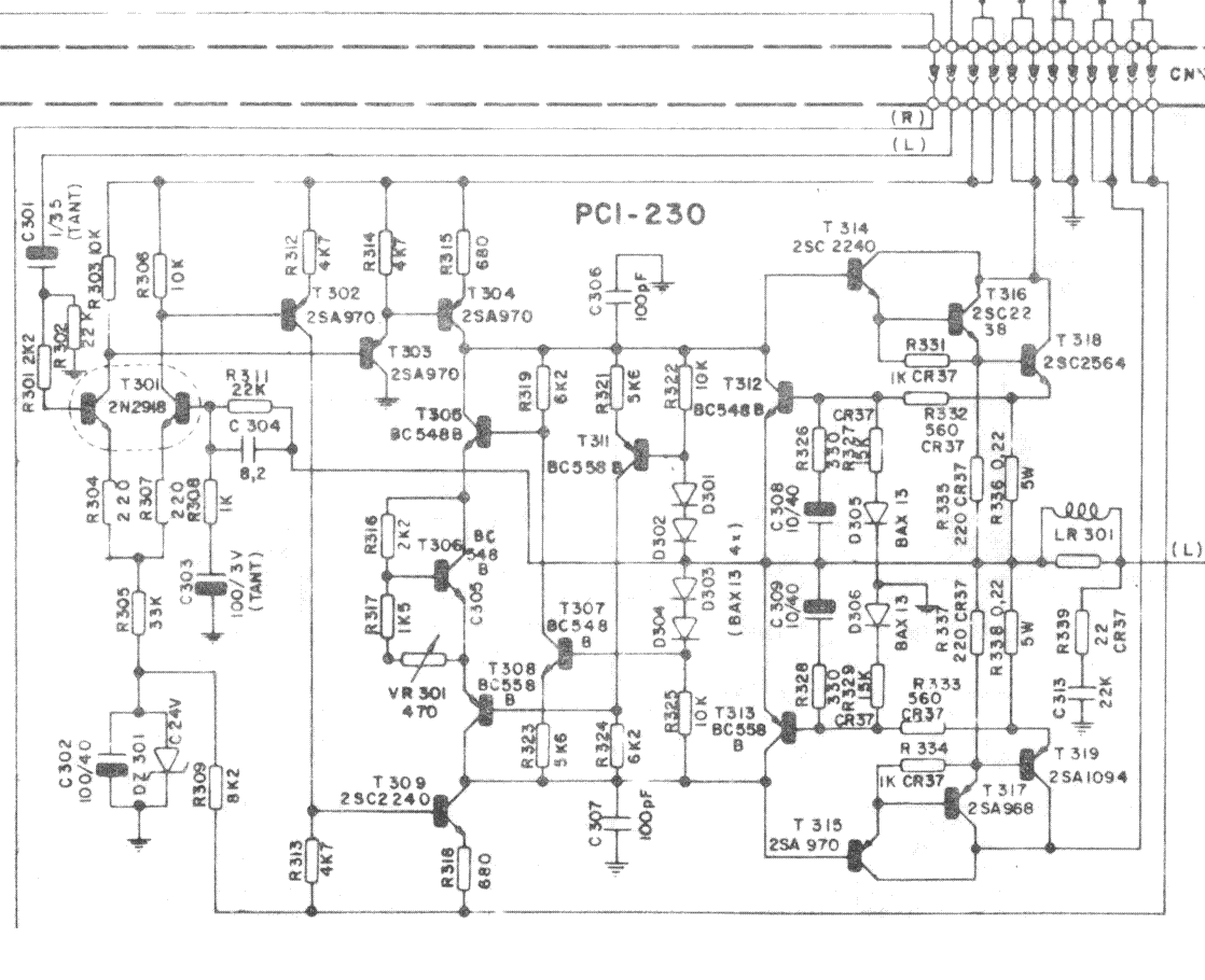

As to my views on the Krill operation, this post summarizes them.
1) There is absolutely nothing wrong with this design from what I can see. The discussion so far has centered around how the circuit itself operates, which of course has led to much controversy. People wishing to build it should certainly do so, and as a bonus it seems that Steve has provided good support to the builders.
2) Except for negligibly small differences, the Krill biasing scheme behaves no differently than a standard power amp shunt regulator. In other words, it does not actually affect whether the output devices turn off or not. This was demonstrated by Glen in post #204. In that post, Glen compared two Krill variants. One had the Krill biasing scheme, and the other an ideal constant voltage source for the bias shunt regulator. In his results, the output stage currents between the two cases had a negligibly small difference. Ergo, the Krill biasing scheme has a negligible effect on turn-off behavior.
3) The soft turn-off behavior of the Krill is due entirely to the absence of a driver emitter bias resistor, as first mentioned by Glen in post #8. This was later shown by me in simulation in post #210, and then further expanded by Glen in post #229. Post #210 shows a graph with two traces. The blue trace, representing the driver emitter resistor as an open circuit, is standard Krill operation, in which the output device emitter current drops down to a couple of uA and exhibits the soft turn-off. The green trace, showing a 220 Ohm driver emitter resistor, shows the full turn-off per standard class AB operation. The different configurations simulated in post #204 and post #210 demonstrate that the soft turn-off behavior of the Krill is due entirely to the absence of a driver emitter resistor. That is, post #204 shows that the Krill biasing arrangement has negligible effect on turn-off, and post #210 shows that changing only the driver emitter resistor (between open-circuit and some other value) fully accounts for the Krill soft turn-off effect.
