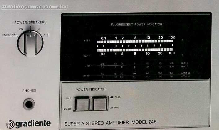

I do not look carefully at the circuit, but is trying to dynamic polarization of the TRs output , you're doing is a circuit called the Super-A.
Super-A is a patent the JVC of the decade 70!
I may remember about JVC doing an "almost classA" design

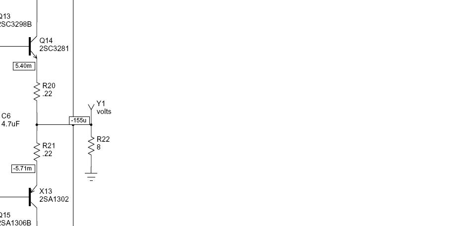

If you read the Steve's latest posts, you'll find out that he's now claiming to bias the Krill @ 200mA with 0.1ohm emitter resistors, which is close to the optimum, anyway (26mV across emitter resistor). The 25mA bias claim was now retired, as not necessary optimal.
Compared to an EF, crossover distortions are nowhere better in Krill. To add insult to injury, and as stated a gazillion times already, the crossover distortions have little to nothing to do with output devices "switching", anyway.

was manufactured in my country a model in this season with a circuit Super-A(non-switching).
I have the schematic, I will try my files on the HD.

So what did I miss? Post number #2 from the original Krill thread, OS biased at 5.55mV/.22 Ohms or 25ma. These were the numbers that started the discussion a year ago. I would certainly hope there are no more bannings for a while.

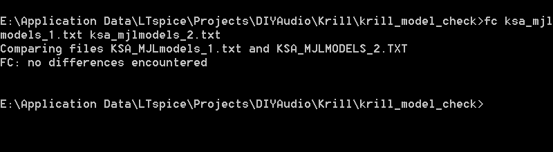

I just downloaded the simulation file from post #11, then extracted the "KSA_MJLmodels.txt", renaming it "KSA_MJLmodels_1.txt". Then I did the same for the file in post #210. I renamed that file "KSA_MJLmodels_2.txt". Then I opened up a command prompt, and ran the command-line file compare utility FC. The command line is:
FC KSA_MJLmodels_1.txt KSA_MJLmodels_2.txt
The result is captured below.
Steve, per your usual tactics, you provided no way for the reader to verify this for him/herself, just the usual claim without evidence.

As a minimum. I did later change that to 25 to 100ma.
So, are you saying a first draft can never be changed or improved on? I have stated several times now that I started this here before I was ready, but pain killers and steroids can make you do things differently from what you should have.
Well, I adjust using both multimeter and my ears, and heatsink temp, finding the realistic and best sounding bias point, and really care less about suggested values
Why do some of you keep clinging on to that stupid 25ma setting, when its of no real significanse
Maybe I don't like being called a liar by someone that alterers the models.
Anyone can do what what I did. Download both and go through the models looking for a difference. If I provided that information, it would immediately be labeled as questionable. This way, everyone gets to find it for themselves. The differences are there. Anyone can find them.
Is that why it took you 28 days? When you ran the files I provided, it showed I was telling the truth about the results I had posted. You either hoped no one would ever bring it up again, or you needed time to make it not work in your last posted file.
And why should I believe anything you have to say now that you altered the models? Did you just forget to tell us you had updated or improved them?
