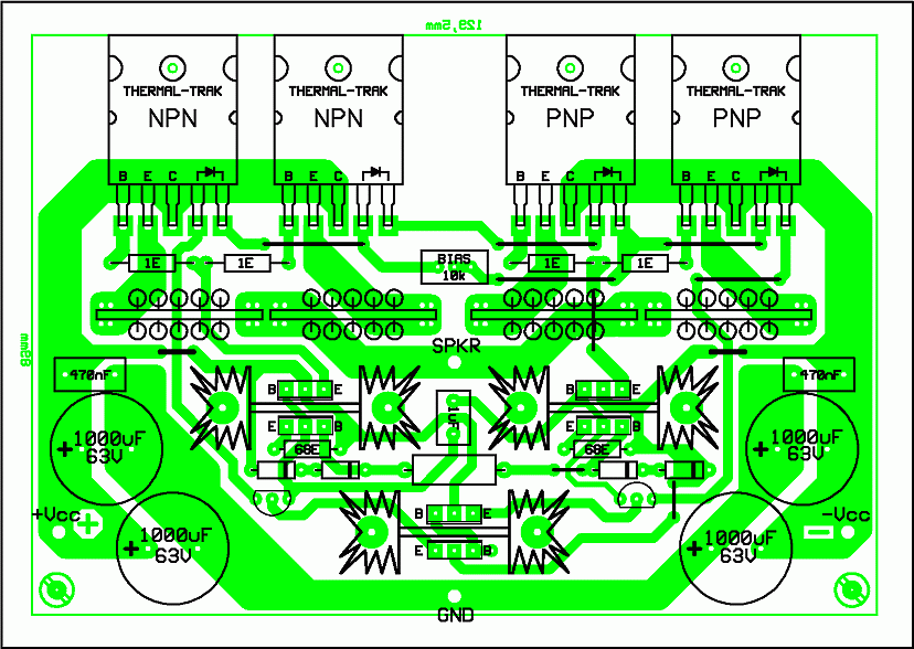

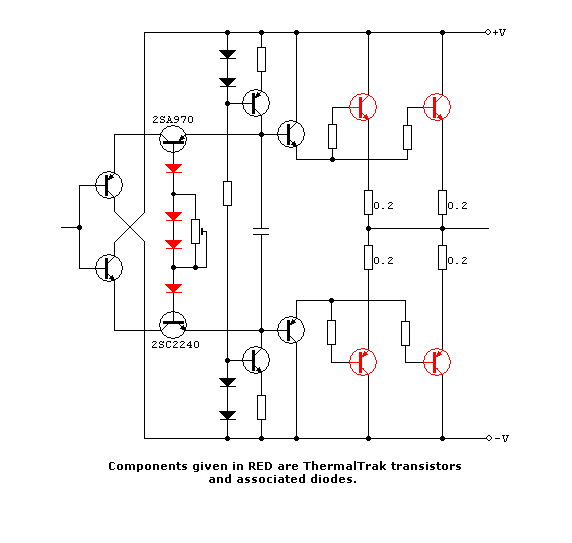

Nice one Boraomega,
can you also provide a matching schematic? It looks like you used a 4-diode string instead of the three diodes used by Steve.
Which software did you use?

Of course but not before tonight!Andypairo said:Nice one Boraomega, can you also provide
I am using TSIEN Board Maker from "Jurasic period"!
Well, I gave my best to do that sooner...
I intentionally omitted components values and people should use those proposed by Steve. With given arrangement of four diodes and trim pot, bias adjustment should be more flexible because it is possible to set trimmer short which will leave only two diodes in action (other two will be shorted by trimmer) or all four diodes will contribute when trimmer is at maximal resistance therefore covering continually all cases between "having two" to "having four" diodes. I used two small transistors 2SC2240 & 2SA970 instead of bigger ones originally proposed, because their dissipation is never more than a few tens of mW and they are with much better gain making regulation more dynamic.
I have to highlight: I haven't tried this circuit in practice, but I believe it will work nicely.
boraomega -- thanks for pointing this out. I've been looking at other transistors for the bias and input pair and never stopped to think about the power dissipation for the bias transistors. Duh...........
I'm going to try the 2SA1210/2SC2912 pair today. I want to be able to screw them down on the main heatsink.
At +- 50 V....
The input pair dissipates app 550 mW
The bias pair..dissipates app 3-5 mW
The predrivers app 500 mW
I can't figure out how much the bias pair contrubutes to the thermal compensaton...Signal wise the two input pairs does nothing......Or so it seems to me..
I have tried to simulate a circuit omitting thesse two transistor pais.. and got just as good results....Still with the non switcing element intact...
It will work.

Let me reduce the contradiction to as simple a case as I can. Just quasi-DC or low frequency, the full power sine/square wave stuff at 10k and above just serves to obscure things. The point was made several times that “the voltage between the bases does not change with signal”. Sorry I don’t have the time to find the exact quote. Reduce it again to just a complimentary follower and .22 Ohm emitter ballast. Say, for arguments sake, that the NPN and PNP both have the same Vbe of 700mV at 30mA, between the bases that would be 1.4132V. Now source 3A. That, roughly, is 100X the current or about 120mV increase in Vbe (820mV) and .66V across the top .22 Ohm resistor or 1.48V. With no change in the voltage between the bases that leaves -66.8 across the other device. Your devices had 575mV Vbe’s but that does not change the result (actually makes it worse). To operate the upper device at 3A and (to be generous) keep the lower one on at just say 1uA would require ~1.913V across the bases. Things vary with temperature but the point seems to keep everything at the same temperature so this is also an unnecessary complication.
This has nothing to do with models, simulators, or beta for that matter. Sliding bias schemes exist, but they all adjust the voltages to keep the device in the forward active region. There are even ones that use geometric mean (constant product) biasing. BTW I don’t really care about switching/non-switching behavior, in open loop circuits full power response tests bury small things that go on at crossover.
Hi Scott,
A valid example. That does make it sound like I am incorrect. However, when the base to emitter voltage on the output stage of my amp is measured, it does increase. This led me to believe the transistors might not be turning completely off. Well, that and the fact that current can be measured in the collector throughout the signal.

Steve Dunlap said:However, when the base to emitter voltage on the output stage of my amp is measured, it does increase.
Simulation shows that too. This initially surprised the heck out of me. It happens because the driver Vbe gets reverse biased, thus increasing the voltage difference between the output stage bases relative to the quiescent condition. The driver turns off abruptly, leaving no path for the stored base charge in the output devices to be swept out. So the output stage Vbe's remain forward biased for a time, but eventually they turn off - but rather slowly.
That's why I wanted to talk DC, the explaination's offered walked through the schematic in a DC fashion. I wanted to separate switching behavior from simple voltage transfer non-linearity.
Could this be the reason the distortion goes down at higher frequencies? This would explain some of what I remember measuring.
scott wurcer said:That's why I wanted to talk DC, the explaination's offered walked through the schematic in a DC fashion. I wanted to separate switching behavior from simple voltage transfer non-linearity.
It never occurred to me to do DC measurements on an audio amp. At DC you may be correct. My simulations do show current flowing in the collectors of the outputs with a DC input. My simulation could be flawed.
Just curious, how much switching distortion do the transistors produce at DC?
The amplifier does not switch off.
