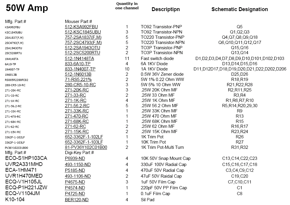

Based on what I read, he actually wants us to build his amp.He said specifically that he was putting this simplified version of his amp out here for the DIY community.
He offered boards if you email him.
But originally did NOT expect to have any boards available.
This says pretty clearly to go ahead and make boards as far as I can tell.
I say go for it as a DIY project. There's a big difference between making boards up and selling them on the forum and going into the biz of making Krill amps. That's a no-no.
A variation for DIY is also just that, a variation for DIY. Not a no-no. Making a variation that is a complete amp as a BUSINESS is a no-no. Making one for Carlos, not a no-no.

Let's just figure out how to build this thing, right here and now? The design and the construction are very related at this point.
I'd suggest posting the $$ total of the 50watt version Mouser BOM to give folks a sense of scale on the raw parts... as a start.

I'm dead serious. To end up this debate, how much are the boards, how many does he have, schematic? If the numbers are decent, and it all makes DIY sense, I may consider buying them (to help Steve) and distribute them for free on a first serve basis.
jkeny said:Thomas probably has an idea of the number of boards he has
Here's the BOM for 50W amp
Edit: again please check this for errors &/or updates
When we stumbled across them (almost literally) out in the work shop we opened them up did a quick count - It was around 100 PWB's. I have purchased two of them - he sent two to Carlos - and he has sold some - but how many he has sold I don't have a firm grip on. I suspect that he has around 70 or so left - but that is a WAG on my part. He has a boatload of transforms too - but they are wound for 120VAC @ 60Hz.

Guys, somebody put together a package with schematic, board size, quantity, prices, etc... and let me know.
70pcs. of 5x8"=40 sq. inch cost $18.60 a pop, to order from www.barebonespcb.com. Double sided, metallized holes. Again, I'm ready to help an individual, but not to support a business.
I'll certainly help out if need be. I am not really set up for anything other than small signal stuff. Do you think an old Hafler 220 chassis on a variac would make an adequate +-40V supply? I really don't have a single HV cap or transformer or heatsink in the house.
