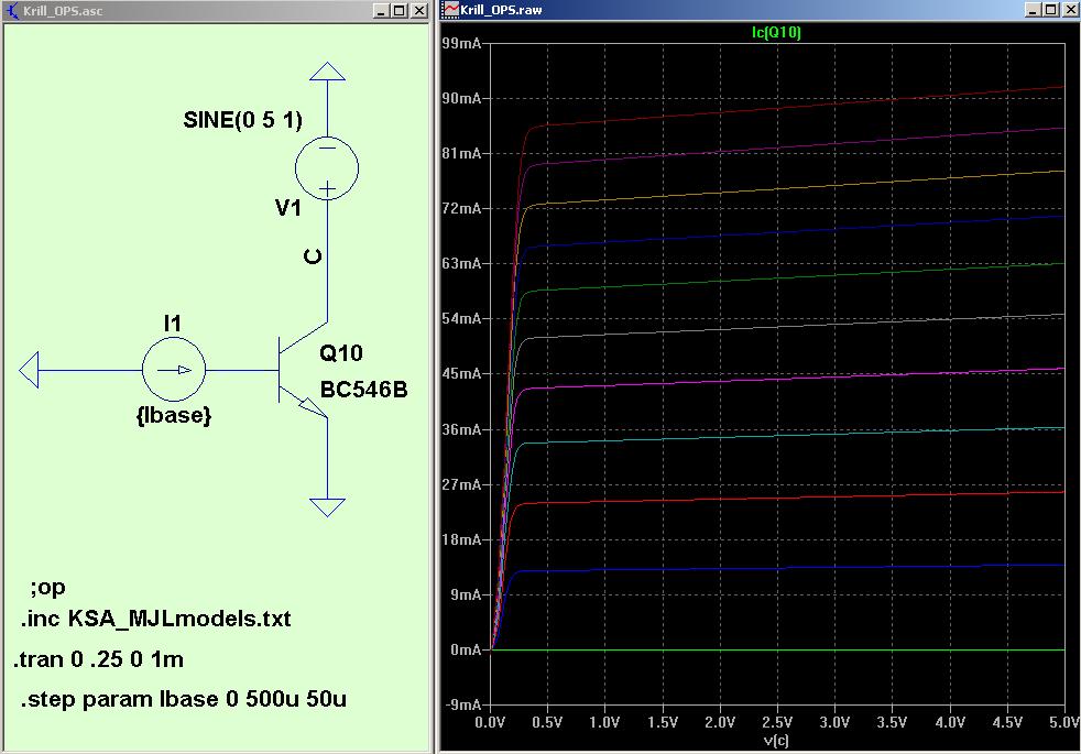

KSTR said:That's what I was referring to (but haven't investigated myself, so far).
This is why I said we'd need to build something running in quasi-sat and then check against the real world...
- Klaus
Hi Klaus,
I just checked out the MJE340 model in andyc's sim and found it looked inaccurate, but I can't find a datasheet that shows the curves to compare. But here's the LTSpice curves for BC546B (I think I got the model from Fairchild - can't remember), but it deviates significantly from the datasheet.
I think we can say that andyc's MJE340 models the saturation curve, it just doesn't accurately model it. Whether an accurate model would make any significant difference I am not so sure.
Brian
