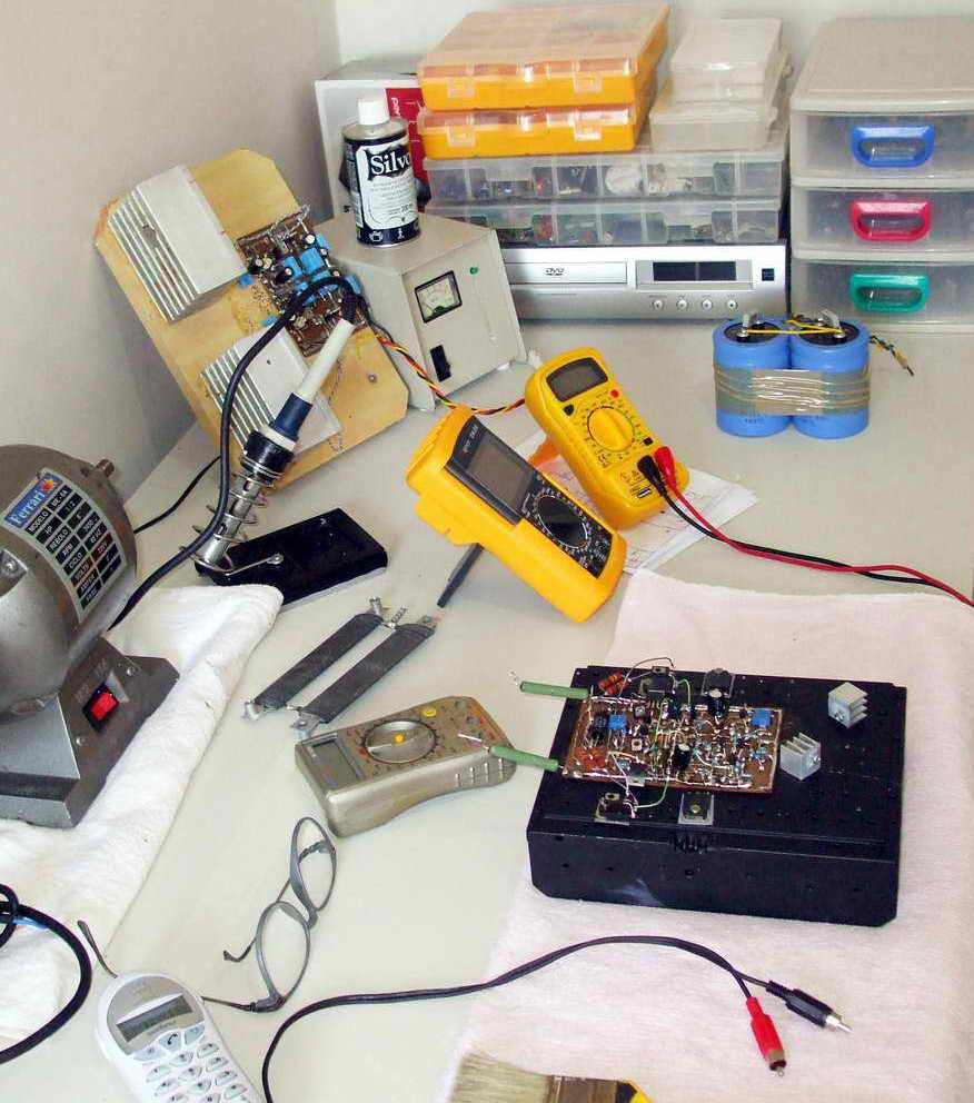

Dnnlap Amplifier is assembled... i will have to travell downtown
.... and today i will submit it to a triple check, a cleaning and they will switch power on to adjust and play nice music.
Be happy folks...i am working to be happy.
It is not pretty...this is macho amplifier....made by a man.... a "mucho macho" amplifier.... a real male one.
Soon i will be back
Enjoy your life folks....it finishes very fast!
Carlos

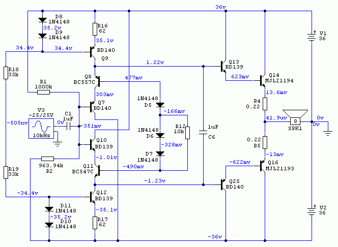

Nice job, redrawing the schematic.
It looks more like a variation of the Blomley design - I don't like the fact that the output transistors have no RC network between their bases (see D.Self EFII) to speed up turn-off.
Great design though, Mr.Dunlap; I will definitely build this with BD159/BD140 and TIP142/TIP147.
I have to check.... but seems finished...maybe one or two resistances wrong place
also i have to pre adjust trimpots and produce some measurements.... then cleaning and JOY!
Maybe will not clean...macho amplifier... with sweet and dirty things...some drops of wiskie and beer around... some hairs falling down over the board... a potato chips around... a male amplifier understand?
Carlos

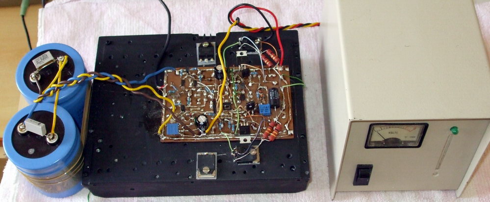

This beautifull amplifier is playing loud and clear
with a exceptional, outstanding sonics.
All controls working fine....but i have some damaged parts (all old junk parts i am using) or mismatch is bothering me a little.... having off set zero sound is not so beautifull compared when i am using it with some off set.
I am trying 500 miliamperes...well...for sure i have something wrong there, resistances wrong value or something...and even this way it is reproducing a hell good sound!
Cristal clear trebles, deep and deeper and strong bass... wonderfull amplifier the way it is today.... imagine tomorrow folks!
regards,
Carlos
That's a sliding bias scheme, no turn-off here (see pic).

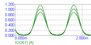

Glad to see that a discussion started!
@Darian: sorry, I have no simfile that would contain only the outputstage!
The attachment shows a variant of Steve's outputstage with 200mA bias current; you see that the transistor stays on through the whole cycle (26mA minimum).
Distortionwise I find about 0.011% THD at shown output current into 8R (depends of course also to the rest of the amp).
To which extent this agrees with Steve's experience I don't know as my variant is not fully trimmed yet (no time so far).
Have fun, Hannes
EDIT: the distortion is dominantly 3rd harmonic (about 0.01%).
darian said:Hello,
Juma, I see you put the circuit in a simulator. How are the results distortion-wize?....
I posted it here:
http://www.diyaudio.com/forums/attachment.php?s=&postid=1683644&stamp=1229130212
Fundamental (10KHz) is 24 V and the harrmonics' amplitudes are shown in the picture. Just calculate relations between any of them and fundamental. The result may not be very realistic, and my question to Steve was more about comparing harmonic content distribution to real life circuit ...

I had leakage into a transistor..the amplifier is absolutelly stable
A fine piece of sonic jewellery.... superior sonics...i will start to dismount other amplifiers.
This one will be my reference.
Excelent.... works cold... you can adjust 50 miliamperes or increase to 1 ampere... the amplifier do not became mufled with the bias increasing.
Controled deep astonishingly superior bass... voice is normal into my poor speakers... i found nothing special, they are there and correct...no emphasis.... a real flat amplifier with special treble without any harsh.
Power is excelent and does not clip producing those scandalous noise we see in more standard designs... sonic purity is awsome.
Excelency in amplifiers.... thank you very, very much Steve Dunlap.

juma said:Since Steve's circuit has its' origins in diamond buffer topology, maybe it will be easier to comprehend when drawn this way:
juma:
Thanks for the simulation results and your support of my circuit. You seem to have grasped what is going on so well that you are answering questions (and correctly I might add) before I have time to respond. I do appreciate that as I can be pretty slow at times. Interpritate that as you will.😀 And yes, that is a very good redraw. Thanks again for that.
Now, about that "diamond buffer" thing. Does anyone here know the origin of that name? I have seen the circuit used in different commercial products going back over 35 years but I do not know where it originated. I saw the potential in this and that was the motivation to improve upon it with my bias circuit.

A word on the real world distortion figures. This can vary depending on bias level and the transistors used. Other things like layout and wire dress will influence it also. I can tell you that every unit I have built could be adjusted to below 0.01% THD with just the bias trim pot. These were units built by an outside contractor and designed to sell for $1000 US for a pair of 100W at 8 ohm mono blocks. The 4 ohm power was 200W and 300W at 2 ohm. They cut some corners that affected distortion such as substituting output devices different from what I had specked. They also did not match transistors. Just one of the joys of having to farm out your design in order to get production up.
On units built in house I have achieved somewhat better results. At low power the distortion can hide in the lower limits of my distortion meter. At higher power I have measured THD of 0.005% at 400W at 20KHz into a 4 ohm load. Clearly no one harmonic could be as high as 0.01%. This circuit has a distortion null at the proper bias level. Going over or under that level will increase distortion. It is easy to see that notch on an analog meter. It might take a little longer to simulate the amp with every possible bias point. This is one reason that (in this case at least) a simulation might not give accurate results.
Steve

Hi Steve and Darian,
the 200mA bias is more or less a random bias number - it's not optimized in any way. As I distrust simulators I didn't bother to sim multple bias points to find the minimum.
What I see in simulation and what I would be interested in is that the sim predicts that the current in the "passive" bjt becomes smaller with increased output current - to a point where the current goes into microamp region. That certainly cannot be correct as that's already more or less turn-off.
Steve, maybe could you comment on that? How does the bias current in the "shut-off" transistor behave with increasing output current in the real circuit?
Does it always stay the same?
Have fun and thanks a lot for your support! Hannes
