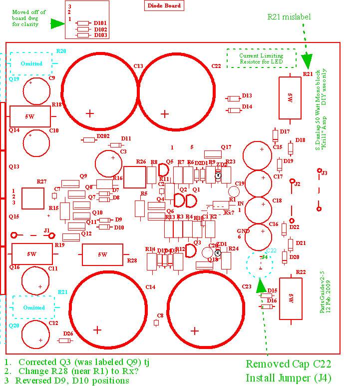

Here is another small correction to the component layout map. I had D9 and D10 swapped around.
I'm trying to keep Steve honest by doing a point to point continuity check on the PWB and the schematic. (Man - my eyes aren't what the used to be
I'm working on a newer version of the layout that uses a scanned image of the PWB. On top of that I'm adding the components and also coloring in the voltage supply runs. This should help when it comes to cutting tracks and adding components. Hope to have something to show in a day or two.
