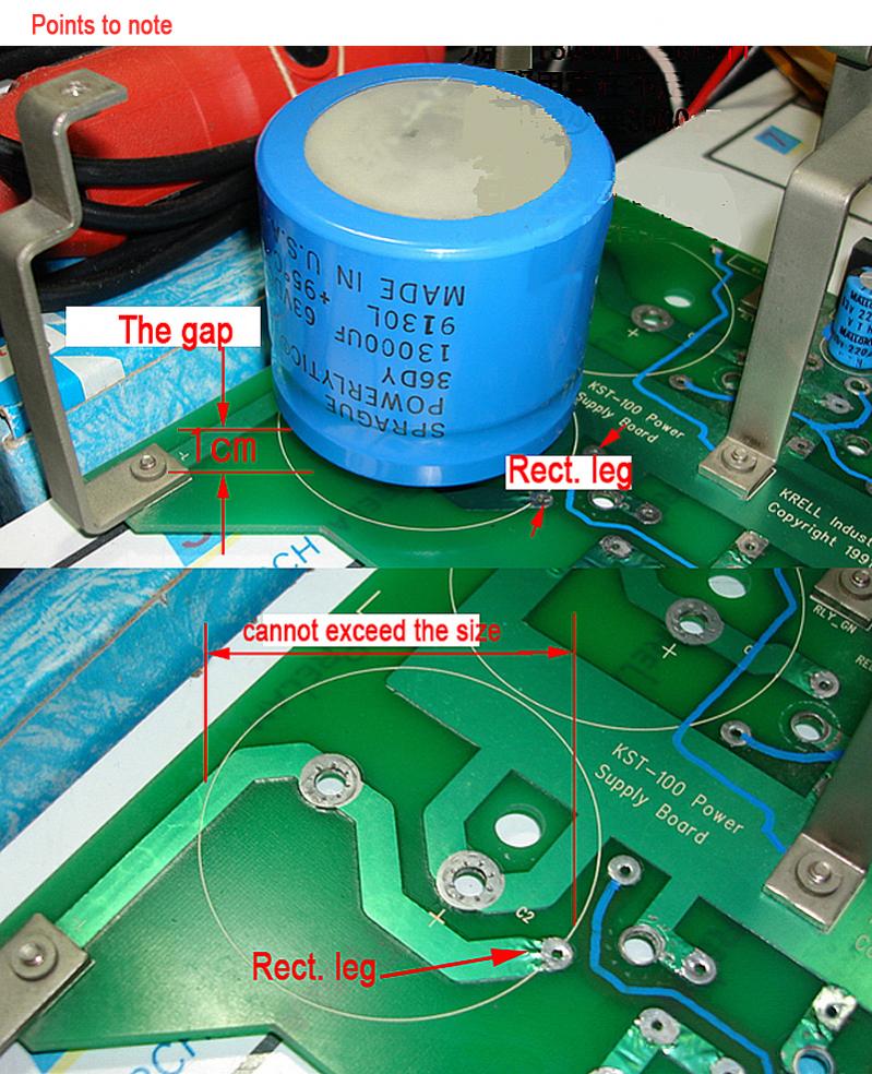

No. Notice the rail will not clear the top of the cap so it won't bolt to the main board. It has to be lined up perfectly to operate.
The only option I can think of is to go down in capacitance and maybe find a cap that will fit. The original schematic has 13,000uf/63V for the main filters; maybe a lower value will filter properly. I will probably call Krell Monday.

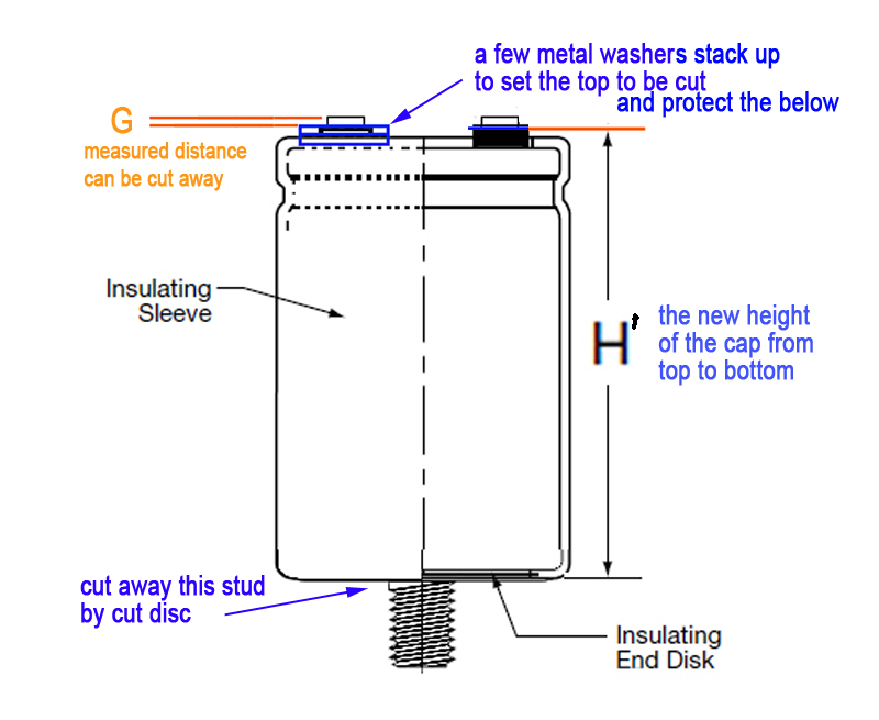

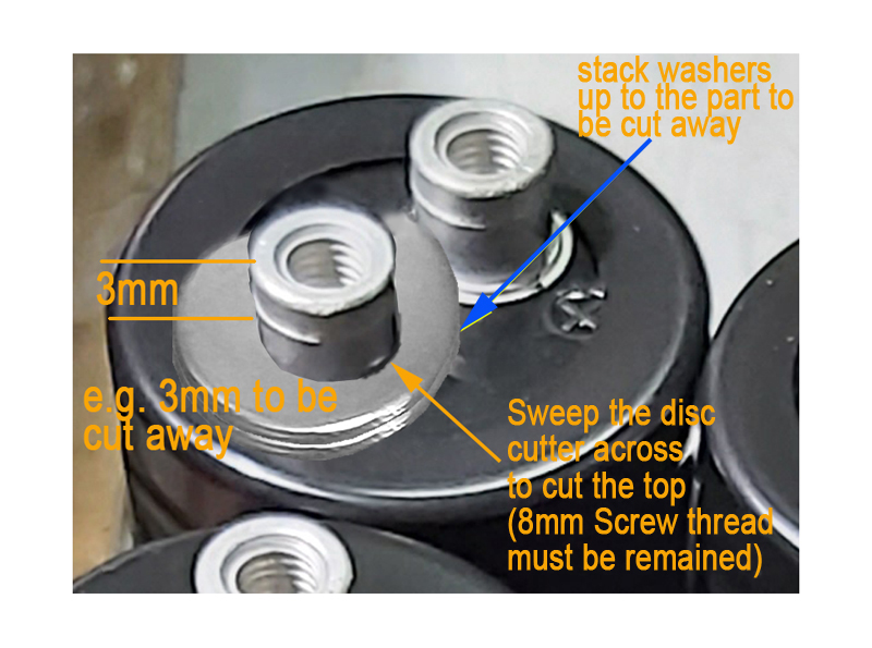

It may be difficult to put them in. I have done cutting the stud and the legs of many caps before at other restoration projects.
1. Measure the H height allow at the amplifier's rectifiers PCB.
2. Measure the new 33,000uF caps of the H' you can achieve after cutting the stud and the (+) and (-) legs
3. If H' is still longer than H. DO NOT DO the action and try to buy a lower caps (e.g. 27,000uF 63V E32D630HPN273MC79M 80mm height)

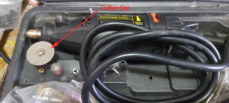

4. Place big hole metal washers to allow cutting a leveled surface of the cap leg as well as protecting the below.
*** please evaluate if you have the skill to do that before you start***
If you can change the caps and tune up the bias, you have the good sound and unique KST-100.
