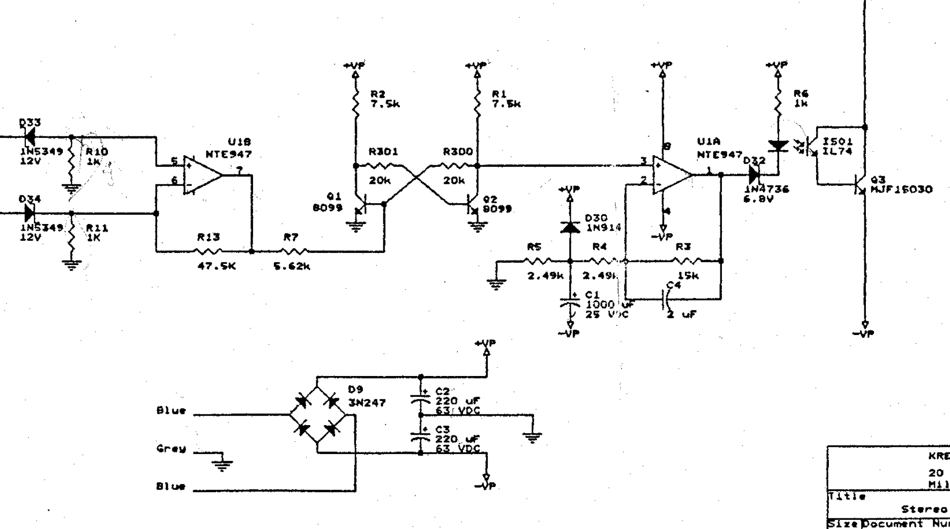

No. Notice the rail will not clear the top of the cap so it won't bolt to the main board. It has to be lined up perfectly to operate.
The only option I can think of is to go down in capacitance and maybe find a cap that will fit. The original schematic has 13,000uf/63V for the main filters; maybe a lower value will filter properly. I will probably call Krell Monday.

Well, I'm throwing in the towel on trying to get these taller caps to work. Krell sure didn't make it easy to change the filter caps on this amp!
Etsang3, thanks much for the details on trying to make these work. I was just about to cut one of the caps when I saw the 4ea .1/100V caps that are mounted to the bottom side of the main board. Well the one's in the back fall up under 2 of the filters! Crap. I don't think there is room to move them to the other side and I don't want to replace and fold over.
I'll just stay with the 30yr old filters and hope they hang in until I can find another solution.

As an update and for others, Krell recommended that I NOT change the main filters unless they have cracked and malfunctioned. Their tech support had confidence that they generally last a long time and don't go bad. I changed the small electrolytics, cleaned everything up and set the bias to 80mV. I'm auditioning as I speak and sounds good so far and no excess heat! Thanks for the help on this one.
Well.....a few more things happened since I posted last. This KST100 ran really well in stereo, but I had another KST that I've owned for several years and the reason I added another was to run mono blocks. Anyway, after I had recapped the amp (I left the big filters alone), the amp would not go into mono, it would trip the protection. I finally bit the bullet and sent it to Krell for repair. The issue was the toggle switch Krell used for "stereo/mono" switching. They are not reliable. This amp also required new relays; the big filter caps were tested and deemed good.
