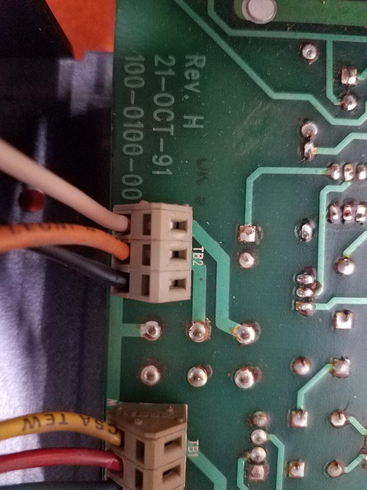

I'm assuming no screw on the side so these are the spring loaded style. Slide a small flat screwdriver blade into the slot above the wire. The springs I've encountered are pretty tight so you may need to wedge the blade in there firmly to get the spring to release. Tug lightly on the wire while working the blade into the slot. The wire will probably still have some resistance but will eventually pull out of the slot.
Thanks! Yes no side screws on these. I did try what you are suggesting, but I did not get very strong with it for fear of damage. I tried the back side and above wire slots. Hopefully I can get it back in after removal!
These are just push in, get a small screwdriver pushed in the slots, and the leads will pop right out. And yes they are really tough
You know if it were mine I'd replace those spring loaded connector terminal blocks with the screw style. I hate those damn spring style ones and I don't really trust the connection either.
All the old Krells use them and they are very reliable.

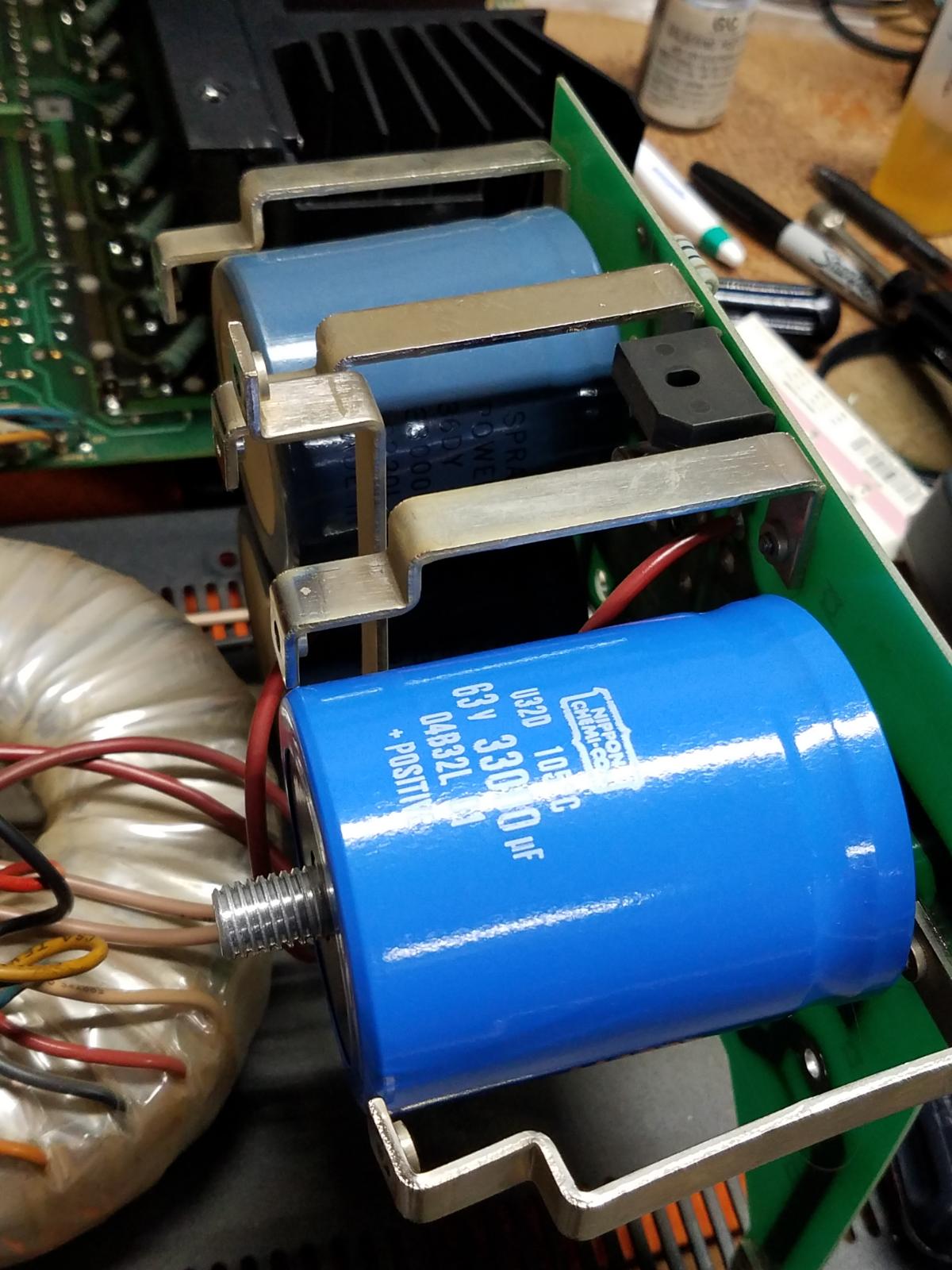

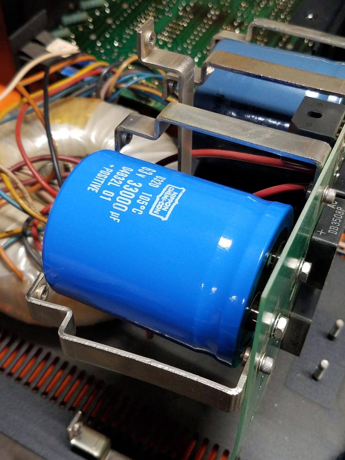

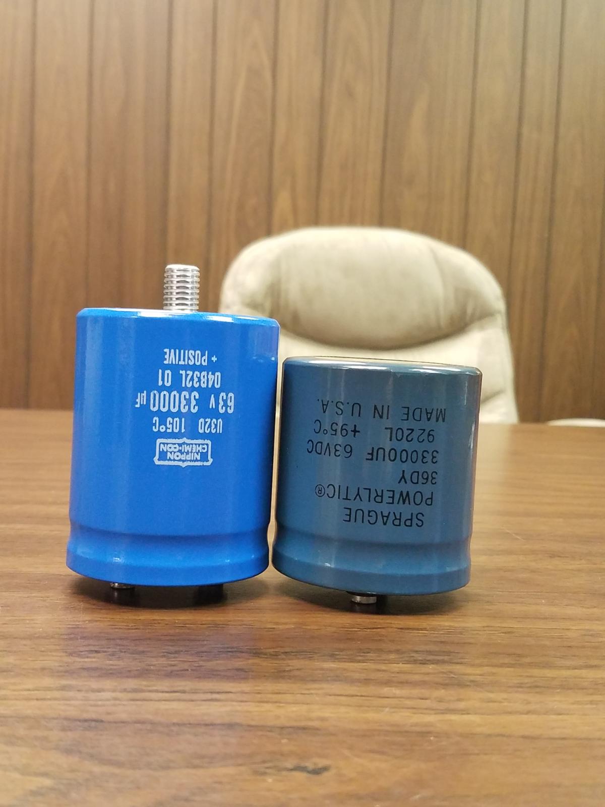

Hope you guys can help me. I was thinking these new United Chemi-Con screw caps would squeeze inside the "rails" that Krell used on this amp. I was wrong. I honestly can't find a screw style cap that will fit this amp. The new Vishay Sprague caps that cross-reference these old caps are not the same footprint; much taller. I can mount these Chemi-cons but as you can see from the pic they do not fit underneath the rails. They would be perfect if just a few milimeters shorter and didn't have the rear bolt (I was planning just to cut that off).
I welcome ideas!
