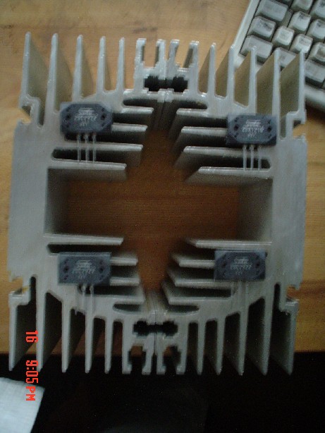

Here is a picture of two of the heatsinks i found for the Krell.
They are really huge, placed a quartet of Sanken's on them to show the size.
Holeeee! Jacco those sinks are rather perky... with a Papst (judging the picture) that baby could probably dissipate 2kW. Look at the thickness of the mounting area...!

The base is 1.25" , K-adcom.
Putting four 4.75" vents on the top will not cut it, probably will need to look for 5.5" models.
