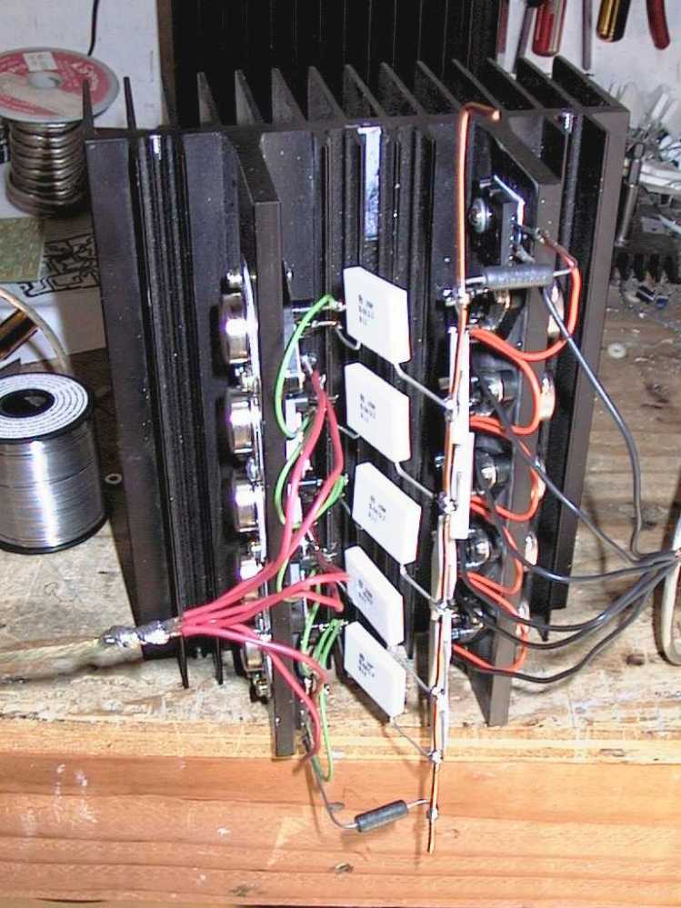

projects...
I've been travelling a bunch, got a new girlfriend, not as local as the last, lots of driving, plus I'm having to go in to the office for work and all manner of other distractions...
But, I made one channel of a ksa50, it worked perfectly, so I started on the other, not quite finished...then I was tempted by k-amps...
He wants a variation on the amp for higher powers. Never one to turn down a challenge I began 'recalibrating' the circuit... I am presently building the output stage, got a nice pair of heatsinks from a deceased adcom gfa565, they hold five TO3 pairs each and I've fitted them together to make a windtunnel. Thermally speaking, fanless, each is just about enough for one channel of a stock ksa50, so I'm gonna use 2 with push-pull 15cm fans for one channel of this amp...I'm quite sure we will need more outputs for 2ohm operation but as I said earlier, I ran out of sockets...
Power supply: Not completely sure yet, but since I have about a bunch of 400va toroids, I think I'm gonna use 4, along with my variac to get unloaded +/- 100v rails, plan B is to use a single 1.4kVA toroid, again with the variac. Currently I have built a couple of the boards with higher voltage small signal transistors throughout, plus moderate heatsinking for the Vas, the increased bias requirements mean the pre-drivers run hot, the drivers are now mj21193/4, though ultimately I think the mjl4281 and it's complement are a better choice.
I'm going to start the idle current low, test everything into a reasonably high impedance, then slowly crank it until the sinks are half way to max. acceptable temp, ~43c...at which point if my theory hasn't gone up in a cloud of magic smoke, we should have an amp with very high output potential... mainly class AB obviously, but still should be able to get the first few tens as class A...I don't have any multi-kilowatt test loads, so I will have to jury rig something, like huge resistor bolted to heatsink immersed in bucket of ice water...
The longest job so far has been bolting and soldering all the driver and output stuff together. I am triple checking everything, a failure in this 'part' will be spectacular...safety goggles anyone...ear defenders..., kevlar vest, and as I said the fire extinguisher is close by...
Stuart

Re: protection
The quadruple octet of output trannies I'm using has 2 Ohm for Re (as per KMA 200). I think it is a good idea to use high(ish) values there as it enforces (rather than promotes) current sharing pretty efectively. It also limits the current per transistor pretty much to such levels that either even a large fuse will blow well before transistor (rated @25A) goes.
There's no downside to using high values of emiter resistor that I see except from a miniscule loss to damping factor (who cares!) and a tiny loss of efficiency (which if you worry you shouldn't be building a class A amp in the first place 😀 ).
Bratislav

Alrodent,
can you tell me the spacing between the output devices, from collector pad to the next collector pad ?
I'd like to know if i can use big Sanken's instead of TO247's, 12 on 2 output boards.
Thanks Al,
should be enough, the MT200's are 36mm, if i bend the legs of the outer devices 1.5mm off center they'll be in line on the boards.
(aquired a number of 0.27 C/W heatsinks, with a couple of Papst vents and 12 devices per channel, 200 watts class A in 2 Ohms, on 25vac toroids, 47.5 C heatsink temperature at 25 ambient )
