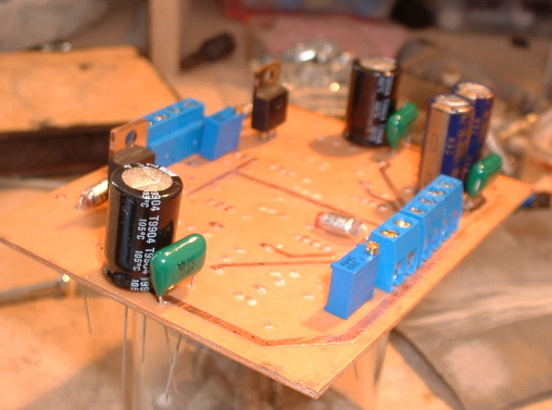

Right next to the trimmers you see two rectangles with the notation "Low" underneath. You can place a jumper or the wires from a switch if you want.

I am thinking of possibly using the low bias setting for a sort of "standby state" to keep the amp warm.
Although I don't think so, does anybody know if switching between low bias to high bias and vice-versa will cause a "pop"?
Also, what are people doing for "soft starting"? I only saw a couple posts but no real details.

The fact that the KSA50 is a class AB amp means you will get the full power you 'paid for' whether it is switched to high or low bias, but I don't know if anyone has tested whether there is an audible pop when it is switched...not for the 'main' speakers...
NUTTR found the amp sounded Ok with lowish bias but IIRC it sounded better at high bias...

Thanks for the answers so far, but as you see i'm still confused on the 2 bias options.
w/r to soft start, i've finally got mine working, thanks to GregoryD. See this thread. I'll post a link in the wiki.

In the "pinkmouse design" there is one biaspot.
Anybody in for a second?
In the "Jan" design there are two holes to switch for normal/low bias position.
If you connect these 2 is the normal(high) bias situation.
So with only pot R126 in circuit is low bias position.

PLEASE... No extra stuff on these boards please. If you want a second bias pot just hang it right on the bias switch. BTW.... use a make before break switch or you may throw the amp into max current draw if you use a switch that goes open before it makes the next contact. The equivelent of an open bias transistor..... Ouch! Also, it is all the extra and really un-necessary stuff on Jan's board that has confused some people interested in building this amp.
If you want current limmiting tack it together on a perf board and try it... Its not necessarily a good thing and can also damage to speakers. I would prefer if we could just stick to the "stock" KSA-50 circuit this time around as per Al's design...... Al's design is very well done.

As Mark replied above, with the addition that there isn't any room! 😉
