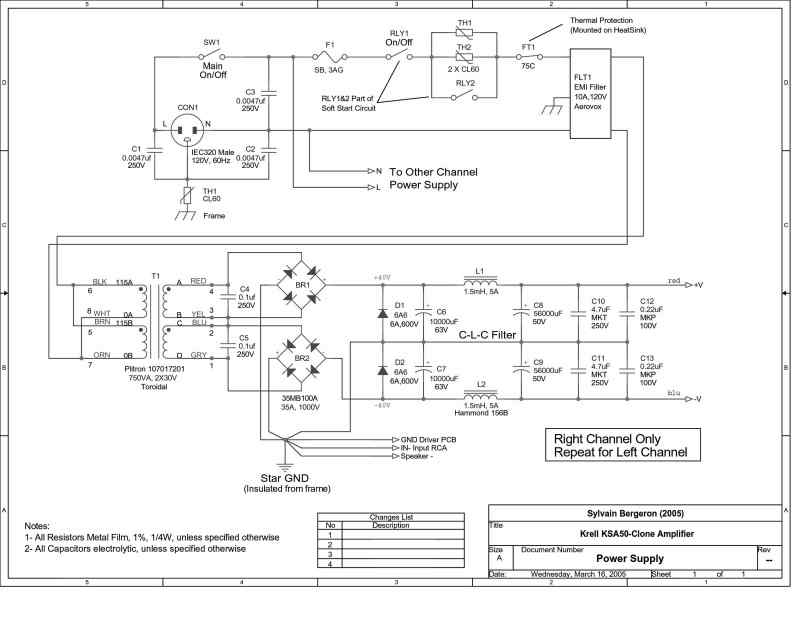

Algar_emi said:The Power Supply I will use.
Very nice! But you need a good chassis to place it in too,.
Question:
What are D1/D2 for?
Did you consider 2.5 to 3 mH coils?
"The Power Supply I will use."
Algar_emi,
I assume that this supply is for one channel? A 3.5 amp SB fuse definately will not hold for 2 channels. Its an impressive supply!! I have a box full of 6mh torodial chokes... would they work well in that supply?

K-amps said:
Question:
What are D1/D2 for?
Presumably protecting the bridges from spikes generated by coils when power is switched off (although capacitors should absorb the spike).
I think you should still consider room for DC blocking capacitors (on transformer's primary side). Even the best transformers will be prone to buzz if saturated by DC from the mains.
Bratislav
