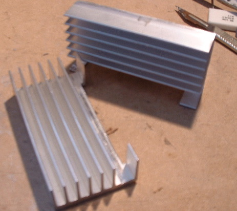

Here's the smaller heatsinks for the driver board:
How hot is too hot for predrivers for reliable operation?
My heatsink reaches 65C or 45 above ambient.

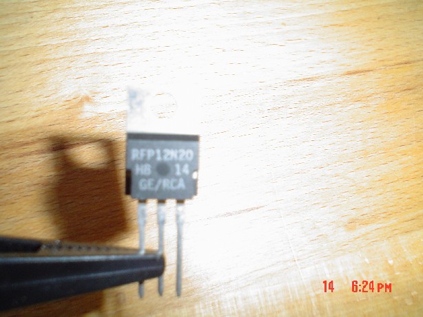

I bolted L-brackets that held 3 TO220's each on heatsinks with silpad sheet.
Worked wonderfull, less than 0.5 C difference between bracket and heatsink.
50 watt in class A from 6 TO220 devices, the heatsinks never reached 50 C.
Below is a picture of a spare TO220.
Did not have the stamina to use the bracket instead of the drains though.
