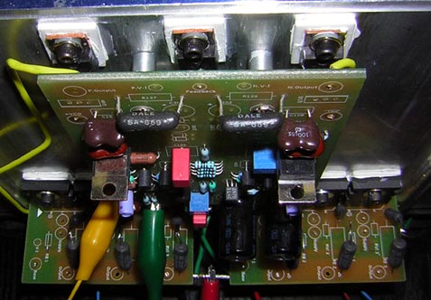

AndrewT said:...Save yourself some drilling on the next one you build.
That is actually the drilling jig I used! They were only slightly cut down from a Crown Powerbase PA amp, where they were the only heatsinking...
I still have two more for future use.
This will tend to bend the angle preventing contact between the heel of the angle and the heatsink.
I had the same thought, and I was going to use the offcut from the Powerbase heatsink plate as a spreader. I might still add some more machine screws though, better safe than sorry! 🙂

Upupa Epops said:Aaron, how are fitted belts with transistors to heatsink ? By screws on narrow side ?
Hi Pavel-
Sorry I'm late on the reply, but the heat sinks are cast Aluminum and have a mounting "tab" as part of the original casting.
They come from Conrad in Australia. I have wanted to try them on many occasions but they are hard to acquire here in the US.

That's correct! They aren't cheap, but they are worth it, for once i'm in the right country!!! Yes they are machined flat on one side too - they are totally part of it, i.e. don't come off 🙂

Your amps look VERY nice. One question. Why did you cross the N & P outputs to the devices? You "may" have been able to reduce the cable length by 50% by having straight wires.
Hi Troy, thank for tip 😎 . But I think, how is this type made - by extruded profile must have every areas axis in parallel orientation and here it isn't
. BTW, this is very nice profile, have this firm dealers here in Europe ?

It's just the way it worked out in the end, in reality i should have turned the boards around and had the wires coming out the other end........ I really only wasted a few cm of wire for the curve, as they have to go from one end to the other already!

Pinkmouse,
Nice job on the heat sink! Let me know how it works out temperature wise. I measured my sink(look alike Krell) and its running at about 65 deg.c. which is a bit too high for me. I am going to move my drivers and bias transistor onto the main heatsink tonight and see how that works out. When you think about it most amps do have the drivers mounted with the outputs and bias sensor. They will be right under the pcb.

I moved the drivers and bias over to the heatsink on one channel tonight. So far bias is stable as a rock. The semi's will also be much happier running at the 50 deg c. temp of the main sink rather than at amuch higher temp with the smaller sink.

Thaks Aaron. It sure cleans it up a bit doesn't it. To me the small heat sink is a waste of time with all that acreage right behind them.... will do the other channel tommrrow night.
