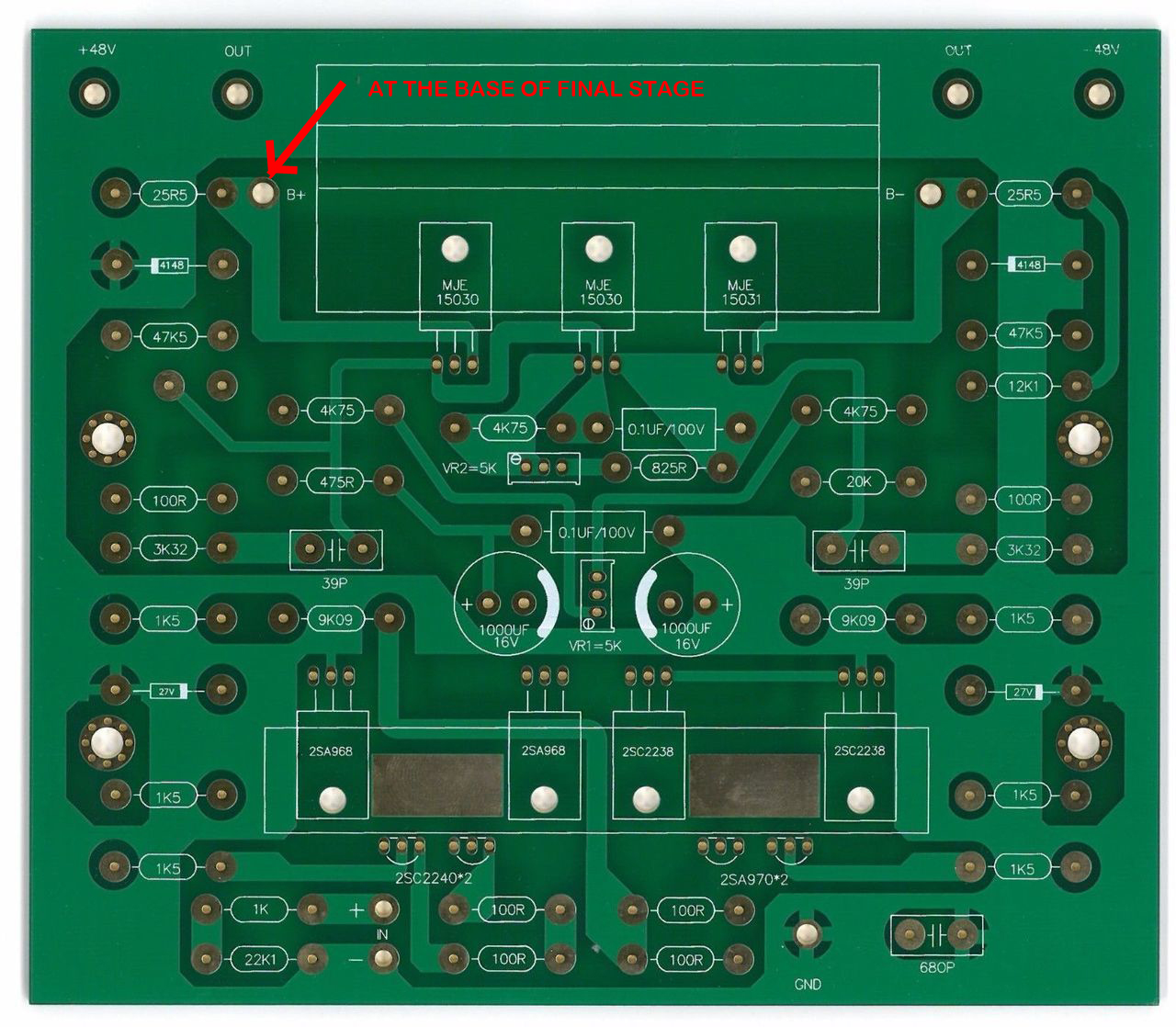

Krell KSA 50 PCB

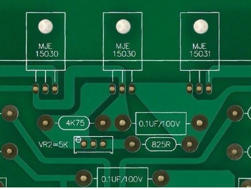

Hi, in this PCB th trimmer VR2 (bias srtting) how to set it before welding? At Zero Ohm? Thanks.

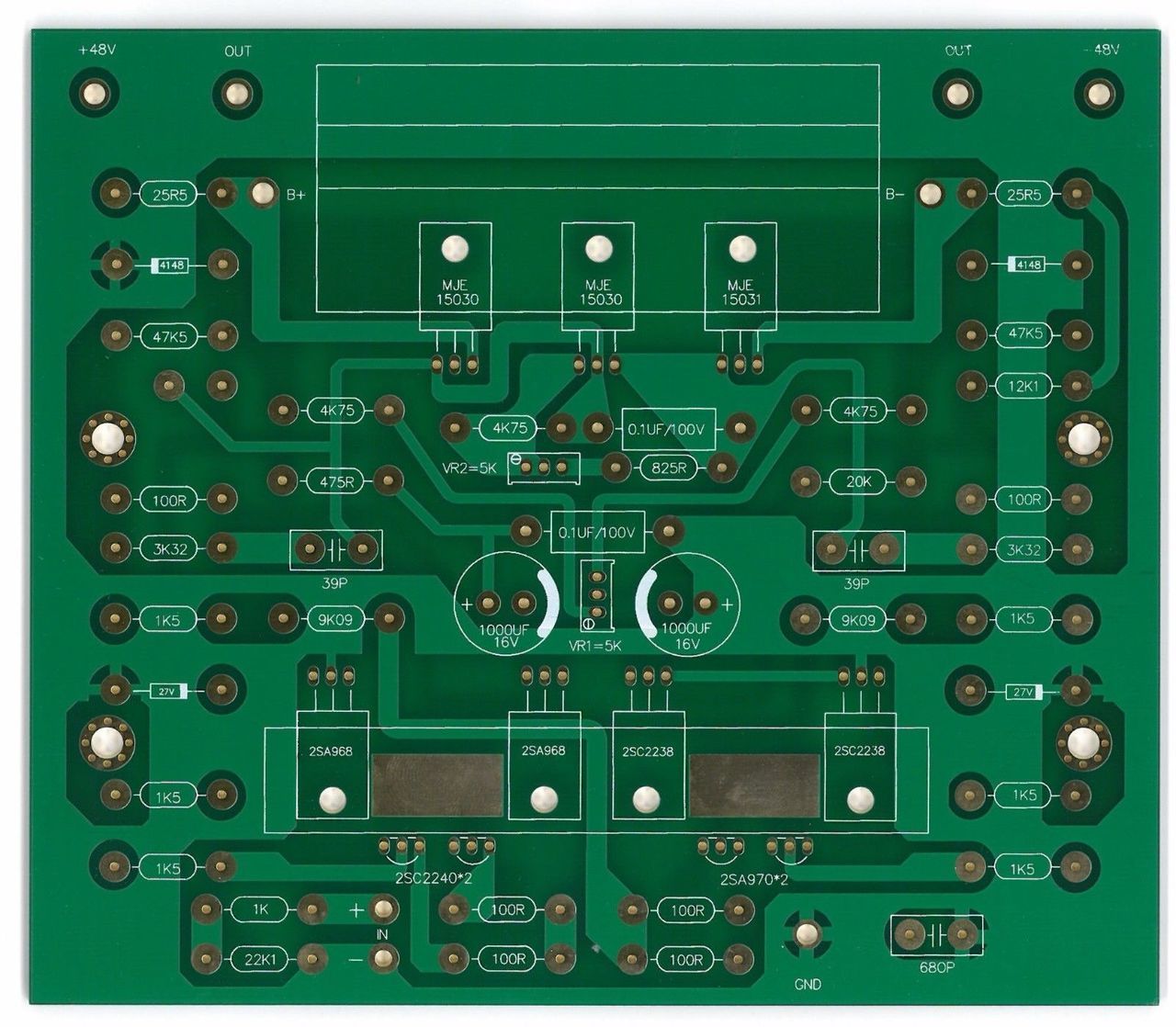

hello I just wanted to post the photos of my krell ksa50 ,, I had some problems completing it ...
I bought the pcb on ebay and then I realized a construction defect ... now I have to revise it again.
I ask and it happened to someone? the PCBs a diode on the negative polarization side that did not go to the ground?

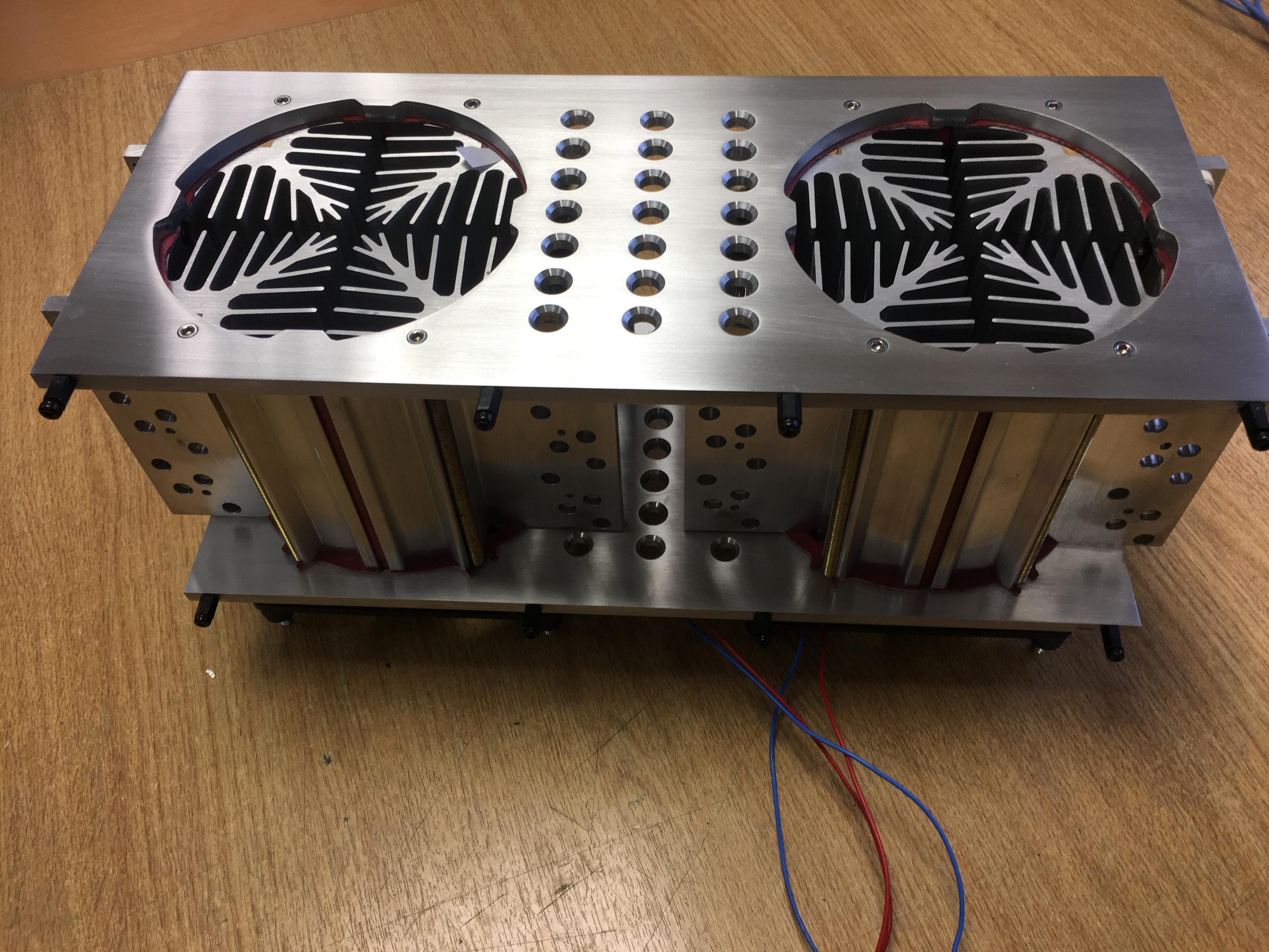

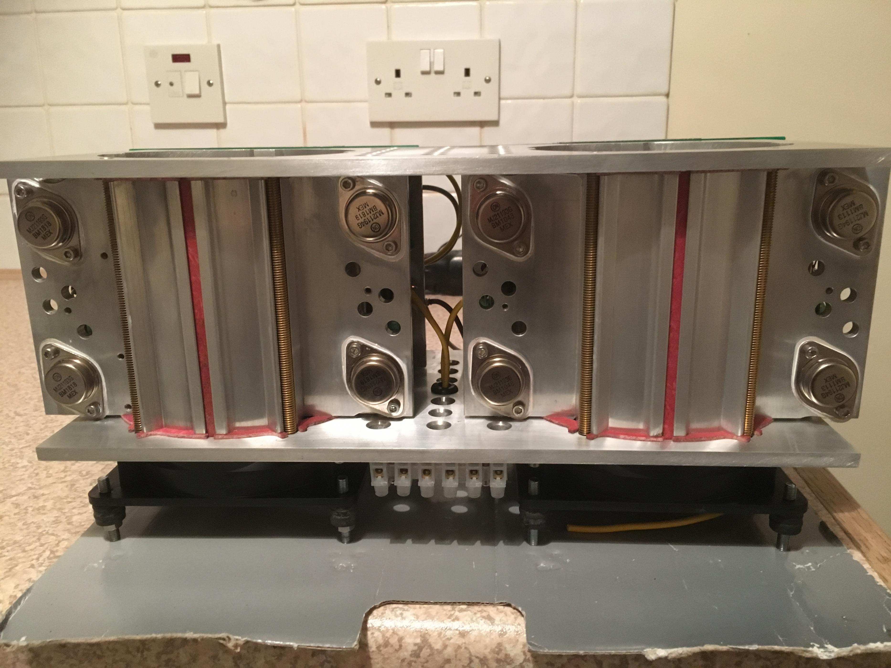

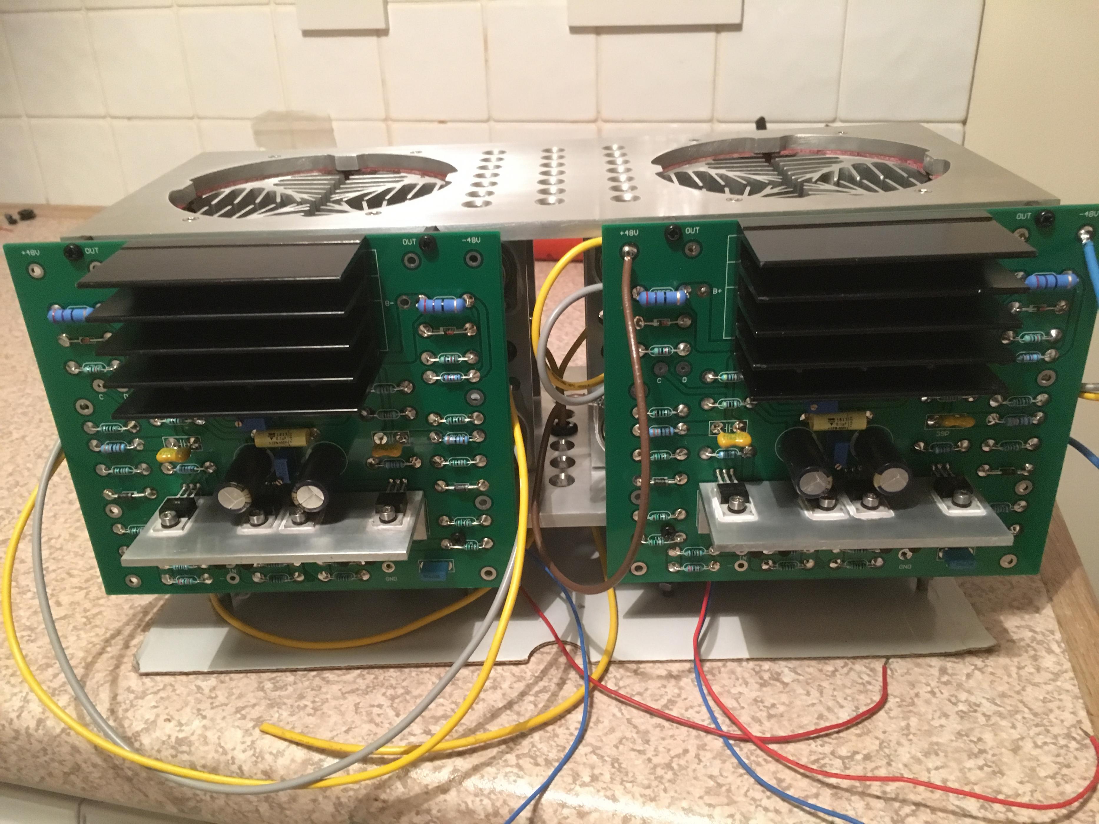

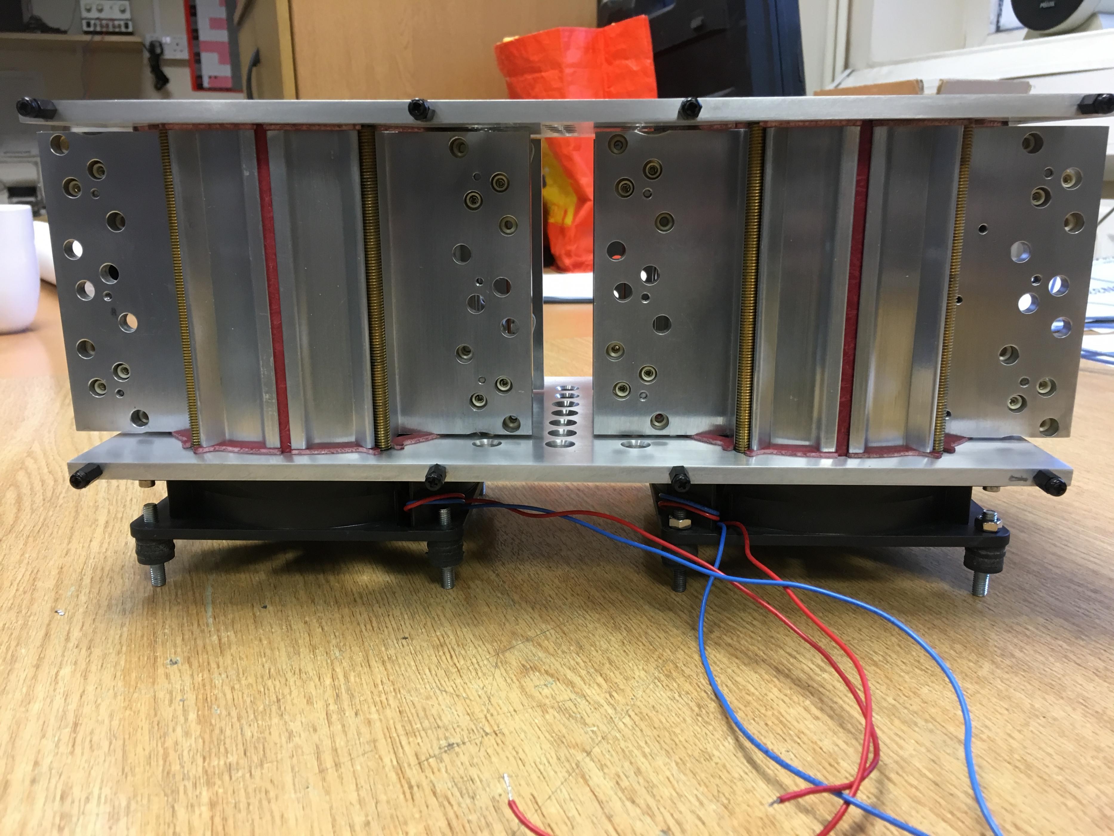

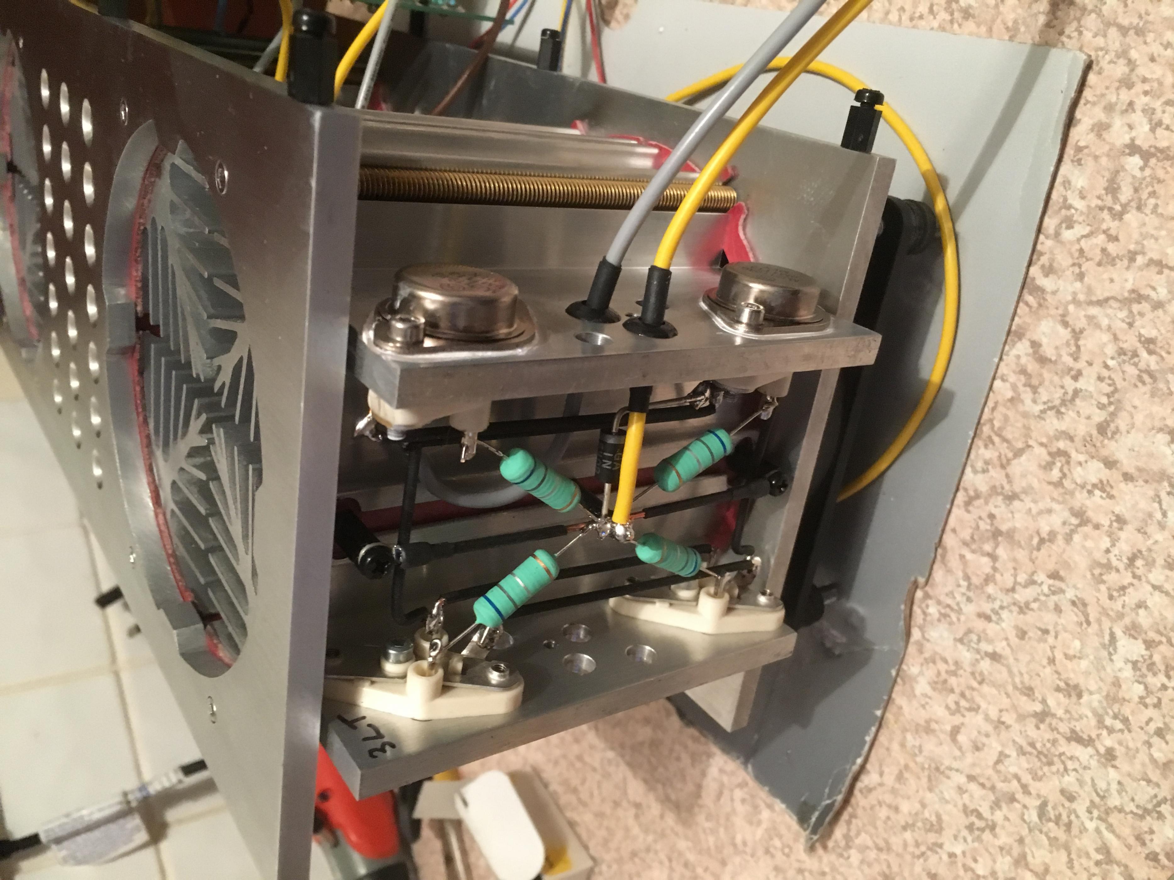

Hi, I have been meaning to build this for years. KSA50 PCB, 4 pairs of output devices per channel, 2 heatsink tunnels and 2 fans. I figured using this configuration I could run the fans slow to minimise noise whilst still keeping everything cool.
Emitter resistors of 0.68 Ohms biased to 330mV gives 60W class A into 8 Ohms, dissipating 160W of heat per channel with 42V rails. Papst 12V fans running at 5V, almost silent and sinks stay approx 20C above ambient. Offset stays within a couple of mV of zero and bias very stable. the plan is to use two separate supplies for the output stage and separate regulated supplies for the PCB, if I ever get that far.
Regards
Alan

Hi Alan,
I've just recieved the same KSA 50 boards that you have built; looks really good btw.
Could you tell me what heatsinks on the PCB you used for your build please? The ones for the VAS and LTP.
Ta.
thank you all
That has been discussed here a while ago. Solution and explanation are in post #9126, but go several pages back and read carefully these previous posts leading to conclusion.
Simply, one side of the diode is connected to nowhere. You have to connect that side properly, according to the scheme.

I also have the original Avel Lindberg trafos and part of the original wiring loom.
The heatsink tower, thermal cut-out and fan is from Krell, you can also see some of the transistors are original Krell.
The green PCB is a clone PCB from China, it looks very well made and it is a 1:1 reproduction, the holes line up nicely.
Three of the photos show the 1:1 clone and Pinkmouse pcb.
You can see the heatsink I'll be using for the driver board, I'll be cutting it up into 4 heatsinks and two for the pre-driver.
