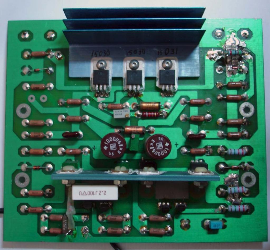

I have attached a picture of an original, albeit beat-up, Krell PCB. The LTP transistors don't need a heatsink. The VAS devices you can solder upright, as shown, attached to a 5 or 6mm thick piece of aluminum to serve as heat spreader.

Grimberg - great looking build. Mine is more of a restomod, mainly restoration with some low-key modifications.
Thanks for the cct Berlosconi, can I trouble you for a larger / higher resolution file?

I'm building a KSA50 clone based on Jim's Audio boards and his KSA50 clone heatsink.
One area that I'm confused with is the standoffs of the PCB from the heatsink. These standoffs attach to one the mounting bolts of the TO3 output devices and hence are live at the +48Vdc supply (-48Vdc on the PNP boards), if the standoff and mounting screws are metal. On the main PCB the holes for the standoffs are electrically connected to the +48Vdc and -48Vdc tracks (NPN and PNP respectively).
This does seem strange as there is already a +48Vdc/-48Vdc wire between the main PCB and the driver boards on the heatsink. So why electrically connect the boards through the standoffs???
My question is whether I should be insulating the standoffs with say a nylon spacer at the main PCB end, or that the live standoff is 'normal'?
