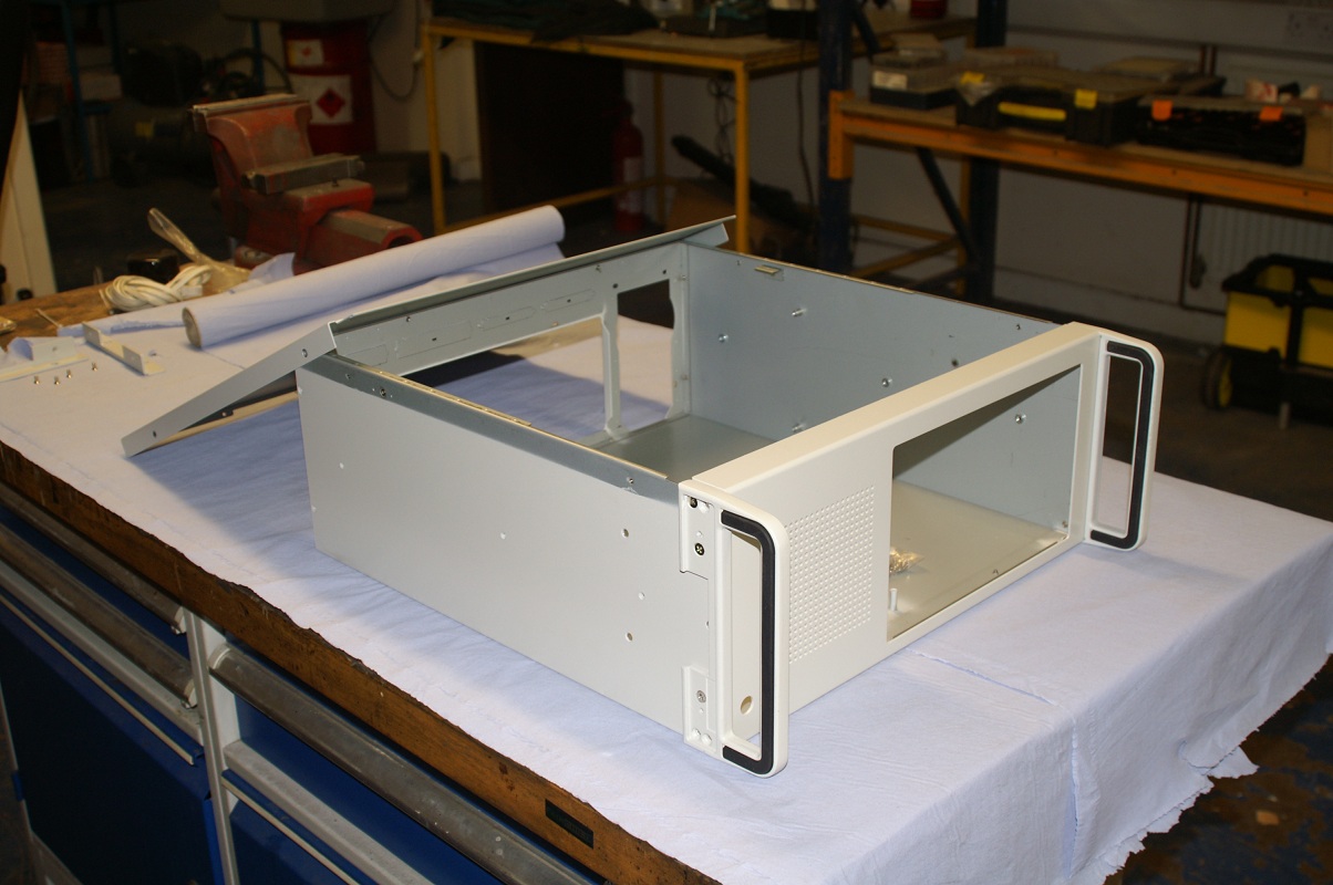

henryve,the heatsinks I used on the build I posted pictures of may have been marginal but please bear in mind that I was using 25V rails and 1.7A bias, dissapating 85W per channel so heatsink required was 0.35C/W. I was not so much worried about the temperature that the sinks reached, I was much more concerned with the fact that all the internal components also reached that temperature. If I was going to use passive heatsinks again I would try to thermally isolate them from the rest of the chassis.
I saw (I think) from your pictures that your construction appears to be the same as I used. I am not technically qualified enough to offer advice, but I would certainly bear it in mind. How much heat are you intending to dissapate per channel?
I have decided to use two heatsink towers as per KSA100 and run fans at approx 5V making them virtally inaudable. If I were to use passive heatsinks for this build I would need to have approx 0.187C/W sinks per channel.
Rails are 42V bias 1.9A = 160W heatsink towers approx 140mm tall.

I calculated around 160W per channel if I bias at around 1.9A. My rails should be around 41V each. This means that my heatsink should have a Rth of at least 0.1875 at Ta = 25 deg C. I think mine is around 0.11. I get what you said about only having 25V. I just don't think you should have given up on your first version that easily. You could have just used an extracter fan if the heat inside was too much. That power module for your first version is done so well, I would cry if I had to scrap it. Hope you kept it around since that power module and heatsink would be ideal for an F5, just change the transformer.
I intend on having lots of holes on the bottom and top covers. Basically about 60% of the area on the top plate will be perforated, and about 30% of the bottom. The proof however is when I start biasing.

However I have some reservations if your enclosure is strong enough for the heavy innards.

Jozua, The plan is to mount all components to a 5mm thick aluminium plate that will then be fitted to the base of the case. Hopefully this will allow an easier build and give the required ridgidity.
