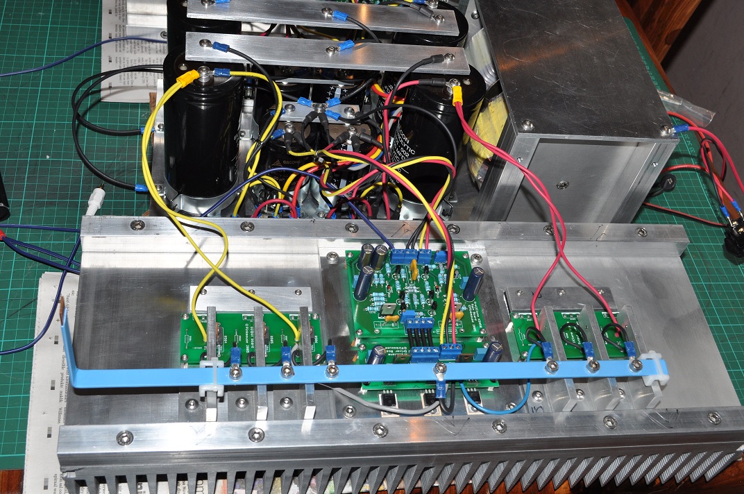

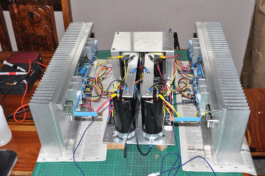

Attached is some pics of the amp during my test setup. The bad thing about this layout is that one cannot bias the amp assembled. Spacing is just too tight.
You will notice 2 different sets of capacitors. The smaller ones are 10000uF 63V Epcos Sikorels that feeds the main and driver boards, and the the other ones are 55000uF 63V cheap Indian caps that feeds the output boards. I might replace thos with some Epcos or other caps when the funds allow.
I also need now to clean up an organise the wiring. In future I would prefer Faston connector on the boards for power wiring. I don't trust these screw terminals.
