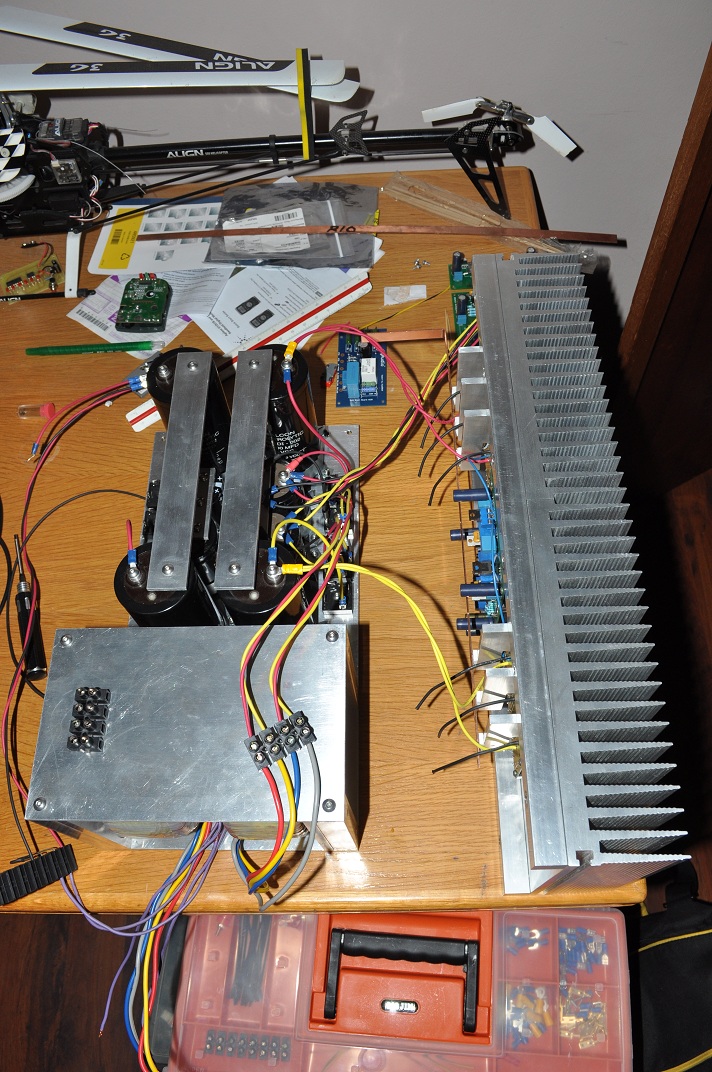

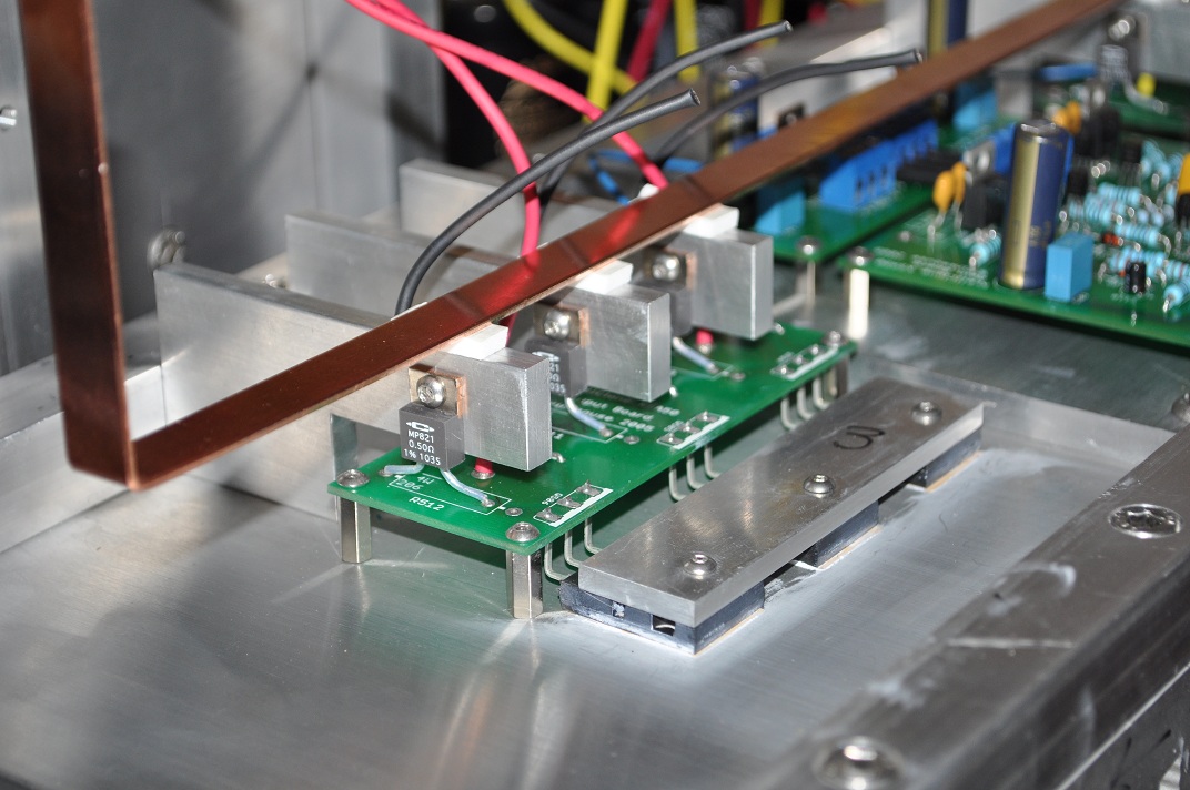

This is my current test setup. I am about to wire up the outputs to the busbar and then I am ready to bias this channel. The other channel is still in my workshop for final metalwork.

Nice engineering! Thought about the rest of the case yet?

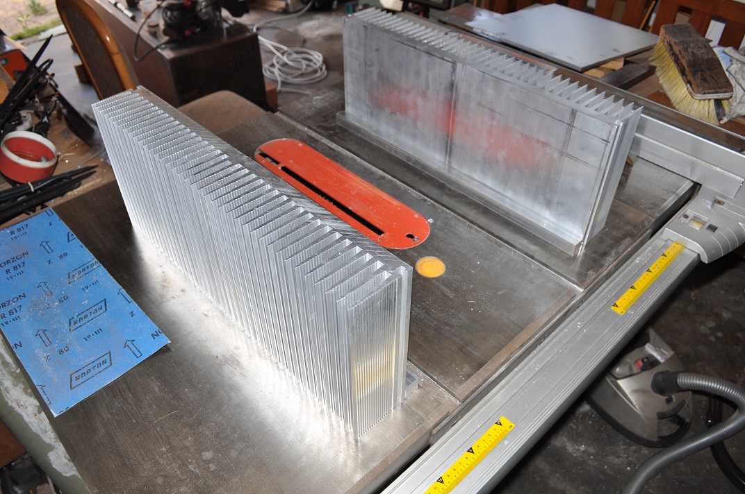

Yup, in progress. Some more drilling needed for binders and sockets etc, and front panel still in the works. Hard work this if you only use tablesaw, standing drill and a set of files.

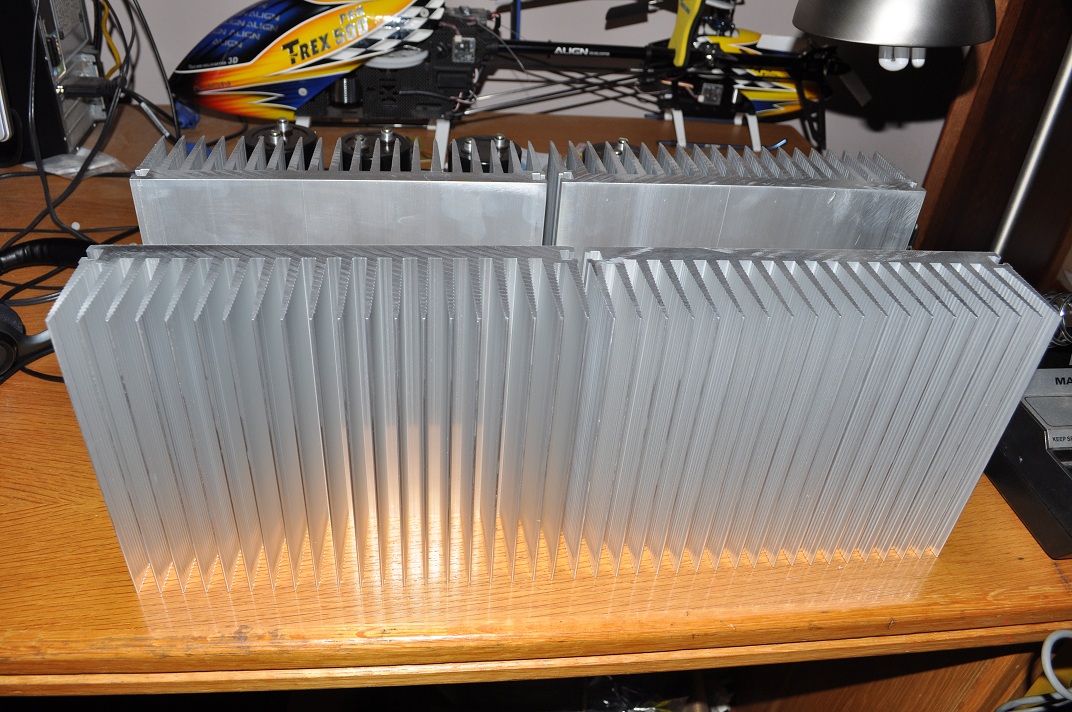

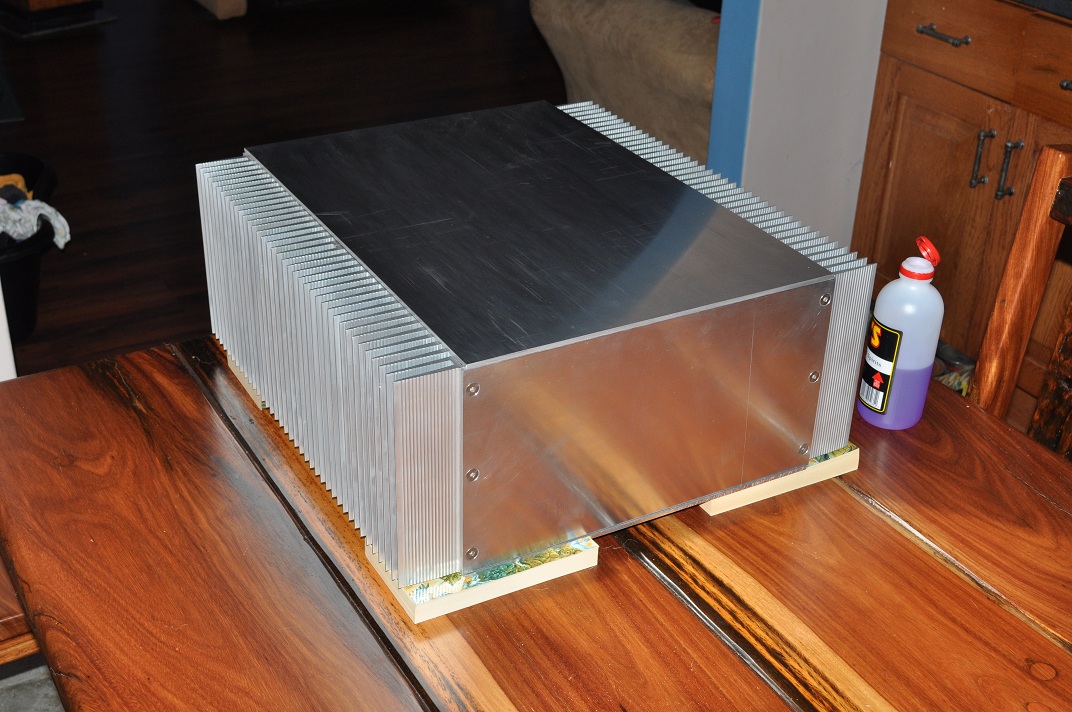

I have been constucting a KSA50 for a long time now, along the way I have altered my design concept several times ( not the circuit, but the cooling and power output ) I started with +- 25volt rails and about 1.5A bias and passive cooling, giving about 25W. This was OK but I ran into problems with heat, I was only dissapating about 70W per channel, but the sinks got very hot as did the rest of the amplifier internals.
Henryve, how big are your heatsinks, the case looks very professional. Mine were 400x150x40 each side.
I then used a heatsink tunnel almost identical to an original KSA50 with a Papst fan and rails of +-33v. Cooling was much better, but I was not happy with the chassis layout.
I am now on the third incarnation and I hope I get it right this time. I have collected most of the parts I need so will start putting it together soon (I hope ) I have chosen a physical layout very similar to the original KSA100. I am now using 2x 30V 500VA transformers, 2x40,000uf per rail, 2x heatsink tunnels (same as Krell but about 150mm high) 2x Papst 12V fans, 2x Jans PCB's, case is ex computer server, bit big, hope the wife understands.

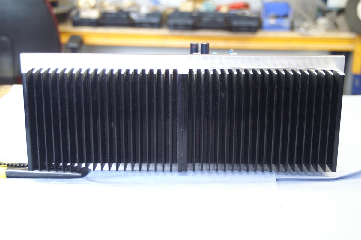

My heatsinks (each side) is 510mm (D) x 200mm (H) x 75mm (W). The base part of my heatsink profile is 15mm whilst the fins are 60mm. My fin spacing is about 13.5mm. I recon it should be enough, though not for today because today our Ta = 38 deg C, so I don't think any passive will make it today.

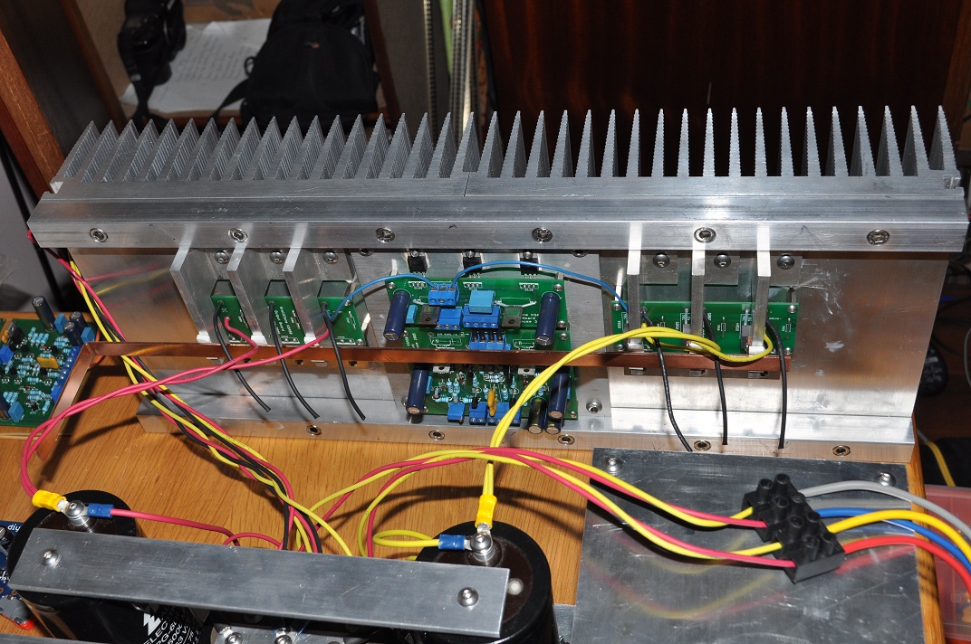

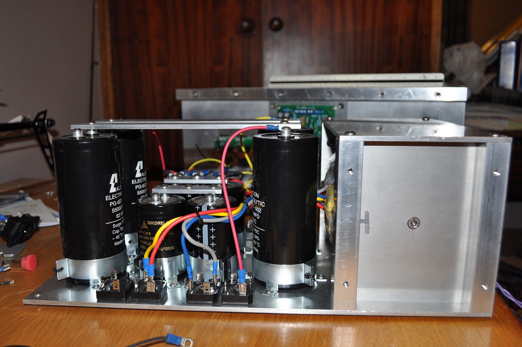

I have attached a couple of pics of my first attemt at the KSA. I was using 25V rails, aiming for about 25W per channel and dissapating about 70W per channel in heat. The chassis sides and bottom were 10mm aluminium and the sinks were aprox 400X150X40mm.
Even with this low dissapation the sinks and chassis became very warm. I have no exact temperature but I think about 55C using the finger test. I realise that the output devices would be OK but it was the rest insde the chassis, transformers, caps, etc that I was concerned about. That is why I have now gone to active cooling
I have used two heatsink tunnels as per the original KSA100, but they are taller, aprox 140mm and two Papst 12V fans. This may be over the top for a KSA50 but I can run 42V rails at almost 2A bias and can quite comfortably keep my finger on the output devices (8 per channel). The sinks will be issolated from the chassis so everything else should be fairly cool. I have only ran in test conditions, eg amplifiers running outside the chassis, lot of work to do yet so I will keep my fingers crossed.

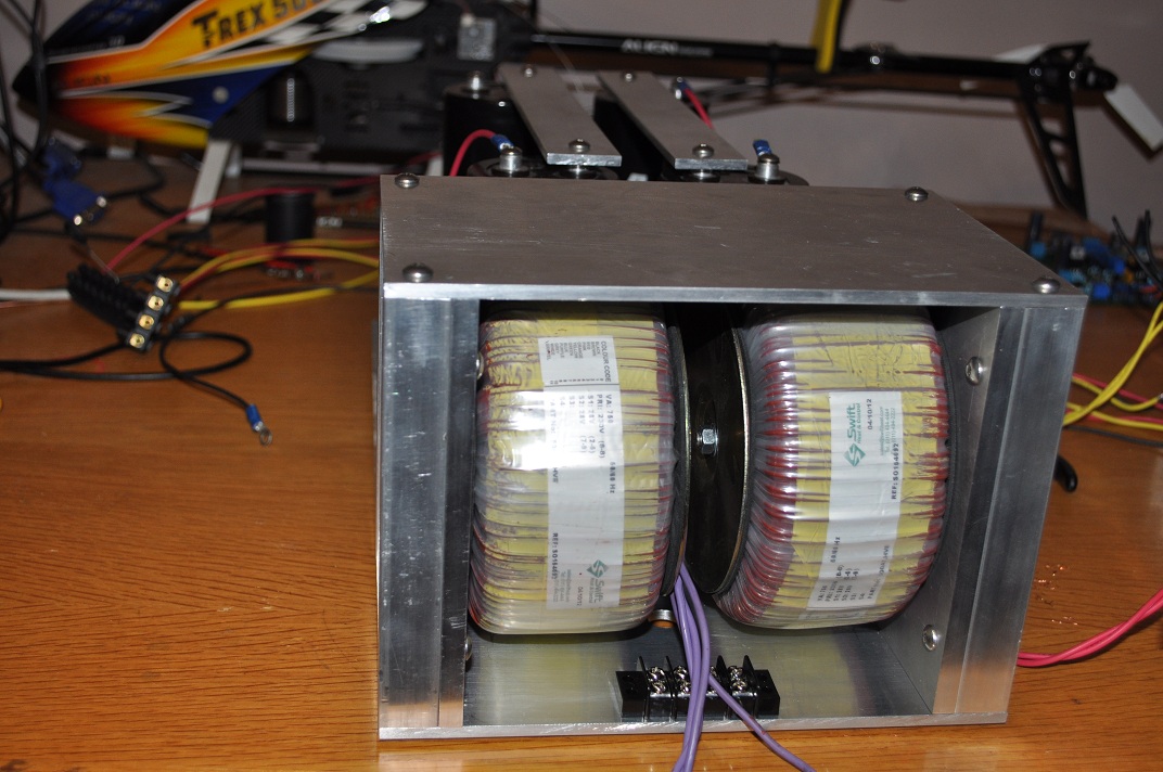

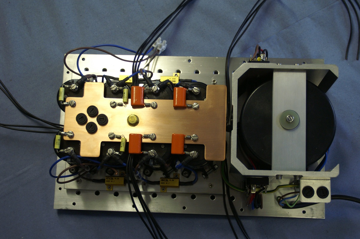

My barrierstrips arrived today so I can now complete the wiring for my PSU module. Pics of the power module attached.
Some info on my PSU. 2 X 500VA transformers with 2 X 30V secondaries each. This is fed on each transformer to 4 rectifier bridges. One set of bridges feeds 2 X 10000uF 63V Epcos Sikorel caps which will be used to power the main and driver boards. The second set of bridges feeds 2 X 55000uF 63V Alcon caps, and this will be used to power the output transistors. The Alcons are cheapies from India, and I hope to later replace them with Epcos caps, though not Sikorels. The big Sikorels are priced completely out of my wallet, so I will go for the cheaper ones.

My experience with the el-cheapo 'by-pass' caps you seem to have used in your Krell PSU has been that they can be extremely sharp and two dimensional sounding. At first they might impress but on the long term it becomes tiresome.
Still your workmanship s very impressive. In fact all the latest clones are beginning to look like pieces of audio art.
